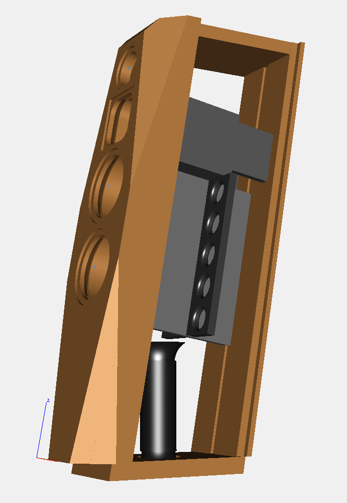

                    Coming to you from my music server... :W
                    Just putting together piece part sheet drawings and thought I'd post another teaser screen shot... :B
                    Yeah, I'm fixing up my music server/speaker tester Mac Mini to also use for work and work/work, as I have to go into the office more often, and want to run full dual monitors, not a laptop and second monitor. So this is from my Mini, bless it's little heart.
                    As noted earlier, the midrange is in a tunnel, but not open back, though the sides do extend to the back for front to back bracing and for the assembly process.

                    And now, as ThomasW would say, more sawdust and less pixels. :W

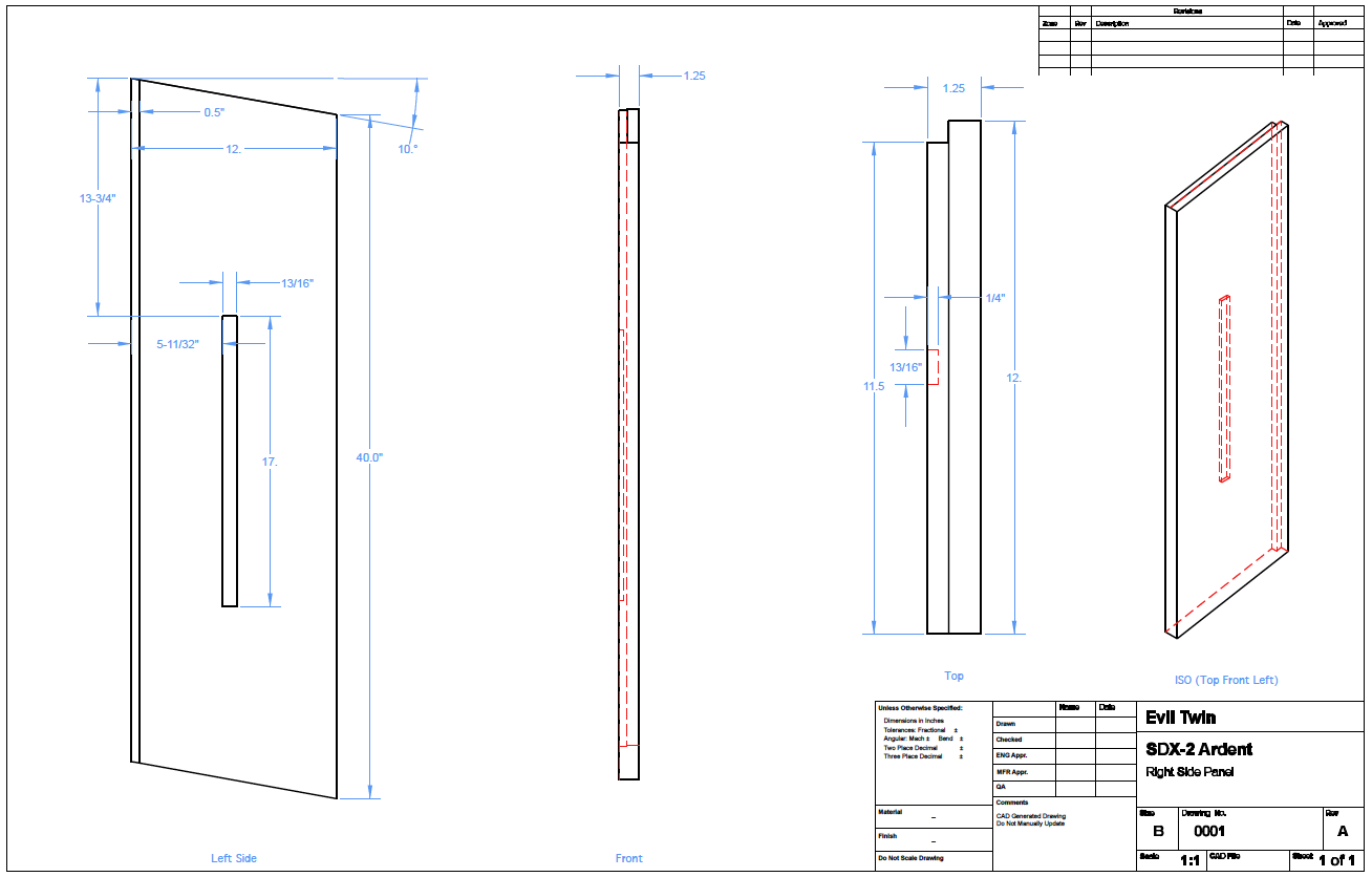

                                    Oh, we've been having fun... made some sawdust, too, more today
                                    As Thomas notes, the SDX-1 NeoD CC (in a stereo pair as mains) are my "daily driver". Best "little" box I've ever done. Not having the linear distortion and accompanying energy storage (think SL and MarkK testing) above 800 Hz that most cone drivers has does wonders for midrange resolution with good source components- that RS52 is a great driver, as is the D26NC55- they just get out of the way of the music.

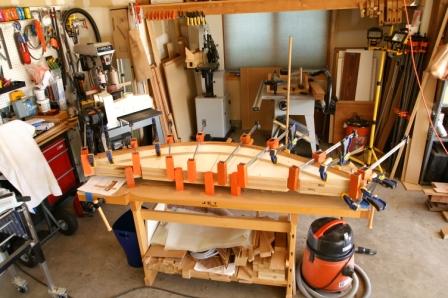

                                      No, I don't own stock in Bessy, but maybe I should. I don't think a vacuum clamp for assembly operations would work well for what I'm doing; I'm actually using clamps at some points to line up work pieces initially, then moving them to more conventional positions after other clamps have been installed. And the clamping force on heavy pieces is much higher than what a vacuum bag can generate; plus, there's the heavy angle iron stock I use at times to insure the glued up piece is perfectly straight.
                                      Click image for larger version  Name:	SDX-2a-FP_Gluing.jpg Views:	0 Size:	212.6 KB ID:	936583
                                      :W
                                      Well.... I should probably own "clamp stock" as well. Since a project doesn't exist unless there are pictures - here is the "rough wood", clamping the arch for the bed frame, and final product from this weekend.... I'm keeping up with you!!!
                                      Tom
Name:	Wood Rough.JPG

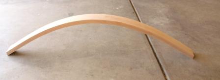

                                        #244
                                        Impressive, most impressive.
                                        Now, if you could produce that curved piece with the power of the Force instead of all those clamps, that would be the mark of a true Sithlord.

                                          #245
                                          Did you have to put the wood in a steam box for that?
                                            No kidding..... you should see how fast I can get the laminated pieces onto the form and get all the clamps attached. I'm guessing I can reporduce everything you see in the picture in under 5 minutes. 8O
                                            I was using my power of the Force to overcome the pain in my back from doing too much with this ancient body over the weekend! :rofl:
                                            Tom

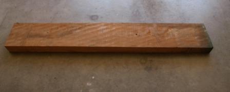

                                                Nope.... I took a 12/4 piece of cherry (seen in the picture) and cut it into 4 inch by 80 inch strips using my bandsaw. The strips were evenly sanded to 3/16ths of an inch with a drum sander and then glued up with a urea glue and bent around the form. When they came off the form there was a slight amount of spring back... ~1/2 inch but it was already accounted for in the design of the form. Steam box would have been a PITA .... although given the temperatures over the weekend I might have been able to do it in the backyard! :rofl:
                                                Tom

                                                  #249
                                                  So they went in the form with wet glue and then removed when the glue was dried?

                                                      #251
                                                      See, this is something I don't know how to figure out - is there a standard amount you can anticipate? How do you calculate this?
                                                      I know how to figure out how much silver to use by weight instead of wax, how to calculate how much a casting will shrink given material... springback from laminating like this? No idea.
                                                          There is a general calculation I've seen somewhere that goes (for my arch):
                                                          springback = (height of arch) * (1/number of laminations squared).
                                                          the height of my arch is 18 inches and the number of laminations was 6... so pluging in the numbers:
                                                          18*(1/6^2) = 0.5
                                                          Since my units are in inches the answer is 1/2 inch. THIS IS JUST AN ESTIMATE... I ran a test on scrap wood and the number was correct. Obviously thickness of laminations, radius of curve...etc can change the estimate so I always run a test but the formula works for a guestimate.
                                                          If my laminations were 1/16th of an inch thick the springback would have been insignificant..... but I would have had to cut and sand 18 very thin sheets and not the 6 kinda thin sheets that I used. :B For most woods cut to 3/16ths the formula is pretty close if the radius isn't too tight.
                                                          Tom

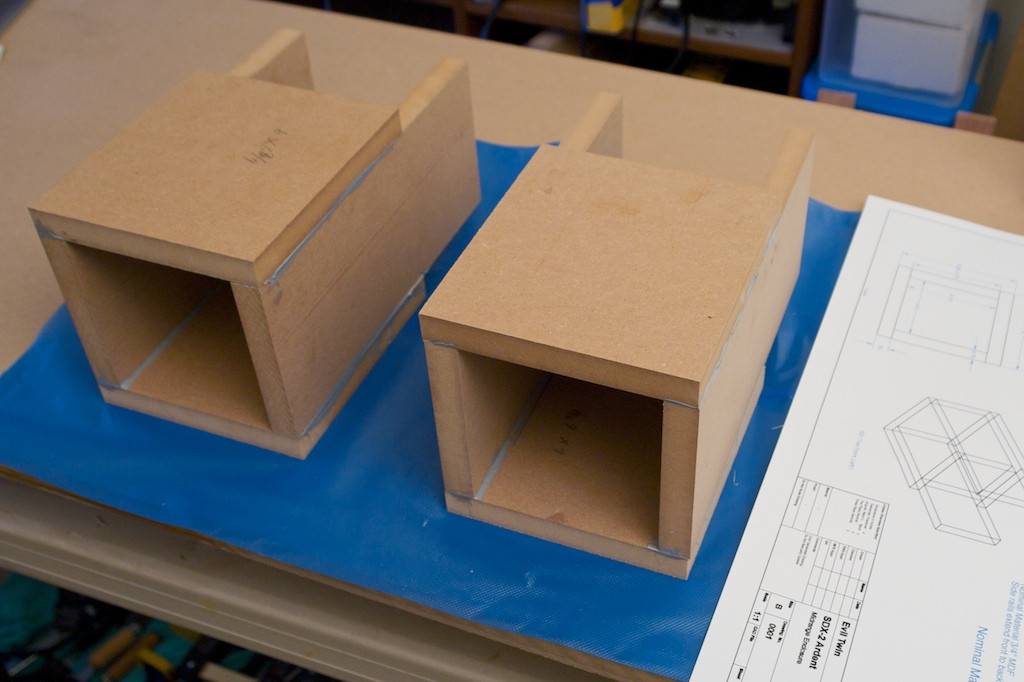

                                                                            Bits and pieces...

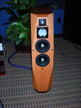

                                                                            Last night I "glued" together the first pair of midrange enclosures, or rather, "epoxied" them together- mostly because they would be awkward to setup to clamp. I use "50 minute" epoxy as I really like to take my time- none of those five minute quickies.
                                                                            If I get done with work quickly enough today, I'll probably dado the front panel groove for the brace and clue up the mid enclosure and brace, after checking a dry assembly. Or not, knowing how things have been at work- yesterday started at 5:30 in the office, and finished at 7 with the end of an hour long conference call to Singapore.

                                                                              #263
                                                                              What's the purpose for the tunnels, aside from cabinet bracing?
                                                                                • 16073
                                                                                #264
                                                                                The extension to the back means that the midrange enclosure is not reliant on resisting tearing forces with the glue to come off the front panel- it is braced in position by the wings extending to the back on either side.
                                                                                Good mechanical design means using materials in ways that they are strong, not ways that they are weak. If you just had a box glued on to the back of the MDF front panel, it could be relatively easy to shear the glue bond, splitting off a thin lear of MDF. MDF has good compression strength, mediocre bending strength, and poor tearing/delaminating strength.
                                                                                I have been a product designer in a past life (decades ago), but I still tend to think like one- robustness should be a given.

                                                                                      So Jon - what is your estimated total weight per enclosure (incl. drivers and crossover) when finished?
                                                                                      Out of interest - is it worth putting an accelerometer (sp?) on the front with some 30Hz sine waves to see what level of baffle resonance / movement (if any) you get?
                                                                                      I'd love to see the results of this speaker compared to a commercial in that regard.
                                                                                        • 16073
                                                                                        #268
                                                                                        Estimated weight is 110 to 120 lb. Depends partly on how the crossover comes out... :W
                                                                                        Usually 30 Hz is not problem- for conventional baffles the issues are usually in the midbass area or midrange. Low in level, but large in area for a floor standing speaker.
                                                                                        As mentioned earlier, this is not a new thing for me; first speaker like this (4 way 10" system) with uber thick faceted baffles was done in the 70's. (that one also had a rounded back- half circle... don't ask. MB 3/4" tweeter, Audax dome mid, Audax 6" mid, 10" woofer (a special "long throw" CTS part if I remember correctly).
                                                                                        That speaker used 1st order crossovers and was "transient perfect", i.e., it would reproduce square waves. But it had the off axis lobing that results form 1st order Butterworth networks with phase quadrature and non coincident drivers.
                                                                                        Some day I'll get this right.
