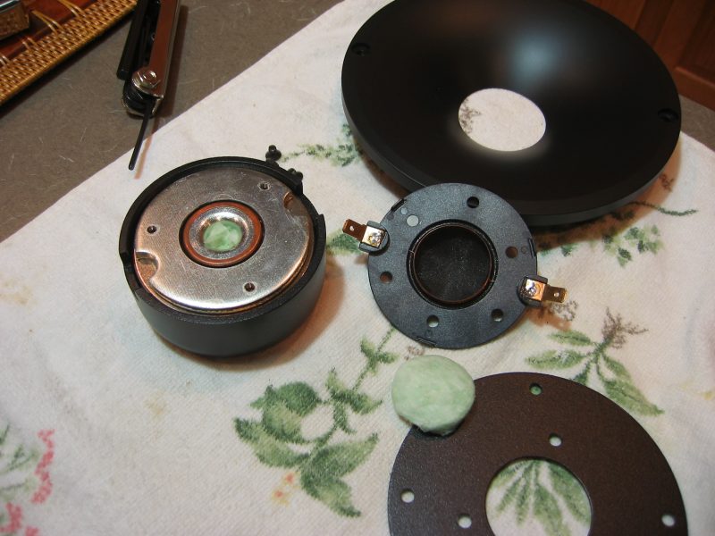

      Just to expand on the distortion of Ciare MT320 a little. Once it didn't work well in the waveguide I didn't pursue but I think the distortion could be improved further. Again below is the MT320 along the Jantzen WG
      Damping "pillow" in place
      pillow removed.
      The distortion with the "pillow" in place,
      pillow removed.
      I think the 2nd order would be smoothed/reduced if a proper felt pad was constructed that did not touch the dome and provide good ventilation like the Scan tweeter pads...another time :W

            Your speculation regarding the edge damping from the felt might just be right on the money. So far, I haven't seen any other hard dome WG test work out this well.
