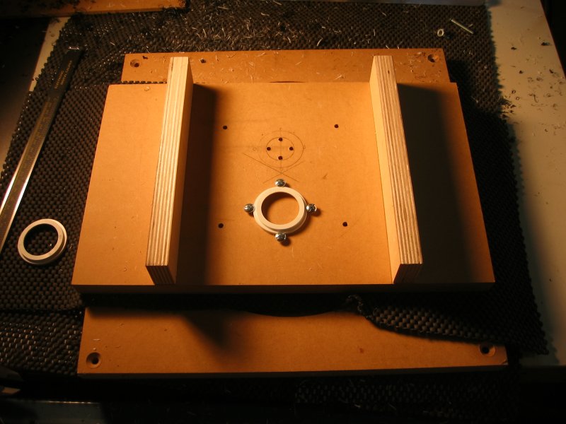

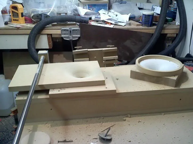

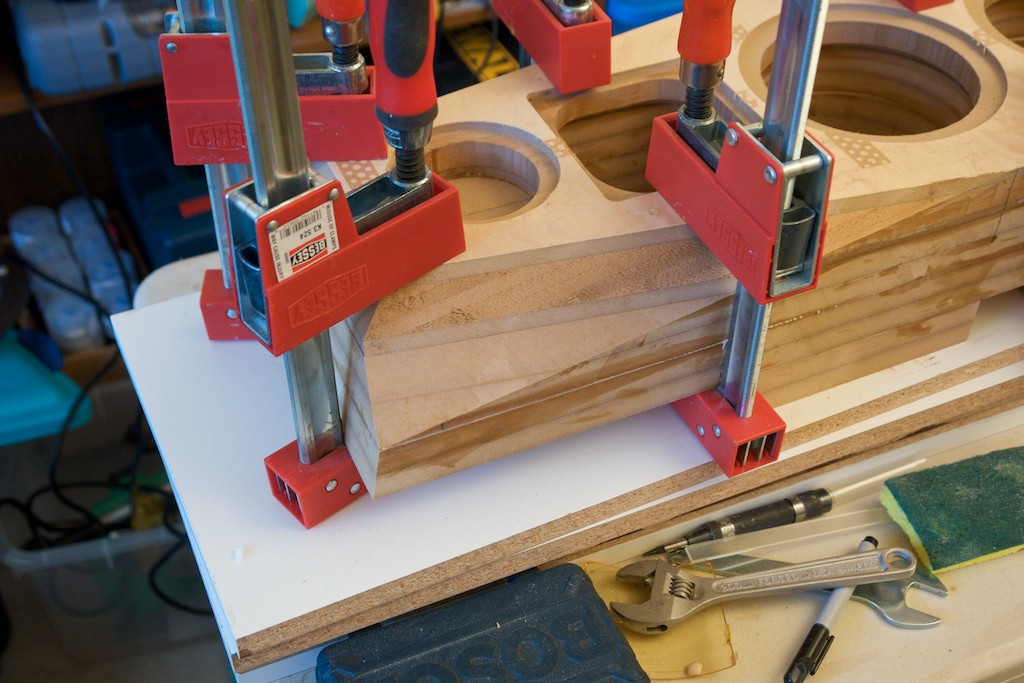

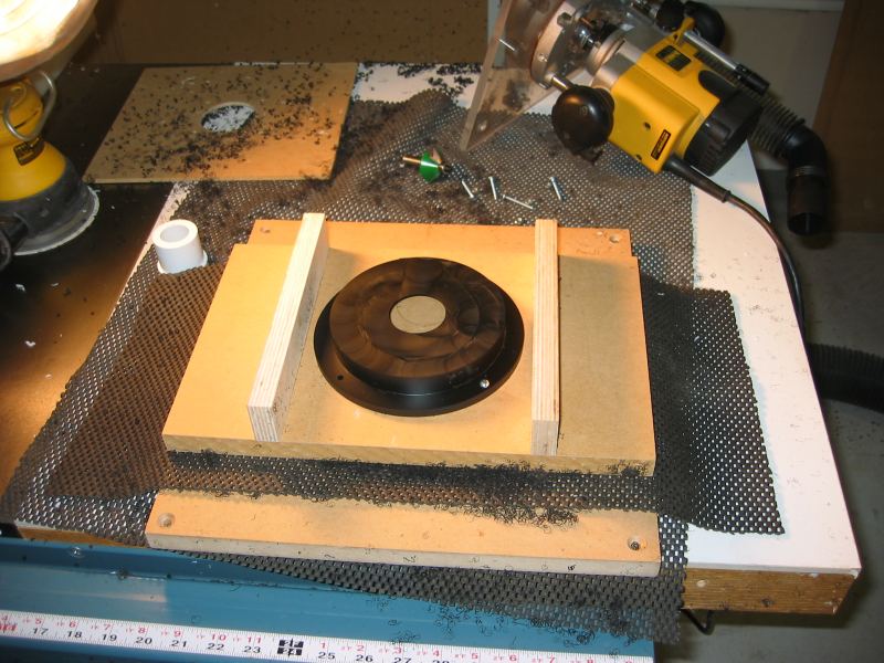

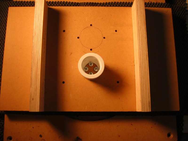

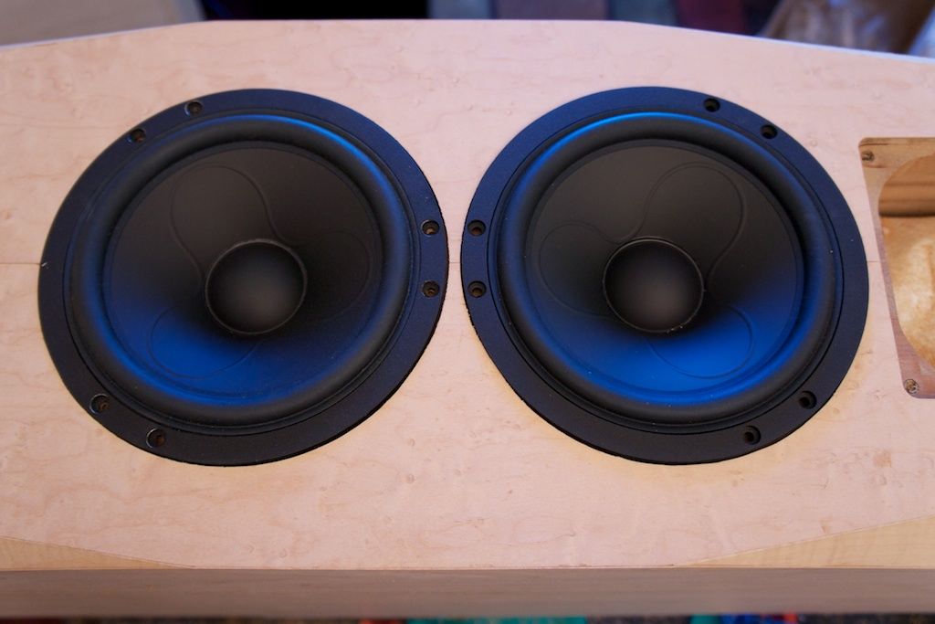

              Well, first weekend since the 4th I've been able to dredge up any spare time- usually been on business travel on Sundays, and getting ready for it on Saturdays.
              And since a picture is worth a few hundred words at least, these should speak for themselves?
              My hole hog out phenolic jig worked fine, and using a rebate bit with Bosch colt router with the speed turned all the way down, cutting the new rebates was a walk in the park. The old threaded inserts were backed out, and the holes filled with system three Wood scalp, a two part wood filler that works more like an epoxy material, but feels like modeling clay. Best to use latex or nitrile gloves, though, kiddies!
              And though the woofer rebate edges are not quite the seamless smooth arcs an original cut one with router would be, they're so close I won't have any trouble living with them in the living room, I think.
              Oh, and yeah, it is necessary to use a router and hog out a bit of the brace board; the rear of the magnetic assembly on the SS woofer is just jutting up against the board, and without the relieve, the pole piece vent would be blocked.
              I'm working on modifying the base plates now, and creating a new entry plate.

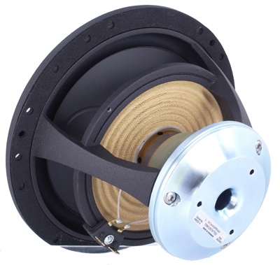

                    Designed for breathing...
                    Wow. I missed or forgot how thick that baffle is. That's crazy! :T
                    No concerns about the back of the driver being able to breathe?
                    The measured response and "breathing" for the ER18RNX was OK, and with the design of the SS illuminators and it's small neodymium magnet, will be even better I believe. The baffle is built up of a contoured set of panels, and the mounting panel for the woofer is smaller in diameter than the pass through holes- it's done with an LBL plank. All is beveled and contoured- though it's hard to see the design from the photo- the construction PDF's make it pretty clear.
                    No effects seen like the Seas Excel 5" in the NHT Xds cabinets, for example. It doesn't hurt that the frequency range of interest is only up to 800 Hz, with nominal crossover point of about 350.
                    Of course, the proof is in the pudding....

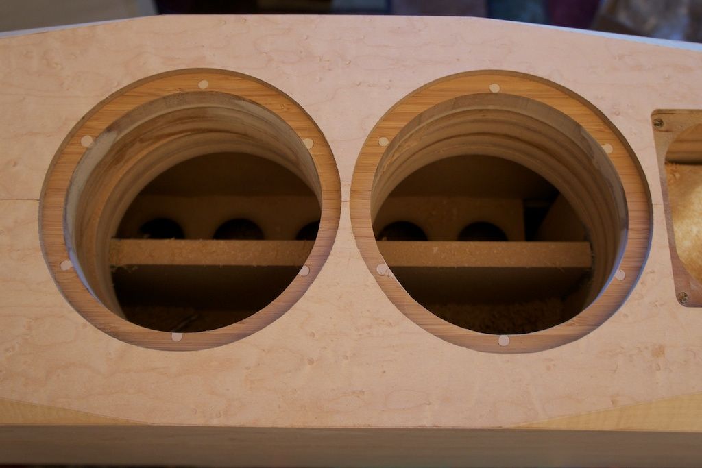

                      What about the C79? Did you end up having the open up the baffle (contour?) around it? Also, I don't recall what it's internal volume is. I 'd expect only a liter or three, but it looks like you might not even have that much in some of the photos once all of the structure is taken into account.

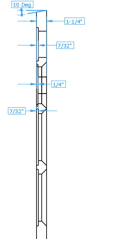

                        This cross section should explain....
                        This is the cross section view of the top layer, which is 1" consisting of 1/4" HDF and 3/4" LBL. Midrange and woofer cut outs are back beveled.
Name:	Ardent FP Pieces.png

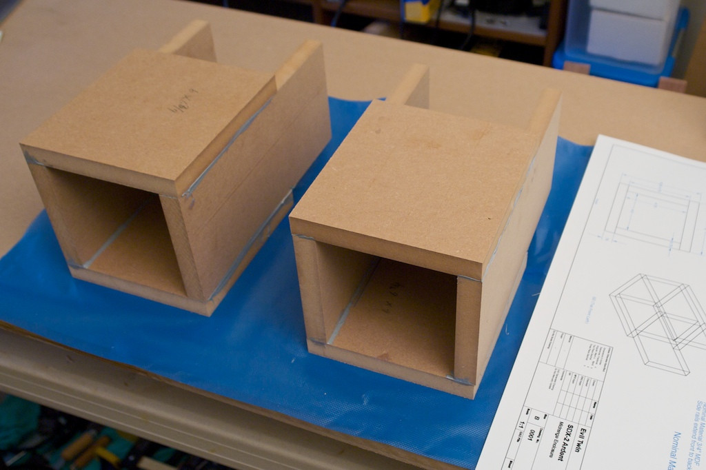

                        Midrange enclosures behind the front baffle

                        The ideal front plate material for the C79 is probably the 1/2" phenolic tool plate I bought at Woodcraft recently, for making the woofer hole hog out fixture. This was very dense and hard, more like plex almost than phenolic.

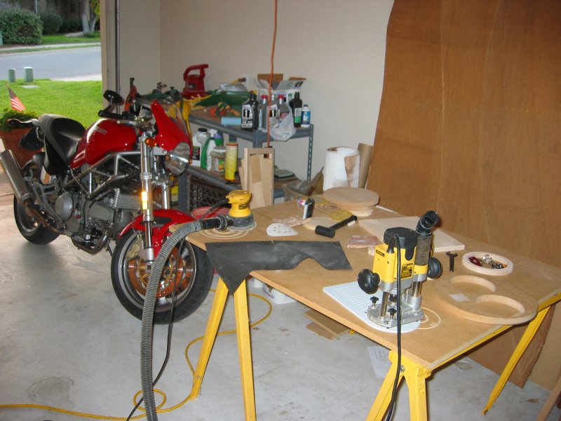

                              This has been the opposite of summer camp this year...
                              well, how did it wind up being September 13, and I'm in Cleveland for the ICSCRM 2011 conference (International Conference on Silicon Carbide and Related Materials), gave my paper yesterday, but have a six hour seminar finish preparing by the end of the month, and when I go back and check, realize I haven't had a day off since July 4.
                              The modified Ardent is on a portable workbench in the middle of the living room to remind me I need to be working on this "soon". I guess soon will be October some time.
                              Even my boss and the VP of our division realize how jacked up this is; they did throw a bone to me with a substantial discretionary bonus last month, but still, this is BSC, and I don't mean baffle step correction this time! We have a new young guy with a PhD just started this week; he's based on the East Coast, and will be coming out for some training in the early part of October. He seems to have some good chops in the low voltage converter stuff, and a number of published papers; he's an IEEE member, as I am. I've got my fingers crossed.
                              After listening to the Ardents for most of the spring, going back to the Modula Xtremes was something of a mixed bag- more guts in the bottom end after a fashion, but just not the same resolving power. No question I need to start planning an Isis like build for those mids and woofers, and think about what to go with for treble- right now, I can't hear anything I don't like with the Beryllium SS 6640, but I keep wondering what the Raal 140-15D works like- any of you guys get your hands on one and do anything with it? The power handling in the lower range seems like it could be an issue.
                              Well, Cleveland is cool and cloudy- flew out here Sunday, unfortunately the cheap flights leave gawd awful early. I think I'd say that my "weekend" this last week was actually last Thursday morning, when I rode up to Petaluma for a customer visit at Enphase Energy, and had lunch at my favorite Thai restaurant in the Bay Area, "Sea Thai Bistro".

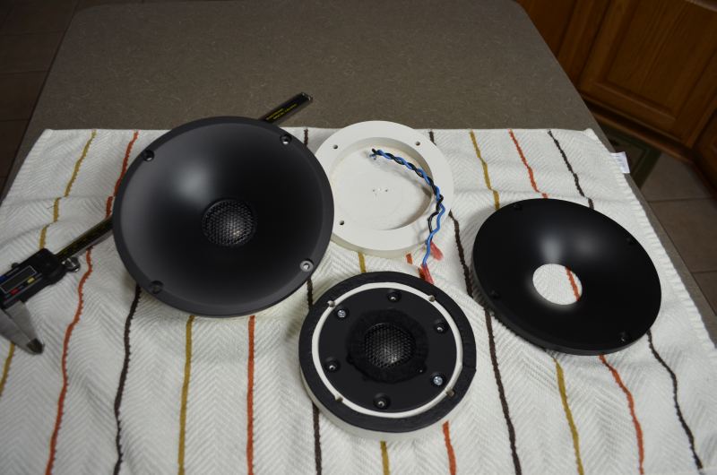

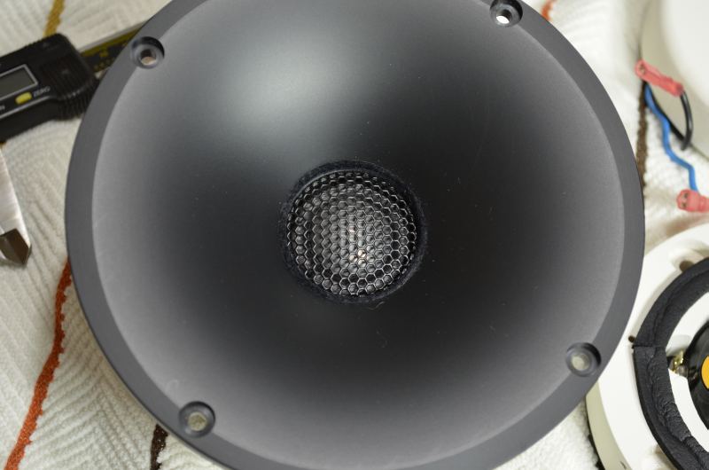

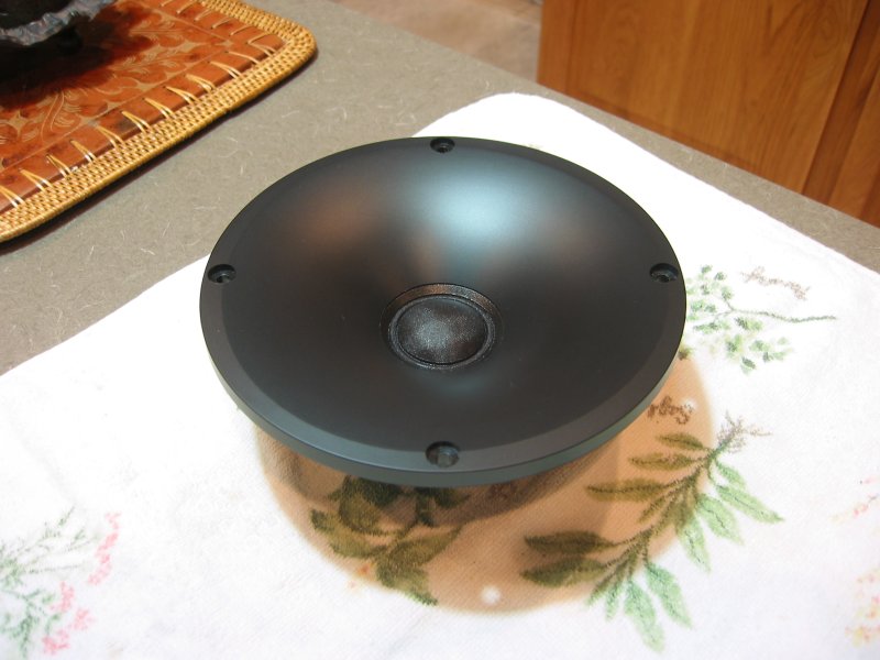

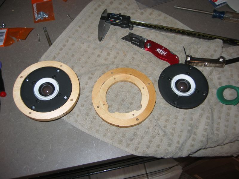

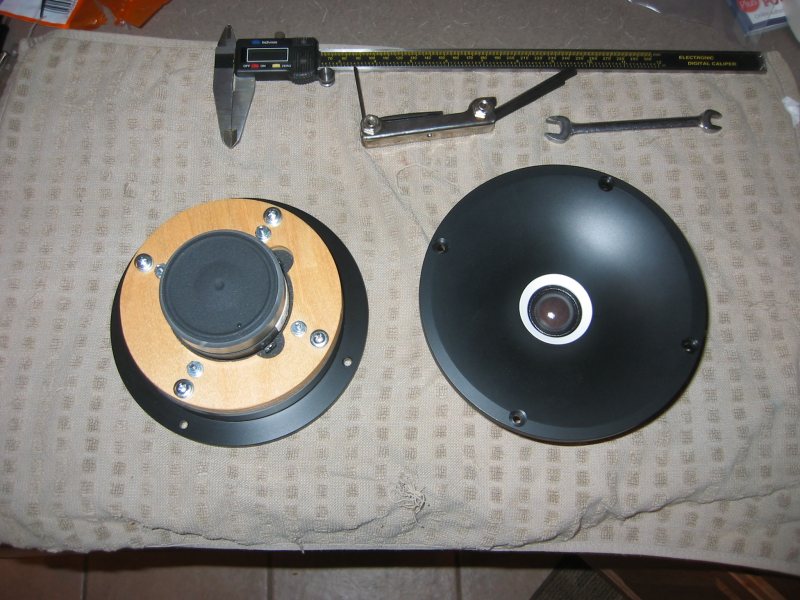

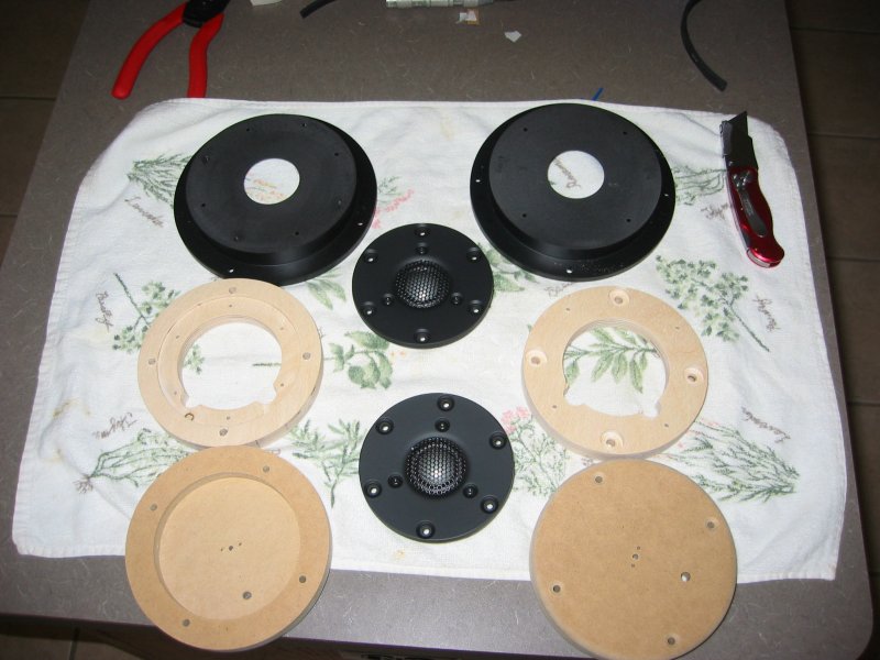

                                                            Jon, I've been meaning to post some info on some work in progress...not ready for prime time...but I wanted to share in case there is interest. I think I have OCD with waveguides lately Long story but I wanted to see how the Scanspeak Be would mate with the Jantzen WG.
                                                            I didn't realize the faceplate was so concave or else I may not have taken the plunge. Luckily this Felt had the perfect ID and thickness...how often does that happen? Well here's some teaser info.

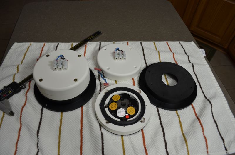

                                                            The tweeter sealing was suspect to me so I built a sealed rear cover.
                                                            Close up of the tweeter/WG

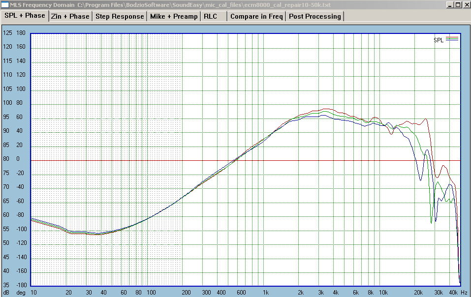

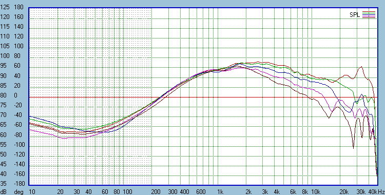

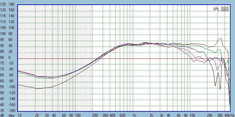

                                                            Standard Scanspeak Be on IEC baffle 0-15-30-45-60deg

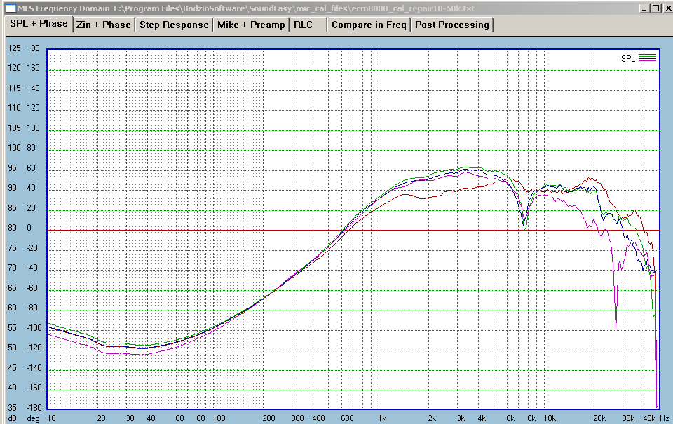

                                                            Scanspeak Be w/Jantzen WG on IEC baffle 0-15-30-45-60deg

                                                              Very interesting, and thanks for sharing! Now I've got ANOTHER option to ponder!
                                                              And what's interesting about what you've done here, is that I'd say it's the first really successful (based on measurements) implementation with a hard dome tweeter that measures well without some out of phase resonances really messing up something somewhere in the 10-14 kHz area.
                                                              Two piece clamshell rear cover- very nice! :T Did you just use a router to fabricate the pieces, for doing the hollowing out? Looks like the kind of thing that could be done on a lathe, but I don't have one.
                                                              Might be fairly effective with a 3000-3500 Hz crossover point....
                                                              Thanks again for the intriguing input and the link to the felt ring! :B :T
                                                              It doesn't hurt that I've got three pairs of the Jantzen waveguides on hand. And I still haven't gotten around to the Ciare MT320! Now if only I could find the dark lord to pitch in on some cabinet construction for testing, but he's been off in the old Imperial sector again on Sith business. It wouldn't be THAT hard to appropriate one of the small PE cabs I've got lying around and do a new front baffle for testing- I even have enough LBL around to go that route if desired.

                                                                Yes, I just used a router for the tweeter housing parts. Not too difficult but tedious. I also milled the waveguide base to make the transition smoother, it reduced some of the HF ripple. I think the original ID was 43.5mm mine is now 45mm.
                                                                I also purchased a Ciare MT320. It looked so promising but my results don't bare that out. I assumed if the Audax TW034 that Troels used works the MT320 being of similar profile would also work. The fit was very good as shown below.
                                                                I didn't go too far with testing because of the results but here the red curve is standard tweeter on IEC baffle, blue and green with Jantzen WG, IEC baffle, 0deg off axis and cyan 15deg off axis. I also discovered there is room for improvement with the rear chamber damping. The dome rests on a "pillow" of damping material. This didn't make sense to me as during compression (dome moving inward) would have a different force as when it moves outward. This sounds like a recipe for distortion. I measured with and without the dome pad and sure enough distortion was much lower w/o the dome pad. I can post result but I am already hijacking this thread...sorry.
                                                                One last thing. I also adapted the Jantzen WG to the D2608. I used a PVC reducer. The ID was perfect to the ID of the D2608 faceplate ID. I can show more detail if interested. Below in the finished pair...I said I became a little obsessed

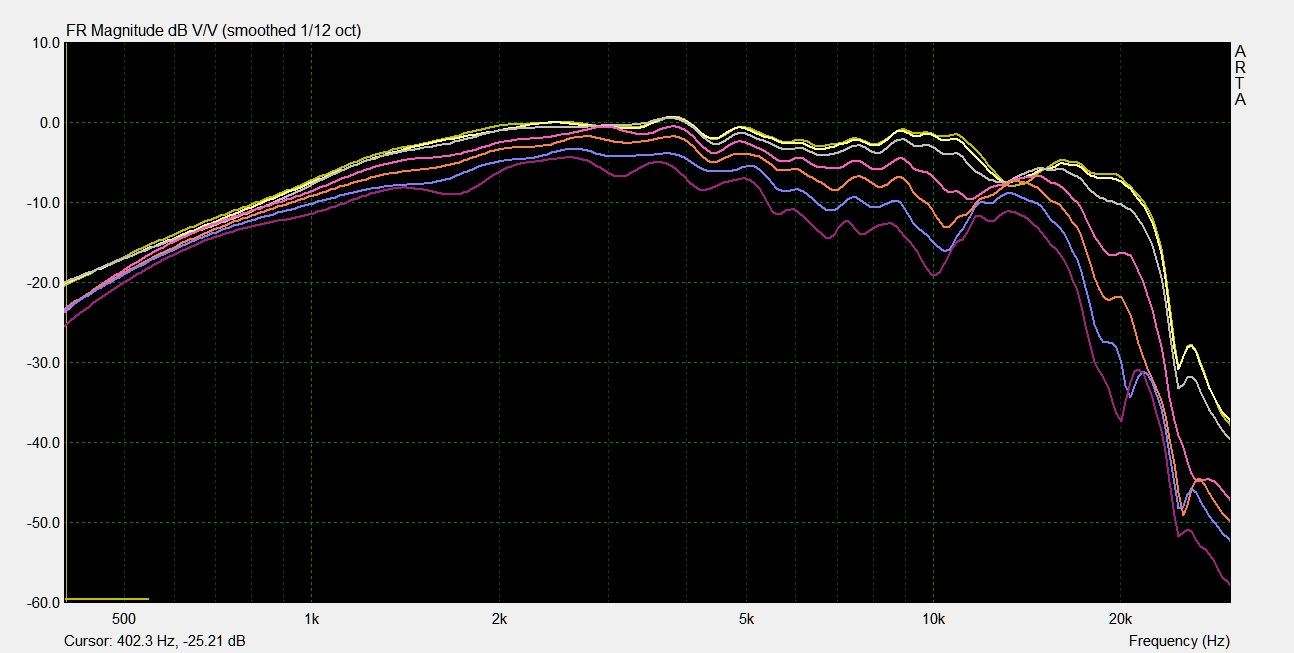

                                                                  Speaking as someone who is also very interested in wave-guides, I don't think Jon would consider it too off topic if some extra measurements were shown. After all you have just done the equivalent of whetting our appetites, it would seem a shame not to give us the main course!
                                                                  The response irregularities in the top octave, where the wave-guide somehow appears to lose its ability to control directivity, showing as a bunching up of the off axis plots to the on axis are of a concern. I've seen this with a number of tweeters I've attached to wave-guides, but not known how to go about sorting it out. It seems that you managed this quite successfully with the scan BE tweeter, with it perhaps showing some signs of it at around 19/20khz in the far off axis, but certainly better then what I've accomplished with the D2608 in a monacor wave-guide.
                                                                  The angles taken here weren't measured, but the trend is obvious and Jon's own measurements with the D2608 in the MCM wave-guide showed a similar thing - not quite as bad as mine show it, but the frequency at which it occurs is roughly the same too. What is it do you think that causes this?

                                                                      Yep, it's a DW621...here it is along with the obligatory bike pic.
                                                                      I had a little trouble with the D2608 in the MCM WG and Jantzen WG with the on axis HF wiggle (btw, the Jantzen an MCM produce essentially the same response). I tried every conceivable iteration from duplicating Jon's technique to many others. Below is typical. 0-15-30deg.
                                                                      To adapt the D2608 to the Jantzen WG, I milled the inner faceplate to create a flat surface, chamfered the ID of the flange end of a PVC reducer and milled to the correct height. Kind of hard to explain.
                                                                      Here the reducer is set up ready to chamfer the ID with a router chamfer bearing bit.
                                                                      Turned over and milled to height the adapter is ready to place as shown in the third pic.

                                                                        Yeah, this is what we call hard core DIY- your explanation makes sense to me.
                                                                        And between your DeWalt tools and the Ducati, your garage is certainly properly equipped! :W
                                                                        For me, creating a 3D model in Shark really helps with visualization and figuring out how to fabricate. Your efforts are definitely tenacious!
                                                                        Based on these inputs, in the spare time I don't have in the next month or two I'm going to have to try to do a SS Be waveguide build and cabinet test. I've got a few 22 liter PE cabinets in storage, and one setup for testing the Jantzen waveguide already, so I'm a bit of the way there already. I think some electronic prototyping will be in order before I put the revised Ardents back together.

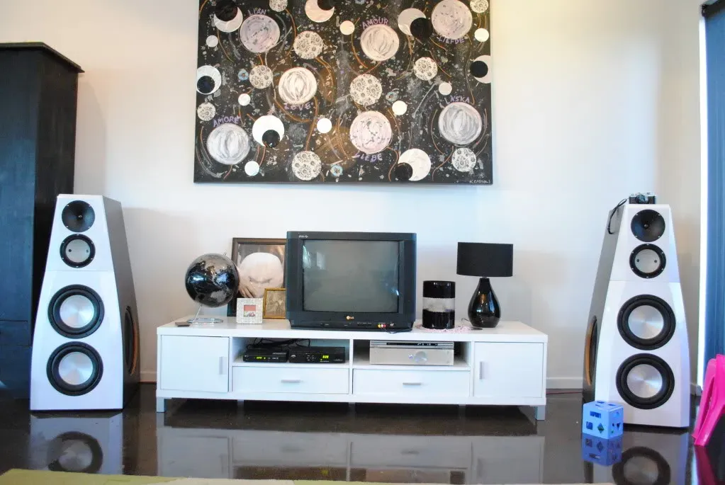

                                                                          Some pics of my version, finally done..
                                                                          • Beau
                                                                            • 74

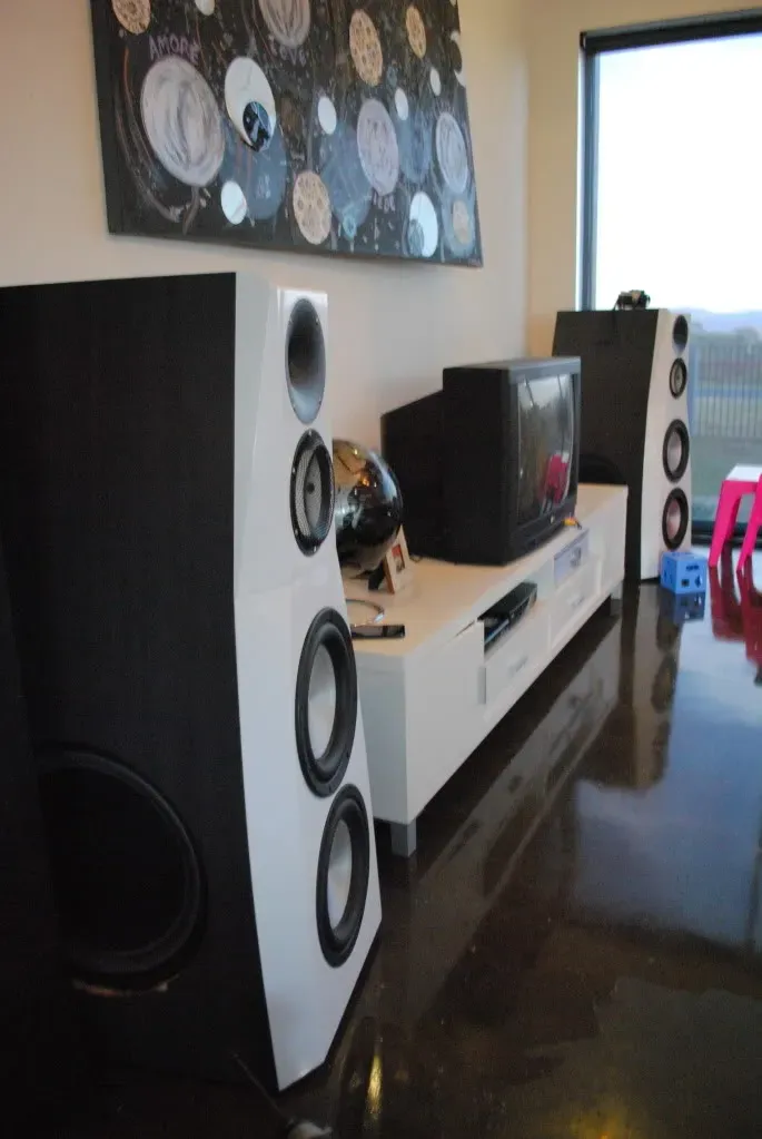

                                                                            #1342
                                                                            And another. ( note the custom bass trap in front)

                                                                              • 74
                                                                              #1343
                                                                              Last one..

                                                                                Cool, Beau! I bet you're mighty pleased to have these up and running! Though I think that custom bass trap is likely to get "blown away" in the breeze when you really fire those up! :T
                                                                                  #1345
                                                                                  Beautiful!
                                                                                    • 16120
                                                                                    #1346
                                                                                    Those are awesome!
                                                                                      Very interesting design. It has a lot of what I'm looking for in a pair of Uber-mains.
                                                                                      Are those 12" AE woofers wt the 15 passive radiators?
                                                                                      Is there a build thread for this design somewhere?
