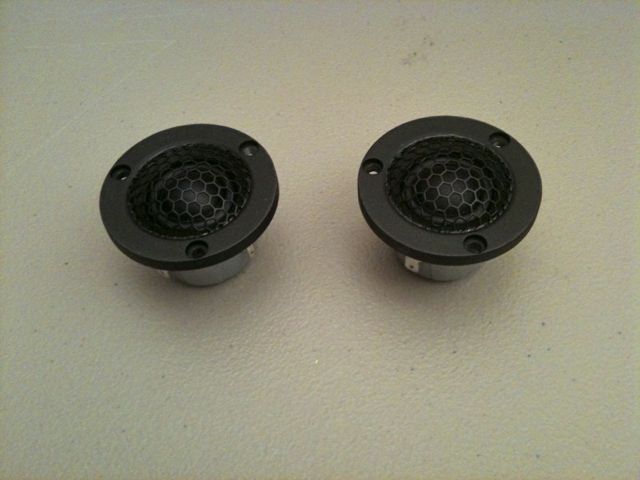

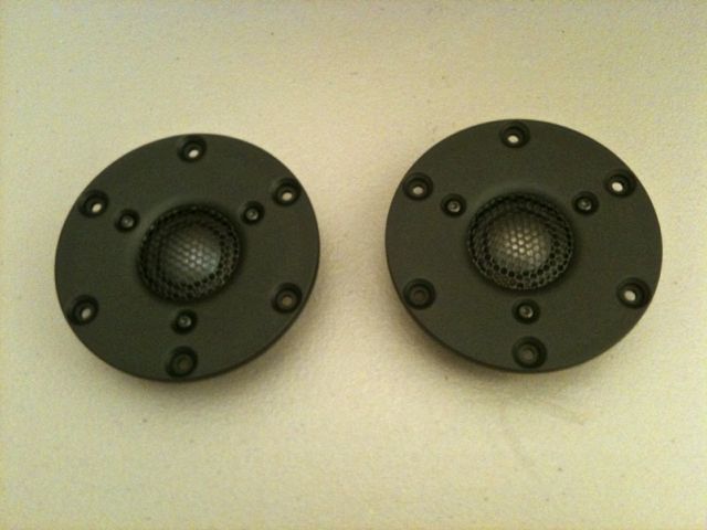

                                  new tweeters for the Ardents ordered this morning during a lull in the day- more more long meeting this afternoon, after a business lunch.
                                  I have followed this thread very closely and don't remember any new tweeters being discussed?
                                  something wrong with the aircirc? :E

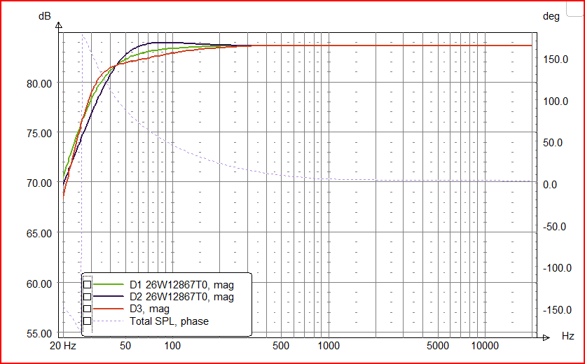

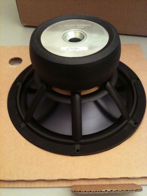

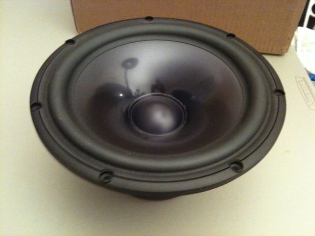

                                            It's one of the Madisound specials- 26W/12867T. It's not for the Ardent, but for another project I've been collecting pieces for.
                                            26w/12867t Image not available
                                            26W-12867T0-curve Image not availalbe
                                            It's a variant of the standard 26W with higher VC DCR and higher Q, about 0.49 (claimed), which looks like it will work in a low frequency alignment that's about as common as flying Deloreans - for the next big system, in order to make it smaller but still capable of the SPL response I want and with low distortion output in a moderate size box.
                                            Basically, we're combining a flux capacitor with the SS woofer to phase shift the current and alter the LF frequency response- you still can't break Hoffman's Iron law, but you can wiggle around in it in interesting ways, make tradeoffs.
                                            Let's say we put that 26W in a paltry 25 liter net volume (or two of them in 50 liters, as I plan).
                                            The result would be the black curve above, with a Q over 1, and a significant hump in the response centered in the 60 ~ 125 Hz area. Some folks really like that sound, I think they used to call that a JBL L100 back in the day (70's). However, I don't think I could live with it long term. :W
                                            However, if we put a flux capacitor in series with the woofer, one can tune the system LF response by the phase shift in the current and the impedance of the capacitor changing the drop across the woofer. The green and red curves show two possible alignments of interest- the green might be more suited to an open positioning well away from the walls, where the boundary lift comes in below 50 Hz; the red curve might be if you're close to the wall and need to lean out the midbass a few more dB; it comes with a little more very low end extension in the 30 Hz area, but drops faster below about 25 Hz. Same 25 liters as the other curves, only the flux capacitor tuning has changed. No, this isn't April Fools Day, it's the Christmas season. :roll:
                                            The concept is seeking good low end extension to the 30's in the smallest possible enclosure; the way this works, there's some inherent protection against overdriving the system at very low frequencies, something a ported system lacks. Output has a 3rd order fall off below ~35 Hz, not as steep as a ported 4th order, but steeper than a conventional sealed 2nd order.
                                            But, 25 liters instead of 75 liters or more for this 26W otherwise! That could make this next project a far more livable size and shape than what was originally conceived! With two of these 26W in the bottom end ( up to about 350/400 Hz), LF performance should be pretty respectable.
                                            And yeah, there's another lower cost implementation of this concept I'm chewing through for a different project that may pan out, using a more readily available driver. That one is tentatively named the BD Monitor- Baby Duelund Monitor, and yes, it will have my favorite dome midrange, the RS52.
                                            Last edited by theSven; 15 May 2023, 08:56 Monday. Reason: Update imaqge and remove broken image links

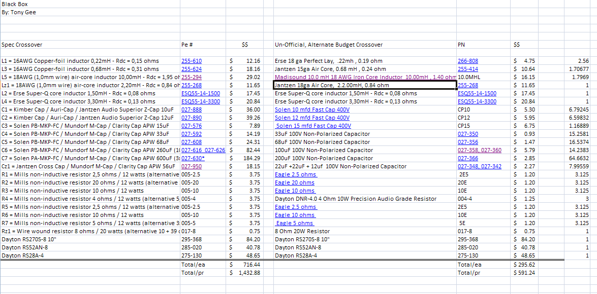

                                                          Looks to be a similar concept Tony Gee uses in his Black Box monitors. The woofer is the Dayton RS270 and he also use the RS52 as mid. The design looks interesting but the crossover is VERY expensive... Lots of big caps... :E
                                                          Very high quality loudspeaker kits, components, upgrades, modifications and custom solutions. Humble Homemade Hifi - the one stop loudspeaker shop.
                                                          Click image for larger version  Name:	blackbox-speaker.png Views:	2 Size:	149.9 KB ID:	936534
                                                          That certainly follows ET's motto....
                                                          There is more money in that one 600 uF cap (3x200uF) than in all the drivers 8O

                                                            This should be in a different thread. I'm in the process of looking for the one someone started, but since it is here and people may be interested...
                                                            I've looked at those. Very interesting. People talk about the cost. I had time to waste this afternoon, so I just finished putting a BOM together for it. I did both Tony's exact BOM, and an alternate. My unofficial budget alternate:
                                                            1) Replaces foil inductors with air cores with very similar DCR.
                                                            2) Replaces 1 air-core with an iron core.
                                                            3) Replaces all fancy caps with Solen Fast Caps
                                                            4) Replaces Solen Fast Caps with electrolytic capacitors.
                                                            5) Replace Mills resistors w/ Eagle.
                                                            Doing this gets the price down from $1,432/pr to a respectable $591. It gets the price for the drivers down to $344 and the crossover to $247/pr. Seems very reasonable. Now I wish I had an excuse to build them....
                                                                That's just silly, when for LF applications you can get things done with Dayton 100uF caps just fine...
                                                                  #932
                                                                  True, but Tony only spec 3x200 Solen Fast Caps $184 total. 6x 100 uF Dayton Poly Caps is $138. Tony was trying to be reasonable.

                                                                      Tony's execution (or hired execution) is pretty interesting, but the crossover looks over the top even to me, though leaving out some things that shouldn't be left out - like Midrange LCR zobel!
                                                                      I think this concept has some room in it, and the RS270 is one of the drivers I planned to analyze for this concept. There are other scanspeaks that would work, too.
                                                                      Nice work Ryan, but let's see if we can split the difference in a creative way during the next couple of weeks? I hope no one minds if I use a different tweeter... :W
                                                                      All in favor of a completely re-worked design with NeoD CC crossover and a reasonable budget, raise your hand and say "Aye".

                                                                            Warning! Cellphone Speaker Porn!
                                                                            It's fresh- it's hot! It's blurry!

                                                                            I'ts the Scan Speak channel!
                                                                            If you'd told me a year ago I'd be spending this kind of money on Scan Speak drivers, I'd have thought you were crazy...

                                                                              I'm really curious on how the Be air circ performs. But I suspect more than one person is, as well.
                                                                              I bought one of the tiny tweets when the Mk2 was first mooted, so I'm covered for my next CC, unless it doesn't prove out. If it doesn't, then it will go nicely with some 15cm SEAS woofers that I've got.

                                                                                #939
                                                                                Hey, I have a good feeling about these little guys- I held my Macbook air up to my head with all the Madiosound graphs displayed, and it just felt right... sort of like Doc's mind reading apparatus in the first movie!
                                                                                It's a 3/4" so the off axis should be good (never trust SS measurements or T/S parameters fully!), and the Xmax is pretty righteous, so for the range they need to cover, should be good to go- all they have to do is beat out the Vifa D26NC55, how hard can that be!??!??!!? yeah, we know how hard from all the other tweeters that don't manage to do that. Got about 5 of those left in NOS.
                                                                                Obviously, I could spend 24 hours a day the next two weeks working on this stuff...
