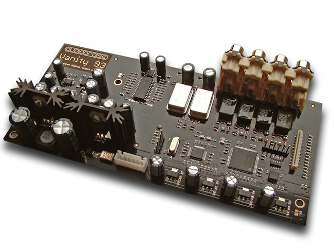

                      In other interesting developments, while over here it occurred to me to check the AudioPraise site and see about posting on their forum as promised- i wasn't able to complete the forum registration (I don't think it's automated), but did discover a very interesting new product from them, the Vanity93 board, which fits in an Oppo BD93, replacing the analog output board, and instead giving 8 channels of PCM output, including the conversion of DSD to either 88.2 or 176.4 kHz at either 16 or 24 bits. It's plug and play, no soldering or wiring, and has options for combining on the board, mixing down multiple DSD channels to a stereo pair. Well, that's interesting enough that I ordered an Oppo BD93 from Amazon today, should have it by Wednesday; if that comes through, I'll order the Vanity93 board next. If I read the material correctly, it will also output multi-channel PCM in S/PDIF format, which could be fed to a multi-channel DAC like my Metric Halo LIO-8. This could be very interesting... I'll report more if I can get this working. And as with the earlier Vanity board conversion, I should be able to "record" converted DSD to my Mac Pro through my RME Fireface.
