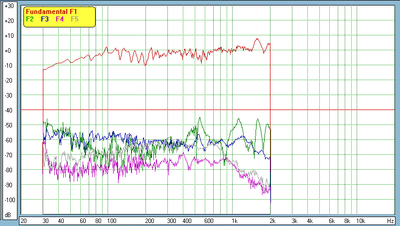

    Brandon's HD measurement of the TD15X on his large open baffle. The level is set to 100dB at 30" and then the mic moved in to 15" for the measurement.
    The way I understand it, the H, S and X series all have the same motor except different voice coils to get the TS parameters. The M series has a short underhung motor and an accordian surround to eliminate a midrange surround resonance. It's excellent above 70-80Hz but not so good down really low.

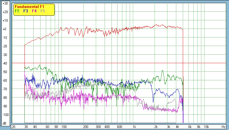

    Edit: here's the TD12M.

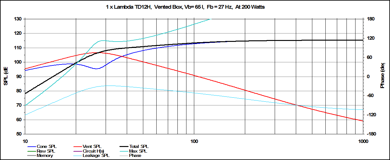

                        Here is a look at the Lambda TD12H in Woofer Box and Circuit Designer v4.31, using their published specs. I tried to approximate the kind of tuning you use and your numbers for Qa, Ql and Qp. The cabinet is up to 65 liters here. Shown is an input of 200w, netting about 116db.
                        Edit: I forgot to mention before, that in addition to the standard models, they also offer an "Apollo" upgrade which adds 2 more aluminum faraday rings
                        outsid the voice coil. I don't know what the upgrade cost for that option is.
