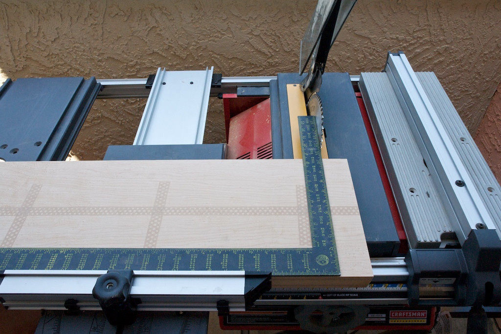

            Just to show sawdust has been made
            Bevel cross cuts on the various front panel pieces, including the veneered front pieces, shown here, "lining up the shot".

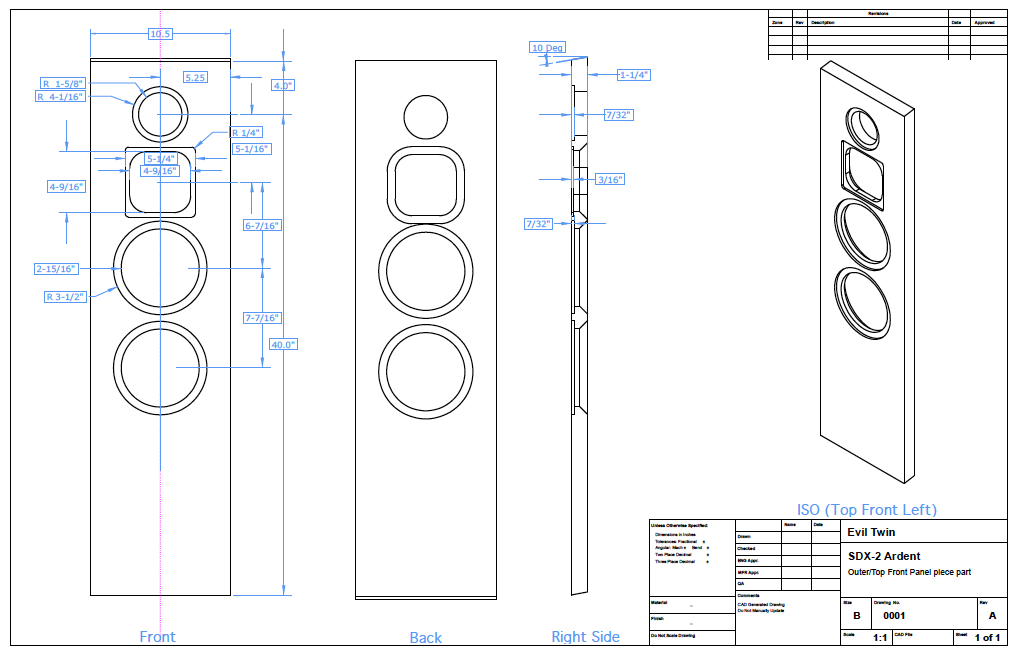

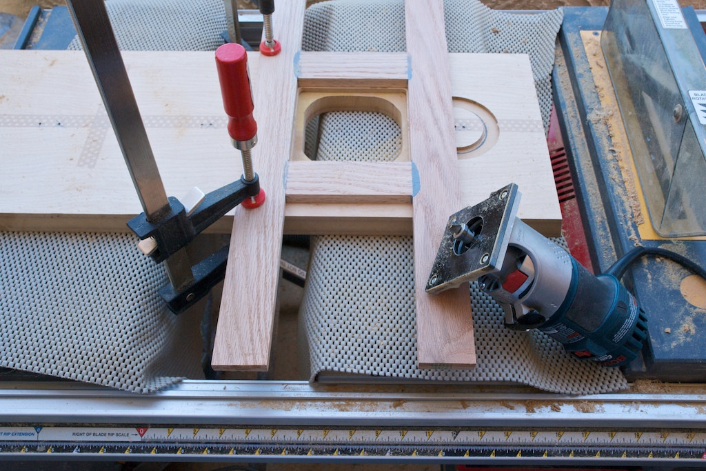

                  Jigs and front panel work
                  Just a teaser, spent more time fine tuning the front panel jigs and setting up routers, but today I expect to be on a roll finishing the cutting.
                  Here you can see the jig for the midrange front panel rebate- yes, the C79 slips in there nicely flush, just like factory. :B
                  That bit comes with a Porter-Cable 59370 door hinge template set; you can buy it separately as a replacement part, but it's harder to find and costs about the same as the complete kit. I have only recently found a bit that may be short enough, (1/2" cutting length), but I'm set up with this for now, and with just a few cuts to make, good to go.

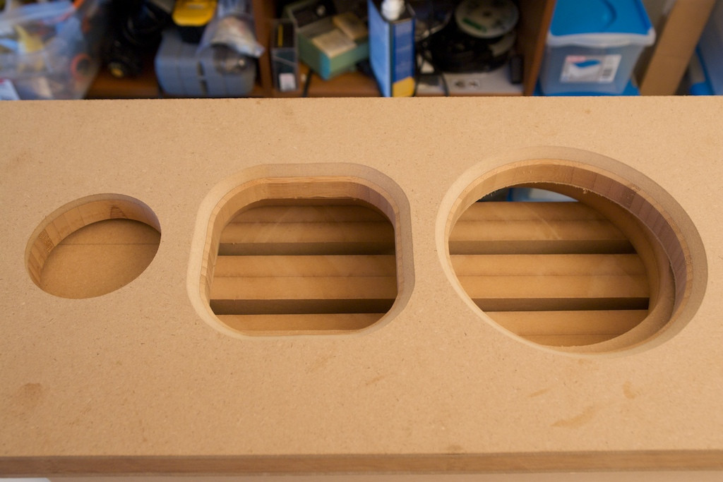

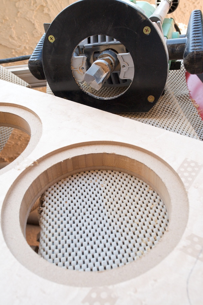

                                  Today's action pics for the Padawan's who crave excitement and adventure:
                                  The Whiteside pattern bit is used to clean up the bottom of the midwoofer holes after the main part is cut out with a spiral upcut bit and saber saw.
                                  The LBL core for the outer front panel has an interesting texture, as seen here in the prepared tweeter opening; it is quite hard and dense, not hard to see why Jim Salk and some others are doing enclosure work with it; but it seems to machine nicely, at least with sharp tools.

                                            What's the cutting length and diameter on that pattern bit? Looks quite manly.
                                              • 16207
                                              #112
                                              Oh, it is a manly bit, for professional idiot at work on a closed course, do not attempt this at home. :W
                                              It's a Whiteside 1-1/8" OD bearing 1-1/2" cutting length pattern bit. Yeah, it costs more than any of the drivers in the "cheap" version of this project. 8O
                                              Does a great job cleaning out rough holes with a good pattern guide. Indispensable for this project, IMO.
                                              A real Evil Twin sort of tool- I make him do all the work requiring that- requires good Force sense and steady nerves.
                                              It's good being Supreme Chancellor and being able to delegate. :lol:

                                                  That looks like a MLCS roundover bit- I have some MLCS 1-1/2" roundover bits I bought for a line array project I never built- now I may use them in an experimental port design, if I can make a good golden mean ellipsoid pattern. The trick that works for me is to just take a bit off at a time, and to keep the speed down.
                                                  I've got a Freud table, too, with a Bosch router and WoodPecker Quick-Lift for the bigger jobs and panel rabbiting.

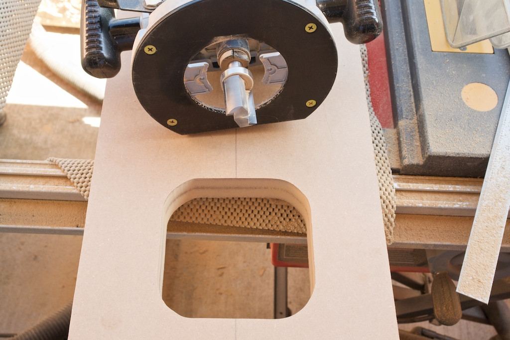

                                                  This is another part of the Ardent work that the Whiteside rules- cleaningup the front sub panel midrange hole after I've done my worst with spiral up cut bit and jig saw! :W

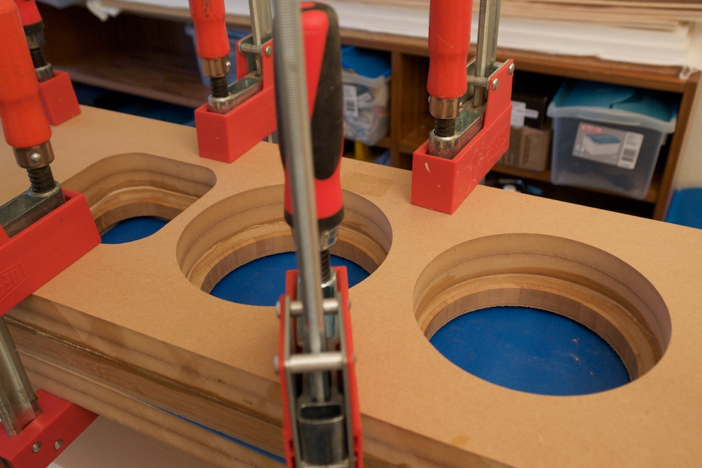

                                                              Yesterday I finished up a set of the inner mid front panel plates, and the "prime" outer front panels (for the Seas ER18RNX/Accuton CZ79-6/SS3004/662001); here's the backside of the outer front panels after chamfering.
                                                              Click image for larger versionName:	Ardent-FP-Reverse.jpgViews:	0Size:	136.9 KBID:	936512
                                                              Here's one of the prime outer front panels being glued to an inner panel, using another front sub panel as a clamping jig to protect the veneer on the outer front panel; this assembly will next go through the facet cutting process, which is why I also built the facet cutting jig yesterday.
                                                              Click image for larger versionName:	Ardent-FP-MidP-Close.jpgViews:	0Size:	155.8 KBID:	936513
                                                              Facet Jig plan:

                                                                            Facet Jig plan:
                                                                            Click image for larger version  Name:	FacetJigPrint.png Views:	5036 Size:	58.7 KB ID:	853372
                                                                            HEY...... that jig looks vaguely familiar!! :rofl:
