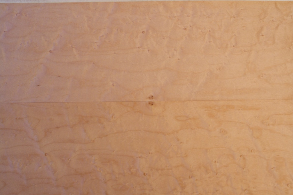

            Jon, do you plan to match the grain of the facets to the front? I'd like to bookmatch the front as you are doing. If I also match the grain of the facets to the bookmatched front, I'll have to order wider pieces (which is not a big deal). There's also the question of what to do with the top (horizontal) facet. Would you book match that as well, carrying over the pieces from the front?
            Also, when you routed the veneer to do the bookmatching, how did you assure they would line up with them laying back to back? Did you do anything to make sure they didn't shift?
              • 16077
              #141
              Howdy Paul,
              I've been using veneer packs from Sauers and Company, sourced through Woodcraft (you can order from them direct, but my local Woodcraft stocks a lot of the maple in 48" long packs, and the sheets in each pack are sequence matched. With the variation you get in Birdseye, which I'm using for the front panel, I found I needed to use adjacent pieces. When I open a pack, first thing I do is number the pieces and assign a letter for the pack, so I don't get things mixed up. So, my center front sections were done (as explained somewhat, further back in this post) bookmatched, and trimmed together as if folded back like a piece of paper- that is, one of the sheets is flipped over (usually the odd number, say #1), then the matching section for symmetry is against the Forum sheet, and checked. They should be VERY close, as the cut is on the seem between the two sheets.
              Then I put them with the center adjacent and sticking out a tiny bit between two melamine sheets, and trim with a router to get a really flat smooth seam. Rarely is this seam good enough from the factory.

              Notice I do use veneer tape to tie the veneer together and prevent shifting or pulling apart. (see earlier parts of this thread).
              Then I clamped it up using Titebond cold press veneer and front sub panels as pressure fixtures.
              The results on four front panel boards have been fine, so far.
              Of course, what I'm doing this time is integrating the veneering into parts of the construction process; doing it after the fact is trickier, but similar in concept.
              For the facets, I have some figured maple I plan to use mirror imaged; and the center facet will be mirror imaged also from that material. I have an idea about how to manage the clamping, but I don't want to talk about it until I've tried it out and see if it works.

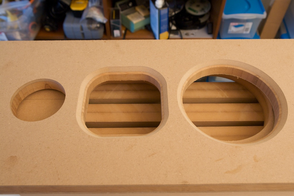

                                          Jon, your baffles appear to be ~4" think. I know I've read places that the driver needs to "breathe" and the inside needs to be, or should be, chamfered. This is on baffles much less think than yours, usually 3/4". Is this a myth, or does the benefit of the mass of your baffle and the shape of it outweigh the benefits of having the drivers able to "breathe"?
                                          Sharp LC-42D64U
                                          TriTrix MTM (Sealed)
                                            • 16077
                                            #156
                                            A cross section would make this clearer- the front panel is is made from three major sub pieces, and the front one is rear chamfered and the rear openings are enlarged in diameter, the middle and back sections follow suit. Here's a back side view of the top front panel section.
                                            When all the drawings are finished including cross section sheet prints, some of this will be more obvious- this was particularly taken into account with the Accuton C79. The rear opening is similarly increased for the ER18RNX, which has less rear masking. For the RS100 version, it will be mounted in a aluminum plate of the same size as the C79.
