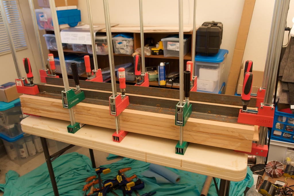

                And clamping a top front sub panel set between the two rear subpanels (used to distribute the clamping force) will satiate your need for vicarious living...

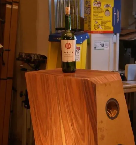

                                            I bought a case of that wine and still have some left....perhaps I should send some back out to California for camp refreshments!
                                            I really gotta, gotta, GOTTA have a bottle of that for the promotional pictures.... :W
                                                    :rofl:
                                                    Consider it done..............

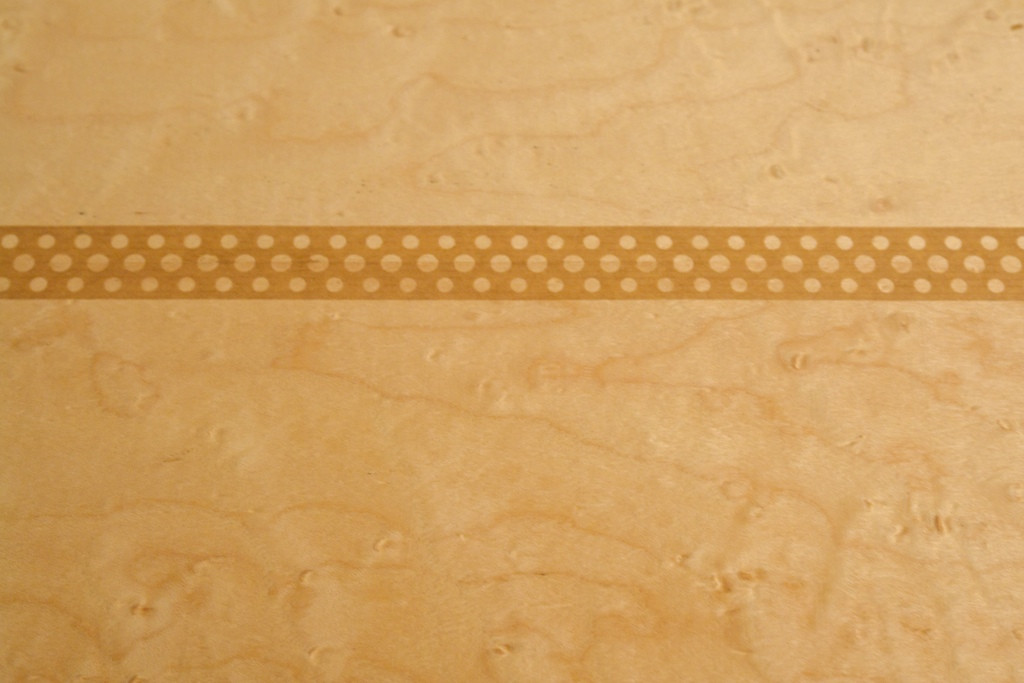

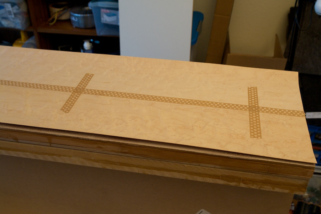

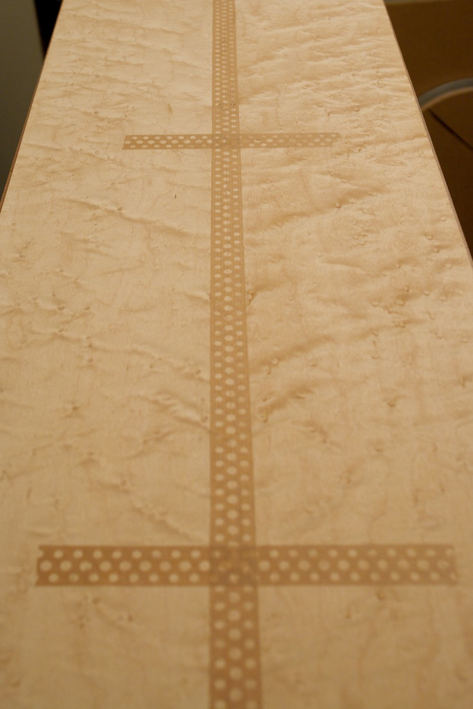

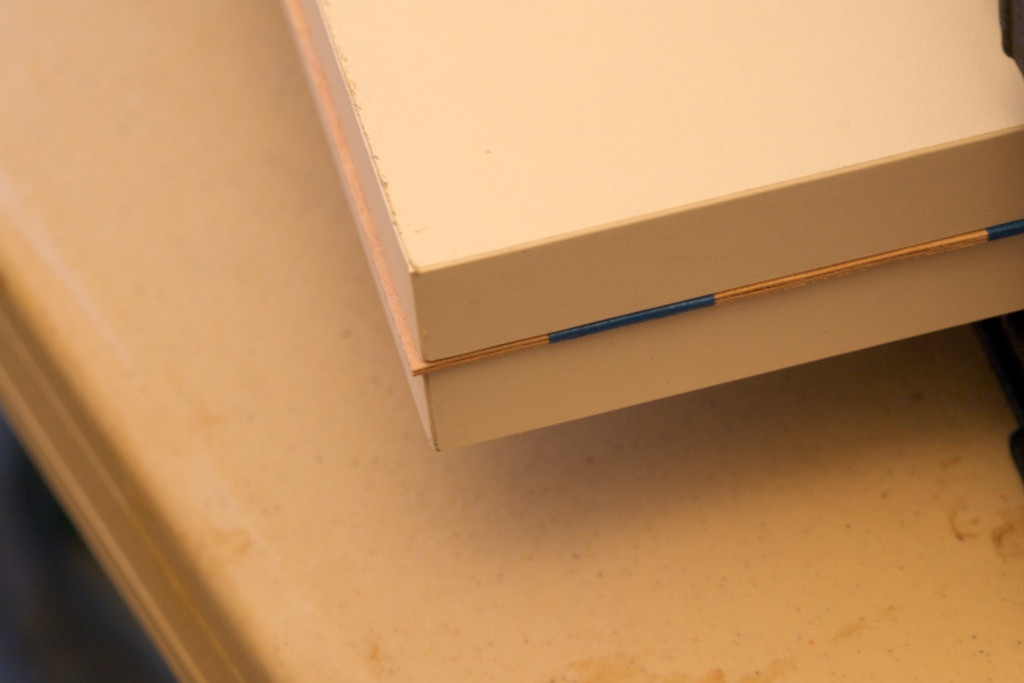

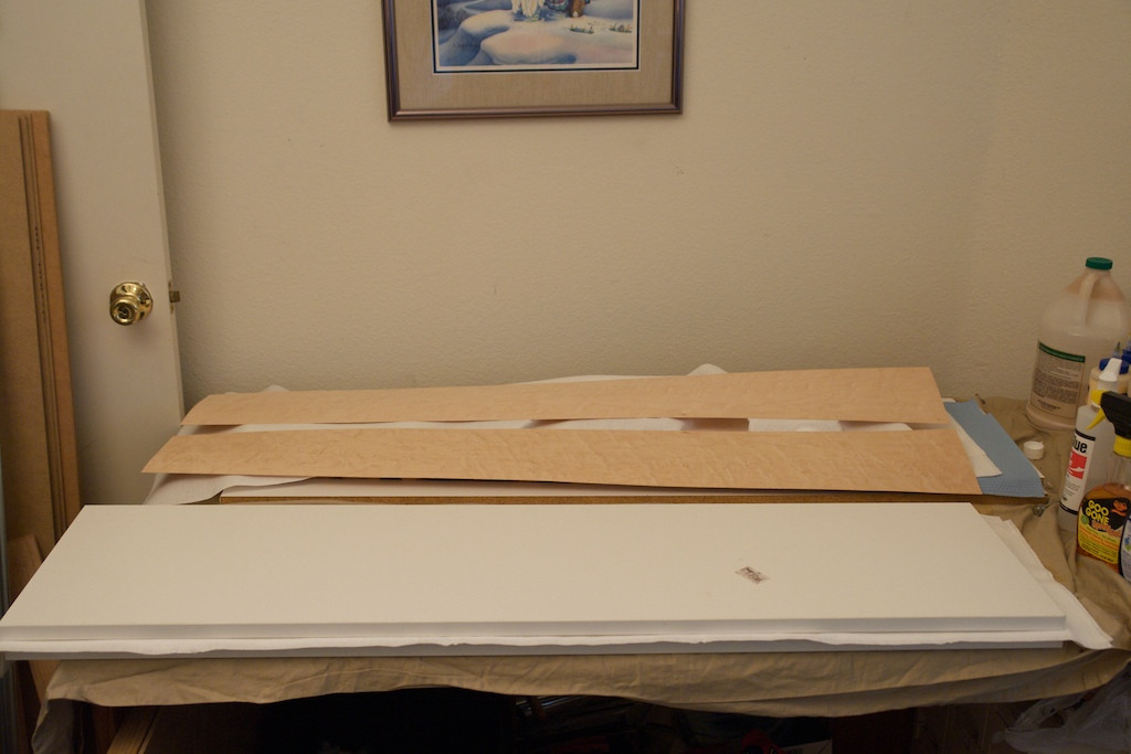

                                                              Critical Process test completed on Front Panel sub assembly
                                                              A process development milestone was complete at 3 AM this morning. The results were quite satisfactory, meeting all expectations- even the Supreme Chancellor is nodding quietly in approval, with a dark glint in his eyes.
                                                              This step was the first veneering of a sub-assembly which becomes part of the front panel.
                                                              The birdseye maple is chosen with a vertical seam book match symmetry, which requires a precision trim on the joining pieces.
                                                              The veneer is sandwiched between two fixture boards...

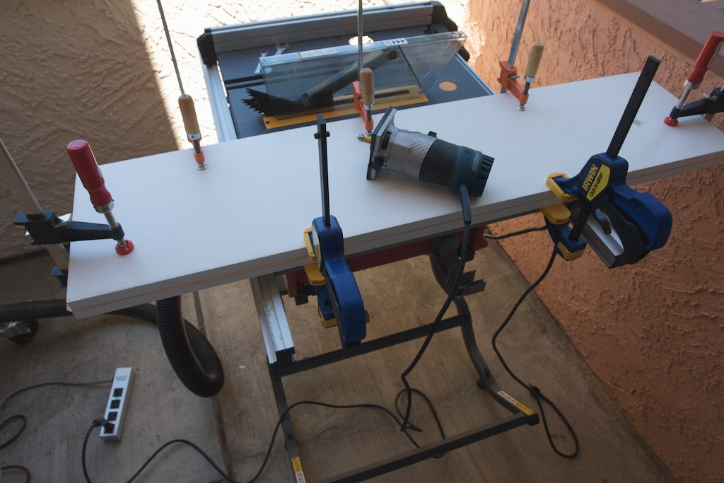

                                                              with a few mm exposed along the length;
                                                              The veneer is trimmed using a climbing cut edge trim with a variable speed router, in this case a Bosch Colt, set for "4" on the speed dial.
                                                              This produces a very clean cut in the veneer material with little tear out even with very close examination.

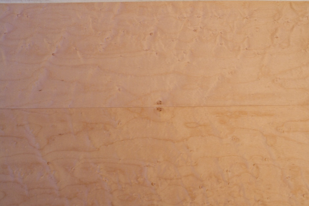

                                                              The veneer must be taped up using standard procedures with veneer tape to bind the seam and some cross pieces to aid in holding it together while handling for placement on the glue prepared substrate.

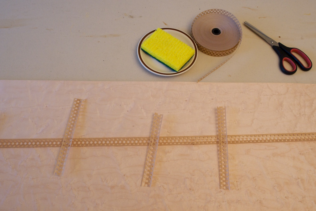

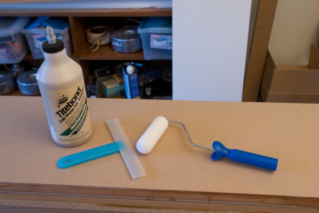

                                                              Spreading the correct thickness of glue is critical; usage of a high density foam roller simplifies getting a finished glue thickness about like that one good coat of latex paint- a pencil mark on the veneer below should be just visible through the translucent glue.

                                                              Here, the taped veneer sheet has been laid on the prepped front panel sub-assembly board.
                                                              After removal from the carbonite enhanced clamping assembly, the results are fully as expected,
                                                              ...and speak for themselves, within the limits of this crude photography and transmission system on your primitive portion of the Holonet.

                                                                Looking excellent so far. You have luck using un-backed veneer with the PVA glue process (hot, I presume? Or do you set this wet?)

                                                                  This new effort is a cold press process with Sauers and Company unbacked veneer- component sub assemblies are used as clamping jigs to reduce expense. So far, the results seem satisfactory and appear that it will fit the planned fabrication flow.

                                                                        Veneering is a complicated and sometimes controversial topic, as there are many techniques and advocates for those techniques and adhesives.
                                                                        I've used the hot iron/PVA reactivation method with good results in the past, mostly with paper backed veneer.
                                                                        For this project, with the selection and type of veneers available and the look I wanted, there was no substitute for solid wood veneer. There are numerous techniques people use with it, including hot iron, (more difficult IMO because of the lack of the backing to stabilize it, and the thicker wood), cold press, and vacuum bag press, with many types of glue, such as traditional PVA glues, or urea resins such as Unibond 800.
                                                                        The most important point is probably to research any given technique you're considering thoroughly, and be a bit anal/OCD about the implementation, if you're looking for pleasing results.
                                                                        I've been to several DIY's where the majority of hobbyist veneered cabinets were disasters- not even adhered flat. There are many ways to screw it up, fewer ways to do a good job- but especially these days, there are so many useful resources to research online, it shouldn't be hard to figure out a way that you think is manageable.
                                                                        We'll describe what is done with this project in detail (assuming it all works!) on the web site being developed- this is not a "build thread", and I don't plan to do a "build" thread- it is too clumsy and awkward a way to put together this level of information.
