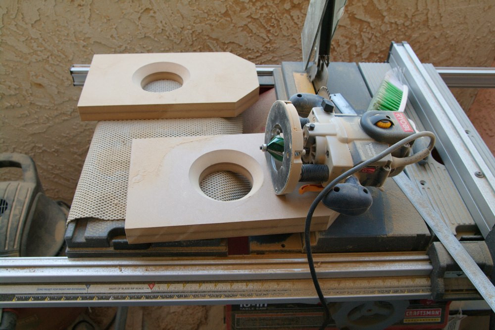

                                            Been making a fair amount of that this weekend...
                                            Sawdust CGI courtesy of Lucasarts, Chuck!
                                            Yes, it is especially nice to see some sawdust on the router. Nice touch!
                                            • JoshK
                                              • 748

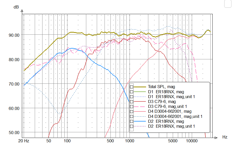

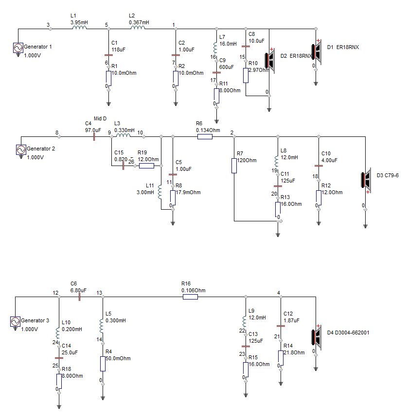

                                                                                  A little more measurement work done, a little more design work.
                                                                                  One more pass this weekend, then time to order parts.

                                                                                  What I forgot to copy was the impedance curve, which looks more like an interstate highway than a mountain road. :W

                                                                                    L7, L8, and L9 will set you back a few sheckels, eh? And C9 is no slouch either.

                                                                                      The zobel coils can be really high DCR- I have to admit I'll probably go back and double check all values, but LspCAD doesn't lie about what it takes to make good conjugate networks, unfortunately. Tweeters with really low Fs are both a blessing and a pain. :W L7 is just two 8 mH 18 or 20 AWG coils in series- not that bad cost wise. The last iteration of C9 was 1,000 uF- using the 10% Dayton's, it's not too bad- the cheap seats will use NP electrolytics, I guess. I'll post the Z curve later today...
                                                                                      I have the feeling this is all "gelling", if you know what I mean. You've got email on a related topic.
                                                                                          Would you adjust the 'R' in the LCR circuit to compensate for a high DCR in the inductor? Got the email. Thanks.
                                                                                            Oh, very definitely I would- so if the coil has a DCR of two ohms, and there's two in parallel, and the target total R was 8 ohms, for example, I'd only use 4 ohms in the resistor. LF zobels like this can see some significant power, too, so we won't be using wimpy little 10 watt resistors... :W
