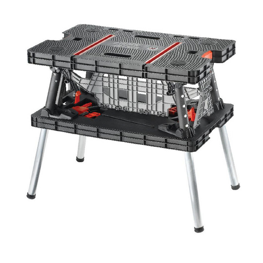

                                    Scored a couple of Black and Decker portable clamping workstations today, which can also serve as Ardent assembly and finishing stations! Had to drive to Fremont to get these. Should also be useful in another upcoming project.

                                      #468
                                      And no pictures?
                                        • 16125
                                        #469
                                        Sorry- the pictures were in progress before I saw your post... just web pictures, no time to unpack, business travel tomorrow, and special project work for the Chancellor this afternoon...
                                        Plastic fantastic, but folds up small, supports plenty of weight, adaptable to many tasks... too complex for the average maroon, so I think they're closing these out. That's why I bought two. :W
                                        You, it's like for me, all the intriguing TV shows get cancelled because they don't generate market share with the masses.
                                          • 16128
                                          #470
                                          Those are nifty looking.
                                            #471
                                            One could even say there's a certain imperial technology characteristic to the design... including a sufficient amount of black...

                                                How do they work? I've been eyeing the "Jawhorse". But at $179, it seems a bit steep for what it is.

                                                  The B&D Clamping table comes with clamps that can be used built in; that wasn't the main draw for me- what I particularly liked was it's relatively low height (which many people might not like) so that you can put a tall cabinet on it and work on it at a more comfortable height than a normal table. It's rated for 400 lb- let's see if it handles 125 lb OK.

                                                                  Hoo Rahh!
                                                                  Jon - These are only showing as being at Lowe's on B&D's website. Where'd you snag yours? I've got three weeks off, and getting the garage cleaned out and the shop set-up is towards the top of my to-do list.
                                                                    • 16125
                                                                    #483
                                                                    I had to drive to a Lowe's 20 miles away- that's where I got them! The three nearby were all out.
