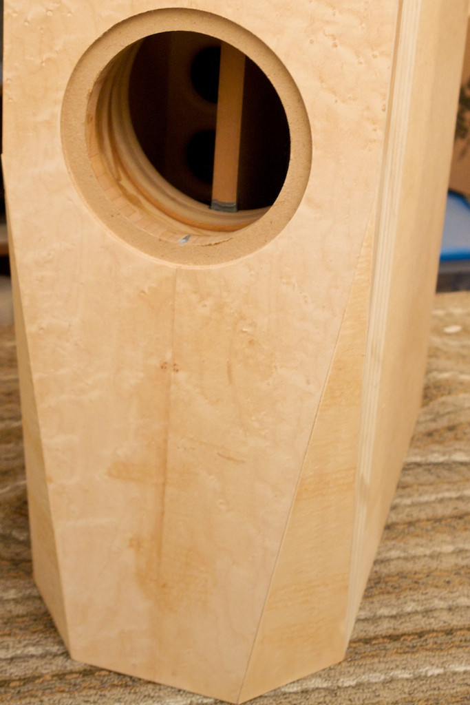

                                                    Various little bits of work going on, rather work than post, but this shows the lower facets on one speaker. I'm modifying the method to do just one facet at a time, as doing both at once (as on this one) is REALLY tricky with only one pair of hands! Live and learn...
                                                    I'm not likely to get hired as a wood worker at Avalon, but I think this will do for now. :W

                                                      Very nice drill guide! The veneering ain't too shabby, either. I look forward to hearing the methods you work out for trimming and adhesion.
