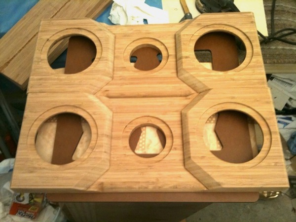

                      No, the LBL came from my local (well, 30 miles!) Rockler store. And they carry it as a store special- it's not from corporate, they order it from a local specialty place because of the demand.
                      As to the MDF, you might be surprised- as a test, and to make something for my weird home made veneering process, I glued up some 3/4" MDF with 1/4" on just one side- I wanted to see if could make some slightly bowed pieces that could be used as veneer clamps for the sides and put more pressure on the center- worked like a charm.
                      Of course, I've set to see if my unorthodox veneer clamp for the sides will work, but I may know by this weekend.

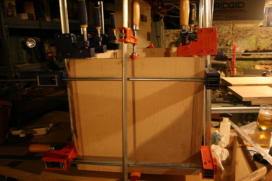

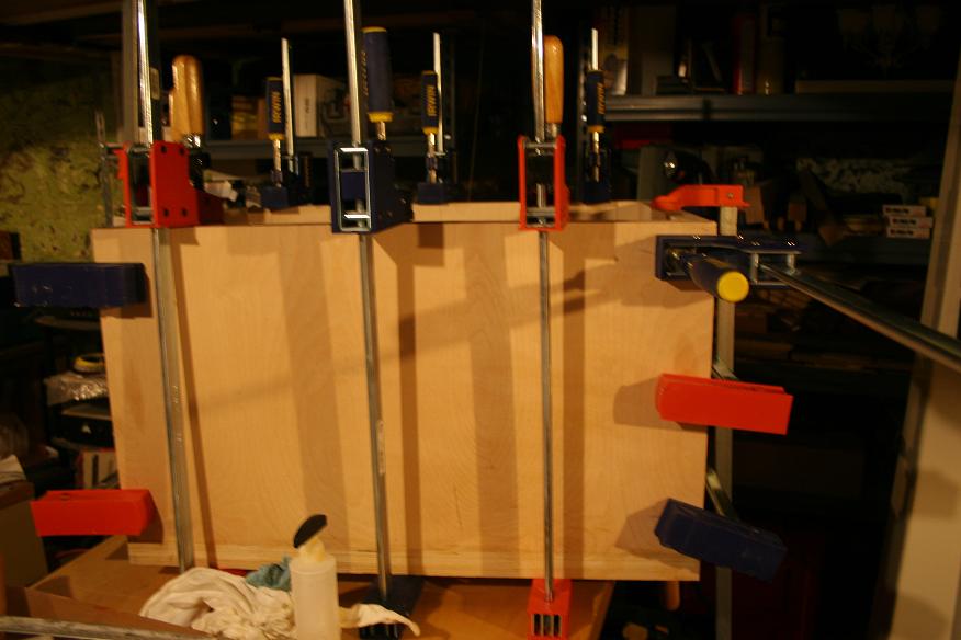

                          My attempt at given Jon a run for his clamp money.

                            Looking good, Josh! :T
                            You're obviously a man after my own heart! :B

                                  I'm using it embedded in the first front panel layer of the Ardent; it's what the drivers actually bolt down into. It's expensive, but not as expensive as phenolic or aluminum sheet.
                                  After I already found this and bought it for the Ardents, I read about Jim Salk introducing a high end speaker at AK Fest using trans laminated bamboo sheets. I shudder to think what just the BOM for the cabinet is!!

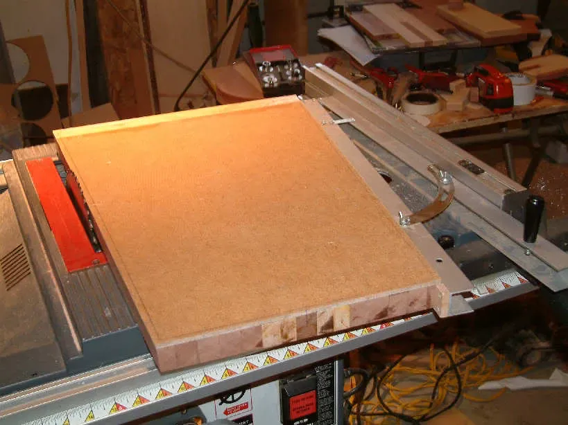

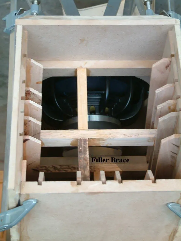

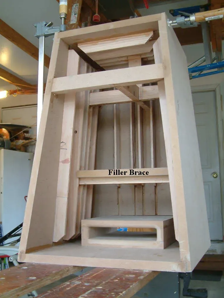

                                                                                        I did the bass bin baffles for my BaSSlines out of 3/4" wide by 1-1/4" thick laminated hardwood, makore and hickory, backed by 1/4" HDF. They are very solid and pretty vibration free. The driver is also press supported along the back of the magnet with the bracing structure (see filler brace) which ties it to the rest of the box. BTW, hickory is extremely hard!
                                                                                        In fact, the ribbed box construction with cross bracing is probably the deadest box I've built as well. A couple more side to side to back and ties from between the braces vertically were added after the photo below was taken. Other than the MDF cross brace across the front behind the baffle (I ran out of oak) all the rest of the bracing is oak. Besides reinforcing the stiffness of the 3/4" MDF sides, the oak ribs give considerably more surface for the side to side bracing to be glued to, rather than just the end of the brace to the all. This bracing structure uses less volume of space, I believe I calculated around 25%, than the typical window bracing and should weigh less as well. These boxes (without the hardwood baffles!) are surprisingly light.
                                                                                        Bass Bin Baffle construction
                                                                                        Ribbed box construction
                                                                                        Click image for larger version  Name:	DSCF0144.webp Views:	4 Size:	50.7 KB ID:	936518
                                                                                        Click image for larger version  Name:	DSCF0144a.webp Views:	4 Size:	41.1 KB ID:	936519
                                                                                        Click image for larger version  Name:	DSCF0226.webp Views:	4 Size:	55.4 KB ID:	936520
                                                                                        Click image for larger version  Name:	DSCF0254-1.webp Views:	4 Size:	36.5 KB ID:	936521
                                                                                        Click image for larger version  Name:	DSCF0258.webp Views:	4 Size:	36.7 KB ID:	936522
