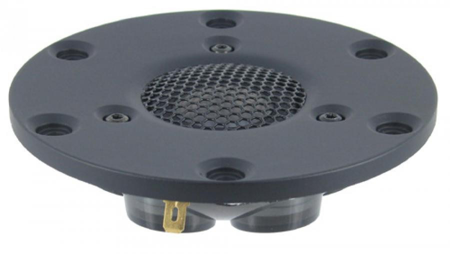

                            Ss D3004-6640
                            How did that old comedian's signature routine go when triggered by the wrong words or situation?
                            "Slowly I turned... step by step... inch by inch..."
                            Well, I'm not angry about testing drivers, really I'm not, except maybe occasionally the ones I spend buckets of money on- that's always a crap shoot. Better to do like John Krutke, I guess, and test other peoples stuff. :W
                            in my case, I think it refers more to how slow I am getting things done when there's a lot of stuff on my plate and it feels like I'm wading through molasses in slow motion.
                            ANYWAY..., without further silliness, I'm thinking this may be the tweeter I wind up using in the Ardent as I finish it off.

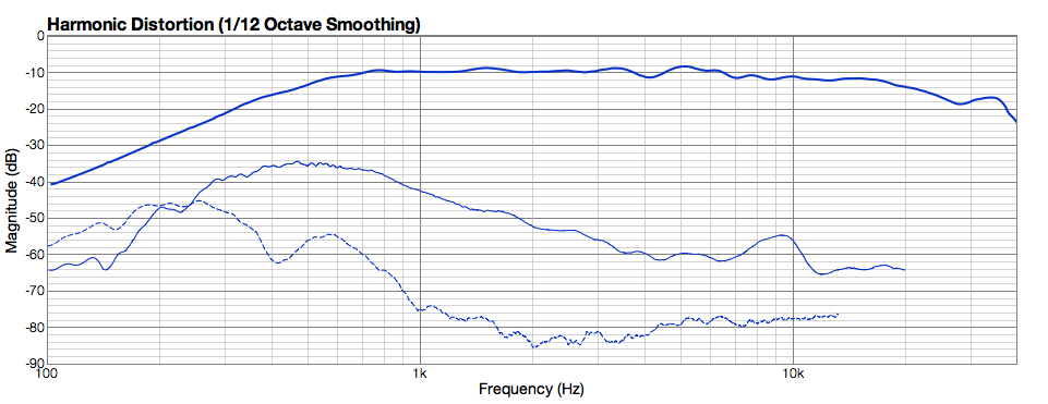

                            Re distortion, the D3004-6662001:
                            they're both characteristically Air Circ tweeters, with the higher HD2 (sweetener to add some harmonics?) though the 6640 seems cleaner in the upper octave. Won't add as much zest to the Zildjians, I guess.

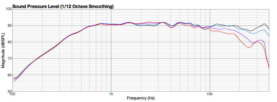

                                      I have CLIO, Praxis, and Fuzzmeasure, but mostly use the latter lately. I like the graphing and general capabilities, and find it very productive with my working style, especially as how I can combine a variety of measurements in one file.
                                      In Fuzzmeasure, there are many options for how to proceed, as you have full gating control for the impulse equivalent (though like Praxis it uses a sine chirp as the stimulus), and several window filters available- rectangular, Hamming, Half Hamming, Hanning, Half Hanning, Bingham and Half Bingham; for in room speaker measurements, I prefer Half Hamming, as you can use moderate length windows that preserve some low frequency detail while rejecting a lot of upper frequency reflections; Praxis has a similar mode.

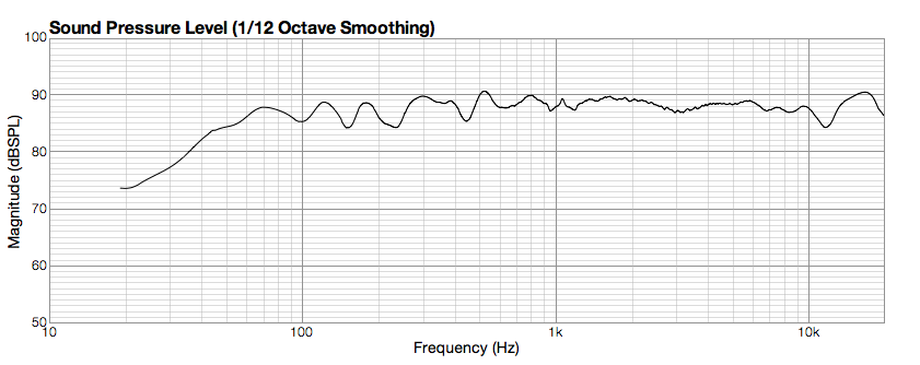

                                      Low frequency performance beyond 6-7 milliseconds is just as dependent on room placement and room characteristics, and that's what you actually have to live with, so I'm not really a fan of spliced full range measurements, though I usually spend some time looking at extended range nearfield measurements and measuring ports output (when present) to see if things are playing as expected.
                                      For example, this measurement is in room, 1 meter on axis, with a moderately long window, but as the port was partly blocked by cables, I wasn't really too concerned about measuring the LF behavior below 40 Hz, and subjectively, the speaker had pretty extended bass, and very articulate - but the ripples in the response between 60 Hz and 1 kHz reflect a combination of floor, ceiling, and probably wall bounce, too- which you have to live with for a speaker in a real room.
                                      In the design phase, I save a copy of the measurement of each driver as a minimum phase measurement, and I also measure the system with all drivers driven simultaneously full range, then in LspCAD I adjust the driver positioning/offsets until my synthesized response looks like the measured response before working on the filters. Usually, this comes in pretty close to just using the VC offset from the front plane, so if I'm in a hurry and working on something with a lower crossover point, I'm comfortable just using the physical calculated offset. Rarely have I gotten into trouble that way.
                                      I use an ACO Pacific mic with 88 kHz sampling, and I generally haven't seen much ambiguity for windowing the impulse response in Fuzzmeasure manually; again, if you use the built in function for creating a minimum phase sample, things seem to work out fine, IME. But then it helps to have clean well behaved drivers, too, I'm sure.
                                      When I'm concerned about evaluating the baffle characteristic BEFORE the effects of driver, I usually use Edge for design studies, with a multitude of microphone positions and a fairly dense calculation grid. Sometimes I do this for sealed/ported boxes, but always for dipole designs. Of course, the best test is to use measurements, and I generally favor taking multiple measurements of each driver on and off axis at several positions through a forward 30 to 60 degree arc, and averaging that data to design the crossover for the flattest power response. That can get you in trouble, though, if the drivers fall off significantly beyond 15 or 20 degrees off axis in a critical band; but then, one probably shouldn't be using them there anyway.
                                      This is all pretty straightforward stuff, nothing innovative or out of the ordinary, I'd say.

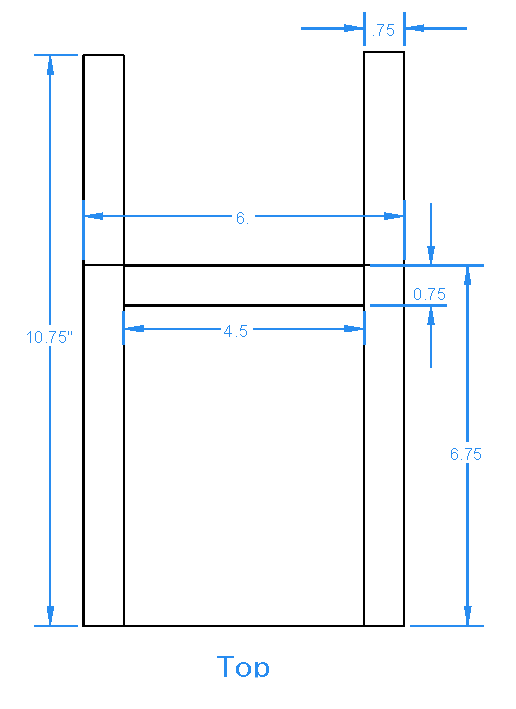

                                                  #1014
                                                  A true pistonic dome tweeter without phase sheild will generally not do so well at 45 degrees or more, unless it's a vary tiny diameter. Cloth dome tweeters do better usually through some bending modes or developing waveguide cavity effects (like the D3004-662001). In this case it wasn't my intent to obfuscate or obscure, in spite of my signature, but just that I was more interesting in detail at a realistic listening angle.
                                                  With regards to the C79 enclosure volume, I didn't think it would be this long before I threw all the details up on a web site. To keep things simple, I did model it in Unibox, shooting for an enclosure size to keep the Q at about 0.5 or a bit less; with a nominal crossover point of 300 Hz but controlled roll off desired down to 100 Hz or so, I ended up with ~3 L, which was similar to the target calculated for an RS100-4.
                                                  The midrange enclosure has sidewalls running front to back on the inside that are 4-3/4" tall; the interior space is 4-3/4" tall by 4-1/2" wide, by 6" deep.
                                                  This top view of the midrange enclosure should convey the concept.
                                                  The front wall is toward the bottom of the drawing- the back wall towards the top. The walls are lined with 1/2" wool felt, and stuffed with long fiber wool. Fs in the box is about 175 Hz. LF zobel is necessary for the midrange to get the right roll off function; otherwise the broad impedance peak will mess up any filter attempt.

                                                    Some measurements...
                                                    Per request, the individual drivers are measured as well as the summed total, on the midrange driver axis. Gating window width is 60 msec, so room effects are visible, of course. The cabinets haven't been cranked up on the points fully, and cables are coming through the port, so LF output is a bit restricted- though it didn't really sound that way. Ports don't have the flare extension yet, but tuning frequency is ~32 Hz.
                                                    Click image for larger version  Name:	Ardent-LF.png Views:	6274 Size:	42.4 KB ID:	853798
                                                    LF Measurement
                                                    Click image for larger version  Name:	Ardent-Mid.png Views:	6373 Size:	43.9 KB ID:	853799
                                                    Midrange Measurement
                                                    Click image for larger version  Name:	Ardent-HF.png Views:	7411 Size:	40.1 KB ID:	853800
                                                    HF Measurement
                                                    Click image for larger version  Name:	Ardent-Sum.png Views:	7258 Size:	42.8 KB ID:	853801
                                                    All drivers summed. Note that midwoofers and tweeter are at the same level at the center frequency of 900 Hz, at ~ -18 dB. The midrange tracking starts falling off at ~180 Hz on the bottom end, but holds up OK to 8 kHz on the top end. I think I can live with that. :W

                                                      Yes, just driving one crossover input at a time- it's a good idea to do so, to see if the target transfer function for each driver + crossover filter set is being realized in practice. A step often omitted, I think.... :W
                                                      These were relatively long gated windows, so they show the effect of room acoustics and position on the response curves. It's always possible to "pretty up" things, but more instructive to see what's really happening.
                                                      I didn't have a chance to get back to these this weekend, as originally hoped, instead finishing up most of the work on cherry cabinets for the Modula MT project, and getting about half way through an SACD player modification (Pioneer DV-79AVi). But everything is gathered together and ready, probably weekend after next, as finishing the first pair of Modula MT MkII is top priority for next weekend. They're deliverables!

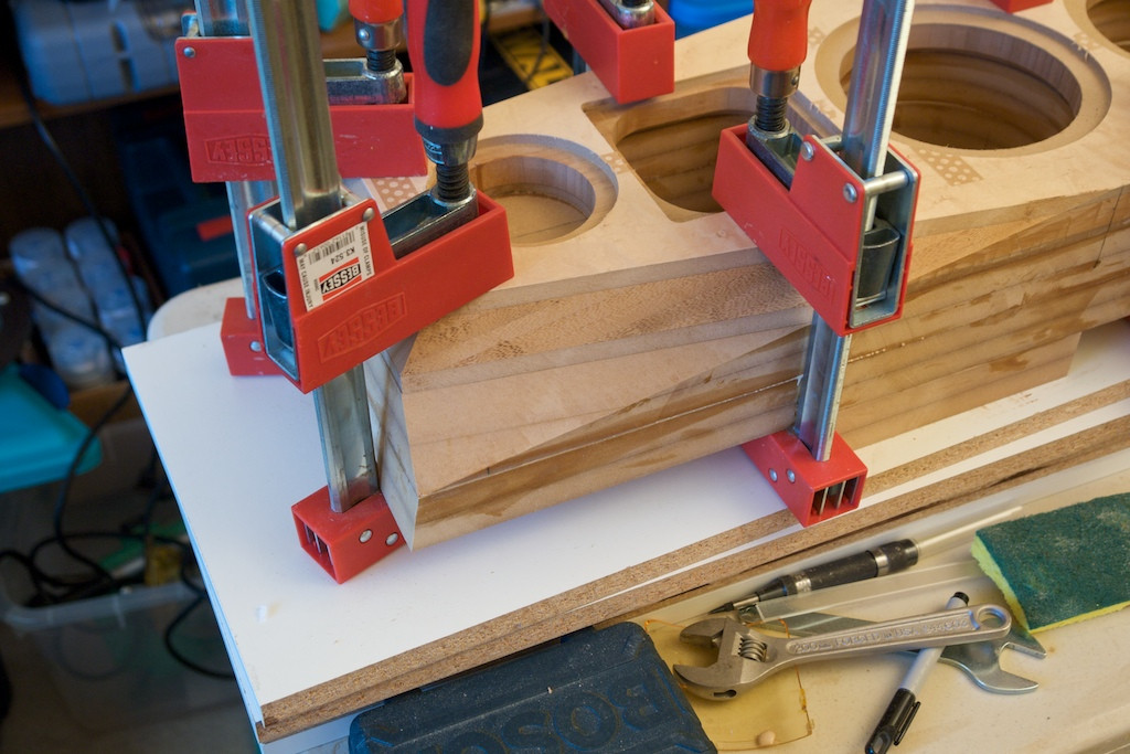

                                                                Ooops! Not supposed to see that secret stash of baffle material, culled from all the Target stores within a 25 mile radius.... the hot tip is the True Bamboo 3205 for the larger cabinets, but for tweeter baffles and braces there are some nice smaller ones.
                                                                I also bought a couple of 1 X 12" 8 ft boards at my Pleasant Hill Rockler last Friday. Better for big projects, but I figured to try some of the cutting boards for little items. They're competitively priced in most cases with the raw lumber. :W Seriously, it's to try them out as alternative in case others want to try that and they have a Target nearby, but not a wood shop stocking LBL!

                                                                  I noticed that the orange box store near me had 5/4" thick stair treads in LBL. They look like they are 11 1/2" by 36" but the round over on the front of the tread looks like it's 1 1/2" and a different material (about the same as the ends on Jon's cutting board). You'd probably have to cut that off leaving about 10" X 36" X 5/4" for just $20.
                                                                  -Bob
                                                                  sorry - no pictures.
                                                                  -Bob

                                                                          How are those Be tweeters sounding so far? I've been thinking about pairing them up with my C173-T6-90s I have on hand, instead of my 6600s.

                                                                                My measurements, other measurements, and my auditioning show an upper end peak that I shouldn't hear, but which I do seem to in auditioning-
                                                                                I believe (possibly erroneously, but what the hey) that it is due to the shallow waveguide design built into the front panel of the D3004/66200 series. I believe this front panel design is part of what gives the 662000 the superior off axis response at 30-45 degrees, but I think it also results in the elevated response in general in this area. I shouldn't be able to hear it, I suppose, but I do compared with the top end on some other tweeters that I find more neutral, like the D2608/9130.
                                                                                Now, the Be 6640 version has a rather different front panel design, more of a broad shallow waveguide, actually, and not the bell like mouth. It's behavior is rather different.
                                                                                So I've put it in one speaker, and will be re-measuring and tweaking the crossovers for both- even ordered some new inductors today. This will be a more relaxed and deliberate evaluation than the frantic preparations trying to get ready to drive for RMAF in Denver- I still have a deadline, but now it's late April, and most of the main work is done.
                                                                                My secret dream of dreams is that the Be drive may give 75-80% of the performance sonically of the Accuton diamond drivers, at 1/4 the cost. The breakup resonance is well controlled, so I'm hoping for a combination of good detail without audible edge in the audio band. That may be naive, but there's only one way to find out. It is rare to find a tweeter as well behaved out to 40 kHz as this one.

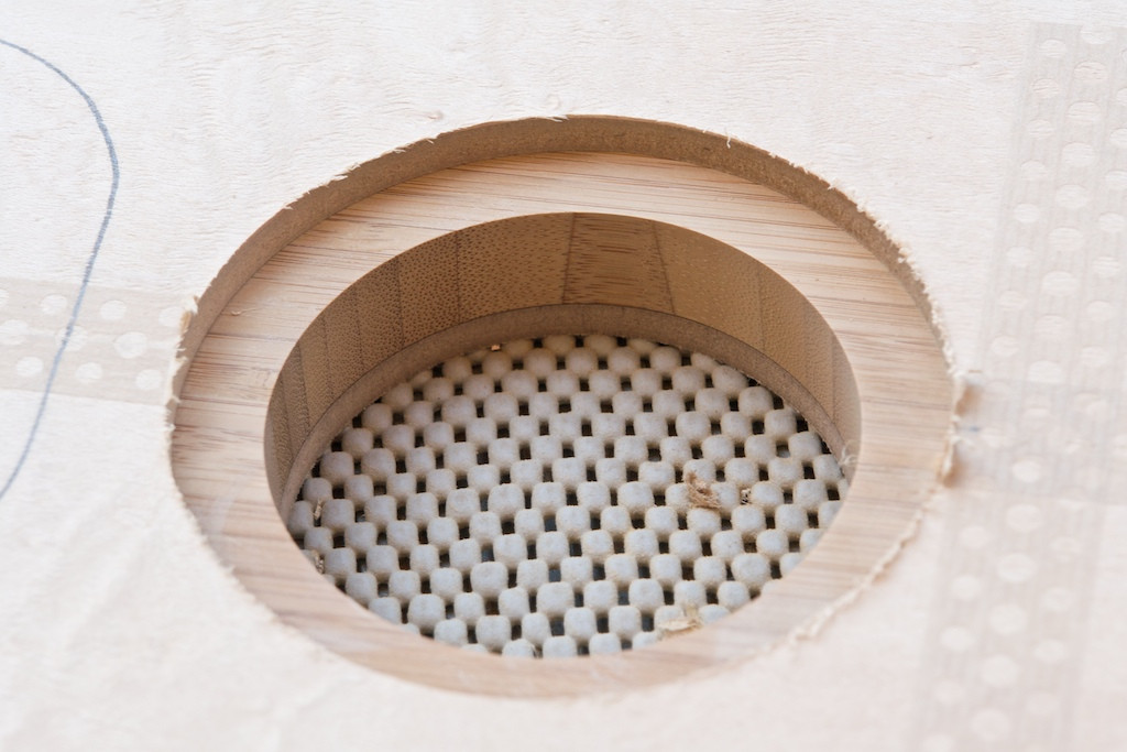

                                                                                        Can you post a picture of the end grain of your LBL. (Cameraphone is ok. ) Does it have the same laminations like plywood?
                                                                                          #1034
                                                                                          Check page 4.
                                                                                            • 16125
                                                                                            #1035
                                                                                            Thanks, Mike.
                                                                                            I'll repeat a few here..

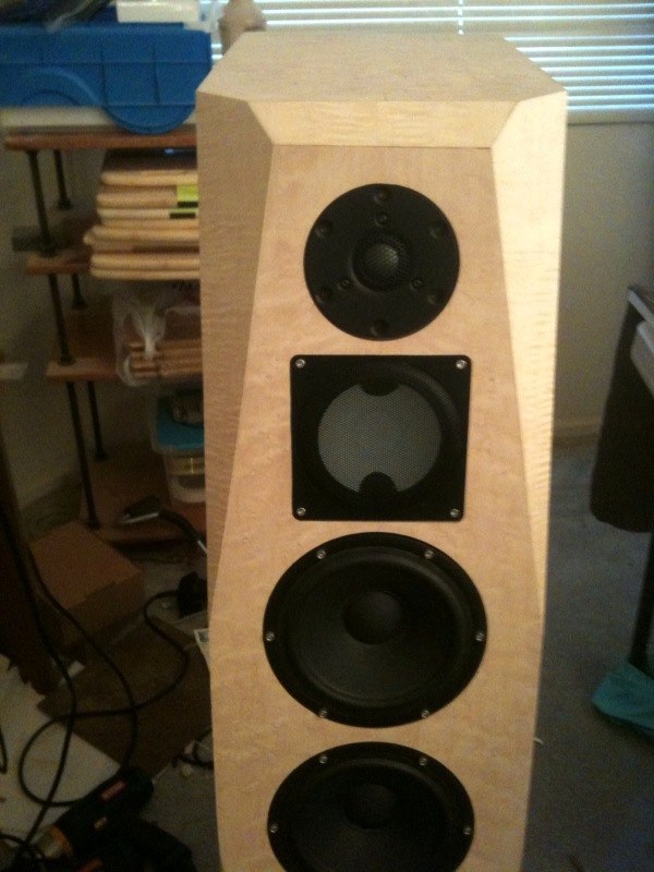

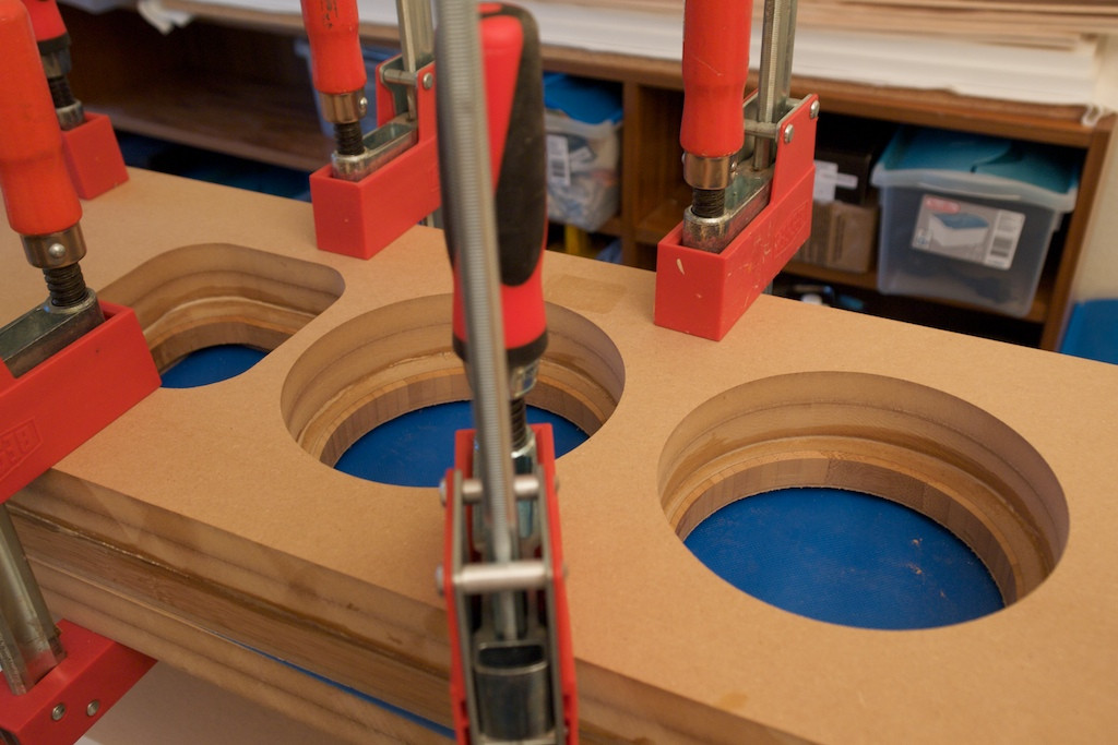

                                                                                            Tonight I'm listening to Synchronicity from a 24/176.4 source... having a real "80's" moment in bliss!
