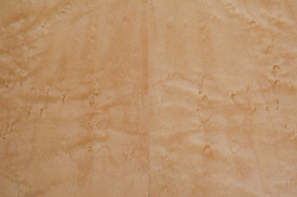

    yes- the top front panel sub sections are already veneered- same concept, birds eye maple, and figured maple. I "might" cheap out and go with paper backed for the sides, but probably not... will probably use the same solid veneer I'm using on the first set. It looks too nice... and considering how much work everything else is just to build the cabinet, it would be penny wise and pound foolish.
    This is from my veneer finishing test block, done with Behlen Por-O-Pac filler and Deft lacquer sanding sealer and lacquer.
    I realize it's pretty hopeless to try to explain this with a picture- figured maple will change it's hue depending on the angle of light, and your viewing angle- and light areas go darker, while dark areas go lighter, like a photographic negative- so while unstained figured maple may at first blush seem boring, it's anything but with a closer look.
    Also, it's a subtler look than I've done in the past, but something I think I'll be able to live with, without getting tired of it.

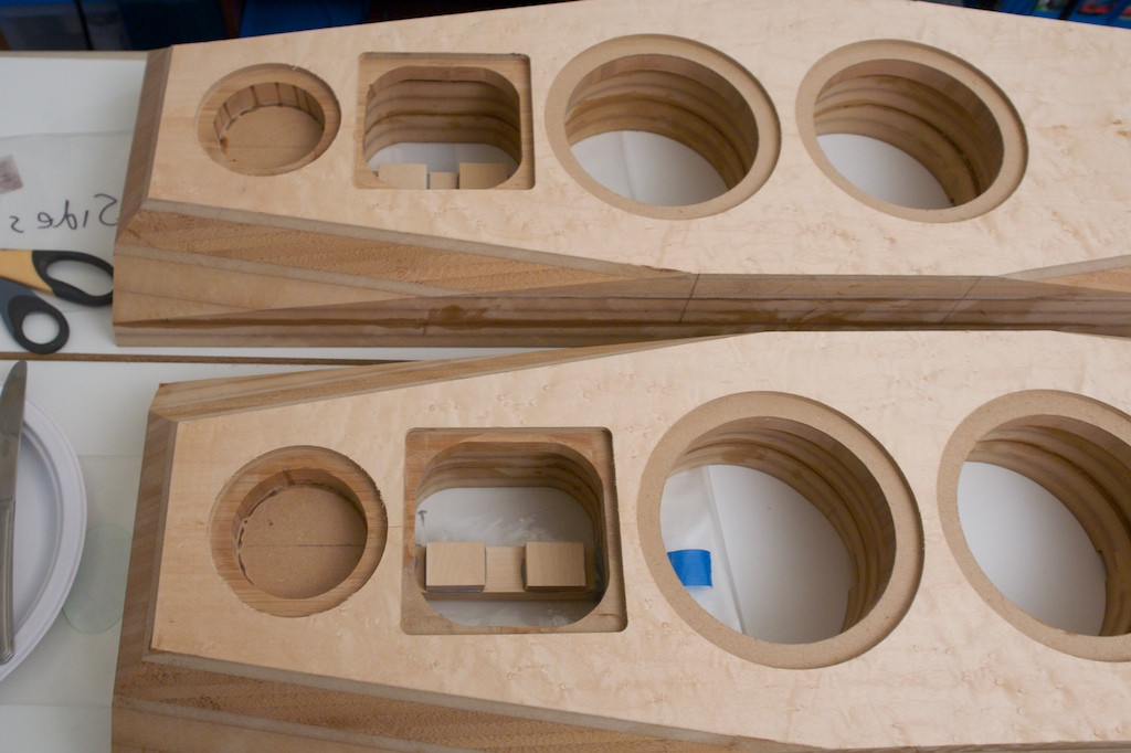

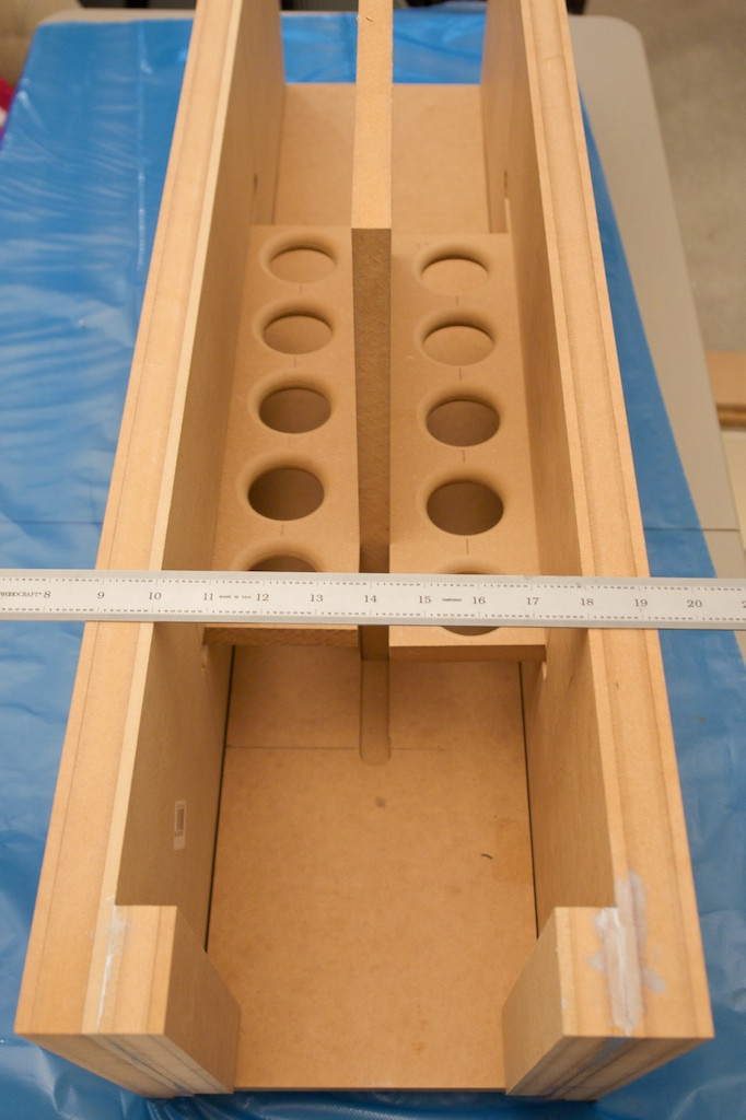

        Unfortunately, when I say I'm just doing detail work that's not very picture worthy, that's pretty much what I mean.
        Soooo, you want pictures? How about these exciting maple midrange driver braces?
        Aren't those sweet?
        You can even see them installed the front panels!!
        :E

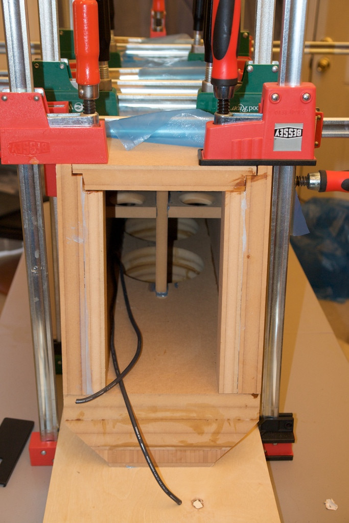

        And for those of you that just have to be in on the bleeding edge of what's happening, how about this riveting shot of a dry fit test of the back, sides, a center brace (not installed correctly, rotated 90 degrees off), and side braces? It doesn't get much better than this!! :W
        Seriously, the epoxy is setting on mounting the midrange enclosures to the front panel, and for the side braces in the sides- this industrial/marine stuff is slow but strong. The top panels, sides, and front panel have had a visit from the DeWalt Jointer so they're ready for "biscuits for breakfast" tomorrow morning. Whispermat II has been "adhered" with 3M 90 to selected parts of the back panels and to the inside of the top panels, and the checklist has been completed down to the final tricky stage of mating front, sides, back and top together.
        As I'm having dinner with my daughter this evening, things won't get all mated up until tomorrow morning- and that means that tomorrow we should, read "Should", have recognizable boxes. :T
        Otherwise, today I've been working on veneering press fixturing for the facets and sides. Boy, that is one thrill a minute, but if I don't do it, who will? :W

          Those panels look amazingly nice though
            And HEAVY!

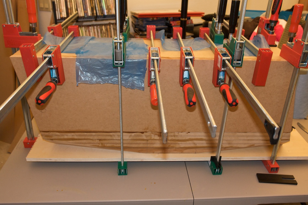

                                            I don't have enough clamps....
                                            To put together two cabinets at the same time! For some ridiculous reason, i thought maybe I did, ever the optimist. I should have known better, considering that in the M8ta I assembled the cabinet shell separately from the front, then mated the two together; in this design, the various bits are more integrated and wind up being assembled around the front panel/midrange enclosure assembly.
                                            These cropped pictures don't really convey the forest of clamp poles involved here, but maybe that's just as well.
                                            And looking up the bottom...
                                            Note, the side walls are NOT double width, that's just the extra spar for stabilizing the connection of the base to the rest of the cabinet, which will have threaded inserts once it's finished. The base will include part of the port length, this ended up being a little touchier on space than I expected.
                                            BTW, that Cardas SE-9 cable is sort of weird feeling; it's a litz coax design, with a lot of copper in the relatively small diameter, so it's heavier (in weight), than you'd expect, but due to the variable gauge Litz construction, very flexible and "limp".
                                            Time to go build another turntable and some veneer fixtures. :W Oh, and maybe lunch, too!

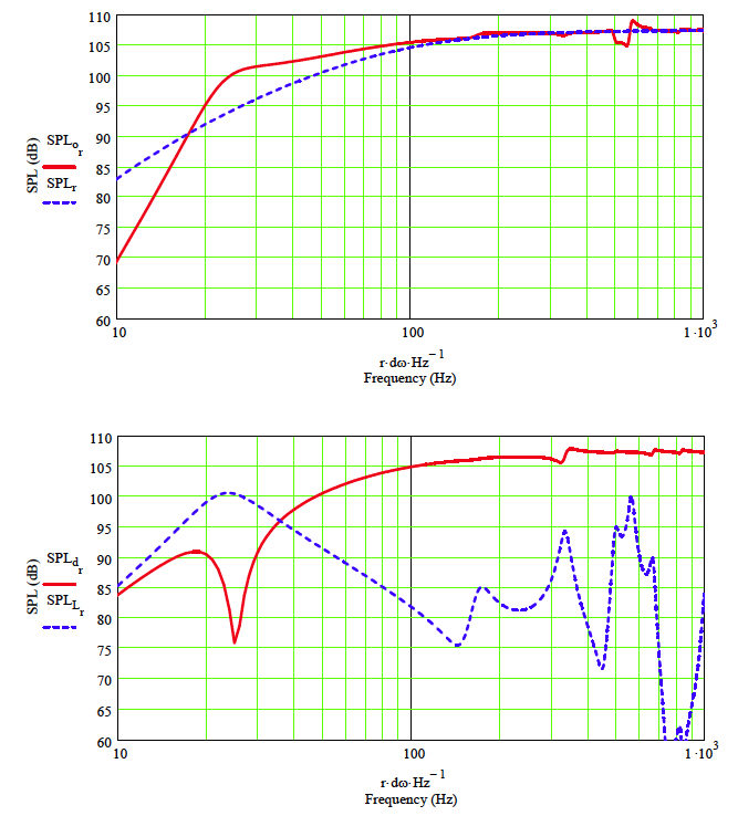

                                            Oh, and last, for those of you who enjoy this sort of thing (we KNOW who you are...), this is the calculated LF transfer function for the cabinet shape and volume and driver and port positioning and damping, per Martin King's ML-TL MathCAD worksheet for the Ardent LF configuration.
                                            This configuration does OK at minimizing column resonances for the most part, with the results calculated here quite similar to the simpler calculation in Unibox. Hopefully the real world will be as accommodating.

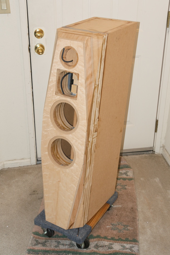

                                                    You didn't ask for it, but you got it anyway- all 98.5 lb without base, drivers, crossover, or even that little dolly it's sitting on now- at least that's what my digital scale says.
                                                    At least one is looking vaguely like a speaker and the drawing on my Mac!
                                                    And is that cabinet dead and stiff! It's like pounding on a piece of granite... well, except for the MDF and epoxy fumes still. :lol: :W
                                                    Of course, CraigJ probably already has his pair done and the crossovers tuned up, but I just don't move as fast these days as I did 30 years ago!
                                                          Click image for larger version  Name:	MLTL-Ardent.png Views:	4381 Size:	61.3 KB ID:	853532
                                                          Jon, I am wondering why you chose to use Martin J. King's Transmition Line MathCAD worksheet. Is this because of a low tuning and having the port at the bottom of the speaker?
                                                          EDIT: I didn't know you could model ported enclosures with his worksheets. Is his software an option to Unibox?
                                                                As you probably know, Martin just very recently decided to try licensing his MathCAD sheets again to DIY users- for a while there, because of problems with folks not observing the "license", and sharing when they weren't authorized to, he shut down making them available.
                                                                The ML-TL sheet can be used for ported cabinets- as Martin calls it, one variant of his TL stuff being a 1/4 wave TQWT.
                                                                Martin goes a step further than tools like Unibox, supporting modeling of the physical layout of the enclosure and drivers- so to physically define a ported box example, you specify the internal length and width at the top, the same for the bottom, the height of the cabinet, the Z height of the driver, the Z height of the port, and the damping.
                                                                I'd only seen a couple of his MathCAD files many years ago, and when I went a year ago looking for them, he was shutdown on distributing them. Now he's got new versions available for a yearly fee of $25 for any of the MathCAD docs, including TL/Ported box, and dipole versions that he developed with John K (the other one, not Krutke). I was still curious to look at this and see how it would model with this tool- believe me, I was able to come up with some configurations that don't look so nice in some regards, due to column resonance and the location of the woofer in the cabinet can be critical.
                                                                An interesting tool- I've been a MathCAD user since the DOS version in the late 80's, so this is my preferred way of doing things, not Excel. :W

                                                                  98lbs without the guts, drivers or base... you are going to have to hire moving guys just to get them out of your shop and into your house....

                                                                    #393
                                                                    Wow that cabinet looks fantastic!
                                                                      • 16125
                                                                      #394
                                                                      Fortunately for me I'm 6'2" and about 220 lb- I have friends, and my boss at work, that couldn't possibly move these on their own. My limit is somewhere around 150-190 lb. :W
                                                                        • 16125
                                                                        #395
                                                                        Thanks, Dougie- I hope it looks a lot more fantastic than this in a couple of weeks or so!

                                                                                    Always I can rely on you to be the voice of objective reason and to set the bar where it really belongs! :agree:
                                                                                    Good thing I have the parts cut and collected for the second pair with Dayton and Seas Drivers (actually, either set can be mounted- there's no difference in the cabinet design), so I can apply "lessons learned" in the future.
                                                                                    While you're rightfully holding me to account for the sloppy glue work and the less than stellar precision on the line up of the braces, I'm just dead relived that it did all go together in a relatively straight forward manner with just one set of hands! Undoubtedly I'll be hearing some critiques since I didn't capture the process on digital film, or any other kind! :W
                                                                                    This design was a challenge because of the midrange enclosure and because of how I wanted to simplify the braces. This made it unfeasible to assemble the cabinet shell first as a separate item the way I did with the M8ta. Several things were necessary to make it "doable" by one person.
                                                                                    First, the midrange enclosure was glued to the front panel, and the board heights on the struts reaching the back carefully sized to have a small gap ( I mean "small"!) to allow for a thick epoxy, but not to prevent flush seating of the back panel.
                                                                                    Second, biscuits were used to align the side panels with the side edge of the front panel, and to align the top panel to the upper edge of the side panels- with proper fabrication, these parts became self aligning that would otherwise be a nightmare to keep straight during assembly. Kudo's to Bosch Biscuits, those little marvels of Deutches precision and quality- high grade workmanship on a relatively small level. My favorites after trying several other name brands, including PC.
                                                                                    Third, the back panel design uses the two part 90 degree dado design as well as a routed channel for the center brace to aid alignment, provide for a flush fit (with good fabrication workmanship), and help it go together quickly. Everything has to be sized correctly and lined up religiously during assembly for this to work, though. The pre-glued side braces stay perpendicular to the sides and also force the center brace into alignment with the rabbeted channel in the back; the channel is a special 13/16" bit design for this sort of application, as a channel for 3/4" boards.
                                                                                    Two kinds of 50 minute epoxy were used; the Loctite marine grade which is much thicker, and can be layered on and doesn't run off the end of a board, (used on the midrange enclosure, on pre-gluing the side braces to the side panels, and for gluing the center brace to the front panel, midrange enclosure, and to the back, and the front of the top panel to the front panel (here mostly for it's non-drip properties)), and a more conventional consistency standard 50 minute 1product that comes in dual 4 oz bottles, and was used for the long seams of the sides to front panel, sides to top panel, and sides to back panel.
                                                                                    The assembly was done in a wrap around fashion, starting with the center brace to the front panel and midrange enclosure, and adding one side panel, adding the top panel with a set of light clamps (Erwin) to hold it in position (after aligning position along the long axis so the top panel/side panel assembly is flush with the top of the front panel) while gluing up the second side panel and moving it into position, while transferring the light clamps to hold both sides against the top panel (alignment provided by biscuits, remember). Last, the epoxy was applied to the surfaces of the side panels and top panel mating to the back panel, and the back panel is dropped into place, then aligned along the length to the top panel (which has previously been aligned to the front), then everything is clamped down, using my painter polyethylene sheet as needed to prevent epoxy seepage from gluing the clamps to the cabinet.
                                                                                    It took a little thought to come up with a design and process that I figured was doable with good precision with just a single set of hands- the anticipation and tension the night before yesterday (before when I tried out the assembly) was as palpable to me as the night before Christmas when I was a kid.
                                                                                    Well, next we'll work on cleaner glue work during assembly and trying to figure out a better way to align the braces- though since no one can see them after it's put together, maybe I'll just let this one item slide for now... it can be our little ugly secret!
                                                                                      Click image for larger version  Name:	Ardent-SheelClampedRear.jpg Views:	2 Size:	177.9 KB ID:	936516
                                                                                      what is the purpose of the gap on between the sides and back? just not squeezed tight in this pic?
                                                                                      Gavin
                                                                                      BAMTM Build
                                                                                        • 16125
                                                                                        #403
                                                                                        It's a shadow /epoxy line; plus the sides are just a teensy bit long, (but only towards the bottom), and will be trimmed using the sliding miter table (we're talking about a 1/16" of an inch here.
                                                                                        • savage25xtreme
                                                                                          • 305
                                                                                          #404
                                                                                          ahh I see it now... thanks
                                                                                          thought you were up to some kind of trick I needed to learn about :B
