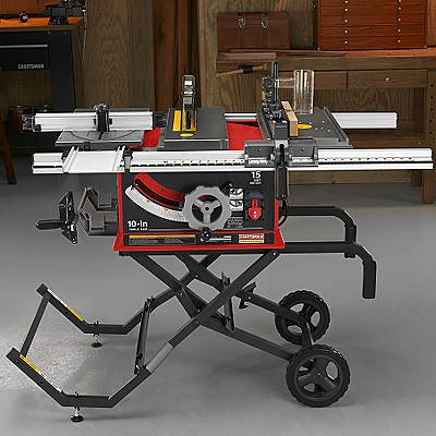

          Pick one of these for the table saw, it does accurate cuts as well and keeps the angle while pushing large material through the saw.

            Very nice :T I rented one of those when I had to do the 10" pine siding on the front of the house. There is a very good extension stand for that saw as well.
            What make and model? That looks interesting!
            Update: Found it on Woodcraft site. Would be a great addition for many saws, I think- my Craftsman/Ryobi has a full sliding miter table, which may be more capable than this add on. Actually, one thing I'd been doing was looking for higher end saws that had fancier sliding miter tables, maybe more weight capacity. Didn't find anything... and the Incra sleds reduce the cutting height unacceptably, in my opinion.

            My Frankensaw is a combination of this craftswman and longer rails from my Ryobi BT3100 and a top plate from my BT3100. Have TWO sliding miter tables, of course- one from each saw!

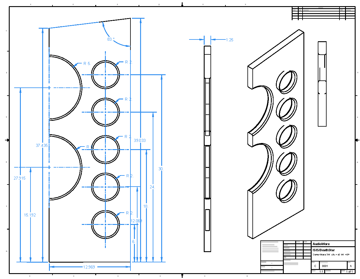

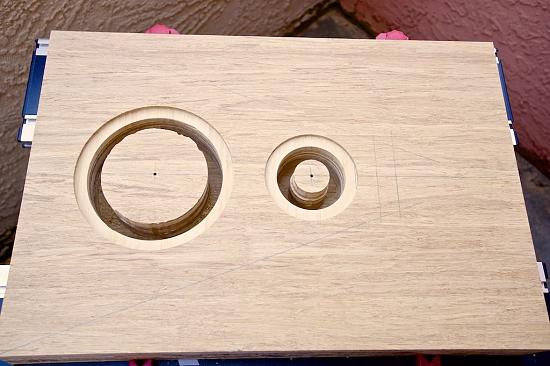

                                                        Got some grunt work done
                                                        Not a lot of pretty pictures, but got some good grunt work done- mostly unsexy stuff like laminating up center braces, working on side panels, and driver logistics.
                                                        The center brace is a somewhat complex piece for being just as flat board,
                                                        Slow work takes time, so there's no substitute for putting in the hours. The right angle rails are used for all panel laminating steps (fronts and otherwise) to be sure the glued up panel is straight and true. Works like a charm. :W

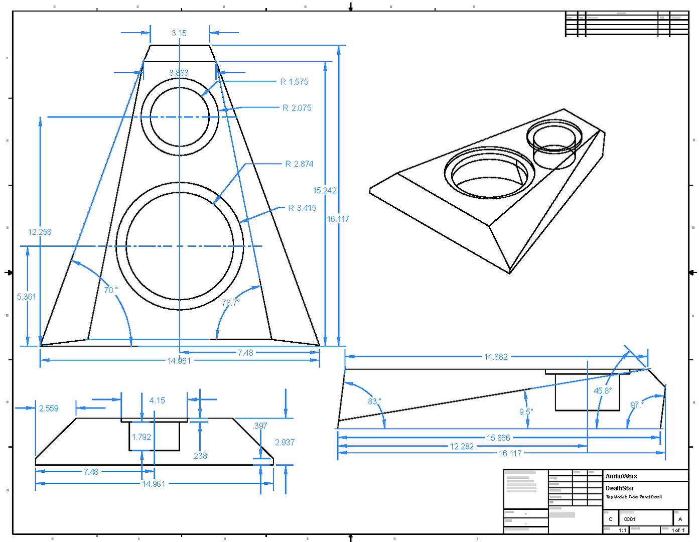

                                                        The front panels for the top modules at least show some tangible evidence of something that will become a speaker... :B

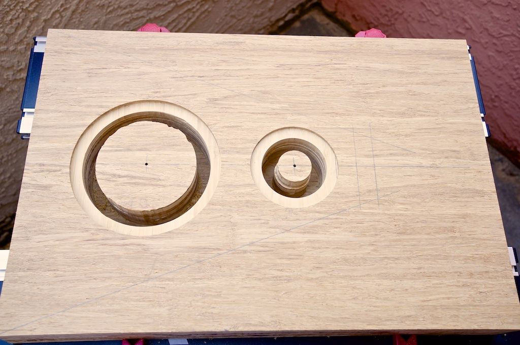

                                                        It takes time to rout 2-1/2" deep hole cut outs! 8O

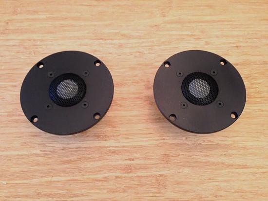

                                                        Also got in contact with the tweeter distributor; they're in stock in LA, and he's getting me mechanical drawings to confirm the dimensions I have by an indirect source. Should order them next weekend. Then I'll have all the drivers on hand.
                                                        It feels like slow going, but it usually does at this stage of a project like this. At least, no veneering to consider this time!
                                                        Hope to get a little work in this evening, laminating side panels maybe, and gluing up the deep cut fixture for the DWS780.
                                                          Hey Jon..... looking good.
                                                          I've had a similar work year to yours, but it comes at a very good time as both my girls will be in college in the next two years and it's nice to have their education paid in advance!! Oldest daughter should hear from Colorado School of Mines within the week!!!
                                                          I've had two custom woodworking jobs (entertainment centers) I needed to finish for friends consuming my free time, but I'm just starting a dual opposed subwoofer project using B&C 18" drivers. Combined with my Geddes Abbeys I should be able to kick some serious acoustic butt in the next couple of weeks.
                                                          Looking forward to see how this turns out.

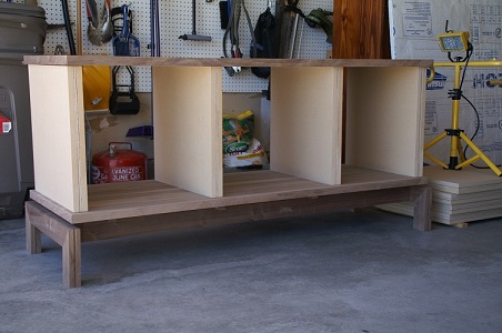

                                                              #390
                                                              I was originally thinking of using the Aurasound NS12-513 - I have 8 of them stashed away waiting on this project. After modeling the B&C it looked to be a better match to the Abbeys. I'll have three subs with two 18 inchers in each one. I've attached a picture with a gallon of Titebond II as reference.
                                                              The other picture is the entertainment center... I've included it because I'm thinking of using the same base on a couple of audio projects. The main part "floats" on the base.
                                                              Tom

                                                                  Did a little more work last night on the top module front panels- cored out the holes, will be cleaning them up and back bevel with a router tomorrow evening.
                                                                  I'm also somewhat relieved the tweeters are in stock in the USA. Just trying to keep some steady progress going. :W

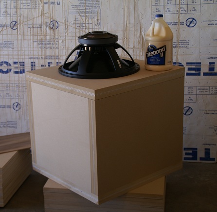

                                                                    More tools and glue purchased Thursday, and tweeters on the way today. Need to build the deep cut platform for the DWS780 tonight. Have all the woofer cabinet side panels laminated, will do the rabbet clean up and cross cuts Saturday, along with more top module work.
                                                                    I'll probably start an official build thread this weekend, if I have time in the evening- this thread has been fun but it's more like a diary of stream of consciousness than anything else-

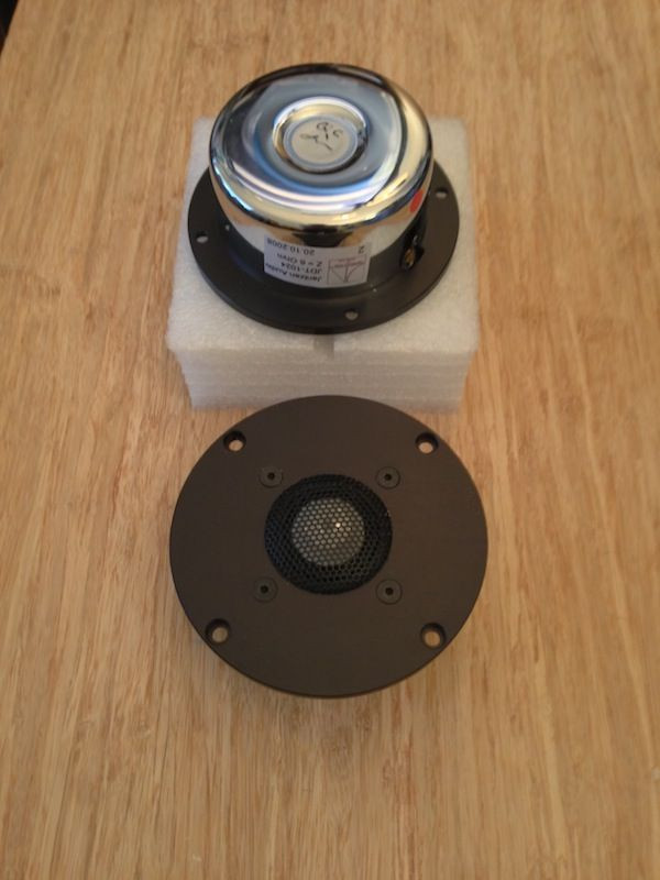

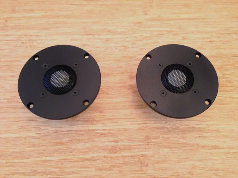

                                                                          Sky is falling...
                                                                          Figures that the day that I get some new tweeters in, the sky starts falling at work and I'm covering for other people's absences on critical customer visits by HQ people!
                                                                          So, if a picture is worth a thousand words, here's a lot of words...
                                                                          Nice build quality, and do come with individual measurements.
                                                                          As always, the proof is in the pudding...

                                                                            Those sure are purdy Jon! Looking forward to your impressions and test results.
                                                                              #398
                                                                              Yes, test results will certainly be interesting.

                                                                                No measurements yet- have been woodworking during the free time I could find this weekend! For "normal" measurements I'll have to get the test baffle out of storage- the Isiris cabinets will have a rather different characteristic, with the baffle step transition pushed up to a fairly high frequency due to the cabinet shape.
                                                                                The two LBL top modules have all the pieces cut but I had to knock off for dinner with my daughter part way through the biscuit rabetting. Everything seems to fit so far (and with the top and bottom being the only parallel surfaces!), in spite of more compound miter/bevel combos than I've ever attempted before! Should be gluing them together this coming weekend. The MDF test mule's (for N26 tweeter) front panel, top and base are finished, still have to cut the sides and rear panel.
                                                                                Black phenolic sheet for the bass/top module separator was ordered this weekend, too.
                                                                                Geez! Slow work takes time!

                                                                                  Jon - The top cabinets can be a bit tricky to glue together if you used the same geometry as me. It takes a bit of guess work... I ended up using ratchett straps and then gluing everything off the back face, if that makes sense. It is really important to have all the angles spot on for it to go together properly...
                                                                                  I had one small hiccup on my cabinets which the supplier decided to re-veneer one face to repair. Means another delay, but hoping for next week for their return.
                                                                                    • 16167
                                                                                    #401
                                                                                    Now THAT's an understatement if I've ever heard one! I have modified some of the geometry a little bit, because of the LBL bamboo- the top piece is now full width, and has a 35 degree bevel matching up to the sides which have a complementary 35 degree bevel (due to the 20 degree slope angle of the sides), so this way it looks like a veneer wrap from the sides over the top. I also have an additional forward cross piece on the base where it meets the front panel, which gives me a 1-1/2" surface gluing to the front panel.
                                                                                    I considered both starting from the front and the back, but the newest assembly process I mapped out and recorded on my iPad in bed at 1AM this morning (you never know when you're going to wake up with a new idea in the middle of the night- this project has caused lots of middle of the night worry sessions!) starts from the front, with the front panel and base, with the sides as dry checks on the angle, then adds the top and back (again with sides as dry checks), then will glue the sides last. Glue I'm using for actual cabinet assembly is System Three T-88 Epoxy Structural adhesive.
                                                                                    As impatient as I'm starting to get, I'll likely try starting that this evening, if the last dry fit checks pass muster.
                                                                                    Working at this stage is nerve wracking, because of the possibility of yield loss- I messed up one top module side panel yesterday afternoon, and had to cut a fresh one, but I have a bit of overage in the LBL to cover small incidents like this. A front panel mess up would be a catastrophe, requiring another LBL order!
                                                                                    Sorry to hear about the hiccup and veneer repair- this has got to be killing you at this stage! Of course, it gives me a little more time to catch up.
                                                                                    I've also been modeling some crossover ideas in the evening- I'm considering doing the mid to tweeter crossover more like the Modula MT/NatalieP, in a quasi series/parallel configuration, because of the ease in tuning distinct areas with minimal components, especially the transition region, but I've got more simulation work to do to prove that out- would give a better control over the low end of the tweeter, too, as well as a very benign impedance curve to drive.

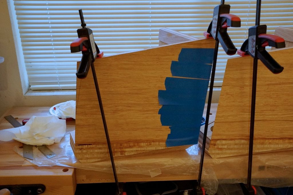

                                                                                        More uses for that wonderful blue tape...
                                                                                        This one's for Hank....
                                                                                        "Soft strapping/positioning" for low pressure epoxy wood joints...
                                                                                        I was up extra early all this week for conference calls at ridiculous times times of the morning, so I broke off a little early this after noon to do some side panel gluing. Everything has been double checked and tweaked, sometimes just shaving off a 32nd of an inch or inside beveling the angle an extra degree to optimize the fit...
                                                                                        They're either a labor of love or labor of insanity...
                                                                                        The black phenolic sheets I ordered for the module separator plates from Bell Plastics arrived today, too. Progress is our most important product... they should cut nicely with my Amana non-ferrous 10" blade; with a -6 degree hook it handles difficult materials well.

                                                                                        • meb46
                                                                                          • Jul 2010
                                                                                          • 398
                                                                                          #404
                                                                                          Excellent progress Jon, I am impressed you managed to get all of your cutting so accurate in the absence of a CNC machine I guess I cheated in my case Keep the photos coming so I can get excited in the absence of my cabinets. I'm going to be cutting in fine between getting cabinets back and drivers mounted before I need to pack them up for my pending move the Chicago. It might even introduce a convenient "crossover" buffer time
                                                                                            • 16167
                                                                                            #405
                                                                                            The special angle gauge from Woodpecker and my calipers have been indispensable !
                                                                                            It's been more like measure four times, cut once, then measure and trim again if needed! It's the best work I've ever done, but then, I'm not really a woodworker! Not like some of the guys here! I'm more comfortable with a good circuit simulation program or a scope and distortion analyzer! I'll start an official build thread once I'm caught up with where I want to be!
