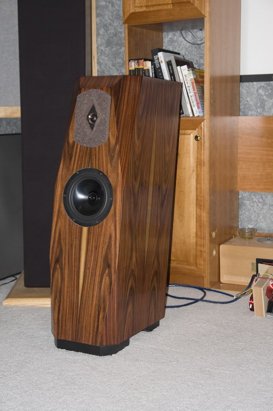

    For those who don't know what an M8ta is, it's a project i did a few years ago not expecting anyone else to build. Boy, was I wrong. :W
    Here's Kris Vardas's-
    a set by Mark Andrew,
    And of course, the inimitable Colorado Tom...
    (a guy who actually knows how to do woodworking, unlike a fumble-fingers like me).

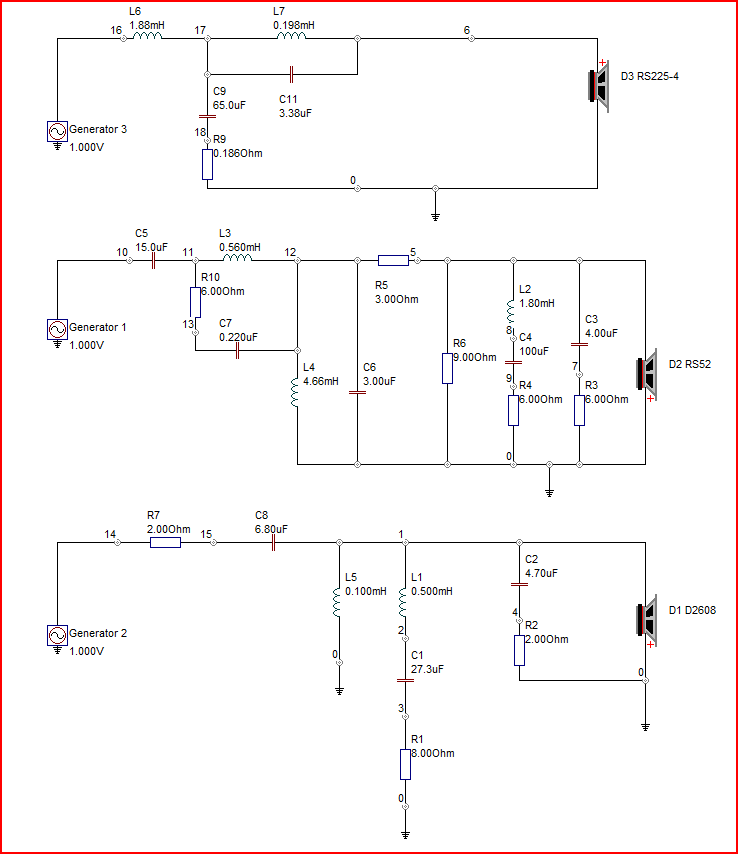

    So, one idea I've been kicking around, and this is basically just a proof of concept doing some quick and dirty measurements (well, not that dirty, expect for the lumpy in room bass), to show feasibility and crossover concept for a three way based on this concept with the RS52AN dome midrange, and in a minor twist, the Scanspeak D2608-9130, my current favorite under $100 tweeter. Note that the woofer used is the RS225-4, which was not available when the original M8ta design was tackled; being 4 ohm, the voltage sensitivity is about 3 dB higher, a worthwhile improvement in my opinion for solid state amps. With four dB baffle step compensation, the net system sensitivity for 2.83 VRMS can be about 86 dB with the right inductors (Jantzen C-Core, for example). Some component values still need to be "normalized" to standard available vlues (such as L6 - 2 mH) but I don't see any difficulty there.
    This IS a 4 ohm speaker across most of the frequency range. No wimpy HT receivers or vacuum state amplifiers without appropriate impedance taps should apply. I consider this just a proof of concept, but it should need very little dialing in. (provided I haven't screwed up in some inscrutable and unknown manner)
    Without further ado, the proposed crossover schematic:

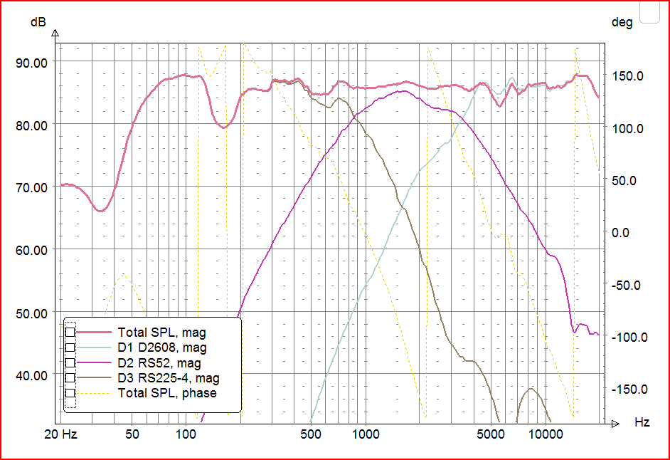

    And the calculated SPL response...

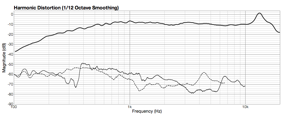

        "Ragged on the top end" is a function of whether you use diffraction control or not in taking the measurements, and whether or not you smooth the measurements a lot (not done here).
        But it's easy to adapt to the RS28a or f. OTOH, for a three way, going lower doesn't really make any difference or serve any use in a three way speaker. For this Duelund target function with a nominal center frequency of 1500 Hz, the tweeter is nominally crossed at 3500 Hz - which is why the D26 worked fine in the original Modula NeoD CC design. Especially as the D2608 has very low distortion also.
        I have design data for the RS28a, and can implement a crossover concept for it which would be compatible with the RS28F, but I don't expect to be popping for an RS28F myself- using a 1-1/8" diameter tweeter in a three way instead of a 1" or 3/4" is not likely to help the off axis performance. So far, I haven't seen any published curves on the RS28F off axis, and the earlier Usher silk tweeter from which the design is based and which I DO have, is not especially good in that regard- not as good as the D2608.
        The D2608 is a driver that looks more than fair on paper, but that I think needs to be heard to be heard in a system to be really appreciated- I think Jed and some others would confirm that. In many regards, it's quite competitive with the much more expensive Illuminator series tweeters, especially for a true three way application, or if waveguide loaded. That could even be done in this case- in fact, that was going to be the next concept post when I have time to work on it later this month. Business travel beckons for now.
        As I hope I inferred in my first post, this is something I expect mainly to be of interest to those who had built or are in the process of building the M8ta- I'm not building another set myself, so there isn't going to be a big thread on this. Least, I'm not planning on it! :W
        Last edited by theSven; 06 May 2023, 21:44 Saturday. Reason: Update image location

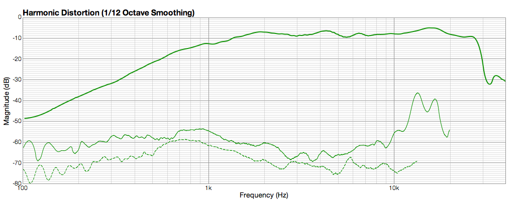

              Just curious, why is there so much space between the woofer and tweeter on the Mt8a? I'm guessing you didn't foresee adding a midrange to this at the time you designed it. But, it sounds like a very nice upgrade for those who've built these speakers.
              What about one version that uses the Morel MDM55? I know it's more expensive, but maybe It'd be a nice upgrade(?) that would interest some. You probably don't have measure data on that, so maybe that's not possible?
              Hi John,
              I may be the lone voice crying in the wilderness on this one, but other than the smaller footprint, I don't think the MDM 55 is superior to the RS52AN in any fashion. I know it's pretty popular in DIY circles, probably because of the mounting ease and Morel's reputation in past years. But whether you look at it in terms of frequency extension or non-linear distortion, the Morel doesn't match up. Morel's motors are nothing to write home about for linearity- HiVi spanks them in some categories, like 7" woofers. The RS52 is one of the best dome mids you can buy at any price.
              90 dB
              The only one I've seen or owned and tested that gives it a run for the money is the hideously expensive (in comparison) Accuton C50-8-44 (at $276).
              The driver spacing is a function of having a near zero acoustic offset on the horizontal axis. There was no RS52 then, either, or it might have been a three way!! :B

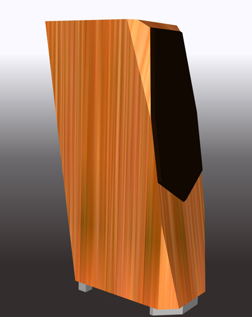

                        Jon - For the baffle, would you mount the RS52 dead center between the '225 and the tweeter?
                          I'd expect it to be far closer to the tweeter. This is one of those designs where a custom faceplate for the mid and tweeter combined would really be nice.
                            Jon, do you see much variation in the part values in the crossover schematic presented above to that of the final schematic? Also, do you think a 225-8 woofer and Seas millennium could be used with the RS52? I know you are busy with a bunch of other designs plus work, but thought I would ask anyway.
                            Kris
                            Last edited by theSven; 06 May 2023, 21:45 Saturday. Reason: Update image location
                              • 16202
                              With the RS225-8, sensitivity will be reduced by 3 dB. I will have that network modeled soon, too, with the Millenium Excel, as many have used that in the M8ta, as I did. The "grind" is on to get the Xtreme's ready for Nothern CA DIY later this month, but I will be getting back to this soon. Bump it later in April... I can always use a reminder.

                                        Haven't gotten back to this yet, other than some thought experiments about how I'm going to hog out the existing cabinets to mount the midranges...
                                        If I had it all to do over again, I'd probably consider a dual 8" configuration with flux capacitors. Or not. Who knows? I will evaluate crossovers for both 8 and 4 ohm versions of the driver, as I have some of the 4 ohm, and it will help the system sensitivity by 3 dB.
                                        • kvardas
                                          • 125
                                          Does the hole for the RS52 need to go through the entire 4-inch baffle, or can it perhaps be a depth a 1/2-inch beyond depth of the driver and then drill two smaller holes for the wires. If this is okay, then perhaps use a long spiral router bit for the hole. If not, a large diameter forstner bit...Rockler has some that go up to about 3-inches. l
                                            • 1044
                                            The problem with the no-through-hole idea is that you have to turn that entire volume into sawdust in the process. The problem with the through hole is 4" baffles. One could get something like a Blue Rhino TCT hole saw. It will chew-up MDF fairly well, but 4" is pushing it for a hole saw and drill driver.
