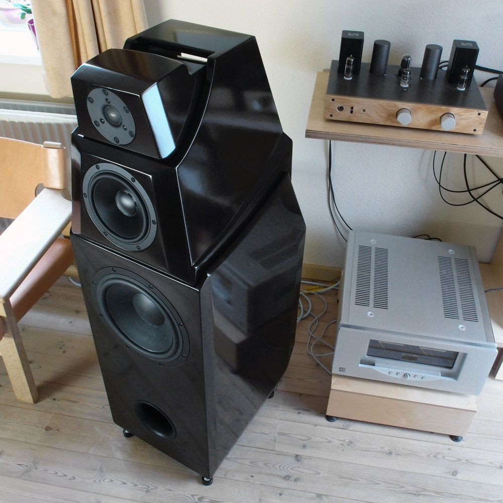

                My god that look stunning. I've been staring at it the last 15 minutes and just couldn't take my eyes off of it. :-)

                  Yes, Troel's newest project, an homage to Wilson Audio, is a nice piece of design and craftsmanship. Why don't you go build one? :W I bet you'd be pretty happy with how it sounds! Troels has a very high level of both design capability and productivity- makes me wonder if he even has a day job, considering all the stuff he's turned out in the last few years! Or maybe that is his day job- doing nice designs with Jantzen crossover parts and ATC drivers and promoting them - however he works it, hats off!

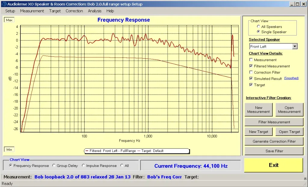

                                                Regarding the "listening curve" here's a very interesting thread.
                                                Bob Katz is probably worth reading!
                                                Last edited by theSven; 23 June 2023, 15:02 Friday. Reason: Update image location and url link
                                                Paul

                                                                  #842
                                                                  Click image for larger version  Name:	BobKatzcurve_zpsa584003f.webp Views:	0 Size:	84.3 KB ID:	941609
                                                                  Click image for larger version  Name:	Bruel & Kjaer optimum curve for HiFi My edt.jpg Views:	1 Size:	107.9 KB ID:	858113
                                                                  The black line is the original. I added the red to illustrate about what my personal preferences are. Of course this varies somewhat based on the type of music im listening to. For me, -6db @10k is a bit much. And I like a bit more (1-2db) in the 20-35hz range than I am indicating here (I really like to FEEL the music)

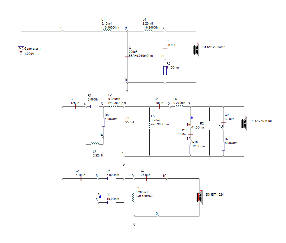

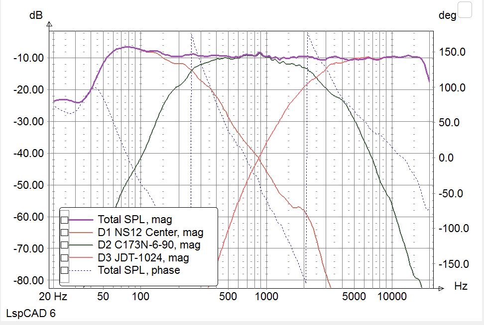

                                                                      #844

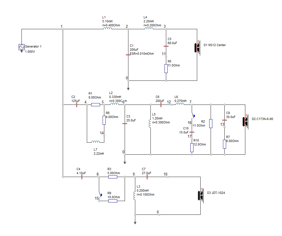

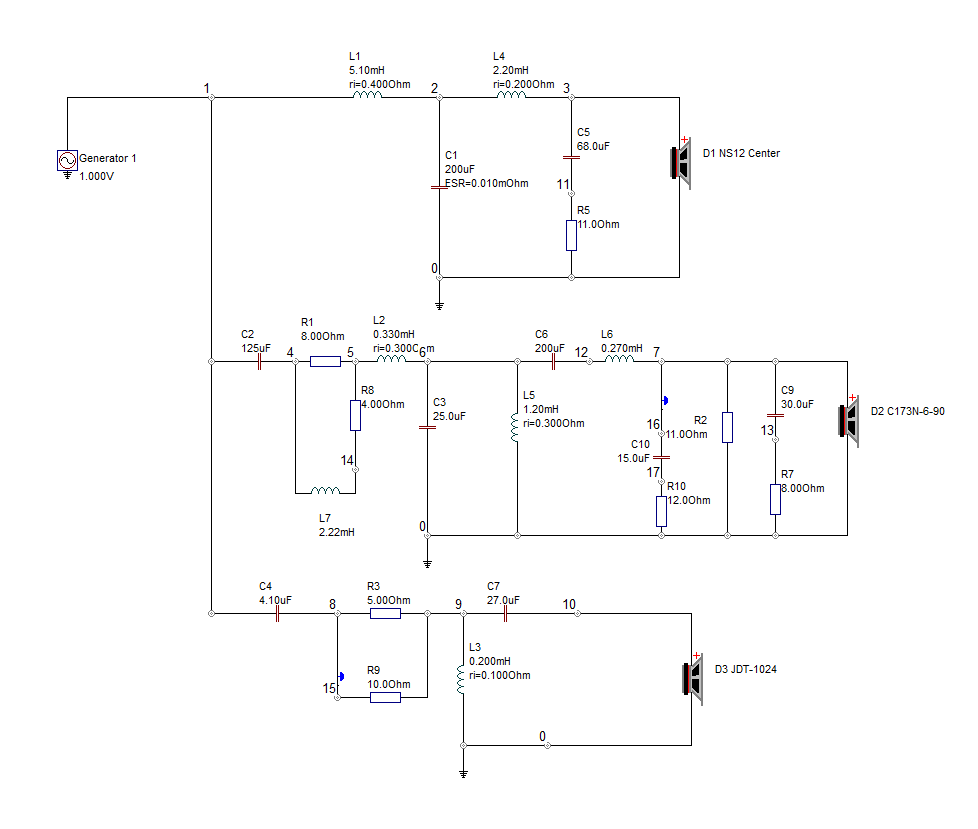

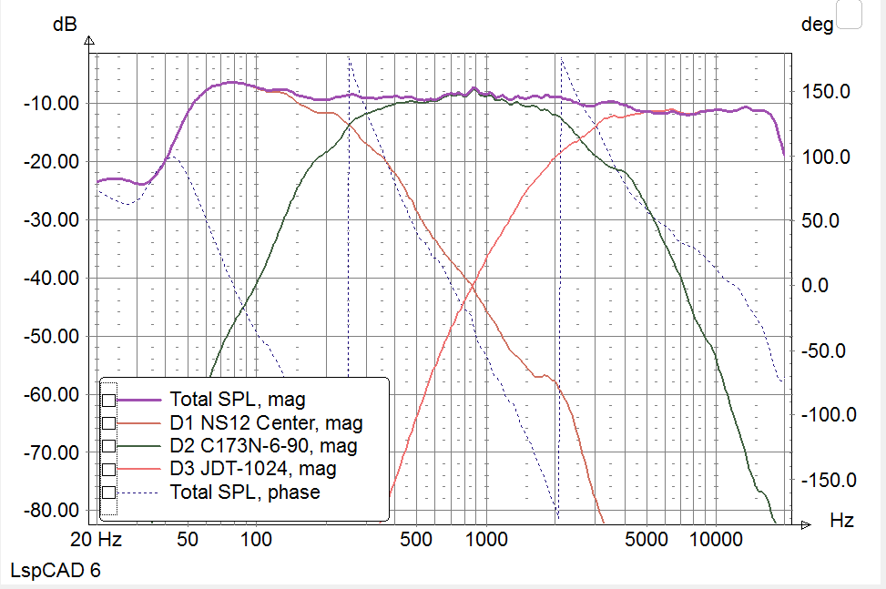

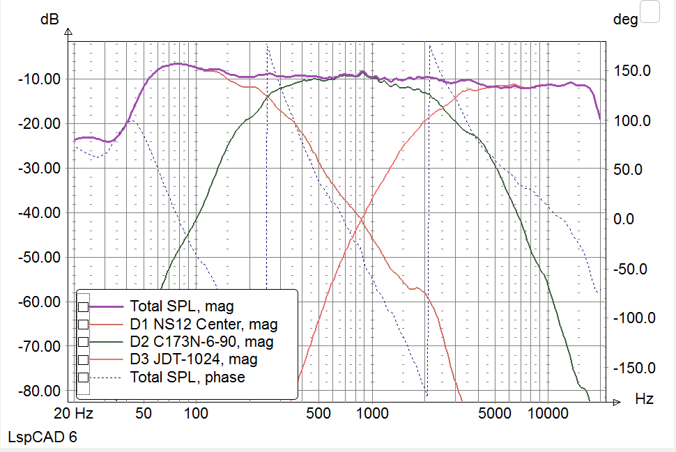

                                                                      Thinking about this at lunchtime today, and having been wanting to put some tuning tricks into the final crossover, my first pass on that in LspCAD looks flexible enough to give me a useful range of results without getting myself in big trouble.
                                                                      Basically, one switch in the midrange section to had an approximately 2 dB contour/level tune for the upper midrange, and one switch in the tweeter section to adjust the tweeter level by 2 dB. Depending on how the combination is used, different "house curves" can be approximated; which is not to say that my choices for WHAT house curve to approximate won't get tweaked a bit once things are setup in their ultimate home.
                                                                      This combination I call the "flat curve", for very smooth flat response at 30 degrees off axis from 100 Hz on up.

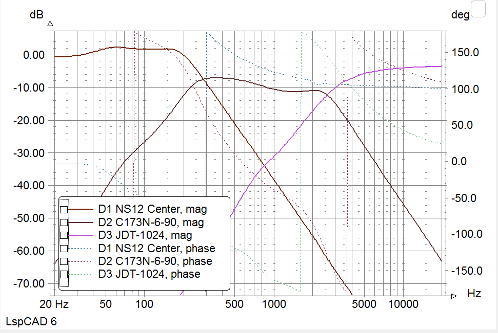

                                                                      Transfer function:
                                                                      SPL curve (predicted)
                                                                      This I call the "Corner Curve" (or should it be Korner Kurve? :W )
                                                                      Corner Transfer Function:
                                                                      Corner SPL Plot:
                                                                      And this approximate a mild tilt function:
                                                                      With the Tilt Transfer Function:
                                                                      And Tilt SPL Plot:
                                                                      Let's see how this works out in the real world... mmm, Madisound is going to love me, buying more of those Mundorf resistors. Obviously they could be modified to be more pronounced in the effect, but maybe starting off a little more subtle is a good idea for now.

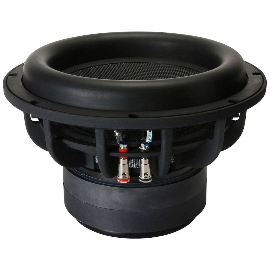

                                                                            Well, I'll try to work that in- I've been saving info and some pictures. Mind, this is a "mini" build, with just the 10" driver- I sort of wish GF has been willing to tolerate something a little bigger, I would have moved up the cabinet and driver size. But for what she needs, this should be fine, and she says she's OK with the Isiris in the family room. Of course, she hasn't seen them in the LBL flesh yet, as it were, so everything is subject to change with little notice! The new "baby" sub is HER's, regardless of future events, as I'm asking her to toss the Sony sub. So it's built more to her needs.
                                                                            Now, personally, I think the Wavecor and the Dayton are somewhat different beasts.
                                                                            The Dayton is built as a typical long throw woofer with most of the focus being on behavior below 100 Hz, and has almost double the xmax of the Wavecor, and 19 mm versus 10.5 mm. OTOH, the Dayton DOES use a lot of copper above and below the gap, so inductivity modulation should be low- I'm expecting to see good HD numbers.
                                                                            The Wavecor has an interesting pole piece structure, should have intrinsically low HD2 compared to many drivers (less mud in the sound at any level), and the cone appears well behaved beyond 2 kHz; it appears from the published data I could make a two way out of this part with an 1800 Hz crossover like the Modula MT. Not that I want to... and in 20 Liter net, an F3 of 42 Hz, and F6 of 32 Hz is realizable without any EQ.
                                                                            Imagine the SW223BD01 in a 22L sealed PE Enclosure with an RS52 mid and the new SB26STCN tweeter up top... "ET Mini Me"? Not very sensitive, but enormous power handling and bottom end and SPL for that size box... 100 dB anechoic at 32 Hz at full song. I believe someone of a darker frame of mind has taken note of the possibilities...

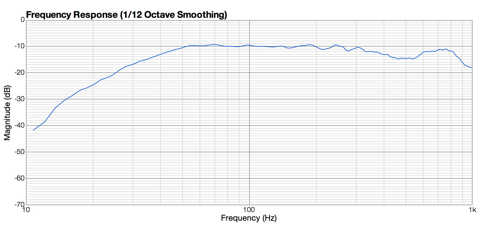

                                                                                      #852

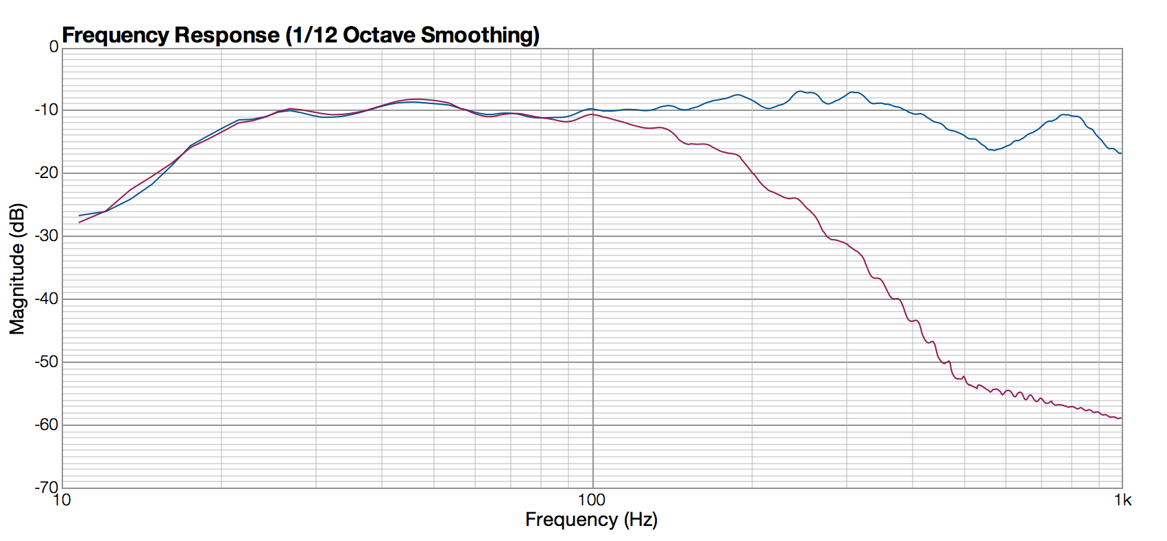

                                                                                      Boom Box update
                                                                                      Will write this up proper soon. Just a "calibration update".
                                                                                      Near field, no xover, no EQ, fixed 12 Hz high pass filter (not defeatable)
                                                                                      With EQ, + 6 dB max, inflection point at 50 Hz; with (maroon) and without (blue) 120 Hz LP crossover.
                                                                                      Measurement SPL was only about 90 dB; distortion curves look suspiciously good... maybe too good. But the 10" DVC driver and the Hypex amp get the job done, though the so called owners manual is real vague about a lot of stuff. Initially I though the frequency for the EQ was the peaking frequency, but after some measurements determined it was the inflection frequency- i.e., starts to get applied below the stated frequency.
                                                                                      This is probably a "large" box by some for a sealed system, but then it doesn't need a Linkwitz/Riley transform to deal with the Qtc bump a smaller box would have. Curve looks nice for HT to me... gonna have to try Avatar with it over at the GF's.
