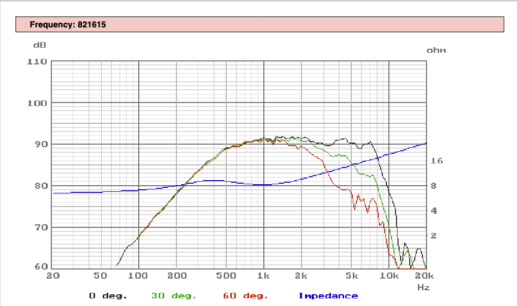

                          What about this true mid driver from Peerless? Krell is using it in their resolution series, it is definetely a true mid with good sensitivity and can barely be used >600 Hz.
Name:	821615 frequency.png

                            That peerless doesn't seem to remain pistonic about 1K......... clearly not part of the emperor's tenet.

                                                                                          Calrissian, you must have been down in the Bespin mines one time too many times without your respirator... always carry a spare.
                                                                                          W12CY: 85 dB sensitivity, with a moderately horrendous breakup mode between 8 and 18 kHz. Possessed of adequate Xmax (3 mm), the breakup mode would be very difficult to suppress adequate and sill contribute to raised 3rd hamronic distortion from 3 kHz and up.
                                                                                          W15CY: 3 mm Xmax OK, big break up mode starting at 5 kHz. Makes the C79 look pristinely clean in comparison.
                                                                                          W12CY Nextel: Promising SPL plot, but what is that impedance wiggle at 800 Hz? Get's a little rough at 4 kHz and above, but looks manageable. VERY large magnet assembly almost complete masks rear wave. Why did they not use the W15 Nextel neodymium motor? Paper cone? Paper? no self respecting Sith speaker designer... mumble mumble.
                                                                                          M15CH002: Fairly smooth, but a curious glitch in impedance curve and response at 1100 Hz. Some narrow peaks in 4-5 kHz region- odd, with the incredibly small Neodymium magnet assembly, it's not plausibe to blame those on a reflection from the magnet assembly. From the impedance curve and SPL data I expect some minor energy storge issues. Potentially usable... but I beleive I recall others lamenting linear or nonlinear distoriton issues for these- will have to search the hypernet to confirm. Cone size and dispersion might be concerns.
                                                                                          Scanspeak 15M/4532K: Ugly impedance ripple at 1 kHz. It doesn't feel right in the Force...
                                                                                          Scanspeak 15W/4531G: Ugly impedance ripple at 1 kHz....
                                                                                          I looked at other 5" SS- similar issues.
                                                                                          This is not to say others couldn't try these- the M15CH002 would be easiest to fit to the requirements of the crossover, with fairly well controlled response to 10 kHz. Does any one have test data on the Nextel?
