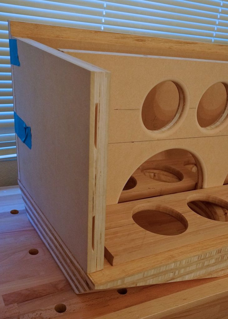

              Additional 3M equipment in use
              Glued up second sides this afternoon; note the same disposable blue strap clamps, but also another essential piece of equipment, 3M ear protectors to reduce the muttering and cursing as pieces are brought into alignment...

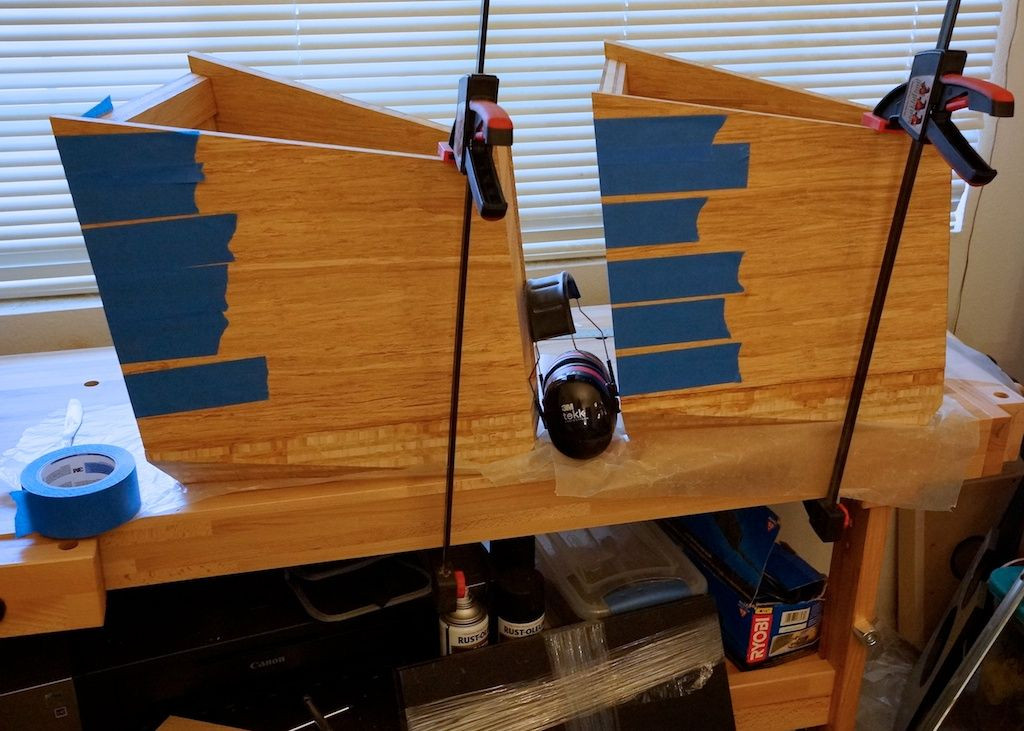

                    TGA clamping
                    If the muttering and cursing has gone well, and full TGA* has been in progress for the earlier assembly steps (* TGA = Teeth Gnashing Accuracy) :roll: , then this is how much clamping is needed for the top piece gluing.

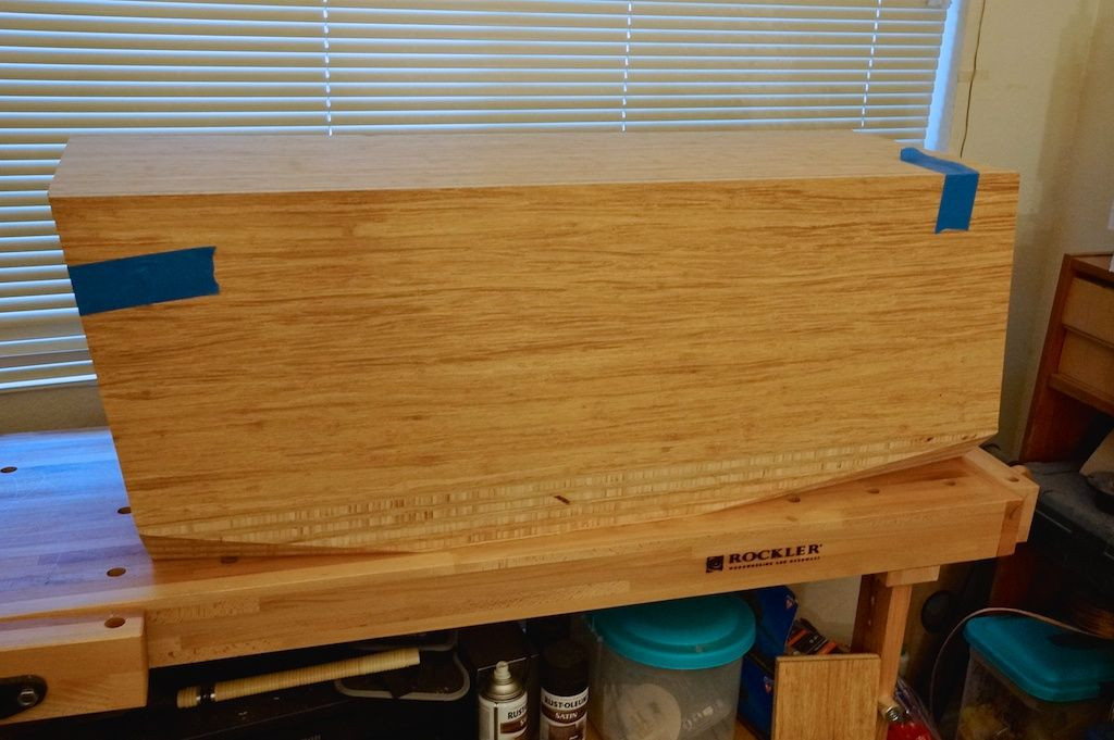

                                                                Back from my trip to Minneapolis this week, and now making a bit of progress, though side tracked this AM by Thanksgiving preparations.

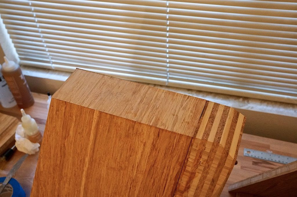

                                                                Initial sanding completed following the bevel cuts; I still have to plan the grille cloth frame and locate where I'll be installing Neodymium magnets in the front panels to support the grille frames.
                                                                If you think the woofer rebates look a little deep, it's because they are, in order that under excursion the woofers won't kick the front grille frames (hopefully! :roll: )

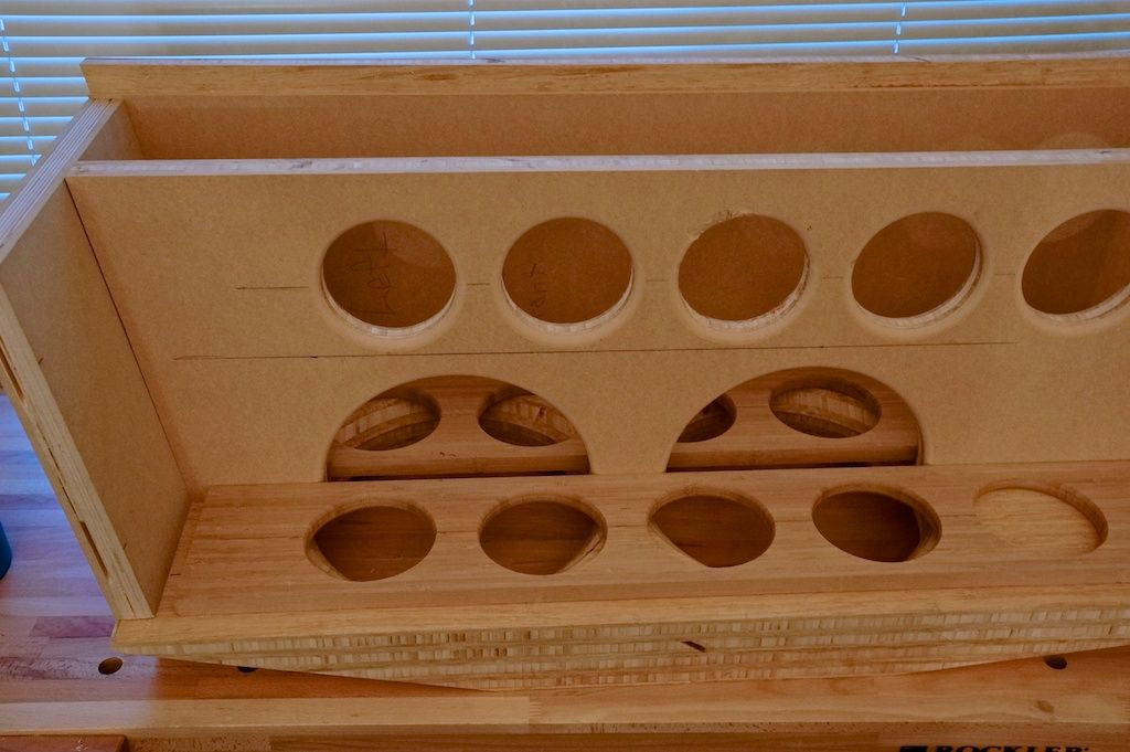

                                                                            Sunday Teaser
                                                                            Base sanding for Top modules in progress.... these still need some filler for the inner core ply defects and some other surface defects, plus Behlen pore filler.
                                                                            you know, we just may have some speakers once this is all done. For a while, it's been an effort to see that!

                                                                                The main joints for assembly (not lamination) have all used System Three T88. What I've found is that there are small voids now and then in the inner LBL core- the inside layer- so I plan to deal with those with System Three SculpWood, which is a two part kneadable wood filler (sort of epoxy based).
                                                                                Behlen Pore-o-Pac natural is pretty good for filling and leveling open grain woods, and this fossilized bamboo ply outer surface is more like, say, oak, than like Maple, (it seems to be shredded bamboo mixed with binder resins) so it needs something to make a level surface for finishing.
                                                                                The other alternative is System Three Silica powder mixed in with Lacquer sanding sealer- (which I've got on hand, too) I've got enough moderate sized scraps that I can test these approaches soon and decide which to go with.
                                                                                I'm not planning on going with any stain; considering how maple develops clarity in the grain and appearance just with sanding sealer and clear lacquer, I'm expecting something like that with the fossilized bamboo.
                                                                                Like I say, I'm no experienced woodworker, so my tendency is to proceed cautiously and test evaluate on scrap before proceeding.

                                                                                  Monkey Coffin dry fit check passed
                                                                                  OK, it's been sweaty palm time, finishing up detail work on the braces, biscuiting the front panel, top piece, bottom brace, and sides, and then doing my first dry fit check for a bottom module.
                                                                                  For now, just laying down the braces to check the side to side spacing (by the way, it pays to round over the LBL, because a straight 90 degree corner in bamboo is SHARP! Skin cutting sharp!)
                                                                                  Nothing but a skosh of the finest blue tape holding these together for a dry check
                                                                                  Houston, we have a go for launch pad assembly... :T break out the T88 structural adhesive! :B But let's hold off on the champagne for now- maybe just some French Blood Orange soda to celebrate (yeah, not in the same category as a fine tequila, but we've got assembly operations ongoing... )

                                                                                          It's for structural design convenience-
                                                                                          The sides, I wanted 1" with a 1/4" rebate 1" deep for fitting the back; adding 1/4" MDF and rebating was the easy way to do it. The back I also wanted 1" thick, but planning to add rebates on the inside for the Vampire binding posts.
                                                                                          Similarly, for the center brace, I needed 1-1/4" in order to get the side braces at or below 6", for reasons of material availability- adding two 1/4" layers to a 3/4" LBL ply did the trick.
                                                                                          The top and bottom panels are actually "cheaters"- BB ply I had around that was already laminated on both sides with 1/4", but not used for the intended project.
                                                                                          The actual base plate is two layers of 3/4" LBL.
