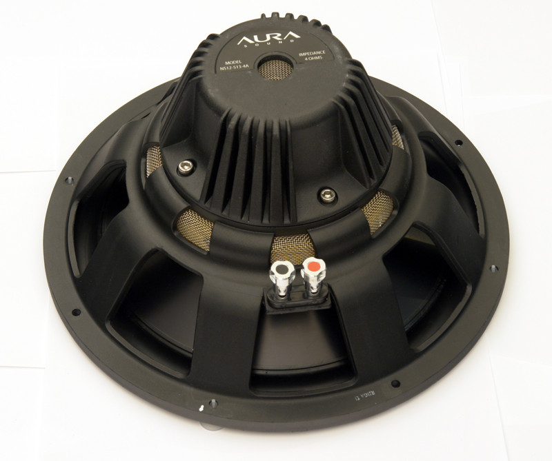

                            Funny you should mention that- I have two pairs of NS10's, and of course Seas, ScanSpeak, and others make good tens. It would mainly be an adjustment to the cabinet size and crossover level tweaks.
                            I've got two pairs of NS12's hoarded for this project, with the underhung voice coil with good faraday shield in the gap, the distortion is quite low on this driver well up into the upper midrange. Seeing falling distortion all the way up to 2 kHz is unusual- usually you'll see it start to rise, actually, from 300 Hz or so, due to inductivity modulation.
                            Keep in mind we're developing a version based on TransducerLabs N26, and adapting this to the Be 6640 would be pretty straight forward. I'm building a test mule as well as a pair from LBL.
                            2nd order HD at 90 dB
                            3rd order HD @ 90 dB (wow, these old measurements seem kind of crude compared with what Fuzzmeasure does)
                            Torture test time, keeping in mind these aren't sub drivers, 100 dB
                            HD 2
                            HD 3
                            That's for one driver.

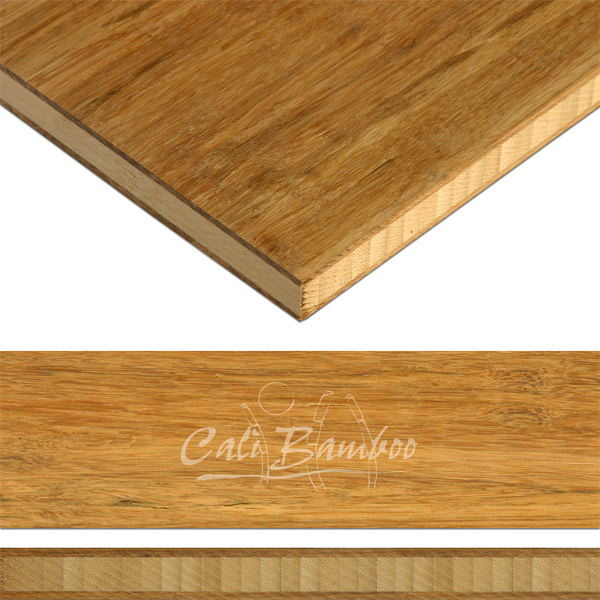

                                                        Actually, the surface of the Fossilized bamboo, while hard and flat, does have a fair amount of slit like pores. That's one reason I mention that I'd researched ways to fill them during the finishing process.
                                                        This pick of the Fossilized Bamboo is somewhat darker than what I have; maybe a photography issue.
                                                        Click image for larger version  Name:	three_quarter_inch_natural_fossilized_bamboo_plywood_600x600.jpg Views:	2035 Size:	86.7 KB ID:	857647
                                                        This smaller thumbnail image is more representative of the actual color/hue and layer thickness.
                                                        Click image for larger version  Name:	three_quarter_inch_natural_fossilized_bamboo_plywood_300x200.jpg Views:	2061 Size:	16.7 KB ID:	857648
                                                        For the lamination work, I just use Titebond III, applied/spread with a foam paint roller (love those foam rollers and foam brushes); it's very easy to get a well controlled smooth coat. While the Titebond instruction say to let it sit up 30 minutes before unclamping, and to not stress the joint for 24 hours, I'm giving them 3 hours before unclamping. I've used the Titebond III with other LBL to MDF laminating, and it's always worked perfectly. It's supposed to be completely waterproof (not really an issue) but it also seems to adhere better to a wider range of woods and be stronger. Good stuff. I'm a bit of a glue fanatic, so I don't make that recommendation lightly.
                                                        All the rest of the gluing I plan to use SystemThree epoxy (pays to shop on Amazon for a good price), probably with silica filler mixed int so that it's a little thicker going on, easier to work with (more like my favorite marine epoxy, but without the color). Best laid plans of mice and men, and all...
                                                        Hank, here in California, I use Calibamboo,
                                                        Calibamboo
                                                        But they have warehouses around the country and support the USA (48 states) and Canada. Minimum order on LBL plywood is two sheets (typically around $400-$500). I ordered 6 4'x6' sheets last February; was about $1200, plus $150 freight, delivered to the street side. Only took a few days to get here from their warehouse in Southern CA.

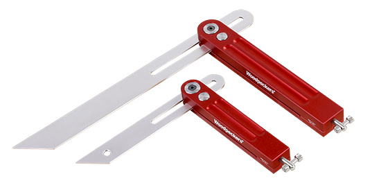

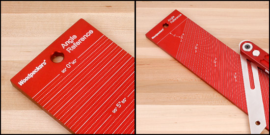

                                                        There will be a lot of challenges in this, particularly manually cutting the pieces for the top module assembly to the required accuracy and dimensions. I think I have it in hand, but we'll see.
                                                        A Woodpeck bevel gauge and angle reference plate (one time tool builds) are an important part of my newer toolset for this project.
                                                        Click image for larger version  Name:	main_angleref.jpg Views:	1964 Size:	73.2 KB ID:	857649
                                                        Click image for larger version  Name:	main_bevel_gauge.jpg Views:	2005 Size:	39.8 KB ID:	857650
                                                        As William Shakespeare was quoted as saying, "There's many a slip twixt the cup and the lip"- sure this applies to this project, so I just have to work a little harder (maybe a LOT harder and smarter!) to have a steady and sure hand.

                                                                                Work work all morning, but made some great progress on a particular problem, after an inspiration in the middle of the night.
                                                                                Since then, just getting ready for tomorrow's sawdust session- picked up a full set of new router bits for what's coming up, another Ryobi 180 and a fresh Jasper jig for it, (don't you just hate using stale Jasper jigs? I mean, sheesh!), a new Woodworker II blade for the DeWalt table saw, and something new to try out, a 10" sanding disk and some sanding pads to use in the saw- all from my relatively local Woodcraft store. I also brought home on of the Aurasound NS-12's as a safety check to triple check the woofer hole sizes.
                                                                                Handling the drivers is getting me jazzed, but what's really getting me excited is the LBL pieces I've cut so far, or more particularly, the one's I've glued up.

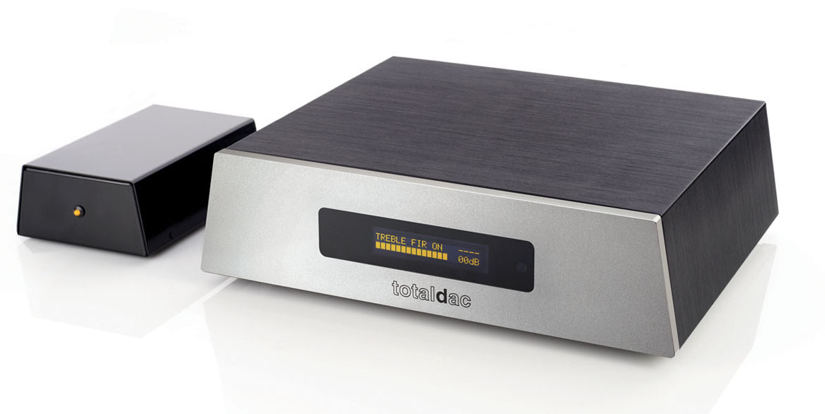

                                                                                (it's a 24/192 NOS (Non Over Sampling) discrete R2R ladder DAC built with custom programmed FPGA's and Vishay 0.01% foil resistors. It includes a built in 69 bit digital volume control, custom adaptive FIR filters, the XMOS USB chip interface for those liking USB, and quite interestingly, a 10 msec FIFO input buffer for jitter reduction. No resampling or SRC for jitter reduction. Makes me drool just to think about it- has various options, including a full balanced version (as in balanced DAC's), and electronic crossover versions. Made in France; no US dealers, though it is distributed in the Far East.
                                                                                Sigh.... I don't think Santa Claus is going to be that nice to me this year... maybe I'll have to crack the savings bank for one of these.

                                                                                  Really, a discrete R2R ladder DAC huh. I remember that in school, when they were discussing digital to analog conversion in one of my first engineering electronics classes. Is this different than DAC chips do. I know there are lots different DAC circuits out there. Nice to hear that the good old descrete R2R ladder is about as good as gets.
                                                                                  John unk:
                                                                                    #356
                                                                                    With all these crazy good new dacs how much distortion do our passive cross overs add to the signal path?
                                                                                      • 16167
                                                                                      #357

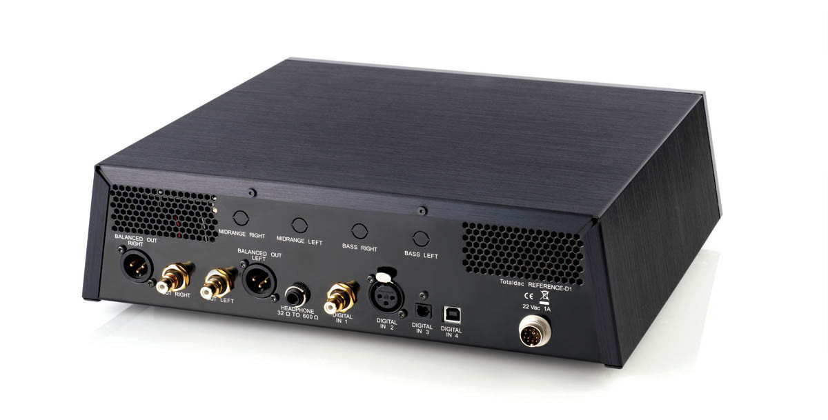

                                                                                      R2/R Ladder DACs are relatively rare, as are Non Oversampling DACs. There is a definite coterie of listeners who prefer NOS because of the subjective high frequency characteristics of more modern DAC chips.
                                                                                      In order to do NOS you need an N-bit LPCM DAC, where N is the number of bits. Since no modern DAC chip is of this type (they are all either 1-bit sigma-delta, multi-level sigma delta, or a hybrid few bit PCM plus sigma-delta), this is why you always see NOS enthusiasts (particularly the DIY enthusiasts) using old chips like the Philips TDA 1541.
                                                                                      Achieving high measured linearity and excellent sonics is not a trivial proposition, and Vincent's original model (A1) and the D1 have undergone a continuous process of refinement and update with new options added depending on the potential owner's requirements. The A1 and D1 use 96 Vishay foil resistors per channel, for the single ended version. (The D1 in dual DAC mode and balanced output uses double this number- the resistor cost alone accounts for 30% of the selling price of the unit).
                                                                                      The noise performance and dynamic range are quite remarkable- note the noise floor reproducing a 24 bit -110dBFS sine wave.
                                                                                      Other products that use high end approaches to R2/R ladder DACs include top models from Meitner, Lawry, MSB, and dCS.
                                                                                      Another key interesting point in the configuration of the original A1 TotalDAC and the D1 is jitter control- a 10 msec input FIFO is used to store the incoming digital signal and dole it out asynchronously to the DAC stage with local oscillator. This technique is now implemented in the new PS Audio Perfect Wave DAC MkII, with the nome de plume of Digital Lens, and according to the Computer Audiophile, the Digital Lens (10msec FIFO buffer!) improves the performance of the MKII so much over the MK1 that he considers the MK1 (or the MkII with it turned off) "broken".
                                                                                      In the case of my friend in Munich, some special shunt regulators he'd been using for his Zodiac Golds were switched to the D1, with notable sonic improvements- Vincent confirmed this and will likely offer a similar option some time in 2013. Vincent also offers configurations with or without the USB input, and Dual DAC versions with electronic crossover functions built in to the DSP, with high and low pass channel outputs, calculated at 69 bit for high linearity, like the volume control.
                                                                                      Sacré bleu!
                                                                                      Anyway, with my friend's feedback and other info I've been able to collect, you may understand why I'm intrigued.
                                                                                      The only thing weirder I've been looking at lately is a RAW file converter written by a rather smart Russian guy...

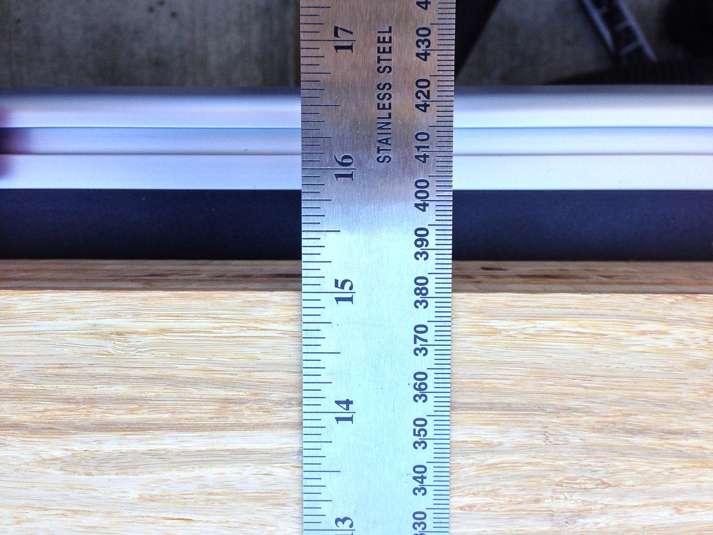

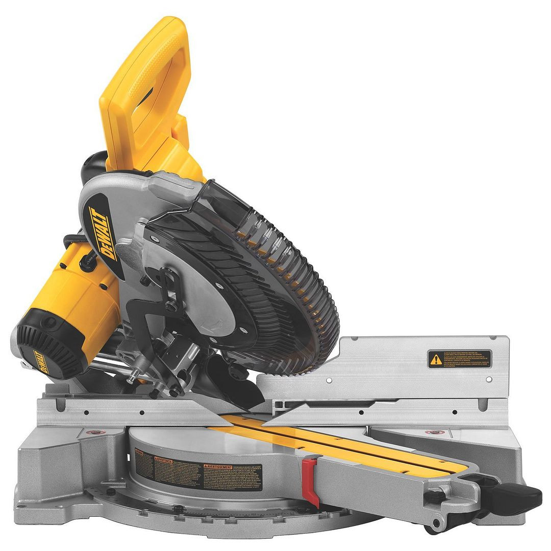

                                                                                          Today, a boy became a man...
                                                                                          I bought my first (and hopefully last!) 12" blade dual bevel sliding compound miter saw...
                                                                                          It was chosen after reviewing the specifics of my needs in this project and some others I'm considering, and after a lot of thought last night, about the concept of precision and repeatability, as epitomized in this picture, of the measurement of my ripped front panels for 15" wide.
                                                                                          I decided it was a necessary investment considering what I'm trying to build. I think the DWS780 is one of the best conceived and designed models on the market, after quite a bit of research this weekend. We'll see how I feel a few weeks from now!

                                                                                            #360
                                                                                            Cool Jon, I have a cheap harbor Frieght that works ok, but is onlly for much smaller scale. One of those would be another thing.
                                                                                            However, I picked up, for free 8O , a mint condition 1970 or so Sears Craftsman Radial Arm saw that I have yet to try. Back then, the Craftman stuff was very good quality. It is in near perfect condition and is built from almost entirely steel and aluminum, except for the switch buttons. An older gentleman in the neighborhood, who had walked by and seen me working on speakers in the past, stopped by to offer it to me. He was moving and was no longer using it and didn't want to move it. He even had his movers dfrop it off at my house. It's amazing the number of things it can do, though I haven't done anything so far but read the owners manual. It is a 10" though, so it duplicates my table saw in many ways.
                                                                                            Dan N.
