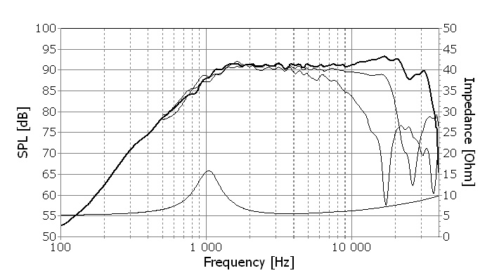

                  Well, this is something I've been thinking about, how to do this and capture some of the best parts of what this configuration does.
                  well, let's just say I have a plan for a Mini-Me proof of concept, and have selected a likely driver complement that looks pretty promising. I'm really focussing on high bang for the buck drivers with the right acoustical properties to do what is needed in this same configuration, but smaller- think about 12" wide instead of 15", and 50" tall instead of 62". And I think I may be able to save enough on the driver cost to put in some of the good stuff in the crossover filters; not just the same topology, but high grade components, too.
                  Overall will keep a similar concept- sealed bottom end, double woofers in series, a very flat and smooth midrange driver, and a tweeter with the right dispersion characteristics.
                  Note similarities in upper range dispersion
                  High sensitivity with smooth response in upper crossover region (2500 Hz)
                  I may be able to modify an M8ta cabinet for the bass section in a proof of concept exploration- we'll see. The idea is to use selected high grade caps still in the midrange and treble- Jantzen Superior Z. Though I'd prefer to go dual 10" woofers, finding the right drivers with regards to parameters is tough- I have them - Aurasound NS10-513-4a, but those are hard to source, and with dual 8's using the RS225-4, we should be in fair shape and save money for the crossover components. Network has to be very similar to what I built for the big project- that's the trouble with trying to do a good 3 way on a budget- too often compromises are made in the crossover.
                  Now, let's see, I could do a hack job on my M8ta cabinets and cut off the front panels to create some "bass bins"... do one for 8" woofers, one for 10" woofers, maybe test the Arum Cantus AC-250SW as well as the NS10's... geez, GF is going to kill me!

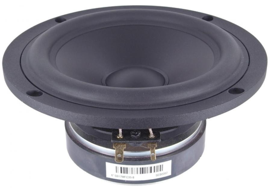

                    You may also want to consider the SB17MFC35-4 from SB as the midrange, ever so slightly less sensitive but with a well controlled cone giving a reasonably smooth response.
                    http://www.madisoundspeakerstore.com/approx-6-7-woofers-sb-acoustics/sb-acoustics-sb17mfc35-4-6-poly-cone-woofer/
                    Zaph has measured the 8 ohm unit and it basically has class leading HD for the price too and it's cheaper than the scan.
                    Whether or not this saving would be countered by requiring a slightly more complex crossover I am not sure. In my experience a controlled rising top end typically only requires a more aggressive low pass and as you'd be using a 3rd order network anyway that should have the required flexibility to get the curve to hit the desired target.
                    The Scan does look nice, but looking at Zaph's measurements of it's smaller brother, that also includes the shorting ring, if the motor trend remains, it's clear that the SB has the Scan pipped in absolute terms.
                    The only question could perhaps be small resonances in the 800-1500kHz region so typical of soft cones, but these seem almost unavoidable.
                        SB Acoustics Woofer SB17MFC35-4, 6" Polypropylene Cone, 4-ohm version. Vented cast aluminum chassis for optimum strength and low compression.
                        Click image for larger version  Name:	sb17mfc35-4.jpg?time=1687549863.jpg Views:	0 Size:	59.9 KB ID:	941571
                        Click image for larger version  Name:	sb17mfc4-graph.png Views:	0 Size:	20.0 KB ID:	941572
                        Click image for larger version  Name:	SBAcoustics-SB17MFC35-8-HD.gif Views:	0 Size:	22.7 KB ID:	941573
                        Click image for larger version  Name:	Scanspeak-15W8434G00-HD.gif Views:	0 Size:	21.1 KB ID:	941574
                        Very good suggestion, and moved to the top of the list! It certainly looks quite workable...

                                            Click image for larger version  Name:	Satori-MW165DC-08N36-DA00-HD.gif Views:	0 Size:	24.3 KB ID:	941577
                                            I think the NE180 would be a safe bet for almost all who are interested, my only slight worry is availability, is it odd that it's been removed from Mad's part inventory? Still you can always go to PE.
                                            The little SEAS tweeter is a no brainer and will no doubt be around for years to come as will the Dayton reference subs I think. Considering that this alternate version would mainly be aimed at giving diyers something cheaper, but still high performance, to build, I'd figure that driver availability would be a rather significant concern.
                                            Yes, you hit the nail on the head with that comment- don't want any un-obtainium drivers for this effort. Got enough of those in the current version!
                                            I figure the mid is pretty critical, as well the bottom end- I looked at all kinds of drivers, trying to find a nice 10", but not really much luck. The RS315HF just makes a lot more sense if it models correctly- should get around to that kind of analysis by this weekend. The other ironic thing is, I'm not concerned about how it models as a sub, but as a woofer! My past measurements show going to 300 shouldn't be an issue.
                                            For "premium" 3 way, my preference is a woofer with 10-12 mm of xmax and reasonable sensitivity (86-87dB), and from my experience with the Isiris so far, I like how stacking 2 four ohm drivers works out as far as impedance control and net system impedance after applying the crossover and dealing with mid and woofer overlap (which usually drops the impedance a bit. The total system sensitivity won't look great on paper, but in the real world it will be fine the typical range of solid state amps, say 50-200W/ch. It still makes a fair bit of noise with 2.83 VRMS on the input sweep! The RS315HF has only moderate sensitivity, but I'm guessing (before analyzing) that two will work fine in this cabinet, given that the HF's cone mass is about 200g, compared with the NS12's 130G. With Erse iron core inductors, insertion loss should be minimal.
