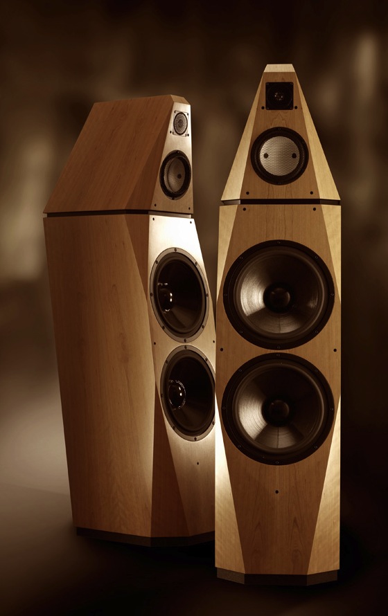

            The final documentation of the build plan is being completed...
            The target is a classic configuration known to many, and the long time object of consideration with variations by this thread.

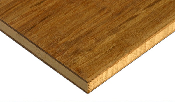

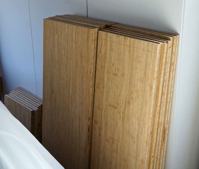

            But after consultation and further design exploration, a somewhat radical implementation has been chosen, eschewing the use of conventional construction materials, and pursuing an all LBL constructed design, using Natural Fossilized LBL ply sheets as shown.
            Past experience using LBL selectively in projects has highlighted its superior properties; the hardness, stiffness, and low resonance and durable, attractive surface make it a very interesting material. Discussion of how the material is used to advantage in the final design will be presented shortly. In the past difficulty has been finding a vendor for sheets of the necessary size. That has been solved, and 530 lb. of material were delivered to the orbital assembly facility yesterday.
            It is expected that a construction can be completed without the use of veneering, further simplifying the build process, and finishing with a combination of tung oil and satin polyurethane varnish.
            Woofers and midrange will be of the underhung Neodymium construction for low distortion; only the tweeter choice is yet to be finalized, pending the results of some measurements and audition.

                Oh man, that is gonna score big points for the dark side if you make the baffle out of multiple layers, slice through it on an angle and reveal all of those lovely bamboo cross sections.
                Greg
                P.S. Was the source in your sector Cali Bamboo? How much does the dark lord negotiate his LBL for?
                  #278
                  The Dark Lord does not negotiate, he tells them how much he thinks he should pay. :roll:

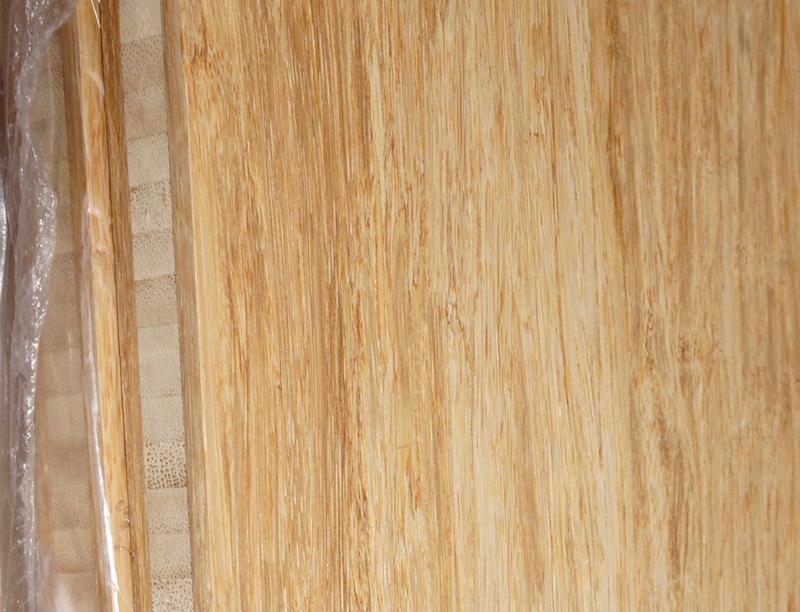

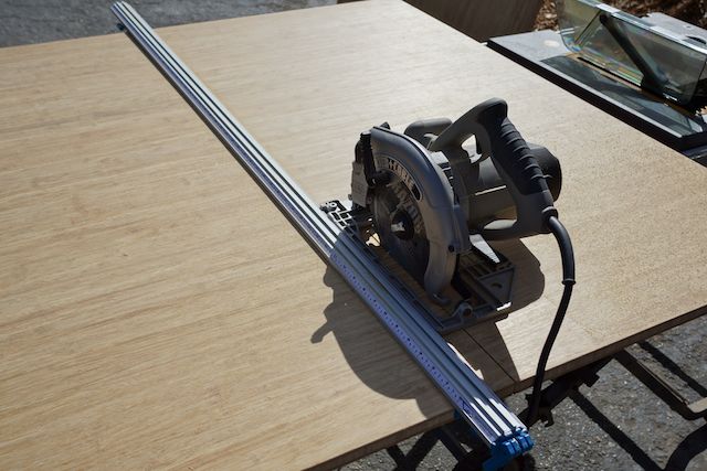

                              Some progress...
                              Large sheets require divide and conquer...
                              At the end, most of the base cuts were completed; front panel pieces and sides/backs ready for lamination.

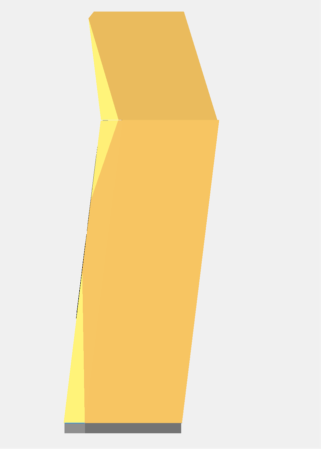

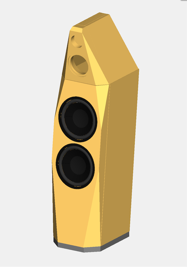

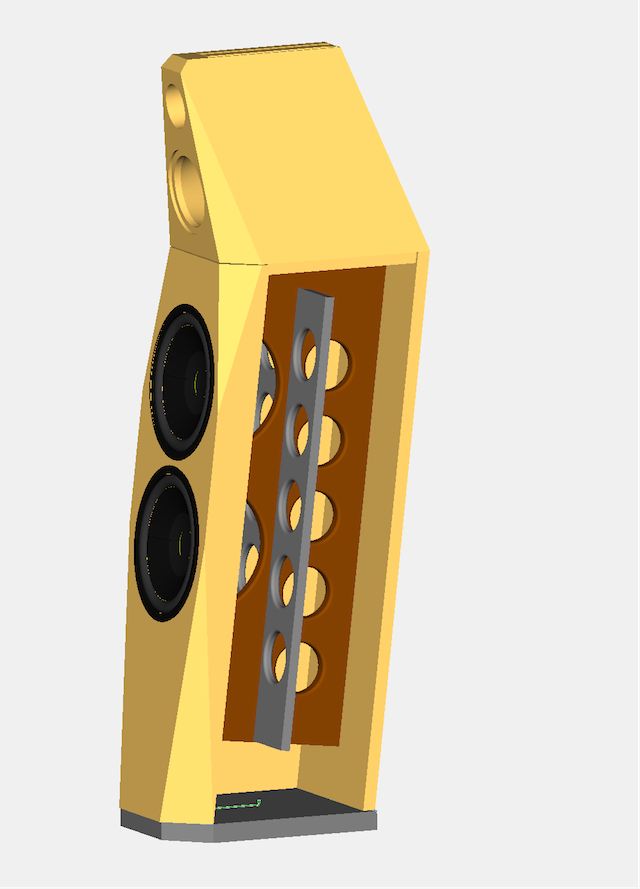

                                The plan is nearly complete. Simplicity of construction is preferred....
Name:	DS Braces.jpg

                                  Why tilt the top section forward? If you keep it sloped backward in line with the bass section you will get a degree of time alignment.
                                    #287
                                    I'm not seeing the simplicity, but I like it! :T
                                      #288
                                      There is a good and perhaps non-obivous reason-
                                      Consider a seated position about 2-1/2 meters from the cabinets.
                                      Of course, the crossover phase response influences everything, but using a Duelund target transfer function with a center frequency of 900 Hz and adjusting alpeh for nominal crossover points of 300 Hz and 2800 Hz, if the target is followed accurately down to at least - 20 dB, within this range all drivers will be in the same relative phase, something not accomplished with more conventional approaches to three way systems.
                                      Standing will compromise this somewhat, but given the difference in the distance/length required for a low frequency phase shit, I'm not expecting serious issues. And due to the direction of the phase shift, the response holds on better moving above the ideal tweeter/midrange position than moving below it.

                                        Have you factored in the relative acoustic center of the midrange to the tweeter? Generally its about 1 inch behind.

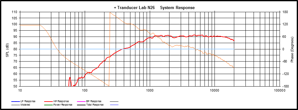

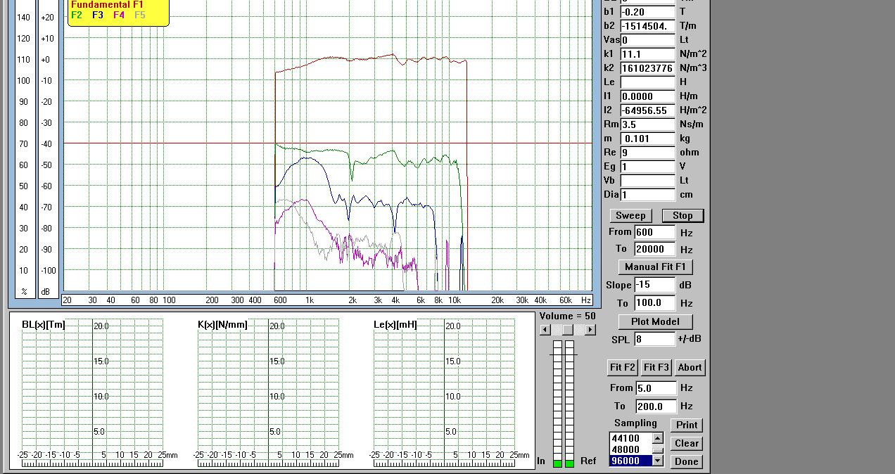

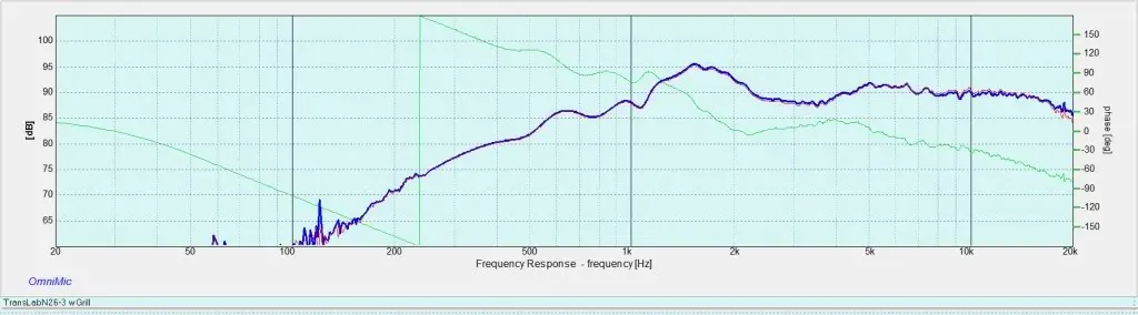

                                                            On a true IB tweeter test setup, Jeff B. got very reasonable results-
                                                            And also got the kind of results you'd expect when mounted on an enclosure (16 X 9 baffle), and BSC and diffraction peaking raise their heads...
                                                            Curious to see any other data, obviously I've got to do my own once I can find some time... next weekend, hopefully.
                                                            Nearfield tells the tale... all else is implementation.
                                                            Otherwise, it's back to some 6640. What I'm really curious about is that I haven't seen anyone measure the N26c above 20 kHz.

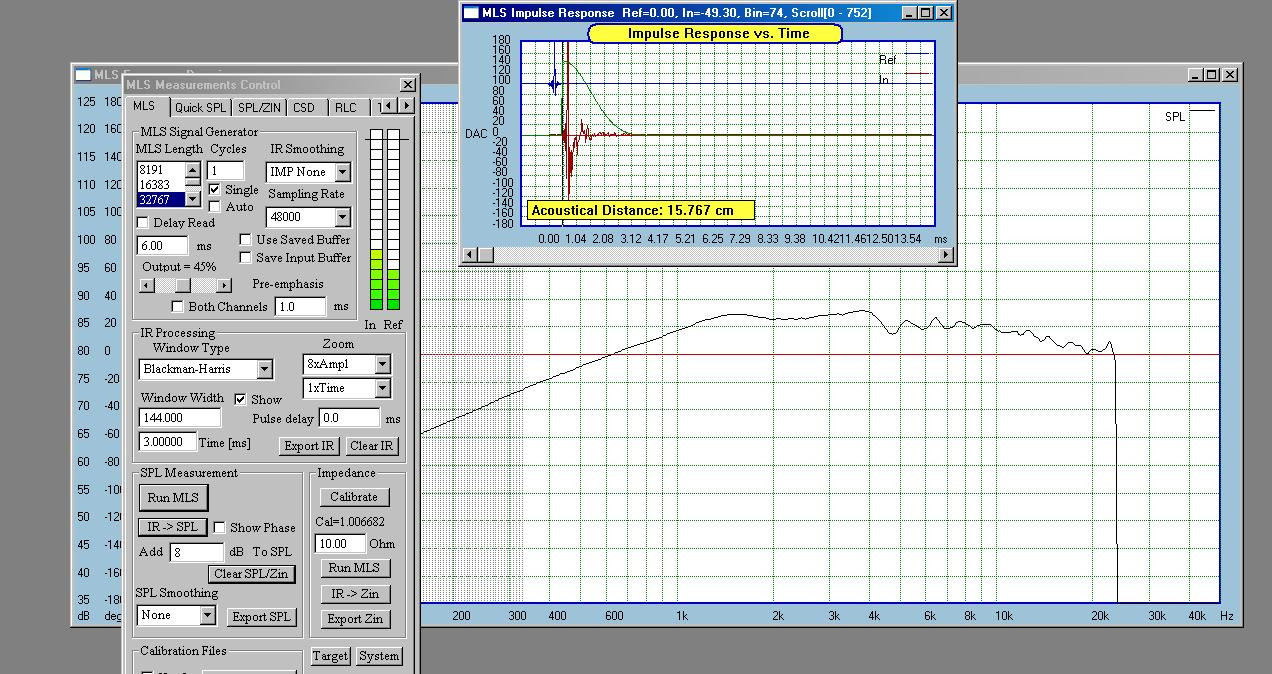

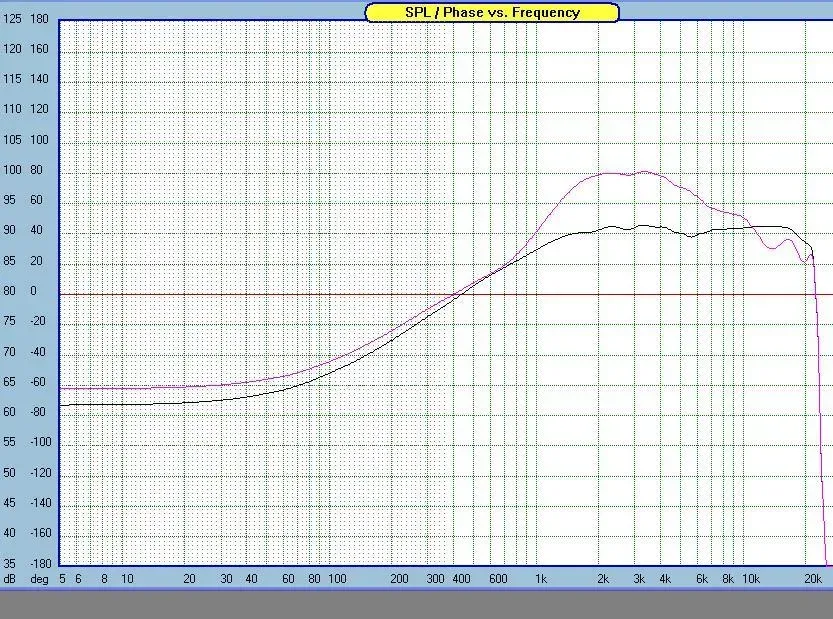

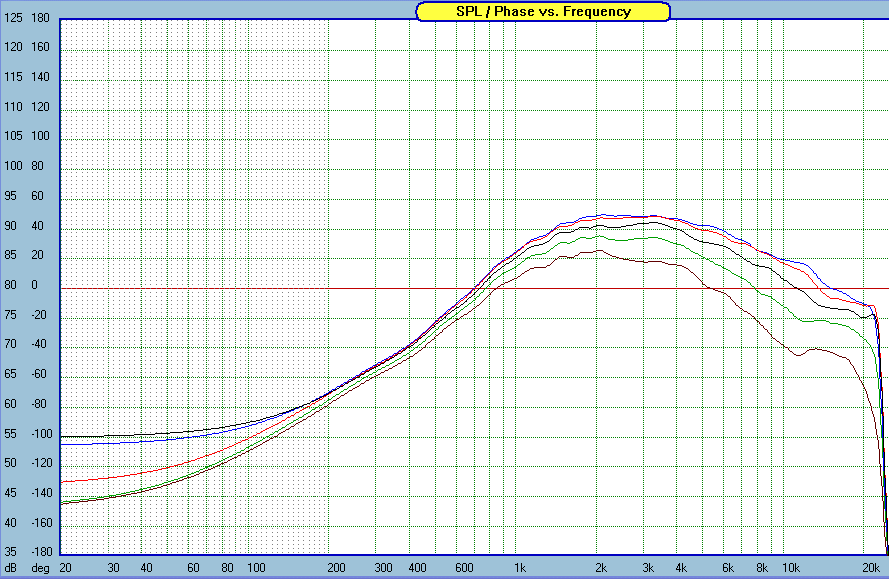

                                                                          Here you go Jon.
                                                                            • 16168
                                                                            #307
                                                                            Interesting- thanks for sharing-
                                                                            Any info about baffle mounting, measurement mic and distance? I usually do both ultra near field, which reveals the IB response, and of course, measurement on the target baffle design, which shows what I have to work with in a specific application. In one like what's discussed above, the tweeter will not be especially flat looking, for raw response, because the BS will be at a fairly high frequency- which creates more work for the crossover designer, but has potential to improve the off axis power response.

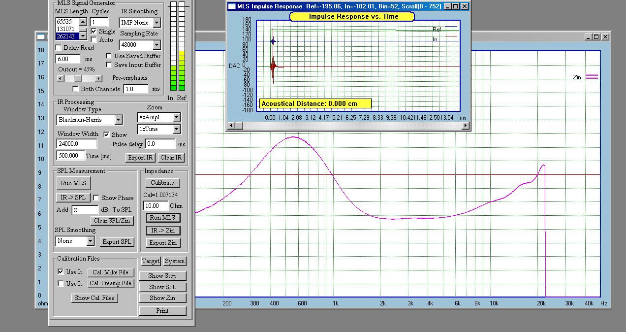

                                                                                          Wow, those N26C results look very different from mine. Below is one in a waveguide 0-15-30-45-60 horizontal off axis, followed by one infinite baffle juxtaposed with an early waveguide.
                                                                                          BTW, this is for the N26C-A. There is now an N26C-G, which is about .7db more sensitive, but more importantly, has a rising top octave, which may do a little better yet in the waveguide. I will have a pair of the "G" version soon.
