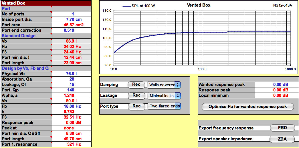

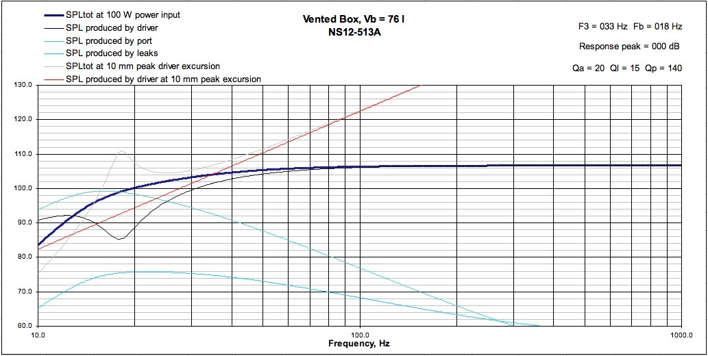

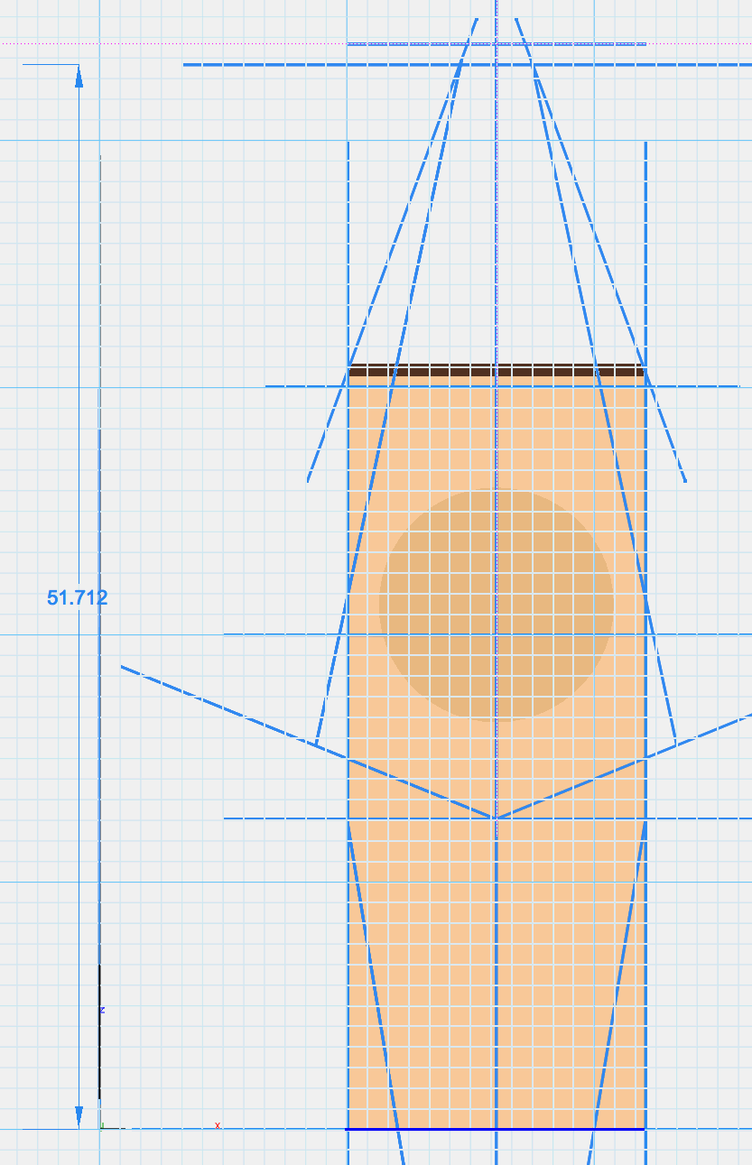

                    With regards to the proposed low frequency alignment, these plots should be sufficiently informative...
                    With a nominal room boundary lift of 6 dB in the low freqeuncies, in room response per cabinet at 1meter will comfortably extend to 20 Hz at over 106 dB. Perhaps not capable of reproducing the full effect of the main drives of a fleet Stardestroyer as heard in the engine room, but it should be sufficient for most music applications.
                    The 76 liter bass enclosure will have a width of 14.5", a net cabinet height of 36", and a depth at 90 degrees to the front or rear panel of 18". The midrange unit has a net height of ~ 16", for a total height of ~52".
                    This partial screen shot should convey the concept....

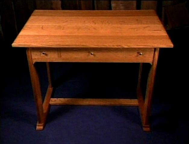

                                                          #208
                                                          I'll be happy to take this on.... told the wife I didn't want a Christmas present this year, just wanted to be able to build some speakers this summer. She told me I have a budget of up to $5000.00 after listening to the M8ta's. :E
                                                          The only catch is that I have to build writing desks for both of my daughters (Arts and Crafts Library Table design for you woodworking types) with matching chairs and she wants a "game" table for our family room made with a Santos Rosewood inlayed top.
                                                          Looks like I'll be making a LOT of sawdust this summer!!
                                                          Tom

                                                            Because of the modular construction planned for the midrange enclosure, the C90-T6 (the old Accuton part number for that driver) can be measured and included as an option. It's greatest advantage over the C89 is the ability to play louder, with lower overall distortion. A duel NS12-513A crossover desgin will be published, with the C90-T6, but probably not built in the Imperial labs- this is where the "Y" in DIY comes from.
                                                            This is an excellent plan. I also like the Picses II idea. Looks like we are going to have our work cut out for us.

                                                              #210
                                                              Originally posted by rjr1
                                                              This is good news. :B
                                                              I concure with the driver selection provided but I am not sure why Madisound has them both listed as subwoofers.
                                                              Aurasound also has the NS12-513 and the NS12-794 listed as subwoofers. However, because of the longer throw on the 794 it may not perform as well......
                                                              The frequency response also differs slightly.

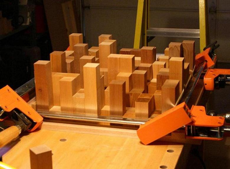

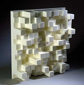

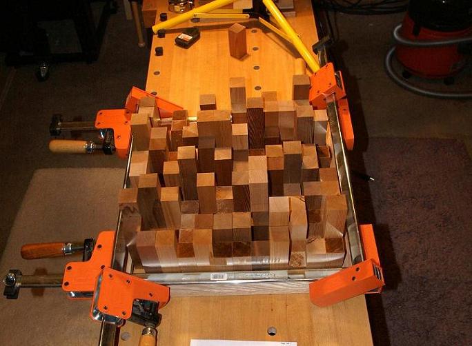

                                                                                I'm working on some DIY acoustical treatments while I'm waiting for Jon to work out the design - might as well get the room in the best possible condition if I'm going to take on this new challange. Attached are two pictures from my workshop of a 2-D diffusor that is similar to the RPG Skyline product (which is the third picture). I've used cedar as the wood because it's light (and smells REAL good). I purchased the cedar in a rough form and I had to plane and cut the pieces which took about 2 hours prep and about 1/2 hour to cut the individual blocks. Total cost so far is about $22.00 US. The array is 18 inches square and should be effective in the range of 900 to 4600 Hz. This is just a prototype to see how the process will go, I'll need about twelve of them and they will be combined with six 2 foot by 4 foot bass traps spanning corners and made with rigid insulation that I pruchased a few years ago.
                                                                                Had six guests over for a party last weekend - nobody could believe that I actually made the M8ta's. Every single person sat in the audio room for over 5 hour listening to music. It was like musical chairs as everyone tried to sit in the sweet spot - lots of fun!!
                                                                                Tom

                                                                                  #220
                                                                                  Tom,
                                                                                  do you also have a website which describes the construction/ calculation of these? I should have it somewhere in my bookmarks, but cannot find it anymore (website has some calculators to optimize for a certain frequency band).
                                                                                  Taco
                                                                                  • ColoradoTom
                                                                                    • 332
                                                                                    #221
                                                                                    Originally posted by TacoD
                                                                                    Tom,
                                                                                    Taco
                                                                                    Taco..... here you go.
                                                                                    Calculator:
                                                                                    Construction (this link shows a rather simplistic and not very attractive method using precut material - I made changes by ripping cedar/redwood stock into perfect 1.5 inch material to use for the blocks.):
                                                                                    I've made 1-Diffusors in the past.... these seem to work much better. I'll be cutting up more boards today and then I'll be spending the next several weeks gluing things up.
                                                                                    Tom
