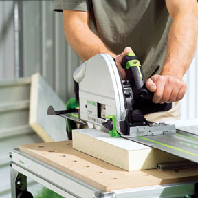

                                      New developments from the inhabitants of the Festool System that have aligned with the annual celebration of my birthdate have indeed given rise to a new tooling system called TS 75.
                                      The following specifications look most impressive: :E
                                      The TS 75 plunge-cut saw will enable you to cut through your workload like never before. Take on bigger projects with our largest cutting depth yet - 2 15/16" or 2 3/4" with the included guide rail. And with 13 amps of adjustable power, the TS 75 has plenty of muscle to spare - powerful enough to cut through steel doors. And it won't tire you out as quickly since it weighs less than 14 lbs. A limit stop and slip clutch drastically reduce the effects of kickbacks, making the TS 75 much safer to use.
                                      Delivery of this new tool will be within the week and testing will commence over the next several weeks. With a few simple jigs and the advertised depth cut of 2 3/4" the proposed cabinet 2" sides and 6" front should be a managable process. Additionally, having used the rail guide system in the past, highly accurate and repeatable cuts can be made with the invisioned jigs.
                                      Tom
                                      • tyler
                                        • Feb 2007
                                        • 101
                                        #244
                                        Tom

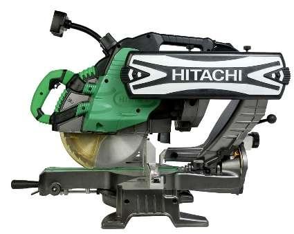

                                        Another option for cutting the baffle edges is the Hitachi C12LSH 12" sliding miter.
                                        Of coarse these can also be done on a 12" left tilt table saw.

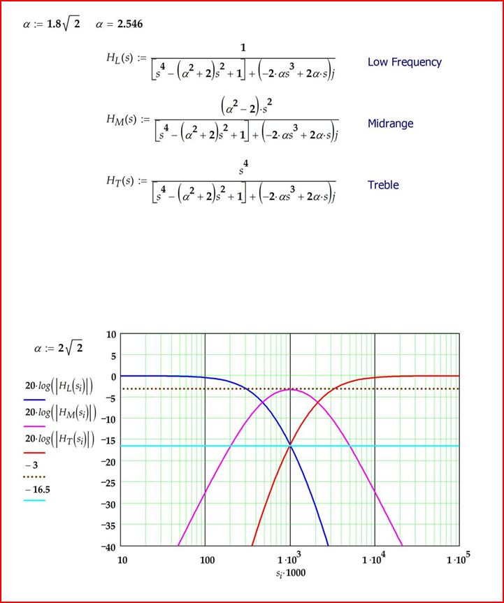

                                                The most challenging philosophical question is whether it will be possible to adhere to a Duelund approach, or if driver limitations will dictate a more pragmatic approach.
                                                A proposed Duelund target response for Accuton C89 or similar will be evaluated soon.
                                                My schedule has been cleared for the first week in September - only this matter shall occupy my time and attention.

                                                                      With regards to the proposed low frequency alignment, these plots should be sufficiently informative...
                                                                      Click image for larger version  Name:	Unibox-Data.jpg Views:	1 Size:	201.1 KB ID:	941444
                                                                      Click image for larger version  Name:	NS12A-76L_Plot.jpg Views:	1 Size:	150.8 KB ID:	941445
                                                                      With a nominal room boundary lift of 6 dB in the low freqeuncies, in room response per cabinet at 1meter will comfortably extend to 20 Hz at over 106 dB. Perhaps not capable of reproducing the full effect of the main drives of a fleet Stardestroyer as heard in the engine room, but it should be sufficient for most music applications.
                                                                      The 76 liter bass enclosure will have a width of 14.5", a net cabinet height of 36", and a depth at 90 degrees to the front or rear panel of 18". The midrange unit has a net height of ~ 16", for a total height of ~52".
