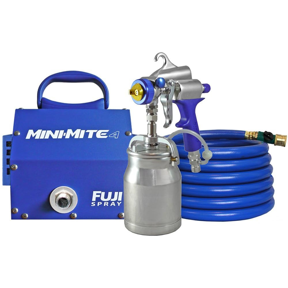

                                    This was ordered today,
                                    along with filters and a Blogs Aircap set for spraying clear lacquer.
                                    Ah yes, I love the smell of lacquer in the morning... :B
                                    I've got to get impedance data measured, then I'm off to the races evaluating three alternative crossover concepts in LspCAD. I have some of the crossover parts on hand. We'll see how it goes...
                                    Fortunately no heavy duty business travel in sight until March and April.
                                    You tell your daughter I'll supply you with a full set of PDF's once the crossovers are complete. :W :B

                                              #652
                                              along with filters and a #3 Aircap set for spraying clear lacquer.
                                              I happened to run across this FAQ on the Fuji website...it recommends the #4 aircap for lacquer. It also has other recommendations. I would still try the #3 though, with the water-based finishes I used, I had to turn the fluid nozzle pretty low.
                                                • 16203
                                                #653
                                                http://www.fujispray.com/technical/#lacquer_hvlp
                                                Thanks for the Tip and the link! I'll check that out, and of course I'll be practicing on scraps first!

                                                        Cool............ new tools/toys are always fun!! I can't set up a spray booth until both of the girls have left home! :cry:
                                                            I LOVE that smell!!!
