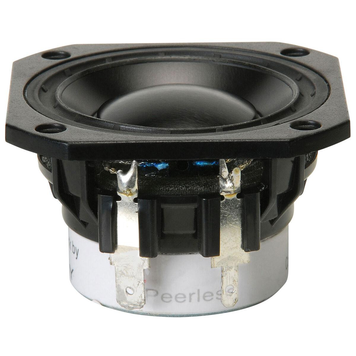

                                            What about the new peerless full range? It featueres a neodymium motor an aluminum dome and copper in the motor. One problem, however, it is an OEM driver.
                                            Last edited by theSven; 22 June 2023, 19:48 Thursday. Reason: Update image location

                                              Pretty remarkable range, but I get nervous when they don't publsih an Xmax, power ratings, and the sensitivity number is that low. Still, I'm sure they're not building it unless they have a good market for it- Upgrades for Bose HT Satelites, anyone?

                                                12 cm² cone area, that's hardly more than a tweeter.

                                                  Also a 3" is coming out in february, yes the product is aimed to accompany their LAT offerings. I just wanted to inform you on the newest offerings of Tymphany.

                                                                                          Not at the levels which a Peerless 830883 achieves over a narrow frequency range, but nonetheless impressive... most impressive. Probably very usable wtih 3-5 kHz crossover with LR4 or better. Certainly an extended range for a cone device in it's price range.
