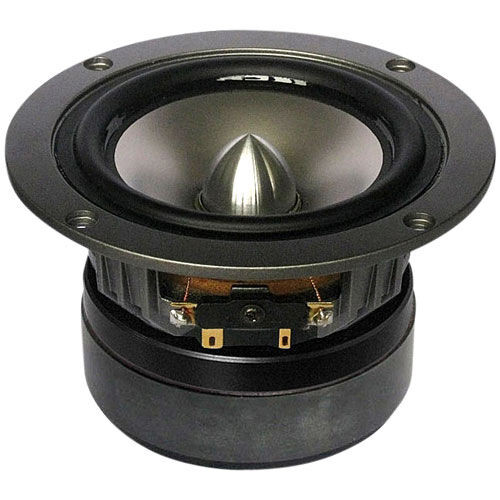

                                                                            Tang Band is a company that could be pretty scary if they really got their act together. They make a lot of stuff for other folks (can you spell Adire, Ascendant?), I'm also curious how the 25-1414SC tweeter plays out, for the small form factor applications.
                                                                            Those glitches in the impedance curve would naturally worry me, could be just surround resonances. The FR plot DOES look pretty amazing, especially if it really hits 87 dB/watt with a DCR of 6.8 ohms (which would make it a fairly "real" 8 ohm driver). I wonder of the response plot is smoothed overall? That hump centered at 15 kHz looks too clean to be a "normal" metal cone breakup.
                                                                            With 3 mm it ought to be usable above 250-300 Hz. And paint it black to disguise it, huh? ET would like that, I bet.
                                                                            OK, you talked me into it, I'll try to get a leg up on this, beat ET to the punch.
                                                                            Order placed....
                                                                            Sorry you didn't get hardly any free time at CES. I think the Venetian thing caught a lot of folks by surprise, though I'd informed a few that were going.
                                                                            Looks like Smith and Larson are doing some interesting things... just what I don't need, more things to spend money on!
                                                                            Last edited by theSven; 22 June 2023, 19:31 Thursday. Reason: Update image location

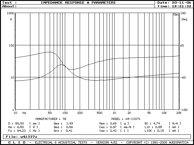

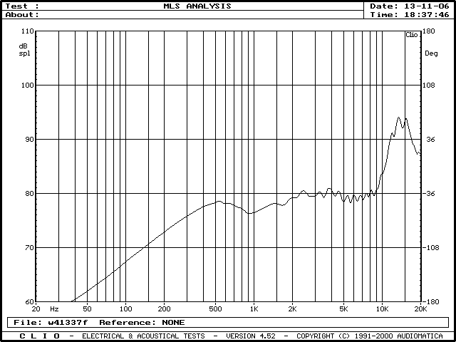

                                                                                Hi Jon,
                                                                                I'm also very interested in the TB W4-1337S and have been doing a little research on it. I don't remember where I found these measurements but they're not quite as nice as the published ones. I'd really enjoy hearing your thoughts after looking at them.
                                                                                Thanks!
                                                                                Last edited by theSven; 22 June 2023, 19:35 Thursday. Reason: Update image location

                                                                                    Hi David,
                                                                                    Yes, I think you're correct. Darren's measurements aren't smoothed nearly as much as the one on the TB website but it's not too far off. They should work well as a mid range I'd think. It looks like they could be easily pushed above 3K which would open up lots of tweeter possibilities. :T
                                                                                    If they sound as good as the Visiton Ti100's John Pastuck brought to the Iowa DIY event, they're a killer mid. The drivers look like twins with perhaps a better motor design for the W4-1337S.
                                                                                    I know the distortion measurements from KT weren't that great on the Ti100's but the SQ was awesome. The mid range had a mesmerizing holographic sound to it. The Accuton 3-way that followed it was similar in the midrange. That is a huge complement because the Accuton design was simply superb sounding. It was easily one of the best sounding point source speakers I've heard.
                                                                                    Thanks for jogging my memory!

                                                                                            Hi Jon,
                                                                                            Actually Darren had forwarded the email and measurements to Curt who posted it on the PE board. Here is Darrens message that should help clarify things a bit.
                                                                                            (paste)
                                                                                            I finally got around to running a couple curves on that TB Titanium driver
                                                                                            that I have in my basement. Unfortunately, I don't actually have any hosting
                                                                                            service right now, so thought maybe you could upload these somewhere and put
                                                                                            a post on the Tech Talk board referring people.
                                                                                            The graphs aren't really good below 500 Hz or so because of my
                                                                                            hacked-together setup.
                                                                                            Overall, it looks pretty good I think. In the waterfall, some of those
                                                                                            little zigs above 3k are indeed a ringing artifact of some sort, and not
                                                                                            just ripple in the measurement. But, I suspect that they are IM distortion
                                                                                            products from that huge peak, and with the proper filtering wouldn't be an
                                                                                            issue. The inductance is also very low, and as John pointed out those
                                                                                            impedance zigs looked bigger in the TB graphs because of the scale. Within
                                                                                            normal mid/woof working range, these look pretty flat, and it appears that
                                                                                            these could be a very nice mid or small woofer.
                                                                                            I'll also point out that the titanium is VERY thin, so anyone who buys one
                                                                                            should be careful when touching the cone.
                                                                                            (Feel free and post some or all or a modified version of my comments if you
                                                                                            want.)
                                                                                            Have a good one!
                                                                                            Darren
                                                                                            A couple other comments from posts:
                                                                                            Even in my hacked-up setup, it was essentially infinite baffle. I think the baffle was 4' by 6' roughly. I had a bunch of junk layin' around it, so had to cut my time window a little short.
                                                                                            And the driver was not properly flush-mounted, which I usually used to do on any true "mids".
                                                                                            I would say that the dip around 1k is real, though it may not be quite as deep when properly set up. Even so, I don't think it is anything too severe in the grand scheme of things.
                                                                                            Also, I forgot to mention to Curt that the drive level was arbitrary, so don't take into consideration the overall sensitivity.
                                                                                            (end of paste)
                                                                                            I hope that adds a little clarity to the mesurements.
