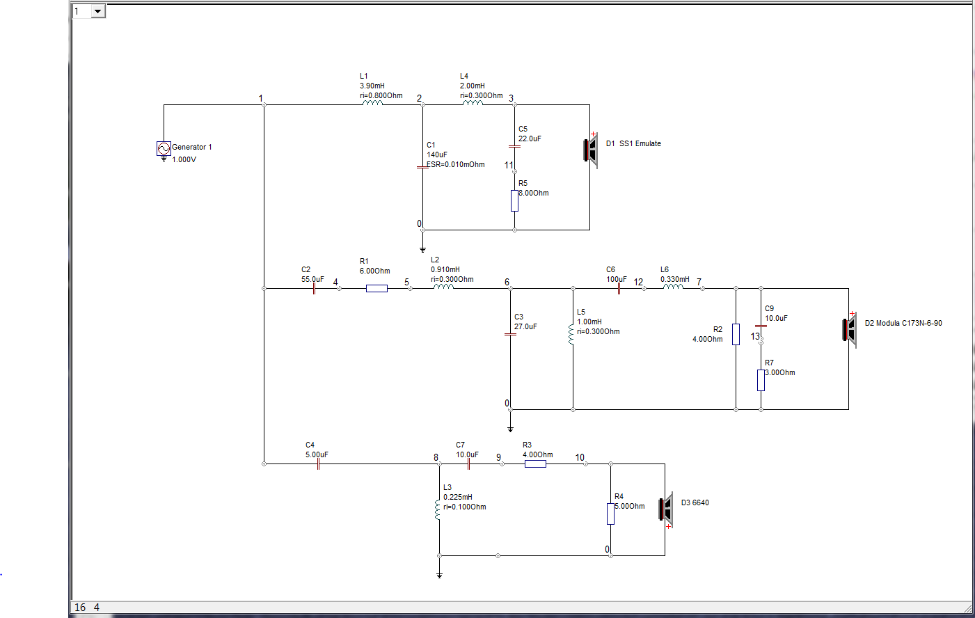

                                          Work is back to
                                          normal
                                          with a vengeance...
                                          Well, being employed is a good thing, but there can be too much of a good thing! :roll:
                                          As a result I still haven't had time to get setup for the new cabinet measurements. But as frustrating as that is, I took some earlier measured data on somewhat different baffles and have taken a full pass through on a prototype crossover, which looks pretty promising on several levels. I stayed up late last night working on this... can't do woodworking or testing at those hours, but can prototype crossover on LspCAD.
Name:	JanuaryMid Isiris Concept Schem update.PNG
                                          • Sealed system means Fs impedance resonance is at a low enough frequency that I don't need an LF zobel to kill the interaction with the crossover- for a ported version, this will still be required, I suspect
                                          • Driver data is fudged for tweeter- using D3004/6640 Be tweeter data for modeling the top end for now. Using older Aurasound data measured in different cabinet but with identical width.
                                          • 3rd order three way all pass concept seems to be panning out nicely, and have deep notches with out of phase driver connection
                                          • Using 3rd order all pass eases the design issues for the upper transition band for the midrange, due to steeper roll off, and it looks like the LCR networks for driver equalization at the upper end will be uncessary. (yes, that means lower cost! Who would believe? )
                                          • The midrange seems to need enough attenuation due to it's high sensitivity that the L-Pad shunt resistor will swamp out impedance variations to a degree, and the LF mid zobel may not be necessary.
                                          • Mostly ditto for the tweeter, it's looking fairly simple at this point (subject as always to future change).
                                          • There is some voicing built into this network, but not as previously discussed. Too early to get into this, pending final measurements and evaluations with external components.
                                          • Oh, and crossover points are 300 Hz and 2500 Hz. Just for the record...
                                          • Once again, EVERYTHING subject to change, with notice. :B

                                            #606
                                            Considering some of your past designs, the component count here is quite low! That must be a bit of a bonus too
                                              • 16109
                                              #607
                                              It wasn't just a bonus, it was a Design Goal!
                                              With a low slope like 2nd order L-R or Duelund on the bandpass, you really have to manage the driver behavior at the outside limits of it's working passband. With a 3rd order All Pass, like the Modula MT and NatalieP, (which were realized with quasi-series crossovers, not practical here, and not wanting the HF signal to go through too many parts), we're attenuating the transition band faster, and I think this may be a good tradeoff as regards signal path, driver attenuation outside the pass band, AND as you note, total parts count.
                                              Of course, the proof is in the pudding, many a slip twixt the cup and the lip, but I have a good feeling about this...
