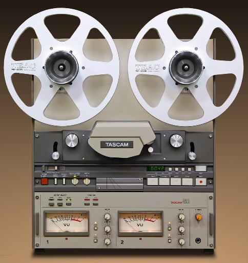

                                  Well, I've been able to avoid GAS..... but I've recently had serious RAS (Reel Acquisition Syndrome) and picked up a reconditioned Tascam 42B/NB deck. I'll be multi-tracking to an Alesis HD24 and then down mixing to the Tascam to get that wonderful 80's analog sound.
                                  Re-living my misspent youth I guess but there is just something about a reel-to-reel that is so sexy (in an audiophile way)!
                                  Tom

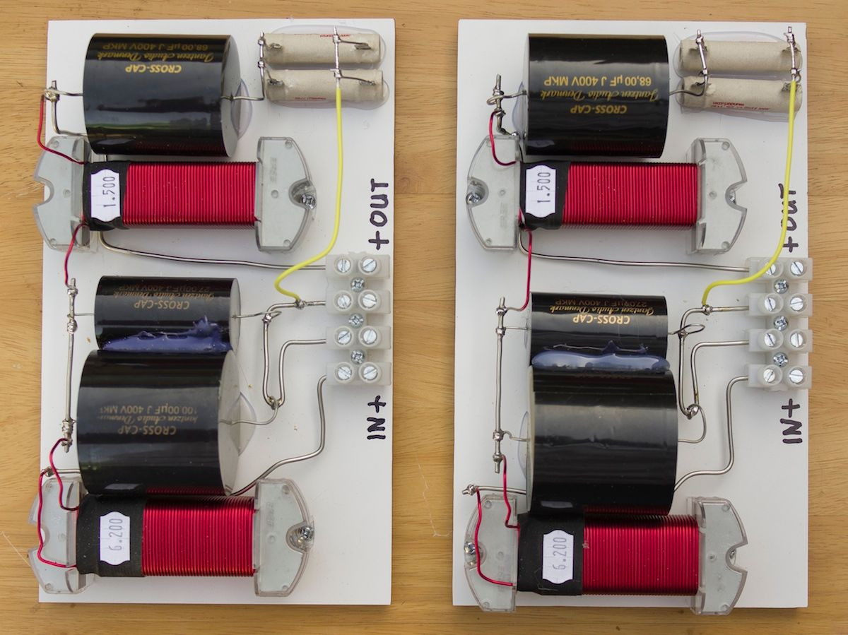

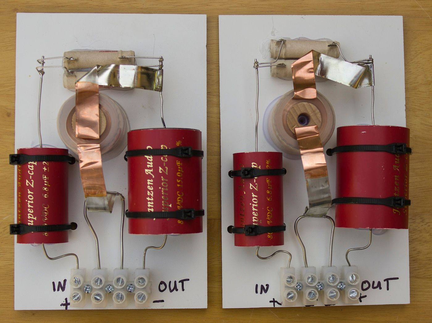

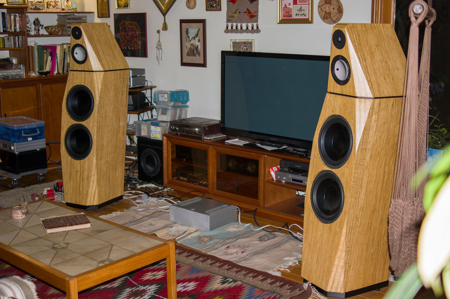

                                                Working on stuff yesterday afternoon and got everything hooked back up- the Cambridge amp is OK after the retrofit in spite of some ribbon cables that came loose which I wasn't sure about the right way to seat them in their sockets.
                                                The new woofer boards are finally connected. Still getting ready this AM to do some measurements, but found I must have left the new tweeter crossover boards at home- road trip time!

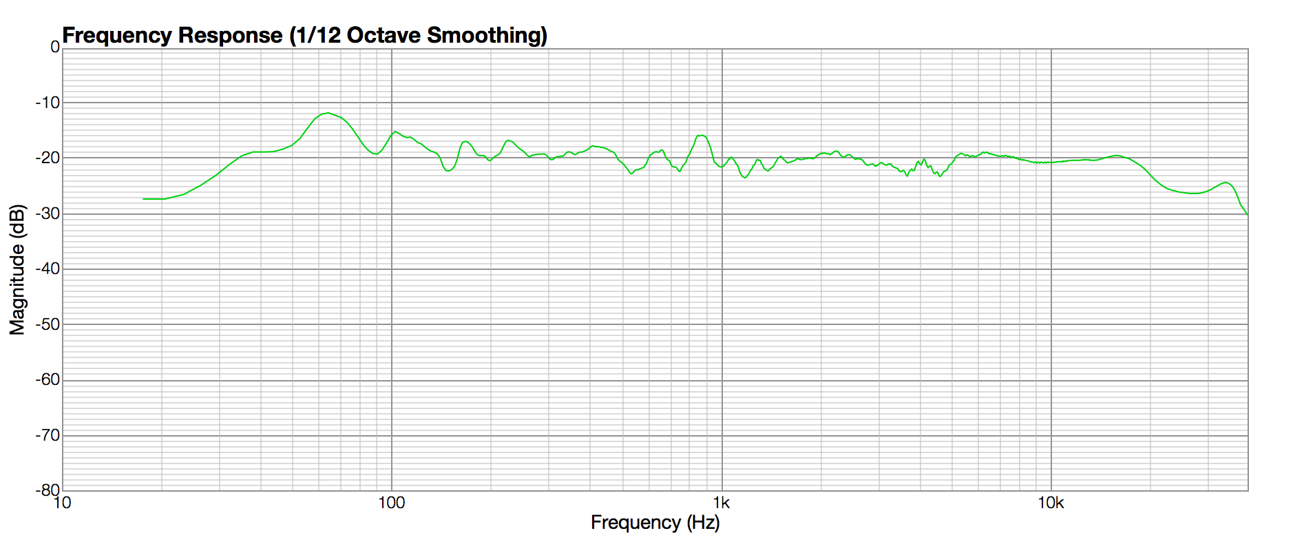

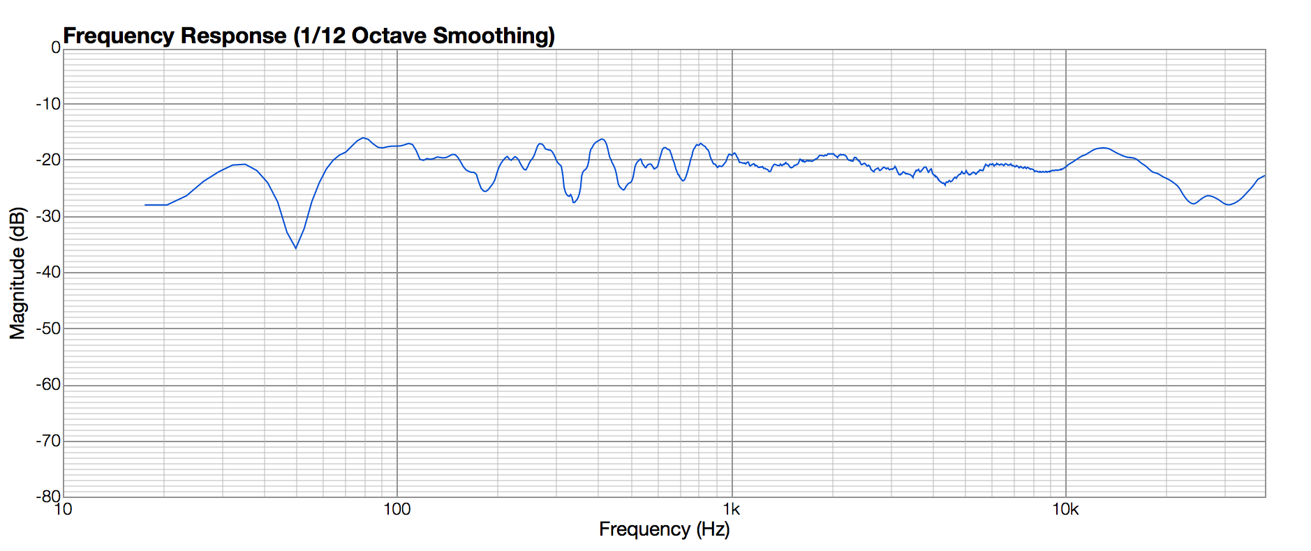

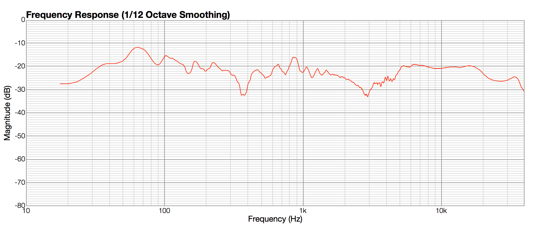

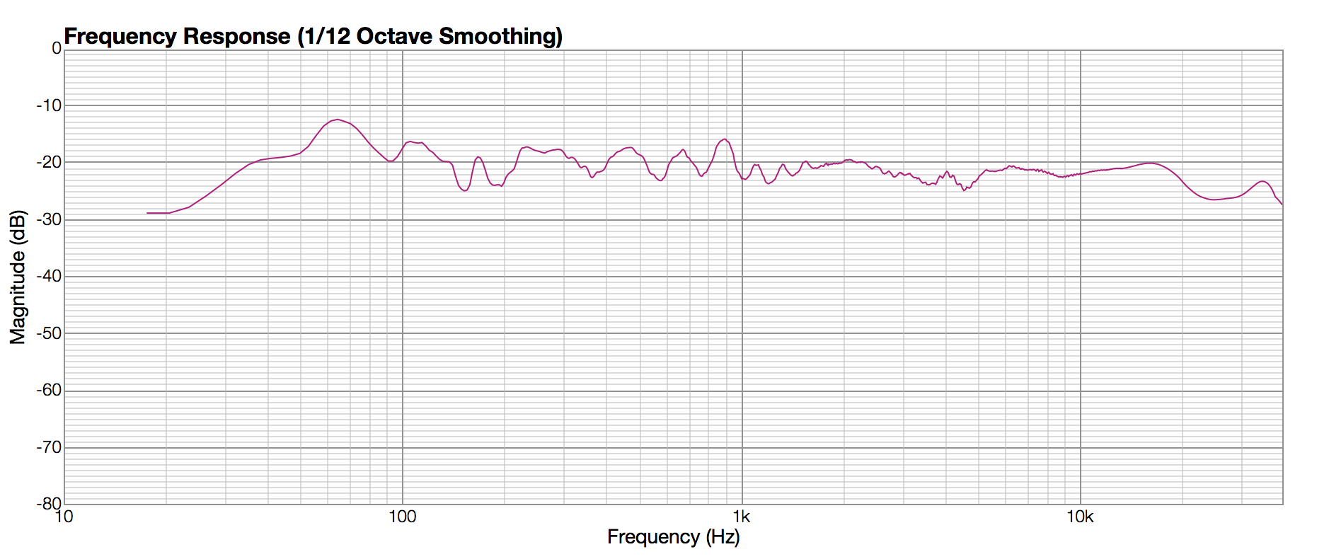

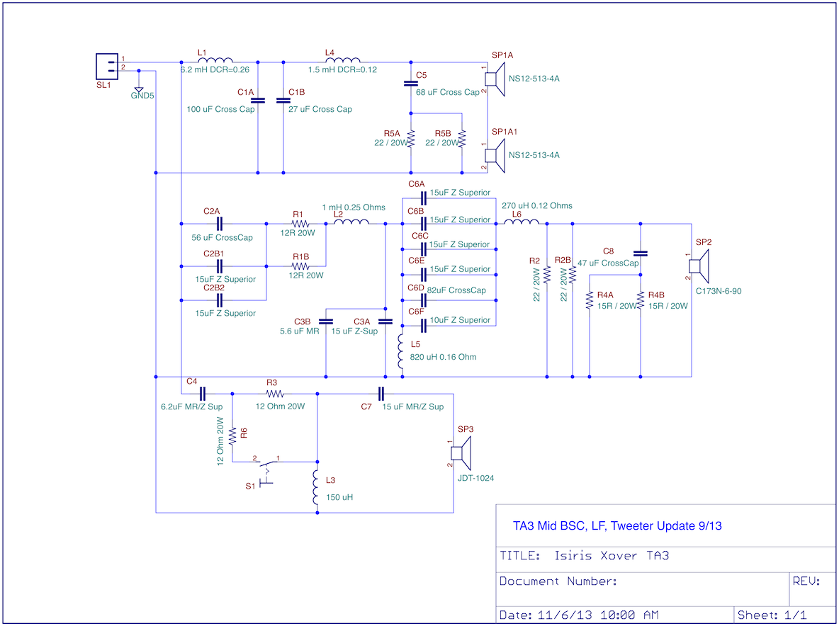

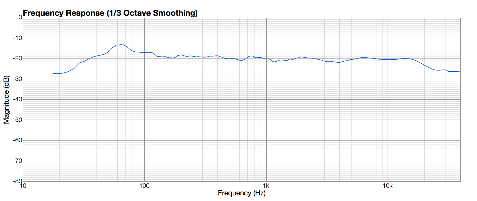

                                                        Well, finally getting around to some more measurements, what with new builds on crossovers to check out, and not having had the time to do ANY measurements since the first cabinet set built before the mad scramble to get a pair together and off to the Northern CA DIY.
                                                        Well, as near as I can tell, I actually wired one of the midranges out of phase in one of the upper module cabinets- because on one cabinet set, it measures normal with all positive phases, as per the original build, but on the second set, that producer a couple of dips in the crossover region for the system, (a slight one in the lower crossover point, a much more significant one in the upper) until I reverse the phase on the mid driver, then everything looks fine. I never had a chance to measure both systems before going to the Northern CA DIY, and haven't had a chance to measure them here until now, though I do admit to thinking the presence region didn't sound right at times from what I remembered at home listening to one system.
                                                        This is the measured response at the listening position in room for the left cabinet with corrected connections with a 150ms measurement window, using a Half Hamming window shape. Note that the measurement window extends to 50 kHz. This is on axis, where the JDT1024 has a bump up in the 13-17 kHz area; it's actually flattest at 30 degrees off axis.
                                                        This is with the newer V2 woofer and tweeter crossovers; the tweeter doesn't really change the response but has better impedance characteristics and less expensive cap sizes! It's been very frustrating to be so busy I couldn't get around to doing this earlier; in fact, I was originally scheduled by the company I'm "embedded" at to be working this weekend, but got my boss to push back on it. Unfortunately, that meant one of our other, more junior guys had to do it. I should feel guilty, but I don't, as he lives down there and has a much shorter commute to Cupertino than I do.
                                                        The newer crossover midrange crossover is less like a B3 alignment and more into the LR3 mode, and will exhibit more issues at the lower crossover point if out of phase.
                                                        Anyway, discovering this problem and the root cause is exciting- I've got to leave now to go look at a storage building of a type we're considering erecting on GF's property, but should have these properly working in stereo for the first time later today! Sheesh! ops:

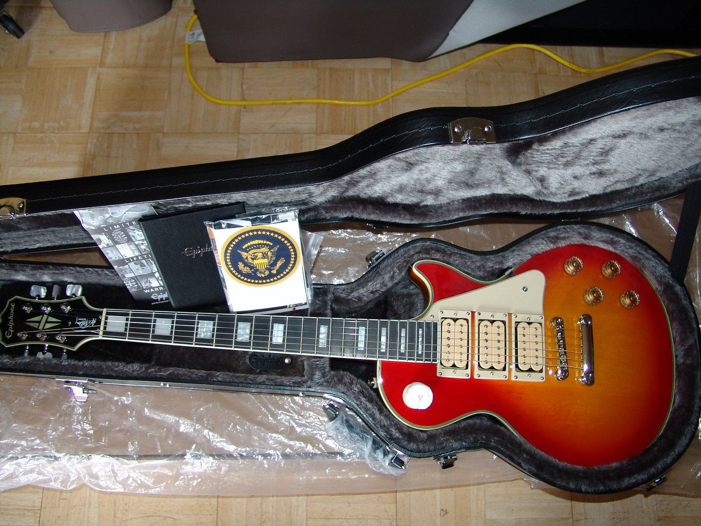

                                                                        Woo hoo! Very heavy small box arrived today with the 1/8" lead sheet I ordered. The Cascade VB3 should be shipping or have shipped from Parts Express, and Madisound shipped the Scanspeak D2904/7100-02 tweeters for the upgrade NatP project, too!

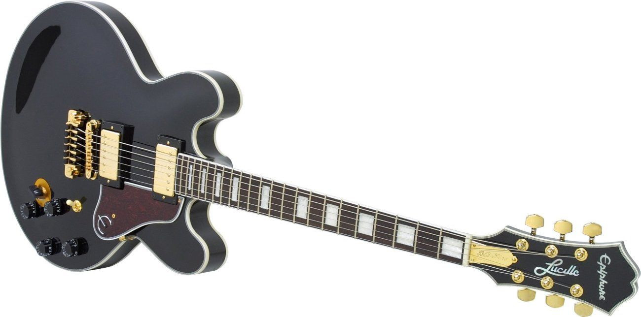

                                                                        And something more immediately fun finally arrived today- haven't been home to receive it earlier this week:
                                                                        It's definitely going to be a musical holiday, in many ways!

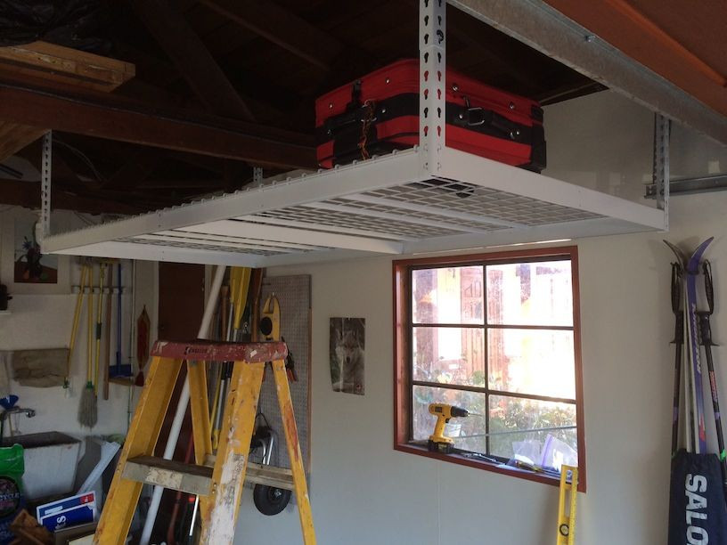

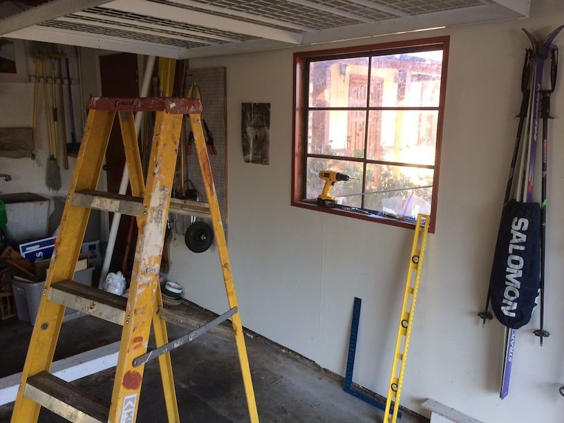

                                                                              Well, it's all part of the parallel processing plan... things that must be done in some sequence though I wish they could be in parallel.
                                                                              The second stage boards of the new midrange crossovers and the jumper wires have been finished and delivered to GF's for testing.
                                                                              But the focus this weekend at GF's, especially considering the crummy weather, and ongoing plans, was to install a hanging storage rack (purchased from CostCo online at a nice price), see how it worked out, and lay the ground for improved storage and buying another hanging storage rack.
                                                                              As a test, GF read the instructions first to try to figure out how to do this (plus, that way she could play supervisor), but as is often the case with things like this, they're written by someone who understands fully how to do this, and doesn't understand how little inherent knowledge or understanding of drawings the average person has. So while I had a question or two here and there, it wasn't anything I couldn't easily figure out on my own, and overall the installation went smoothly once we agreed upon the set of rafter beams to use and the positioning.
                                                                              Looking towards the rack with a normal perspective (i.e., straight ahead, not looking up)
                                                                              Looking up at the rack, to view the storage area
                                                                              Easy for a tall person to walk under, even one of my coworkers who's a Jack Reacher-esque 6'5" (Danish viking, basically- i.e., actually a Danish citizen).
                                                                              The plan of record now, with beautiful unseasonably warm weather arriving, is to test with the new crossovers out doors on the backyard patio next weekend, then begin the cabinet modifications (midrange enclosure damping, new SE-11 concentric cable for midrange and tweeter wiring, and permanently mating the cabinet halves...
                                                                              Slow work takes time....

                                                                                The weather and activity gods cooperated this weekend, for the most part- so by Sunday I got around to doing the testing I had planned for Saturday! The tested cabinet was also the at times problematic cabinet #2, the one with the tweeter internally wired out of phase (as I discovered well AFTER the Nothern CA DIY. For a while I suspect it was the midrange out of phase, which was harder to detect one way or the other with the original Mk1 Midrange and LF crossover, because it behaves like a B3 for the woofer to midrange transition, so it will measure fairly flat through that transition region with either polarity on the midrange. Further checks showed it was not the midrange, but the internal tweeter wiring. That's the problem with trying to build something to a tight schedule and not having time to double check everything thoroughly.
                                                                                Anyway, enough of that, on to the meat of Sunday's work.
                                                                                This is a plot of the right cabinet (it's known as "Clyde" by GF; the left channel, article 1, is known as "Bonnie", and has the little draped navaho mini-blanket on it usually.... quirky girl friend, gotta love her and support her quirks, as she does mine..)
                                                                                This is indoors, with the new LF crossovers, (also as MEB built) the old one piece Mid + tweeter Mk1 crossover, 150 msec Half Hamming window (some long time HF reflection rejection, but decent LF resolution); the notch around 40-50 Hz is a room modal issue due to less than ideal placement at this time (to be remedied in the future, negotiation with GF)
                                                                                This is the same test setup and crossovers, now outdoors, measurement distance of 4 ft, 150msec Half Hamming window. 4ft is about the closest distance for good wavefront recombination, and would be the minimum "near field" listening distance.
                                                                                Bye Bye LF notch. I think the bump in the LF response overall is due simply to the floor boundary, and that being the only boundary- near field measurements of the LF drivers are pretty flat from 40 Hz to 1500 Hz.

                                                                                Here's the response with in phase connection of the midrange driver, all other conditions the same as previous measurements.
                                                                                This looks about like what I expected after the last round of LspCAD sims and the crossover updates that came from that. Note this is at 1/12th octave smoothing.
                                                                                There's still some other work to be on internal damping of the midrange cabinet and external diffraction control and grill clothes. There's some stuff I'm seeing in unsmoothed data that looks mostly like diffraction effects. Time to squash those. (well, when I next get some free time- we're making progress on backfill hiring and getting me back into a more normal role at work).
                                                                                Who knows, with the right work, we may get pretty close to this kind of smoothness- just for fun, 1/3 octave smoothing, like you see a lot of guys posting their designs with. Can't blame them, it looks good this way, and may fairly correlate well with the true balance and smoothness of the drivers and network.
                                                                                We'll have to see how close to this I can get with the next round of work. :W
                                                                                A refresher: the current schematic:
                                                                                The new build has split the midrange into two long boards, so they can fit internally in the cabinet. The changes in the crossover are smaller values for the two series caps, particularly the C2a cluster, and L5 going from 1 mHz to 820 mH. Note, I've actually made the crossover less expensive.... mmm, about time, huh? For the tweeter crossover, I normally have that switch closed (actually, hardwired) but it can be used to provide a softer more polite top end. With my current DAC and electronics, I don't think that is necessary or desirable, but I'm sure if I had my old Benchmark DAC, I'd be flipping that switch open in a heart beat.
                                                                                I did a quick "sound check" before moving on to other chores and errands, just the first cut of these albums...

                                                                                The design will be the basis for the Wavecor Ardent network, too. It may wind up being quite similar.
