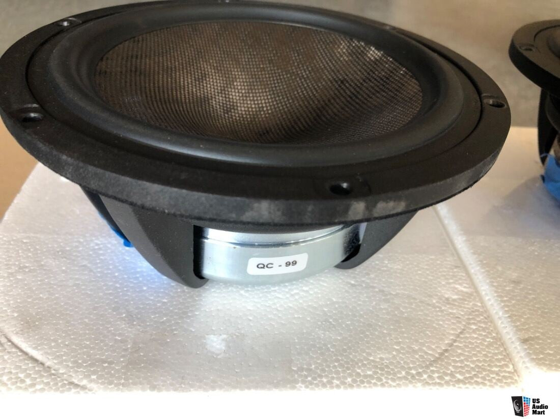

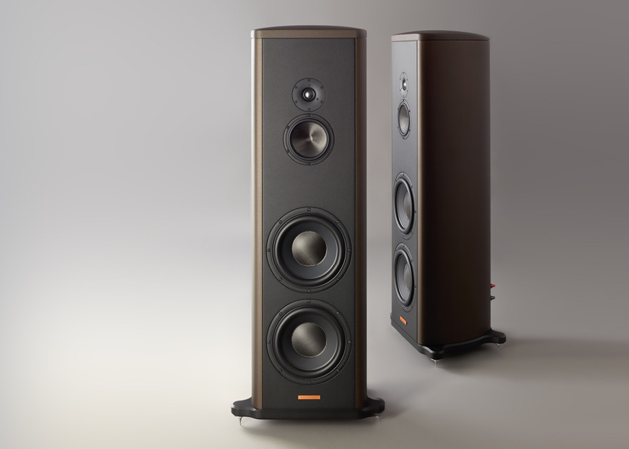

              [QUOTE=JonMarsh;585785]Going by the Stereophile measurements, I wonder a bit how they sound in room- (I've heard some smaller Magico's, which were quite nice) - that large front baffle shows up in a disparity between on axis measurements and off axis power response. [QUOTE]
              Canucks have measured the Magico S5 ((Poor Man's Q5?) and it is stunning!
                • 16168
                #1132

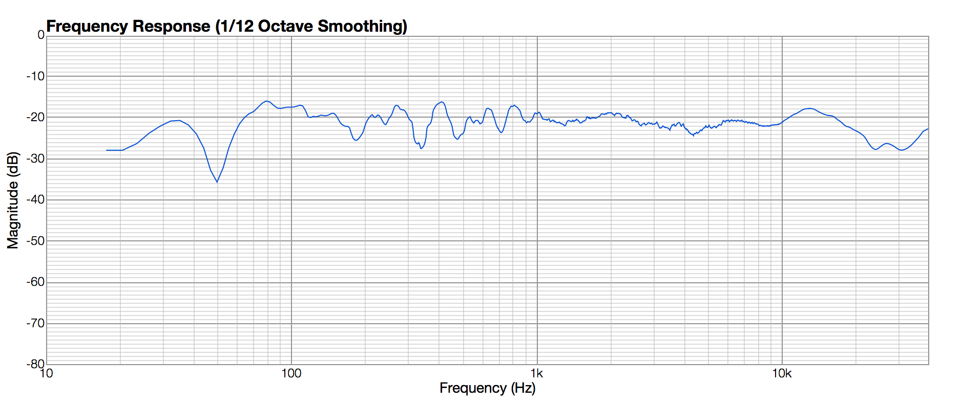

                Yeah, the S5's are making a stir for sure, as they represent something more "affordable" ($28,650 pair) but still very high performance, and with a much more home friendly foot print.

                One of the things really contributing to their success is their very good wideband midrange driver. Interestingly, the S5 uses the same Scanspeak beryllium dome tweeter that we're using in the Ardent project, including the new Wavecor Ardent.

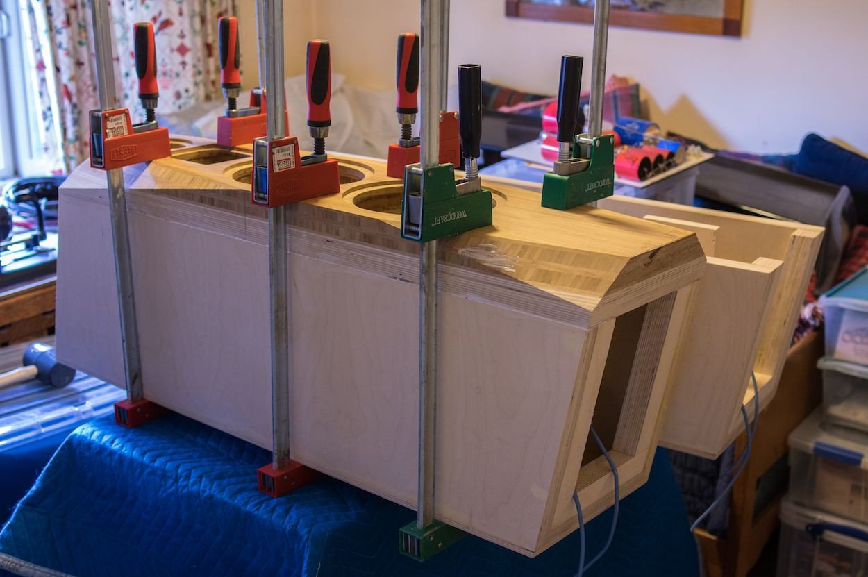

                  Monkey Coffin dry fit check passed
                  OK, it's been sweaty palm time, finishing up detail work on the braces, biscuiting the front panel, top piece, bottom brace, and sides, and then doing my first dry fit check for a bottom module.
                  Click image for larger version  Name:	_DSC1157.jpg Views:	3 Size:	148.2 KB ID:	941428
                  For now, just laying down the braces to check the side to side spacing (by the way, it pays to round over the LBL, because a straight 90 degree corner in bamboo is SHARP! Skin cutting sharp!)
                  Click image for larger version  Name:	_DSC1158.jpg Views:	3 Size:	153.6 KB ID:	941429
                  Nothing but a skosh of the finest blue tape holding these together for a dry check
                  Click image for larger version  Name:	_DSC1162.jpg Views:	3 Size:	163.1 KB ID:	941430
                  Houston, we have a go for launch pad assembly... :T break out the T88 structural adhesive! :B But let's hold off on the champagne for now- maybe just some French Blood Orange soda to celebrate (yeah, not in the same category as a fine tequila, but we've got assembly operations ongoing... )

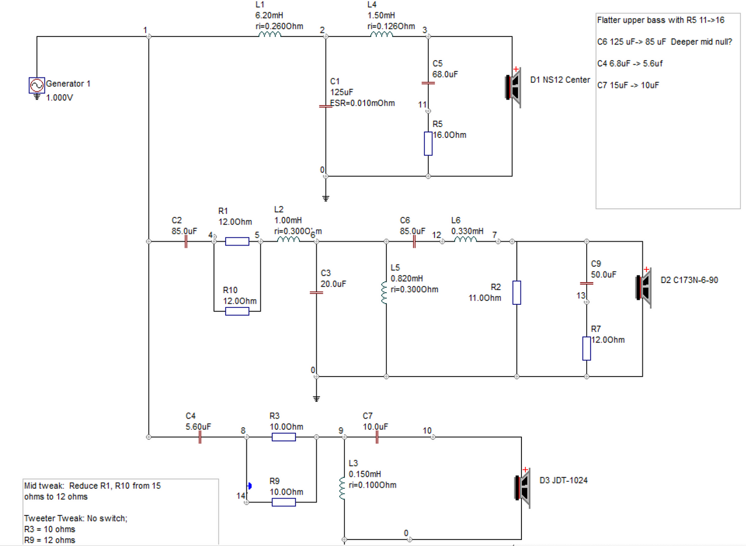

                              Going totally OCD...
                              Refine, refine, refine. Or go OCD. Where's the difference?
                              Anyway, more thinking and tweaking in LspCAD, and ordered parts to implement testing modifications to all three crossover sections, though woofer is only a resistor change...
                              This may just amount to playing around in the error between simulation and measurement, as the measurements look pretty good, but... just in case.
                              Modifications as basically noted in upper text block,
                              • R5: from 11 to 16 ohms
                              • C6: 125 uF to 85 uF
                              • C4: 6.8uF to 5.6uF
                              • C7: 15uF to 10 uF
                              • Some small adjustments to tweeter and midrange level via pad resistors

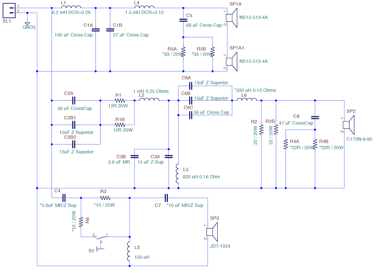

                                  Updated "production" schematic, parts on hand to modify, but the Wavecor Ardent will take priority this weekend, and many to come.
                                  Sill, I'm looking forward to getting to this- maybe over the Easter break while lacquer is drying? :W

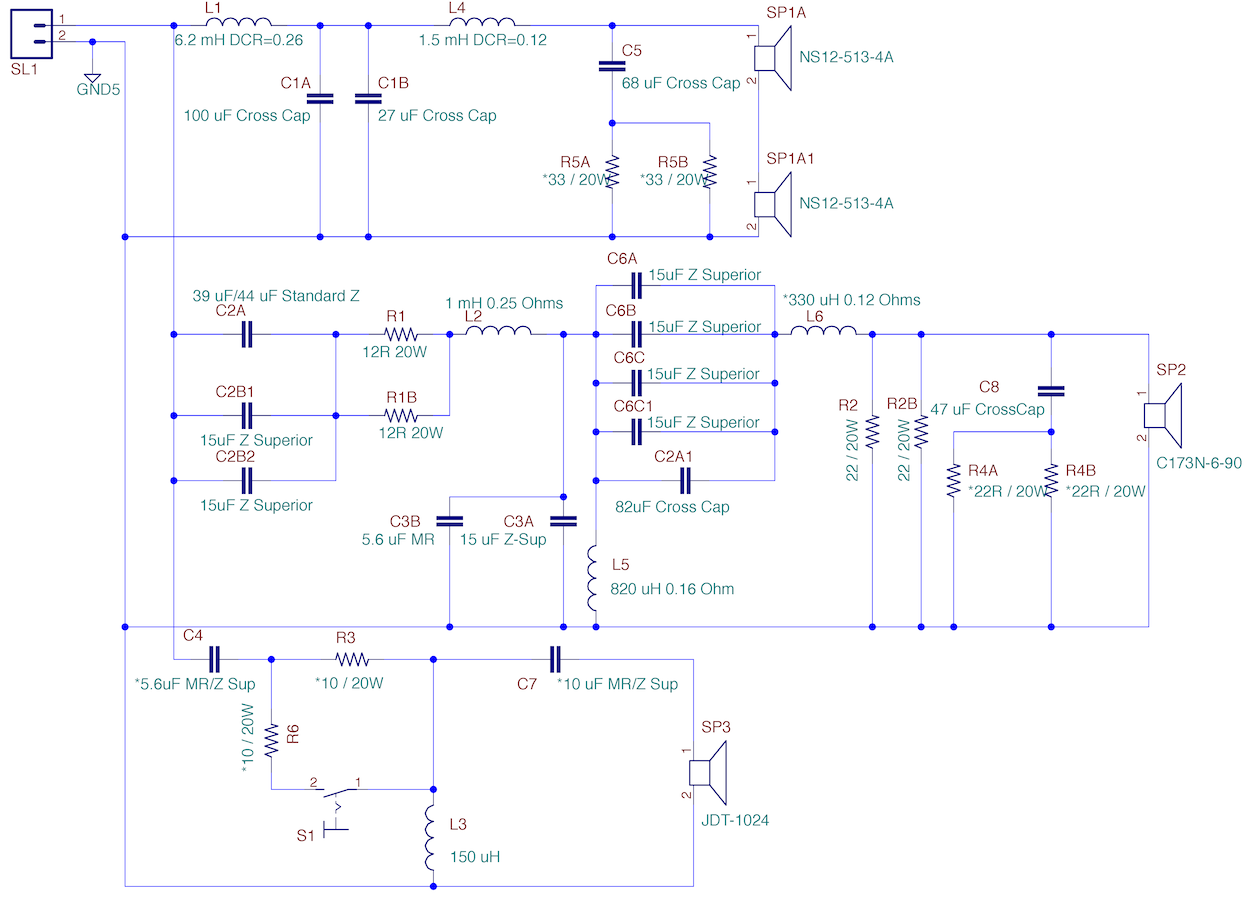

                                                  Going out just a little on a limb, my money says this will fairly likely be the final configuration this weekend:
                                                  The bigger problem won't be modifying and testing the crossover, but getting GF to let me set them up optimally... at least until my friend meets us on June 11!

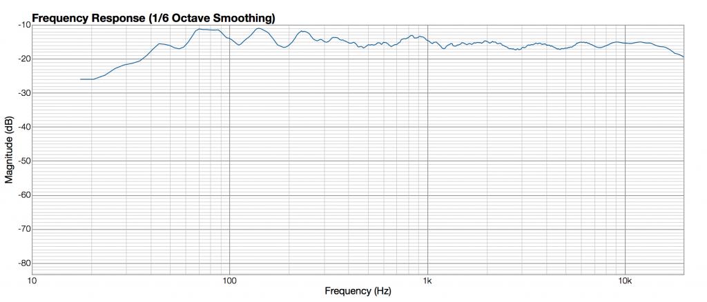

                                                    Have tested the above schematic now- built up a pair of new tweeter crossovers, and updated the value of C2 also, to 72 uF total. It's nice when things measure in room pretty much like the simulation - so there are improved reverse null dips, including depth and more symmetrical, and the overall response is quthe rite smooth if you measure close enough to ignore a lot of the room reflections. Of course, that's not how we listen, so measuring at the listening position on the couch is also an interesting exercise, if not one that often looks all that pretty!
                                                    I also worked on room positioning, getting permission to for now pull them out further into the room and change the spacing and relocate the couch. These all have salutary effects, even when you're listening or measuring 6-8 feet behind the couch!
                                                    This is the "couch potato" measurement, at 15" degrees off axis from the tweeter, as they are not completely cross-fired.
                                                    The goofy thing is, sitting at the work desk behind the couch, listening to on channel of the new Oregon album, or some Jacque Loussier (88.2 kHz material downconverter from ripped SACD) they sound like they have center fill to the middle of the room, even though there's only the left channel playing through the test setup. Hmmm, probably had a glass too many of chardonnay with dinner....:W

                                                      I'll take some pics of the modified setup sometime in the next few days. GF is being fairly patient to let me set things up "right". The problem for me is going to be going back to the old way- pulling the speakers into the room and moving back the couch sounds like it has tightened up everything top to bottom, while at the same time increasing authority on transients, especially LF ones, as we've greatly ameliorated the dip in the 50 Hz area, among other things. Here's the old in room response with the cabinets in the "normal" position- compare with the above in the last post.
                                                      OLD SETUP measurement for Reference
