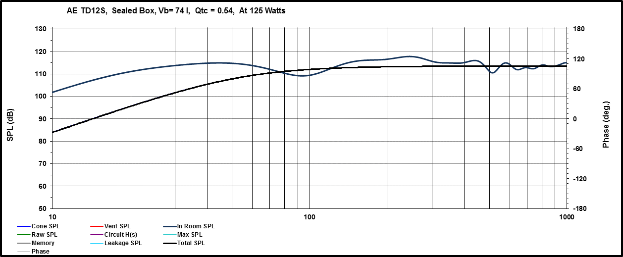

                                                                                  How about AE? http://www.aespeakers.com/drivers.php?driver_id=11
                                                                                  With room gain.

                                                                                            However, this is the update on the complete crossover, with the updated midrange broken down by components. Note that the tweeter caps could be MR or Z-Superior, and the recently built ones are Z-Superior as a test.
                                                                                            Click image for larger version  Name:	Isiris_TA3Post_zps20f0eb99.png Views:	0 Size:	174.8 KB ID:	941536
                                                                                            I need to double check that all resistors are on hand, but I think I'm good, and hope to start the build this weekend for the new midrange boards which can be mounted in the cabinets. The woofer and tweeter boards are done.
                                                                                            Maybe this has been covered. Or maybe its a stupid question but why the swtch with resistance option on the tweeter?
