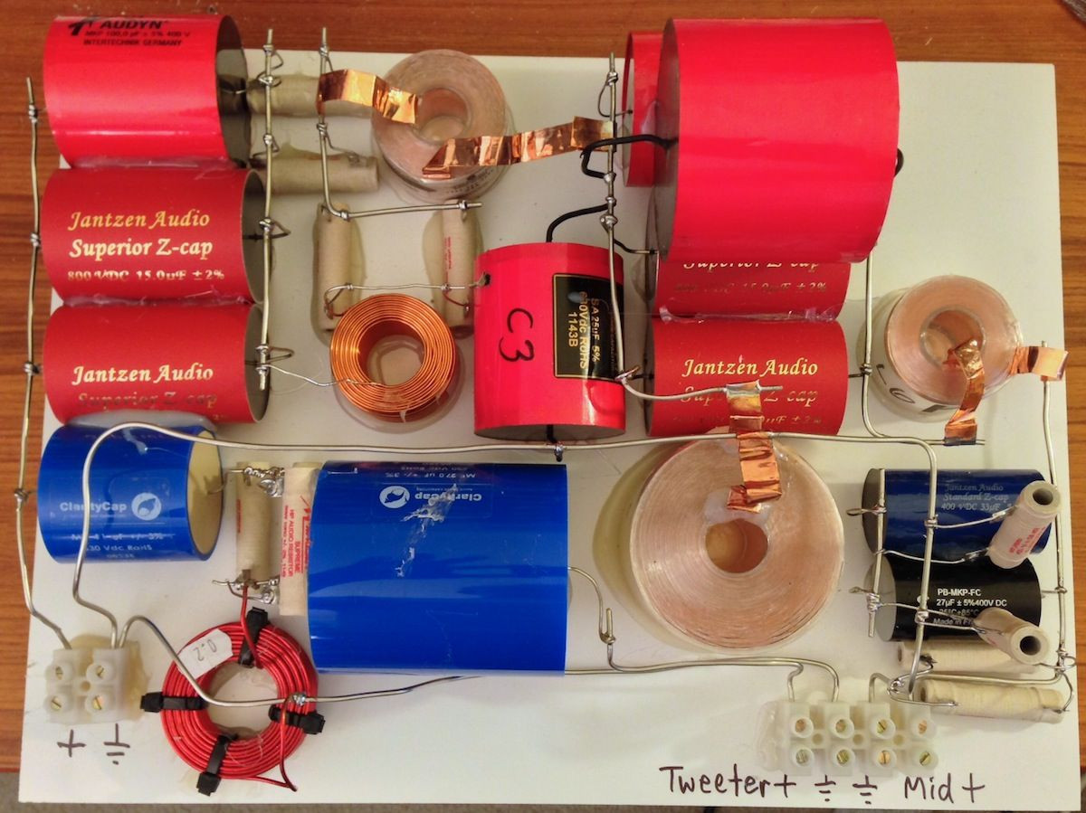

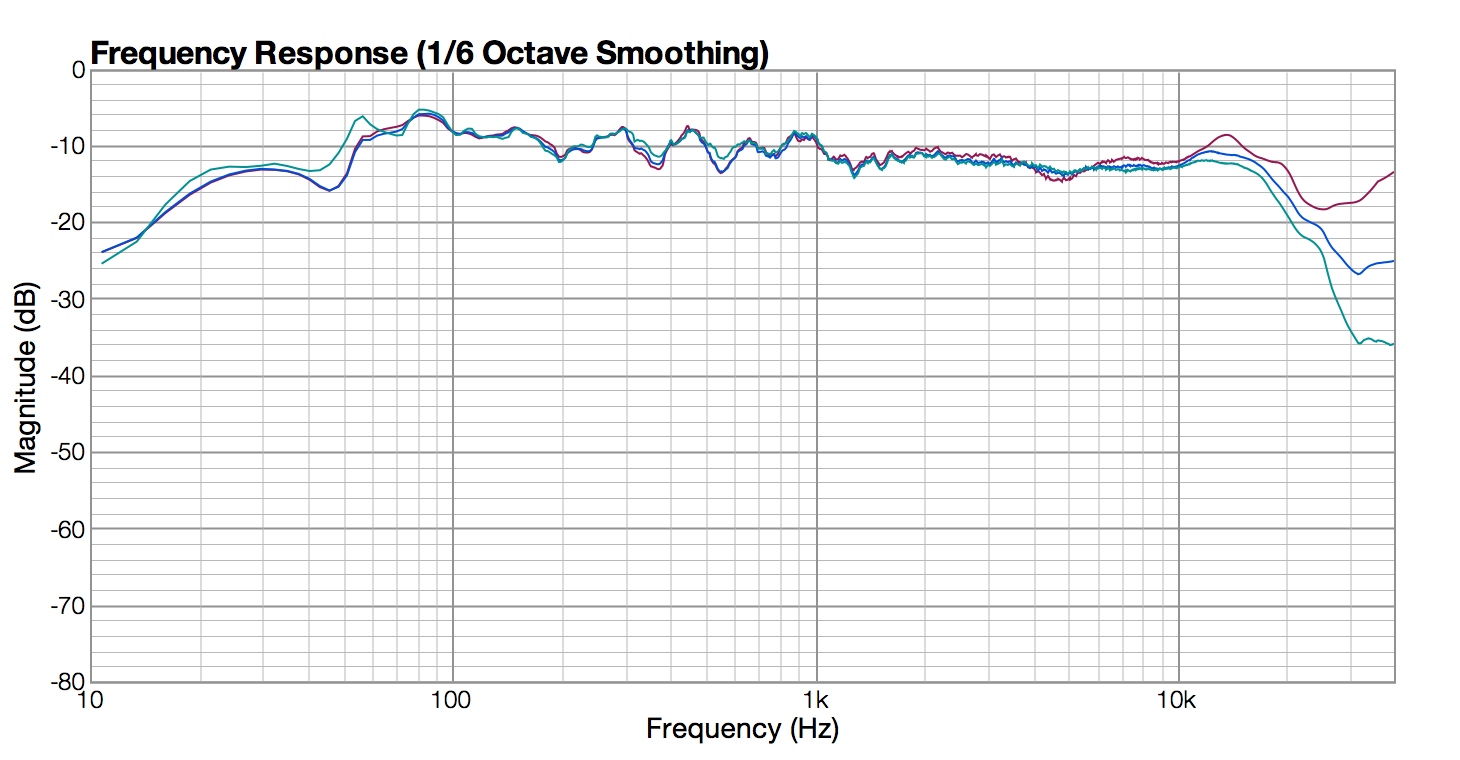

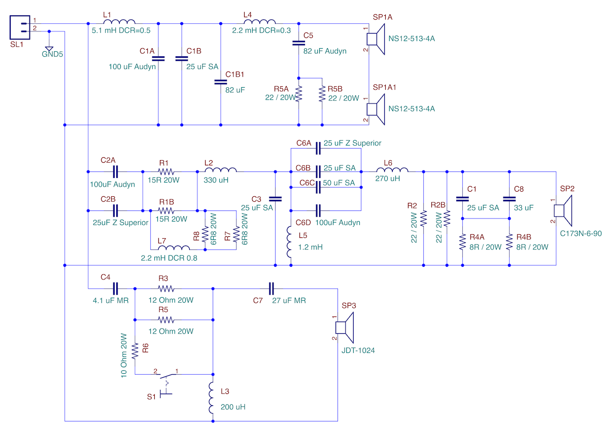

        Crossover update check
        Boy, I sure do love Tuesdays off from work. :B
        I've implemented the last LspCAD updates into the physical test crossover, with "production" components (high DCR inductor for mid BSC, for example; new mid HF zobel caps, new resistor networks, all pretty much doubled up Mundorfs as shown in the schematic).

        I checked all the individual curves for the woofer, mid, and tweeter, and measured the total at 0 degrees, 25 degrees, and 40 degrees off axis (sure do love those two speaker turntables I built, and glad I overbuilt them for the Ardent, as at 250 lb, the lazy susan bearings can cope with the Isiris fine.)
        This is in the "voiced" position with the tweeter level softened, and slightly more roll off contouring on the midrange. Looks good on paper, and sounds quite nice to me, though as I swapped out the preamp to my Cambridge (it's flatter in the extreme treble, and gives more accurate measurements), their are other things that may account for sonic differences than the crossover update. Still, it's in the right direction; clear, detailed but relaxed. A little on axis sparkle that I suppose the ribbon lovers would dig, but the overall power response (look at the 40 degree curve!) is quite nice, extended and smooth. I expect the measured response to smooth out even with this long gate (125 msec) with some diffraction control measures in place with the grille assemblies.
        Back to woodworking now. Oh, and the new organ is out for delivery, according to FedEX! Wooo Hooo! :B

                                                                                          Not a work of art...
                                                                                          But should get the job done for the mid to treble on second speaker....
                                                                                          I'm leaning towards the idea that when I'm finished with crossover development and tweaking, I do a complete fresh build, probably with PCB's and doing my best to optimize the layout and construction. No time for that at this stage. These are almost junk box crossovers, given about half the parts were things I had on hand. I think this is possibly worthwhile at least for the mid and treble crossovers. I mean, I've got all these pretty crossovers by Troels that you guys are building- makes me feel like I'm from the wrong side of the tracks! :W
                                                                                            Click image for larger version  Name:	Xover_zpsd071341c.jpg Views:	0 Size:	247.7 KB ID:	947740
                                                                                            Well, I would be happy with a crossover looking like that! :B
                                                                                            After all, it goes INSIDE the box, right? :T
