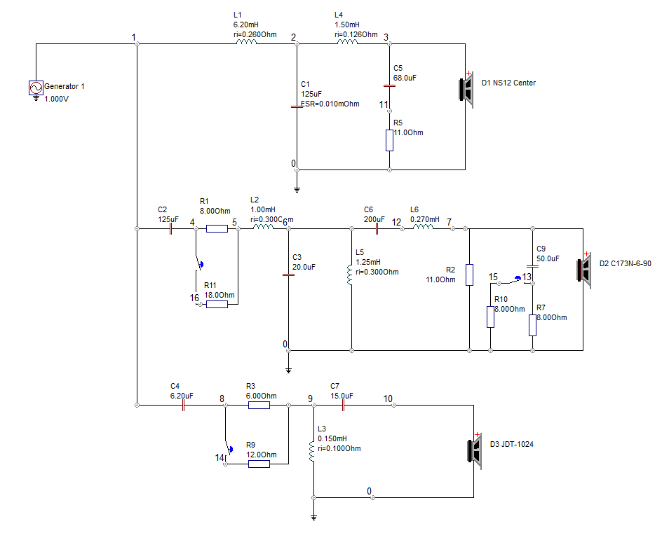

                                      Updates in progress....
                                      The reviews and tweaks have started, along with what may be the "production build", depending on how things work out.
                                      After more pondering of listening tests and measurements (but maybe not enough of the latter; haven't been back at GF's since setting things up on Sunday), have revised the LF to midrange crossover design and simplified the midrange BSC (which means less tweakable but fewer parts).
                                      Crossover point trial will be moving up to 300 Hz from 250 Hz; impedance looks nicer, and as mentioned, component count is reduced in the midrange crossover by one inductor and one resistor; parts ordered last night.
                                      Also, the revised woofer crossover will probably fit into the shelf at the bottom of the cabinet as originally planned! "Should" being the operative word...
                                      I also need to test based on the newest stuffing system, which I think is about perfect on the mid cabinet, but may be overstuffed slightly on the woofers. More testing to be done this weekend.
                                      Pictures should be up this weekend, also. And by then we should have picked and ordered some new racks for our mutual equipment.
                                      Progress is our most important product...

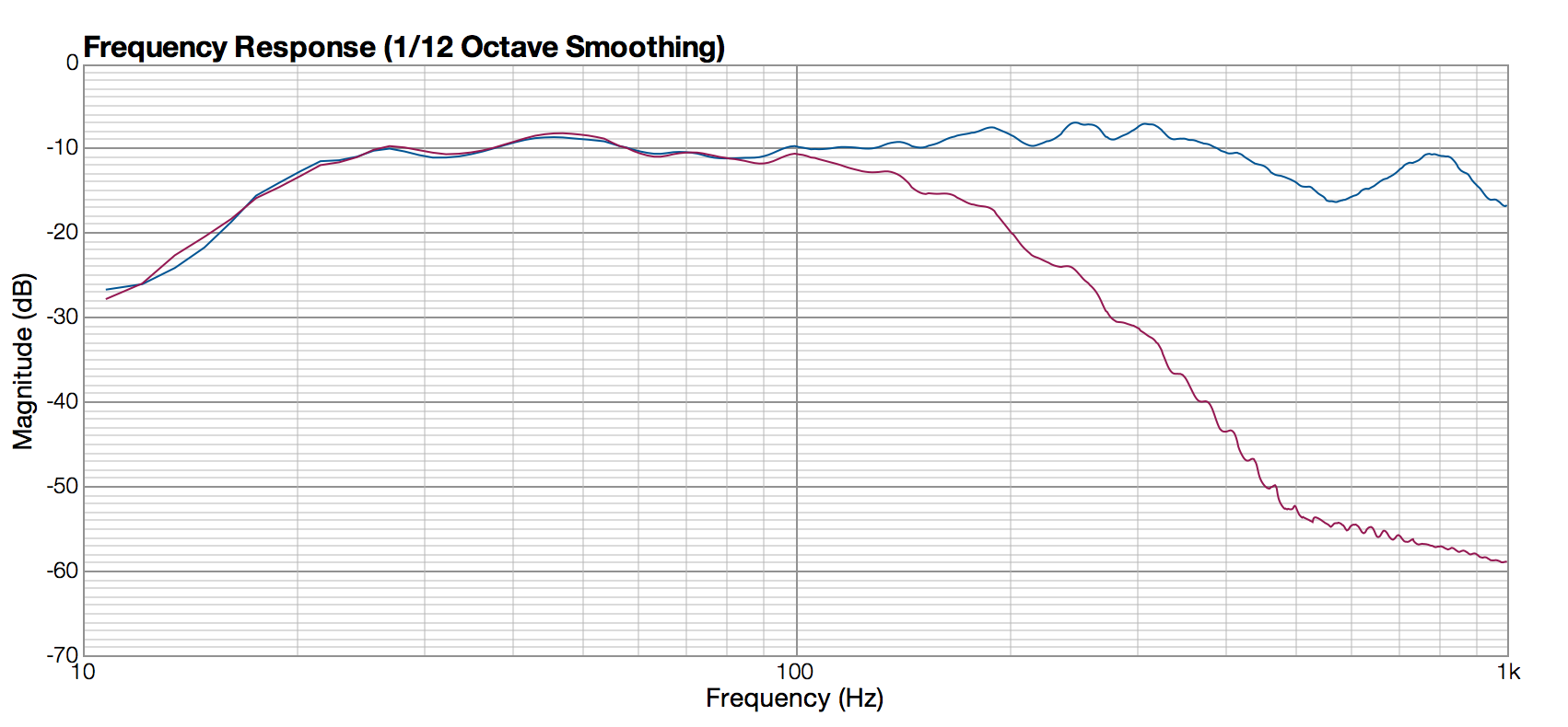

                                                So how does the new Dayton sub shape up?
                                                  • 16202
                                                  #924
                                                  The response using internal EQ, with and without the internal roll off filter looks like this:
                                                  I'm expecting it to work out pretty well...

                                                    That's pretty good and no breakup till ≈800Hz, what does the distortion profile look like? Ie how high can you really use it?
                                                        Distortion is pretty flat from 100 Hz to 300Hz, then starts gradually rising. Really not bad for a fairly high Xmax woofer in this price range. You could use it up to maybe 250 or 300 Hz, though a little lower would be better for the Xover. It's not like the BPD 12'sa I have in storage which are about 24 mm Xmax, but no copper, and THD starts rising at 150 Hz.

                                                          New crossover parts arrived today- the balance of the parts for the revised low midrange.
                                                          Now, do I build crossovers tonight, or practice the guitar? These are the questions one should be confronting every day... :W

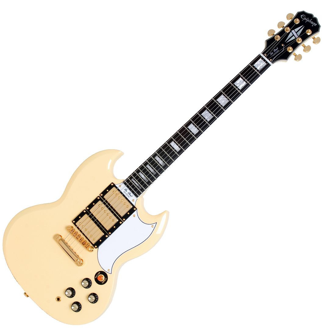

                                                              I did unpack and look at the parts and shuffle them around on a trial board just to see...
                                                              Tonite's mid week date nite, so no work on either project this evening. But may pick up my other new guitar, a sentimental purchase of an Epiphone SG Custom; it won't quite replace my old 67 Gibson SG Custom, but it should be close- the last one I could find new in the USA, shipped from the Harrisburg Guitar center store to Concord; should be arriving today.
                                                              The SG was the one I played for the longest part of my working career; though I later bought a Les Paul Professional low impedance, I never gigged with it.
                                                              I was horrified to see a totally beat to crap '67 Gibson SG on eBay this week, that the guy was asking $9450 for and pitching it like it was in pretty fine shape... don't see it there today, the listing must have expired. Good riddance!
                                                              Last edited by theSven; 12 August 2023, 21:29 Saturday. Reason: Update image location

                                                                        More progress on crossover tweaks, including lowering the cost a bit; updates for the tweeter and woofer, and parts ordered.
                                                                        in spite of all this guitar stuff going on lately, I haven't completely lost focus...

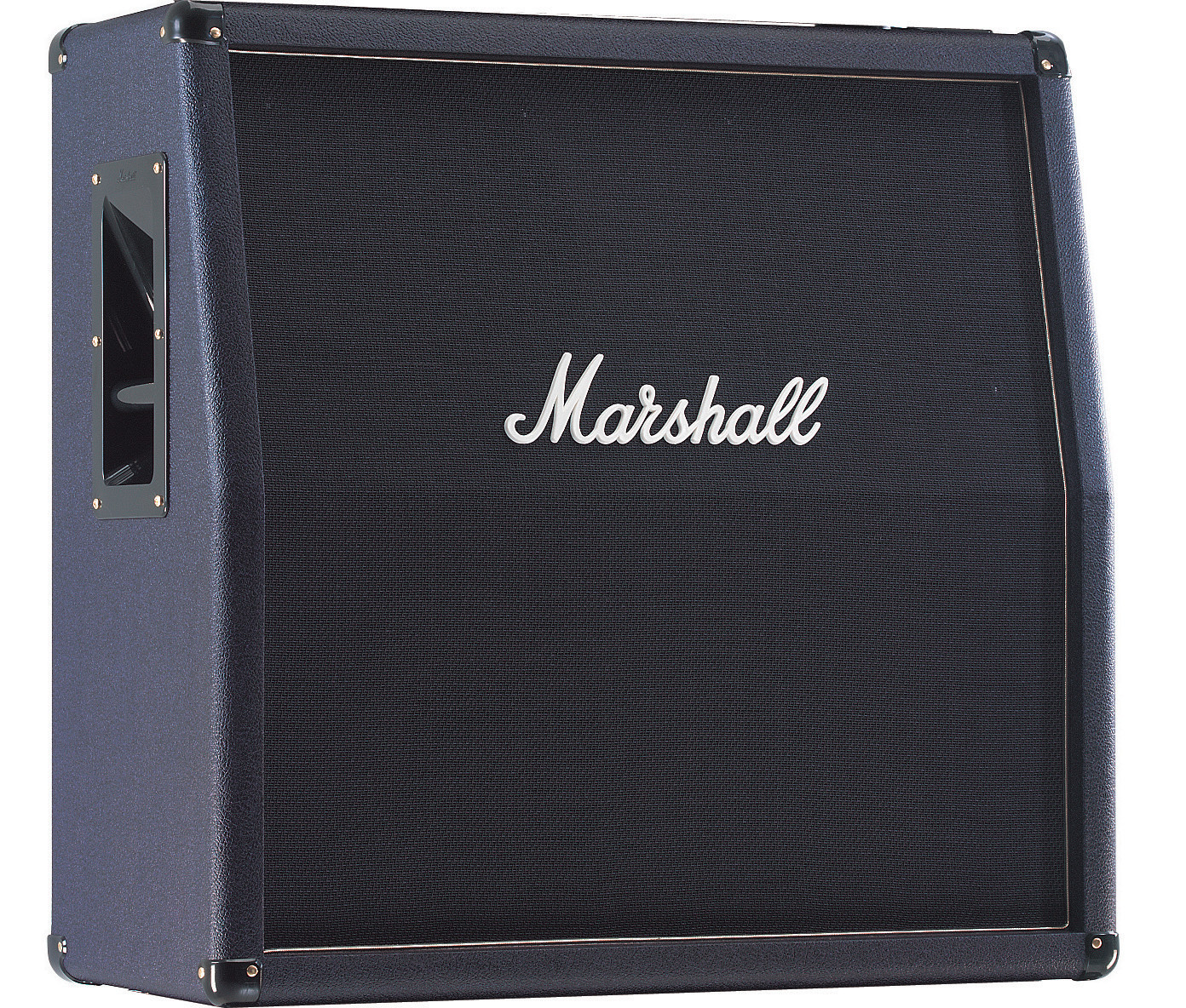

                                                                        But I also ordered one of these today- :W
                                                                        Not a standard Marshall cabinet and not easy to find. This is a VM 425A cabinet with special design Celestions. Should work very nicely with the new VM2266, and for keyboards, too, due to the more extended bottom end.

                                                                          Am I sensing a major mid-life crisis going on or what? Keyboard, guitar, Marshall cabinet....jeez, pretty soon you're going to announce the NSX is out in favor of the 2014 Corvette.
                                                                          On a serious note Jon, I can't remember if you got your bamboo ply from Rockler or Cali direct? I ordered mine direct from Cali, but now I need just enough for baffles on the studio monitor. I can't afford to commit to the 2 sheet minimum from Cali. Didn't you get some smaller pieces already cut up from Rockler? I looked on their website and didn't see anything I could use. Any ideas? I've looked all over the web and all I find is 4*8 sheets or cutting boards.
                                                                          Greg

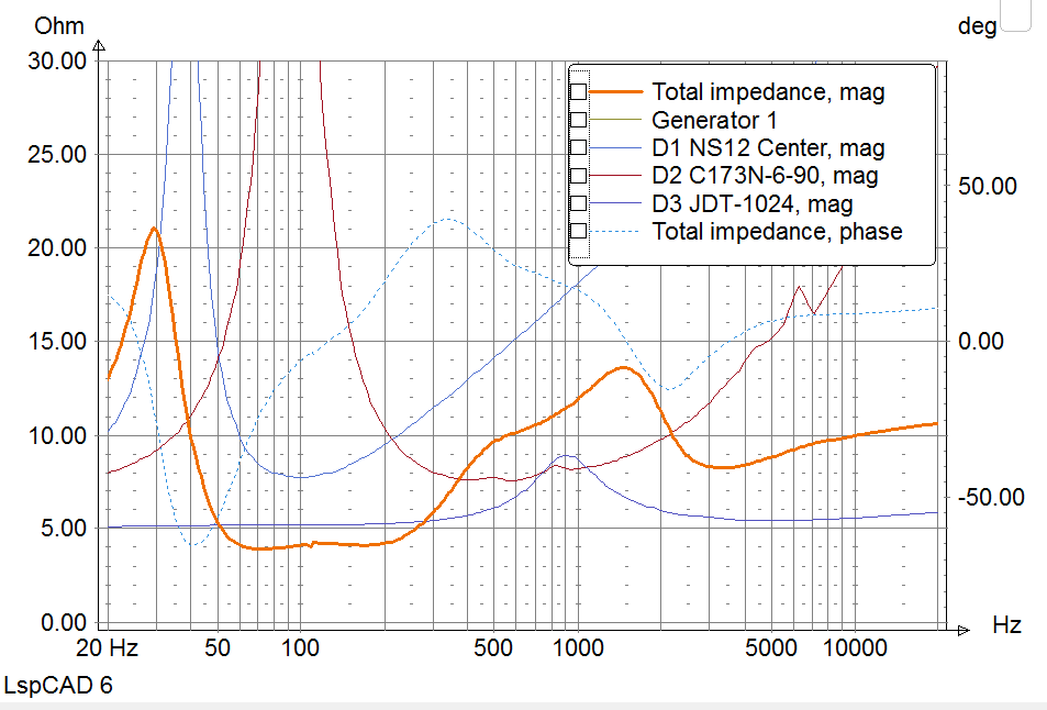

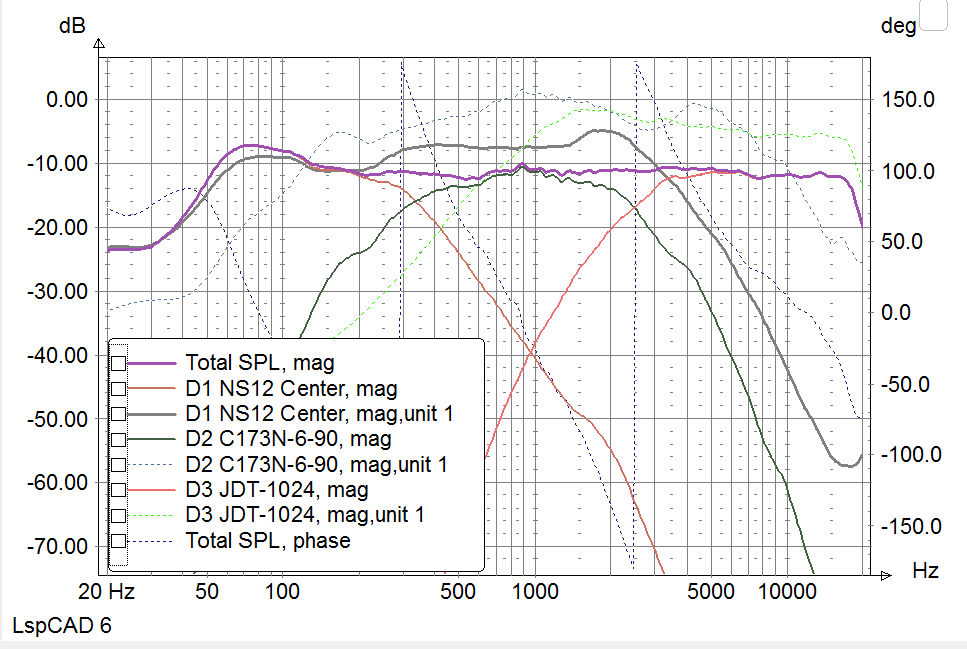

                                                                                    OK, this may be interminably boring for most of you, as I agonize over details in the crossover and play with the bits once again, but maybe it's good to show that often things don't happen just in a flash of divine revelation! (well, not for me- those of you with a closer connection to the divine may do things a bit differently!)
                                                                                    Given that a picture is worth a thousand words, these three pics show the current state of what's going to be built and tested shortly, also doing this such that I can do direct A/B's, as this isn't a mod of the existing LF and HF crossovers, but new builds that can be tested side by side, as soon as the rest of those pesky parts come in!

                                                                                    In particular, with regards to the LF crossover, note that C5 and R5 were revamped for the flattest but also highest net impedance curve on the woofers by them selves (before hooking up to crossover), and not lowering R5 to achieve some modification of the SPL response as the optimizer is wont to do if you let it have it's way...
                                                                                    The switch with R11 allows tuning the midrange output a skosh, and might be desirable if you have the system a bit closer in to side walls than my design target. The switch bringing in R10 is probably not needed, but would be what I call the "BSC switch", as it tames a region that can be a little forward, especially if the tweeter is at full up, with many rock recordings. For acoustic music, I doubt you'd want that. The switch with R9 gives a two dB adjustment to the tweeter level. Close for measured flat response; open for recordings that are up front or close mic'd, in my opinion.
                                                                                    The overall impedance curve is about as happy as I can get it at this point, considering the net impedance of the midrange and it's BSC response in parallel with the woofers. But at least it's not a 2 ohm load in the mid bass like many Avalon's and other similar three ways.
                                                                                    This should be reasonably benign to drive, excepting those Home Theater receivers that come out of a Cracker Jack box and aren't rated for anything tougher than an 8 Ohm pure resistive load!
                                                                                    This LspCAD simulation shows what should be expected if all of the switches are open, using the data measured 30 degrees off axis with boundary placement too close (i.e., the LF tip up), which tends to be reasonably representative of the power response in room.
