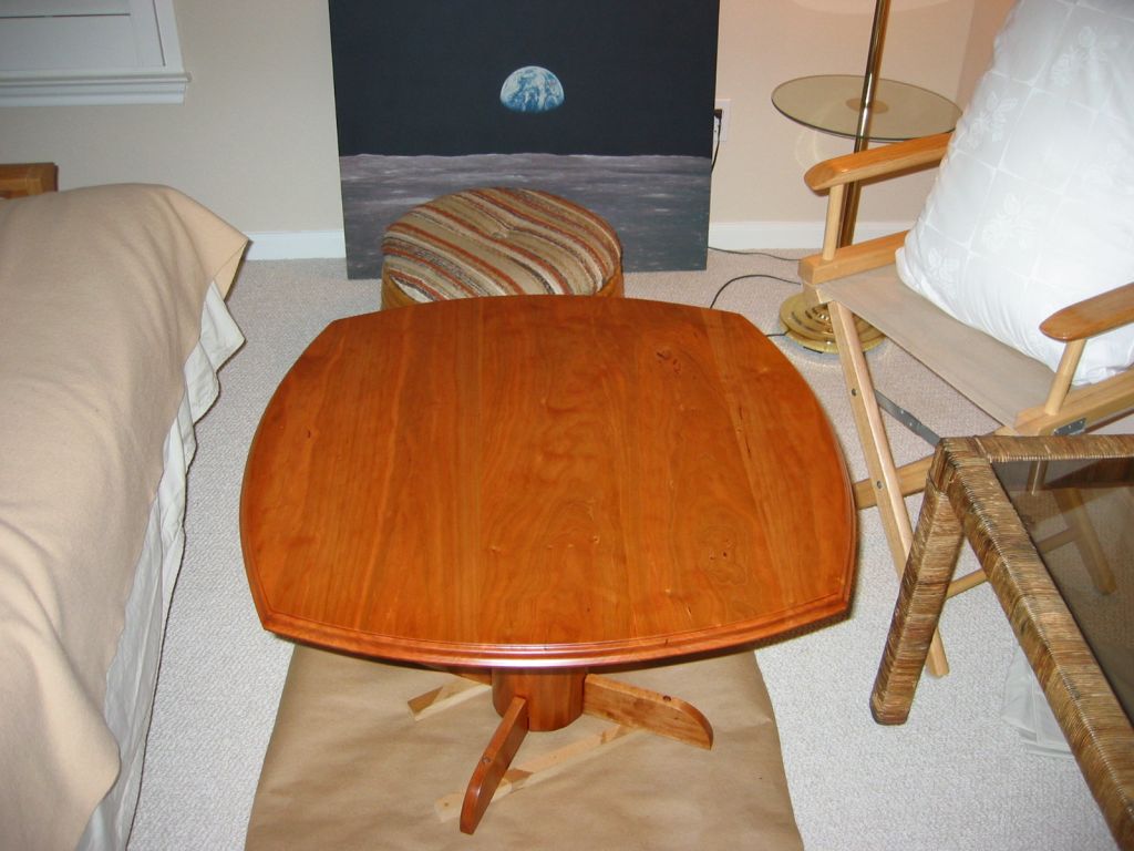

                                        My 2 cents on finishing...I'm definitely an amateur and have no spray equipment. I like lacquer best and have used Deft rattle can lacquer but when I lived in Houston the weather and bugs wreaked havoc on a project.
                                        After seeing the David Marks tv show WoodWorks years back I tried his method with General Finishes Seal-A-Cell and Arm-R-Seal and it is just so simple with great results. You might add it as a candidate...try it on a test piece. That is what I'll be using for my Jenzen build. As far as the UV issues...maybe some of their water based products..?..I haven't tried them.
                                        I used it on this cherry end table.

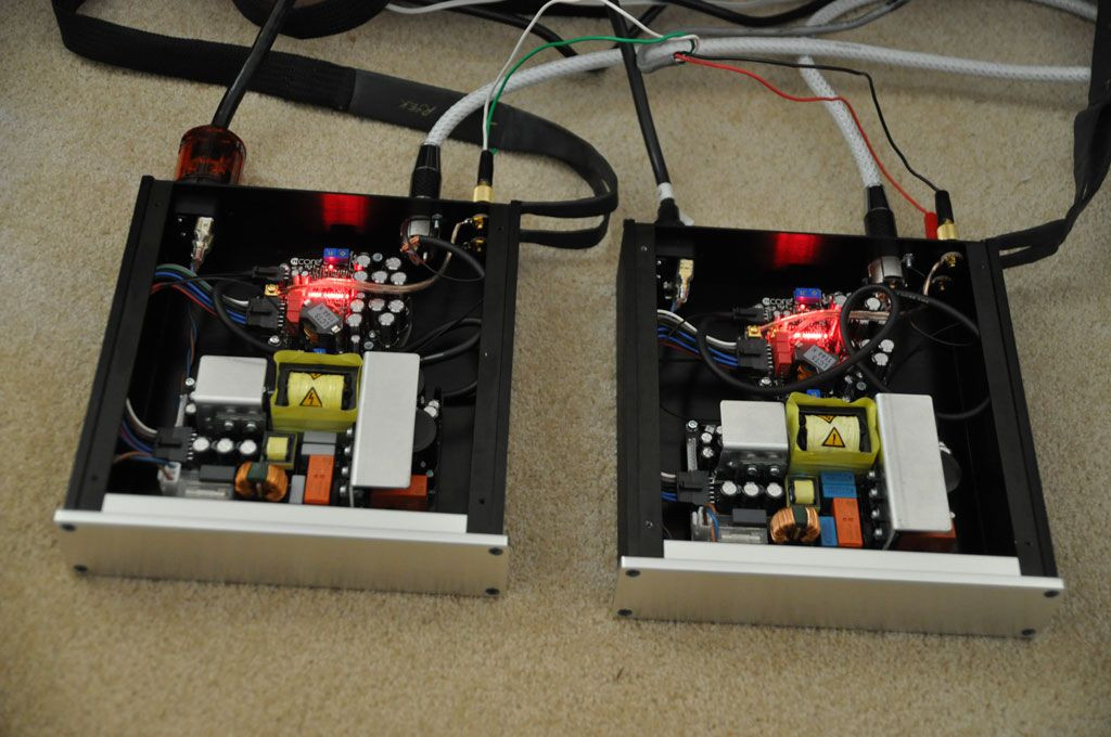

                                                    No visions of sugar plums and elves dancing in my head, more like HVLP sprayers, dust extractors, and a new amplifier project based on NCORE 400 modules. I'm debating whether to go fully dual mono in small enclosures like this...
                                                    or something larger wired and built as dual mono in a single chassis with better thermals and a more conventional footprint- really leaning towards the latter right now, using this chassis:

                                                    Need something very low distortion that runs cool and with a small electricity footprint- maybe this will do the trick! Certainly it's a lot different technology base than quasi class A Aragon's!
