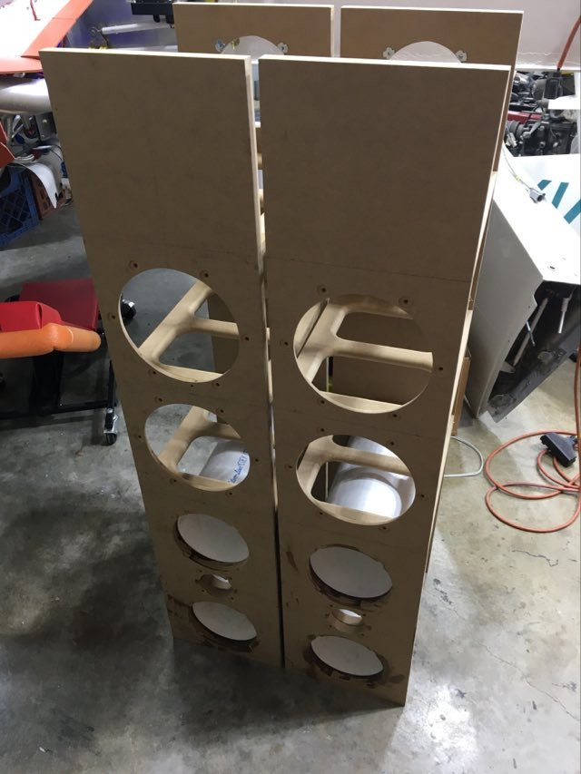

    We started with the PVC support doublers added to the front and rear baffles
    Added all of the Tee Nuts

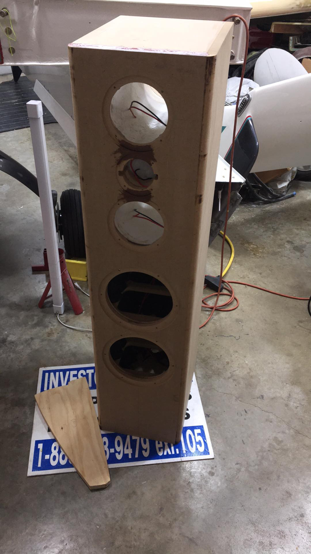

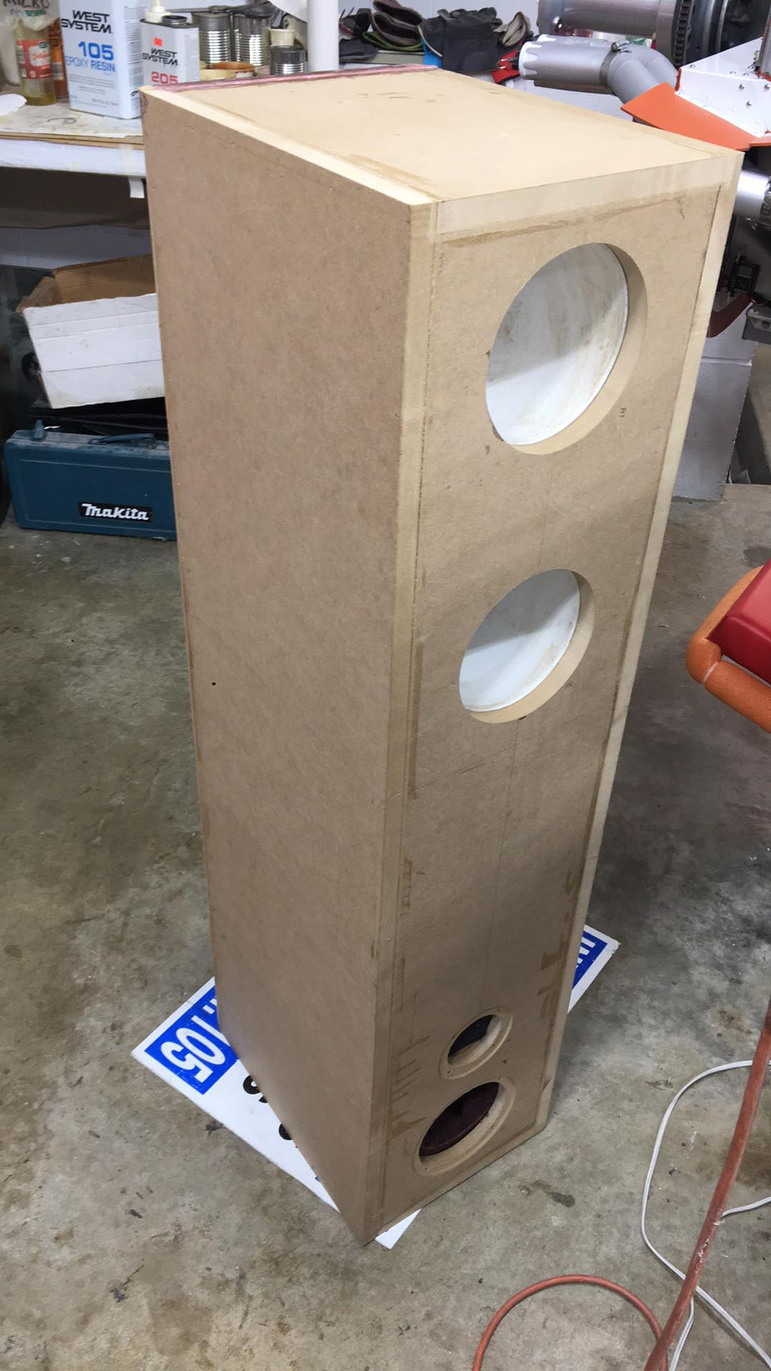

    Closed them up and routed edges

    Then routed front edges

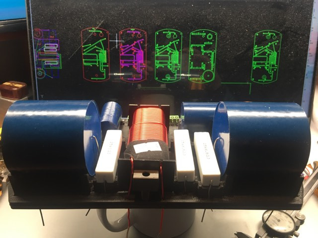

    Currently working on the crossovers. We 3D printed rafts that
    will hold all of the components and support them.
    They are anchored in place with a larger version of the snap fittings
    like used to hold speaker grills in place.

    Do you have any pictures of the 3d printed rafts?
    • Chrissi
      Chrissi commented
      Editing a comment
      Sorry not yet but we will post several. They really helped make it a high density board yet still maintain optimal spacing of the inductors.

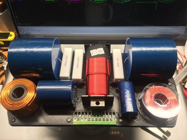

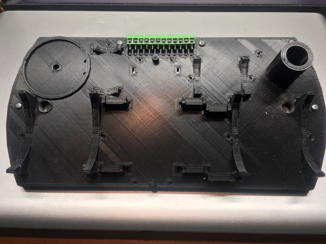

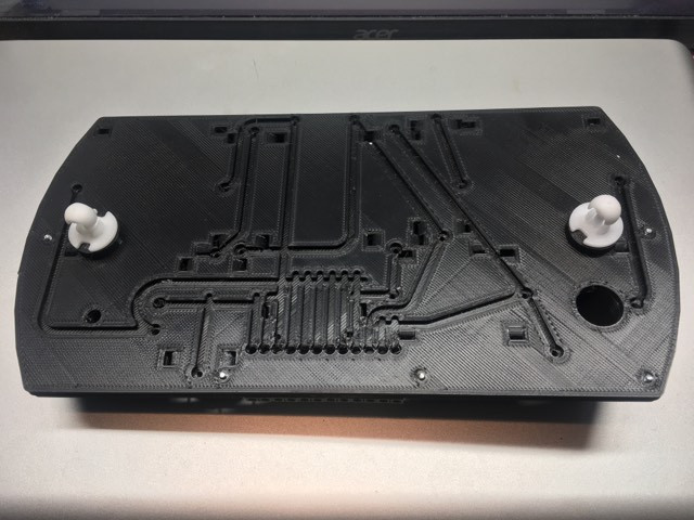

      The 3D printed crossover raft project, I am limited to 10.5" diameter prints
      Back side

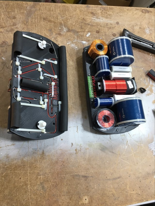

      Populated but nothing glued or zip-tied yet
      Rear view
      Resistors are up on standoffs for air circulation, everything has through hole slots for a zip tie at each end

        Very nice! How did you go about producing the file for those?

          Scareurpasenger​ - To create a 3D printed object you start with a CAD generated solid file. That is saved as an .STL file. The STL file is then imported into a program called a slicer, in my case a freeware program called CURA. CURA has all the parameters of your 3D printer in it so then looks at the object and literally slices it into the layers the 3D printer would lay down. That file is saved as GCODE which most 3D printer could process but as a version specific to your model printer. Each has its learning curve but the most daunting for most is creating the original solid object in CAD if you have no prior experience.

            Both crossovers finished and tested; hooked them up to the feed from my PC amp and plugged a speaker into each channel one at a time.
            Cabinets done, sanded and two coats of black on back, bottoms and openings.
            Waiting for delivery of 4x10 sheet of walnut veneer next week.
            It's getting real.​

                  I read this post and you make it sound so easy! I know what all these software components are 😁. I use Cura, but I'm very limited in my knowledge to use it. Yet when I print things some turn out and others do not. Someday when I get more time I hope to be more knowledgeable in the 3d printing world. Thanks for connecting all the dots and sharing this for the process to print the board.

                    Ok, so this took some real time! Kudos to you for creating the 3d model from scratch. I was hoping there would have been a shortcut.
                      Thank you. I make it sound easy because it is, if you have been using some of these programs for some time. I have been using AutoCAD since it was 2.5 D monochrome on an amber monitor, circa 1984ish? V1.2? as a young designer. Today there are much better and more versatile CAD design programs and some of them offer home user registrations for free or a bargain, I'm old and just use what I know because it is second nature after nearly 40 years. It's my hammer, I could not draw a straight line without a CAD system =D

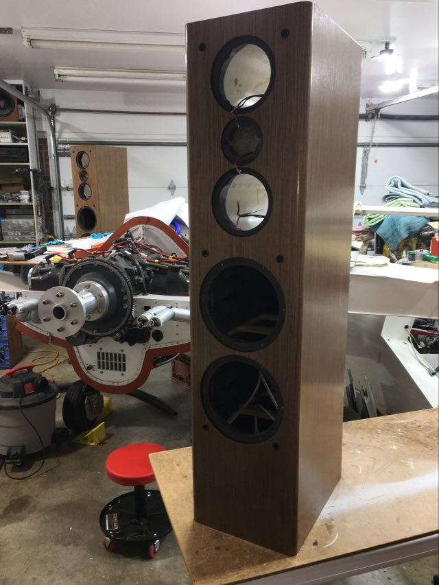

                                  A 4 ft x 10 ft sheet of paper backed English Walnut Composite veneer from JSO Wood Products nicely covers three sides and the tops of two Anthology II speakers.
                                  We used Heat-Lock glue, rolled on in two coats on both surfaces. The veneer takes longer to dry so we started there. Per instructions we gave it two hours to dry and there was no tendency to drag or grab when the two surfaces touched. We put a bit of tape on each end of the veneer with a center mark and top and bottom of the cabinet with a center mark so alignment was easy.
                                  Cranked up the iron to high, I don't know what measurement system they were using at Heat-Lock when they said 196F because cotton/high shows 350+ on our household iron. We used half of an old pillowcase as a cloth shield to prevent scorching of the veneer.
                                  Starting in the middle we worked to the ends of the front face then back to the middle rolled down maybe 1/4 of the radius and again worked to the ends, and so on until we were to the flats of the sides. You really need to lean into it with both hands on the iron. Next day my arms let me know I was using muscles that I usually do not use at the keyboard.
                                  Tap testing did not reveal any voids.
                                  Next day they were thoroughly sanded with an air powered random orbital sander.
                                  I laid out centerlines where the individual speaker hole center were located and used a drafting compass to draw a slightly undersized circle for each hole. Using a Fein tool we cut an undersized hole through to remove the bulk of the veneer in each hole prior to routing out the holes. For routing we used the suggested solid carbide 1/4" dia single edge piloted router. As suggested I tried to grind the "bearing" end down for clearance, got it most of the way there then dropped it on the floor where it shattered. After going through all five stages of grief and loss of my brand new Bosch router bit I asked Randi to go to Menards in search of a replacement. I put the new router bit in a 1/4" collet and collet holder where I could grasp the bit tightly all the way almost to where I hoped to grind it to thinking that maybe the heat and vibration was not helping the longevity of the bit and also protecting the cutting edge and giving me something more substantial to hang on to. This plan worked like a charm.
                                  Next we applied four coats of Bulls-Eye sealer wax-free shellac. More sanding.

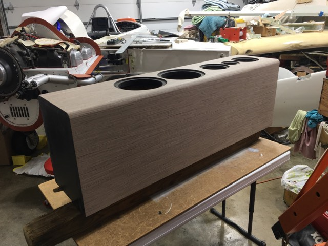

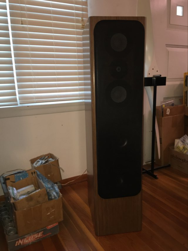

                                  The final finish is Varathane Ultimate water based urethane semi-gloss. We love the way this stuff lays down and self levels. The key is to not fuss with it, just lay it on, it might even be ugly but don't be tempted to work it, just leave it alone and like a miracle it just lays down, fuss with it and it might stay ugly because it dries fast. Two coats without sanding between applied two hours apart. Only two coats per day and let it set for a day then sand. Repeat two more coats then wait a day before buffing with superfine to knock any dust nibs off. Buff on some paste wax.
                                  We were going to apply Minwax walnut gell stain after the shellac but by the time we arrived at four coats of the shellac we were in love with the color and grain of the veneer as it was also knowing that the clear urethane was still going the deepen the tone slightly so we did not add the stain.
                                  We could have gone with more coats and smoother but we have other projects and timelines to get back to.

                                    Most important "So how do they sound?"
                                    Even with low time on them, hardwood floors, marginal placement etc...
                                    Our go-to home theater gymnasium of sound is the first 10 minutes of Top Gun Maverick (gratuitous, we are both aviators) all I can say is I was crying it sounded so good!
                                    Thank you Jim Holtz and Curt Campbell, you are truly alchemists of speaker design, your wizardry reduced me to tears of joy.

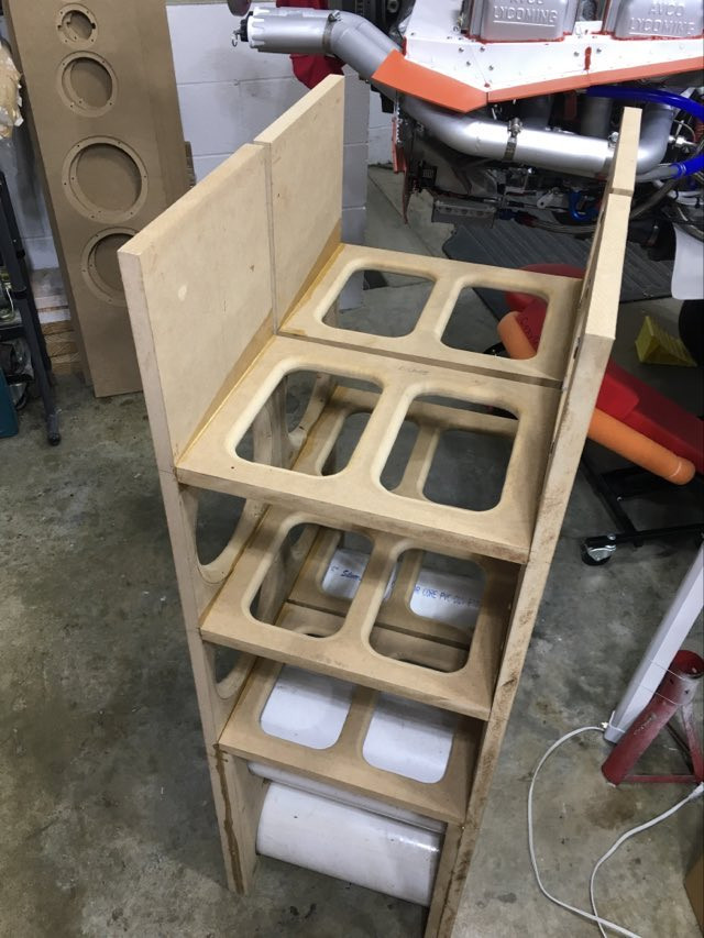

                                      Lacking an off the shelf solution, no available specific design to build I turned to Jim Holtz for suggestions. Jim came up with the "Bromo" speakers designed by SB Acoustics and offered by Madisound. It utilizes the same ceramic dome tweeter and a 6" ceramic woofer that is the next size up same family as the SB Acoustics midwoofers used in the Anthology II's. I asked Josh at Madisound if it were possible to get a single version of their offered package deal and he came though for us.
                                      The nice thing about this build is it only takes a 2x4 sheet of MDF, and probably a 2x4 sheet of veneer.
                                      Right from the start we planned to lay the speaker on it's side and do our best to make the little box appear part of the family with the Anthology II's, the 6" woofer is right to the edges of the box design so rather than change anything about the box design and volume we added an additional layer to each side so we would have material available to do the 3/4" roundover to match the Anthology II's. I'm sure we violated some rule of cabinet design but we are very happy with the outcome and we will have room to add a matching grill to the box for that family look between our three speakers.
                                      Not complete yet but I'm confident in our small listening area this speaker will be more than adequate to do the job and certainly better than the Bose sound bar it is replacing.

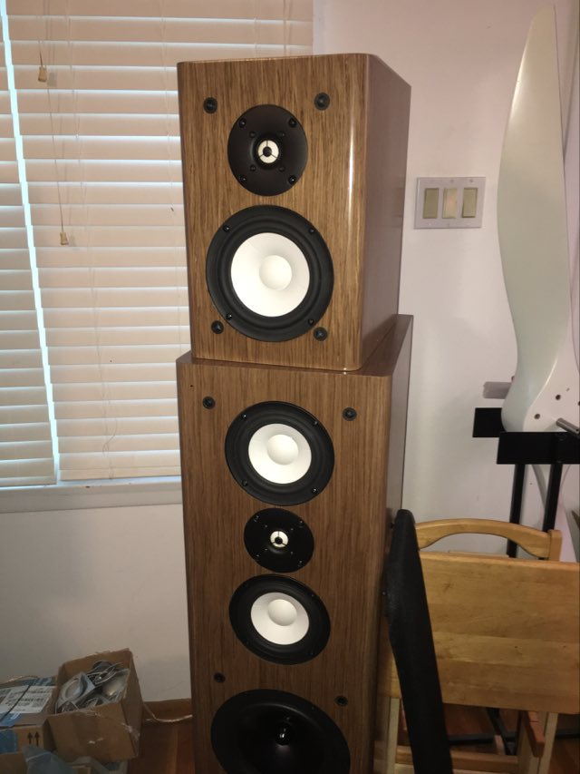

                                        ​ ​​The completed center speaker based on SB Acoustics Bromo design with enhancements to make it appear to be in the Anthology II family...

                                              I am not sure how I missed this build!
                                              You've done a top notch job, and made it look easy while you were at it! Nice speakers.
                                              I have all the parts picked up (for a couple of years at least now, lol) to build the 1st gen Anthologys. I am going for an identical aesthetic to yours, so this was cool to see.
