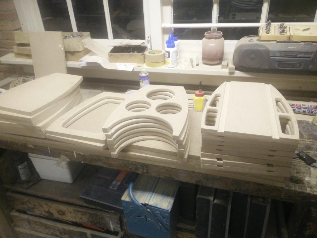

    Last week I received the CNC'd inner parts for the cabinet and currently I am sourcing all the parts except the drivers.

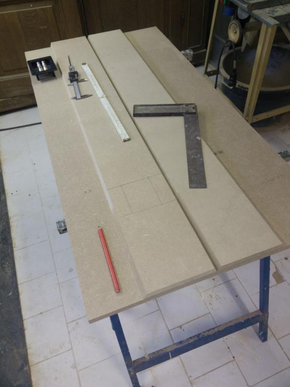

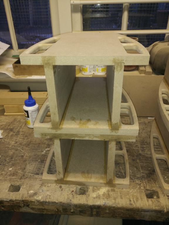

    This week I rounded all the edges and glued the baffles together. Next thing to be done is cutting the baffles at an agle on the correct width in order to make them line up nicely with the radius of the braces.
    After that I will start doing the driver cut-outs. :T
    Never done that before so I hope all goes well.

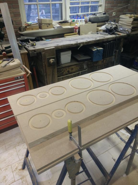

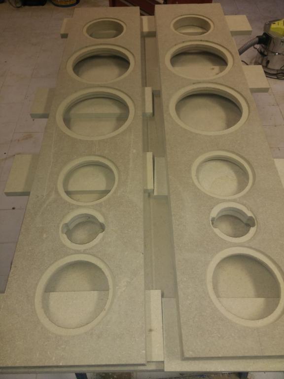

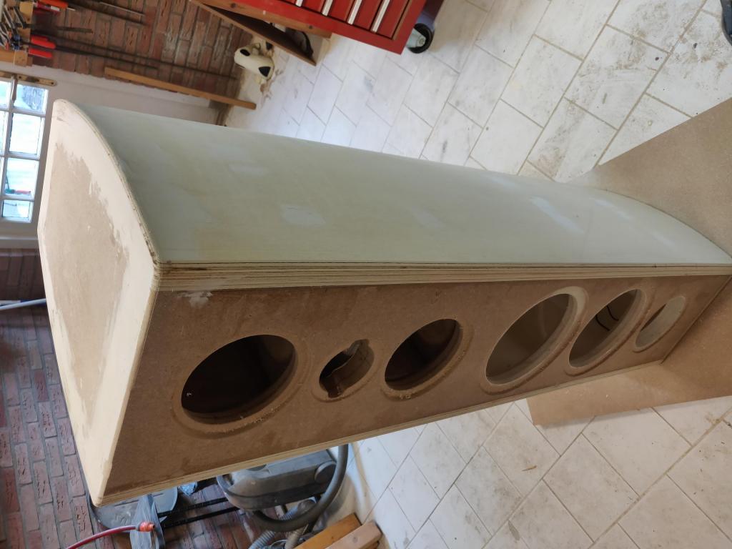

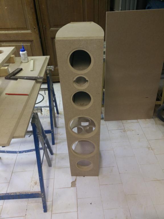

          Today, after a busy period at work I was able to make some progress again;
          Baffles cut at the correct width and angle and the outer circumference of the drivers routed. What a dusty job!
            Be sure to measure the drivers and cut the recess and driver cutouts the appropriate diameters to fit your project. Paint or veneer makes a difference.

              Is that one of those crappy paper masks I see In a picture? If I could go back In time I would make sure I always used a high quality dust mask (I use an M3 4251). Sorry for the miserable post.
              The build's looking good though
              • Dilirium
                • Dec 2017
                • 20
                Thanks for the heads up!
                Leaning more towards painting now and I hope I added enough to the diameters.
                We will see.

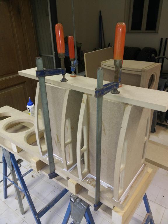

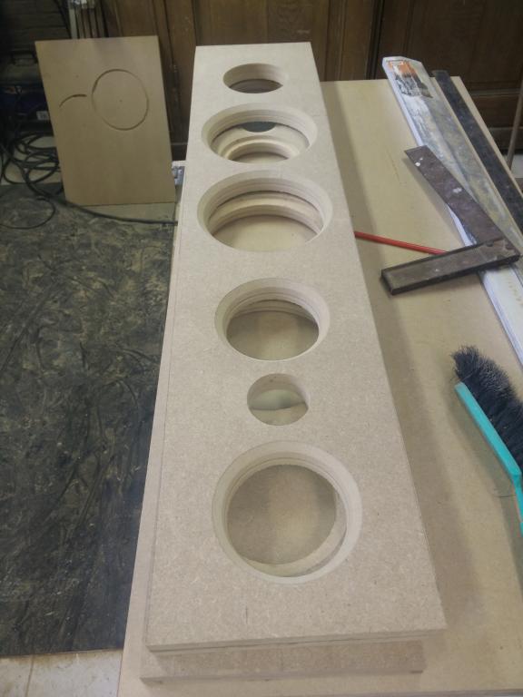

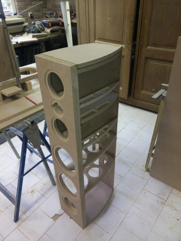

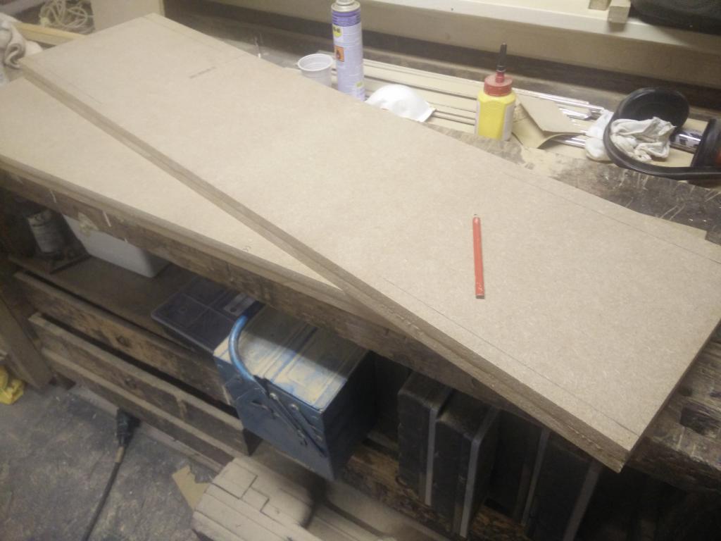

                  Today I finally made some progress again;
                  - Baffles are done. Tweeter holes finished, chamfered the driver holes etc.
                  - Panels for the mid tunnels cut and glued the tunnels together.
ID:	863529Click image for larger version
ID:	863530Click image for larger version
                  Hopefully this week I can start with the back panels. So far so good!:T

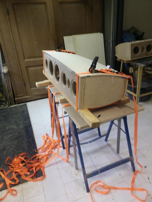

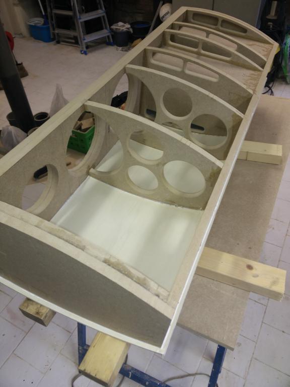

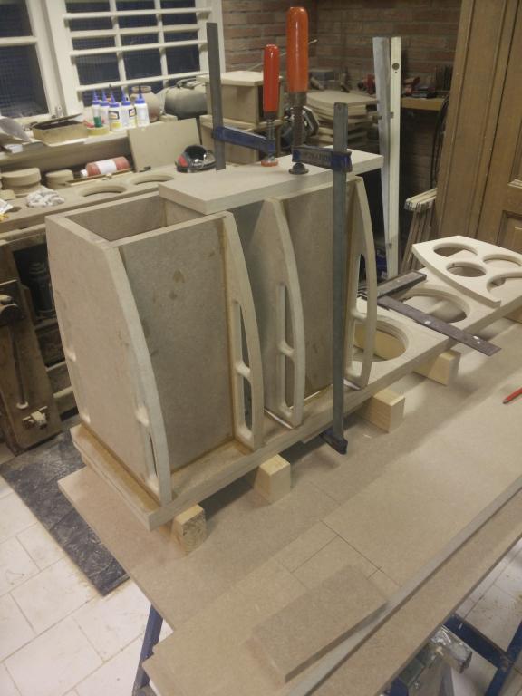

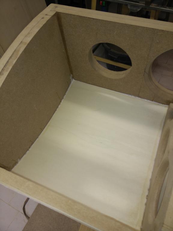

                        This weekend I had some time again to continue with the build. Finished the back panels and glued the first speaker cabinet together. Looks good so far!
                        Found out the angle of the baffle does not quite matches the curved line of the cabinet, need to solve that first. It is to much for sanding so I probably will do it on the table saw or the like.
                        This week I hop I will finish the second cabinet.

                        1 question; would it be wise to add another rib between the 2 woofers for extra stiffness or is it OK like it is now with only braced behind the middle of the woofers?
                        Thanks in advance!
                          I think the bracing looks excellent. It should be a very stiff cabinet.

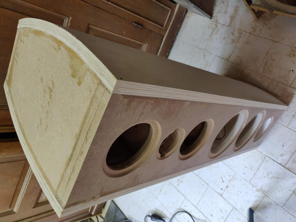

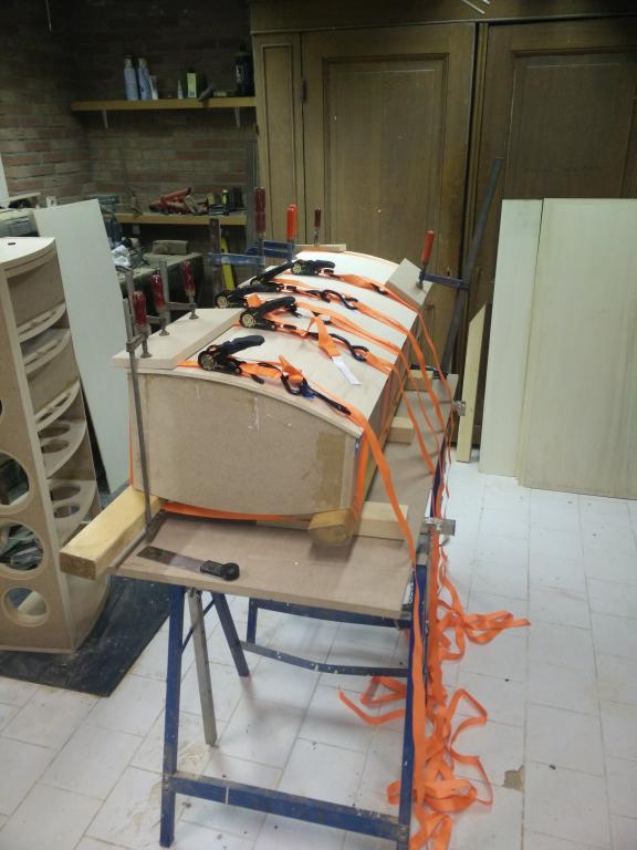

                            Hi all, today finally some time again to work on the speakers. Bought the bending triplex and cutted the sheets. Sheets are 7mm thick and will apply 3 layers each side.
                            Glued the first layer of wood to the cabinets, tomorrow hopefully I will trim the excess wood with the router and apply the second layer of wood.
                            This will take some time as I can do only 1 sheet at the time.

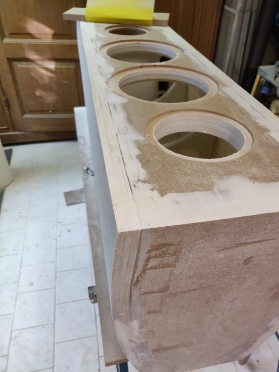

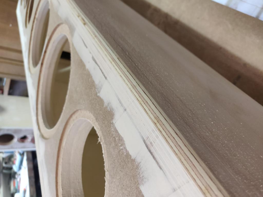

                                Both cabinets finished, rounded off the edges and sanded them both.
Name:	Rounded edges.jpg
Name:	Rounded edges 2.jpg

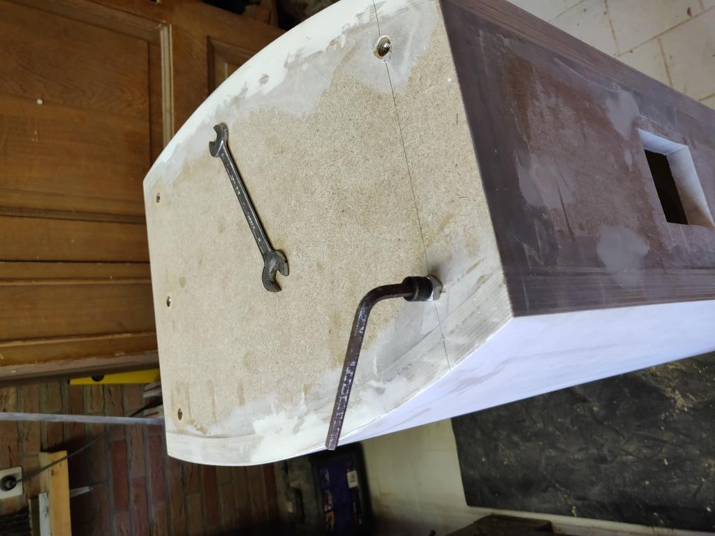

                                Used a lot of filler to smoothen the edges. Unfortunately some edges are still visible. A member of another forum mentioned I should have used better quality MDF, not the type one can get in the hardware store usually.
                                Good tip for mu next build then. :P

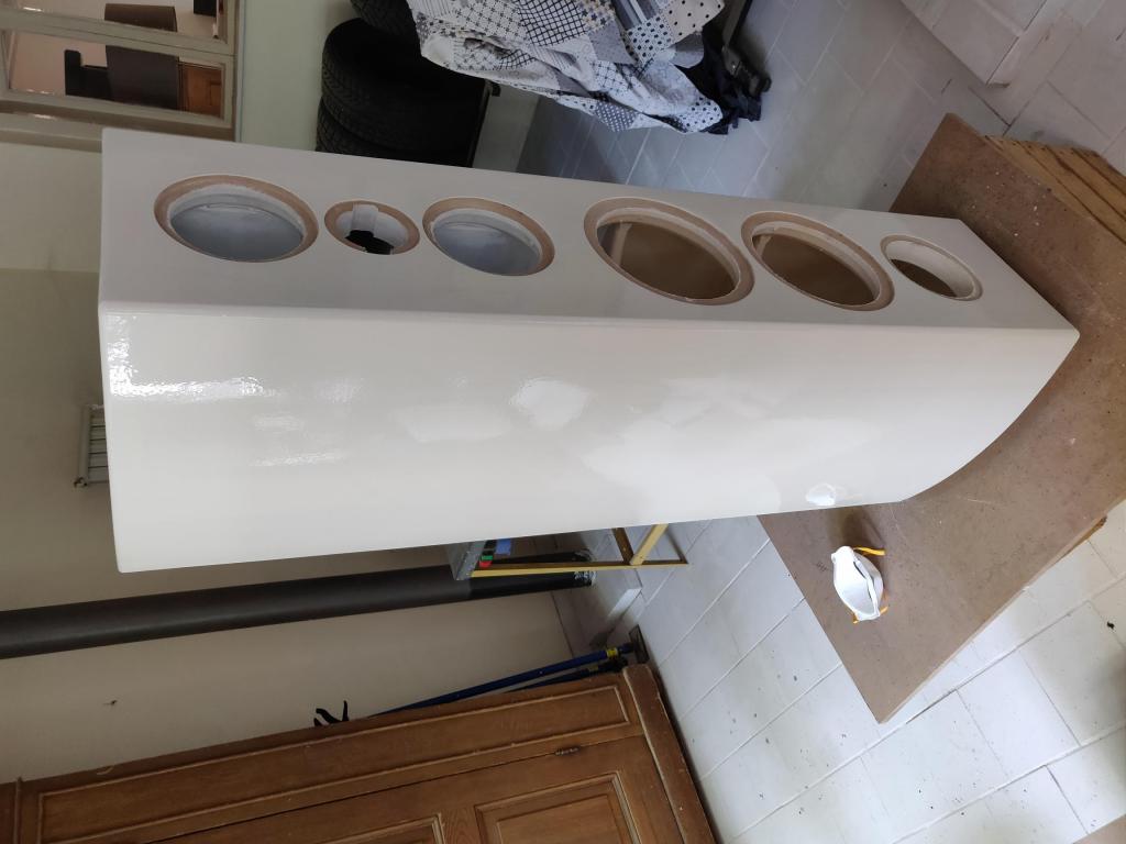

                                • Dilirium
                                  • Dec 2017
                                  • 20
                                  Next were the inserts for the feet, pretty straightforwarded job:

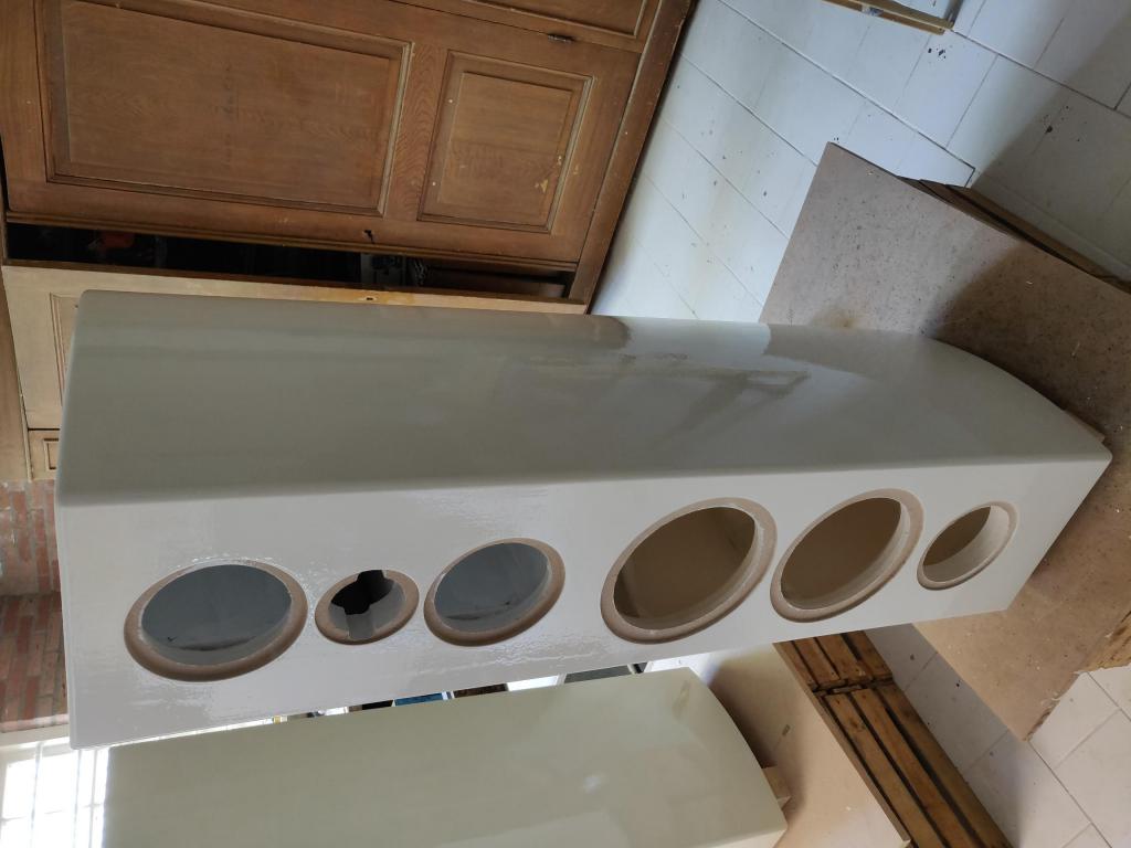

                                  Then some paint:
                                  I used 3 layers of primer, 4 layers of paint and 3 layers of laquer.
                                  All in all the result is quite good and the defects caused by the filler etc. are hardly noticable.

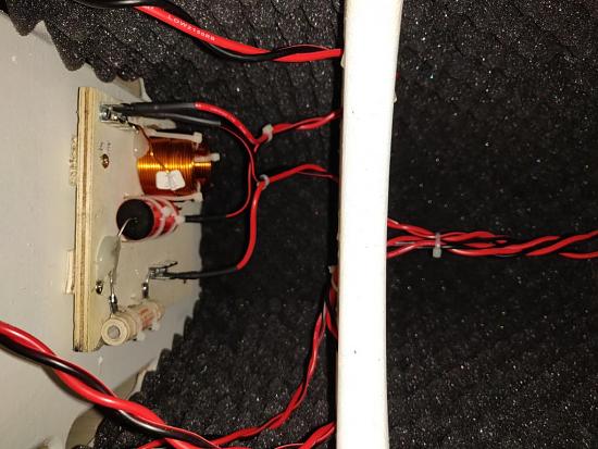

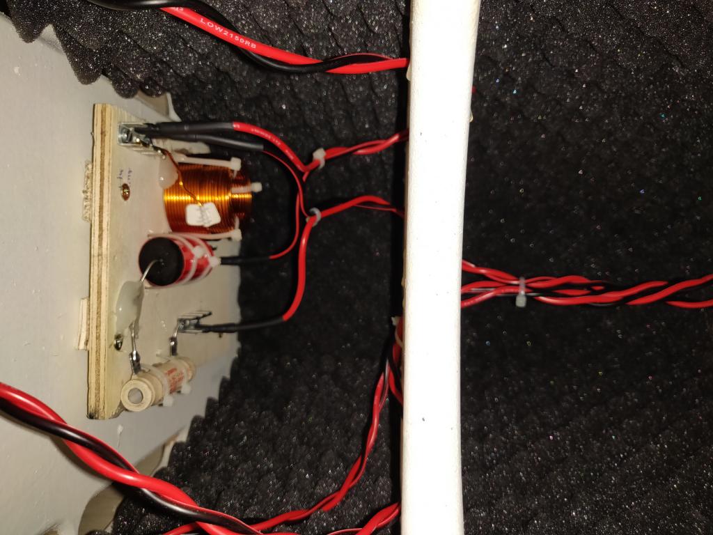

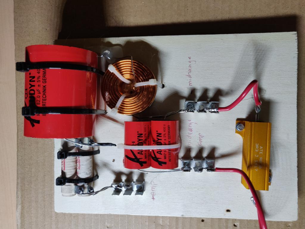

                                          I have been offline for a while due to work obligations and some rebuilding in my home.
                                          Speakers are finished also for a while and the sound is really good! My old Dali's are nothing compared to these backbreakers.

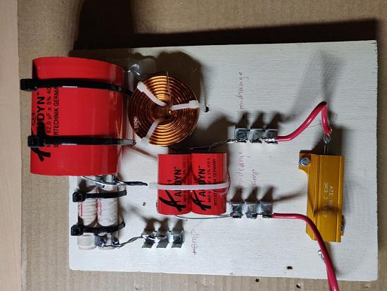

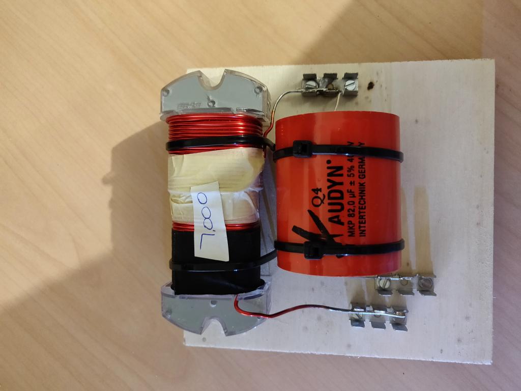

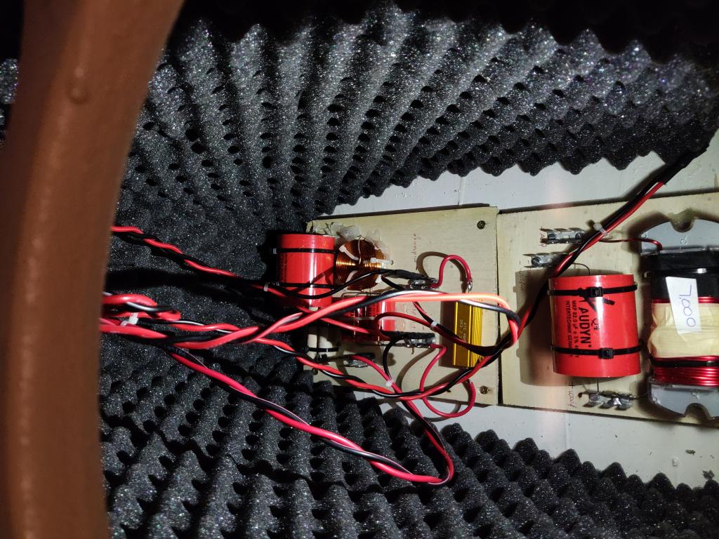

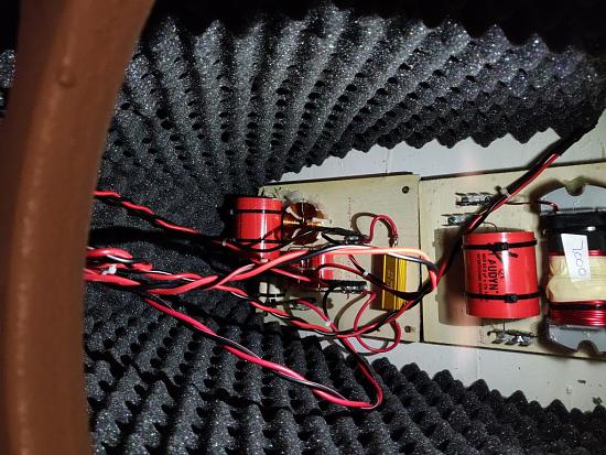

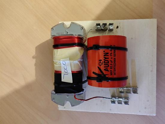

                                          Below some pictures of the filters and mounting in the cabinets.

                                          • JoeAngelicchio
                                            • Oct 2006
                                            • 47
                                            WOW!!!! Those look fantastic!!!

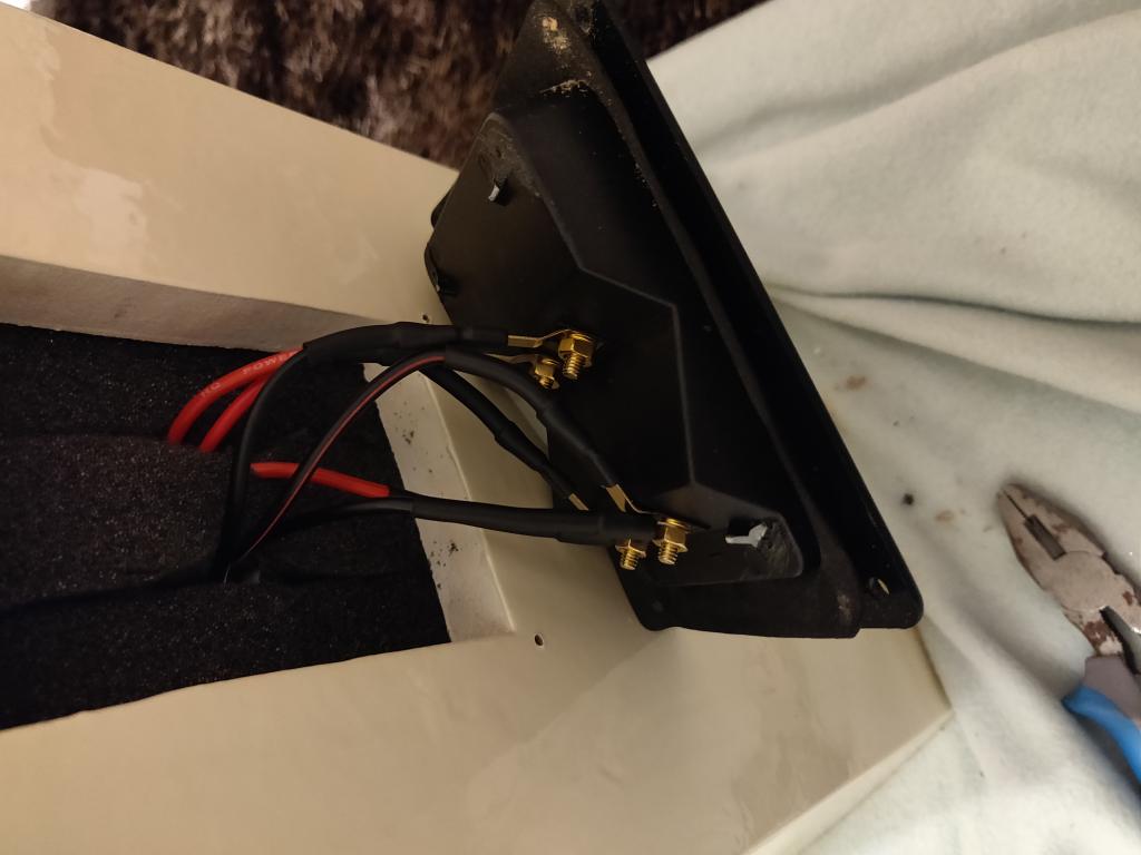

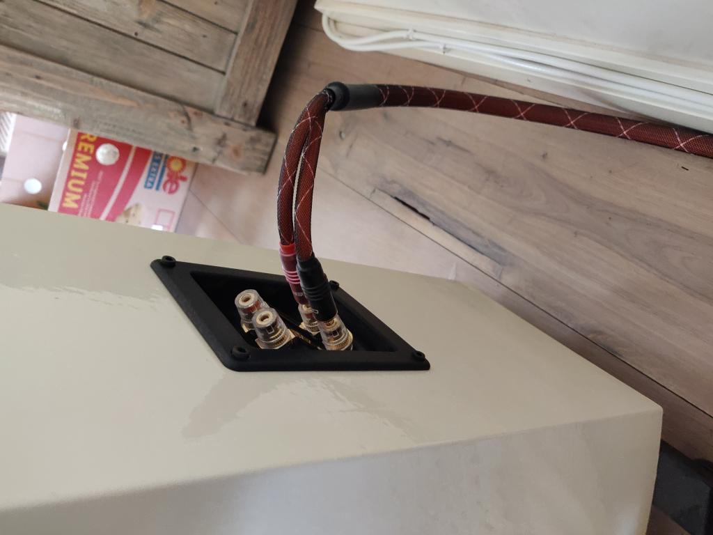

                                              And the mounting of the terminals to the back:Click image for larger version
                                                Great job! I'm glad you're enjoying them! :T

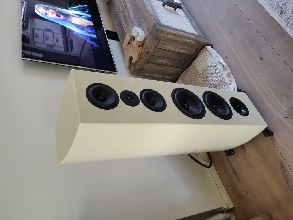

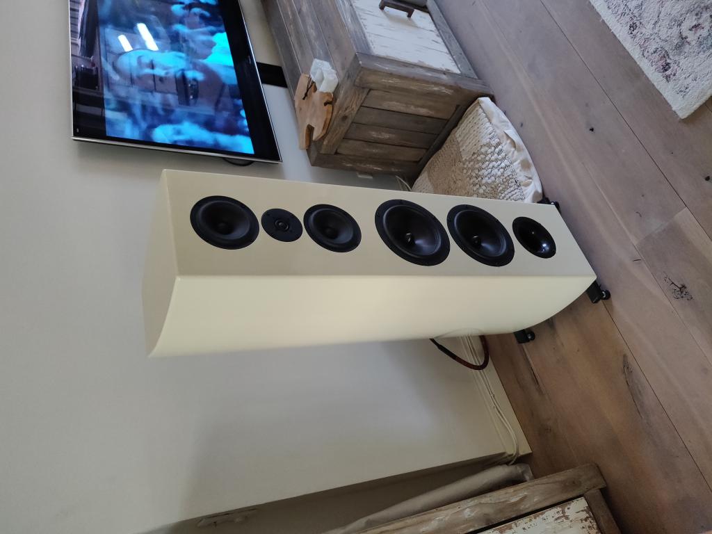

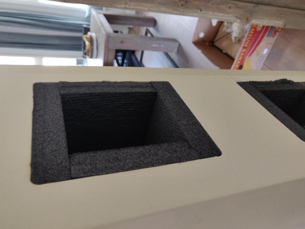

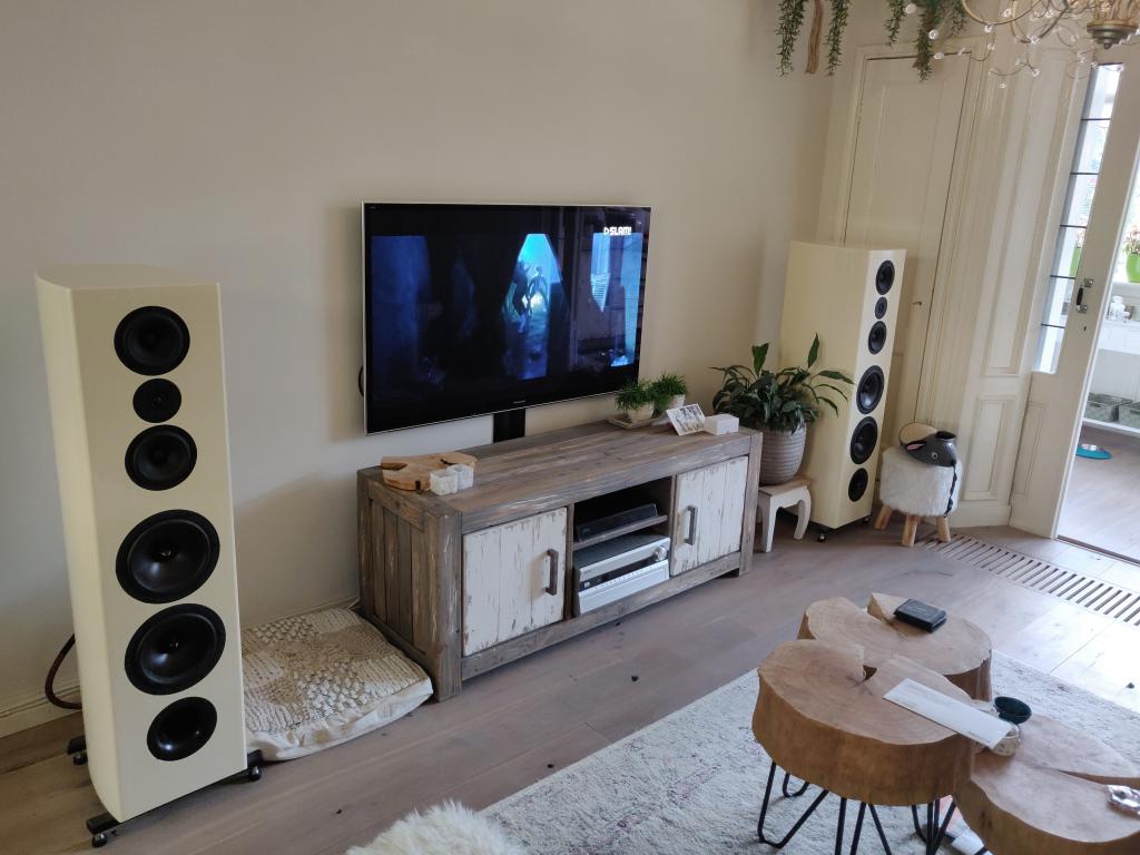

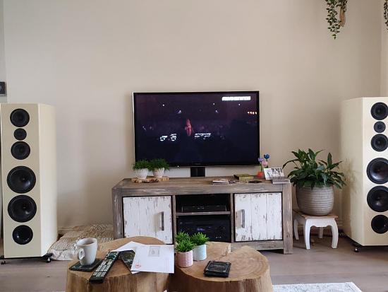

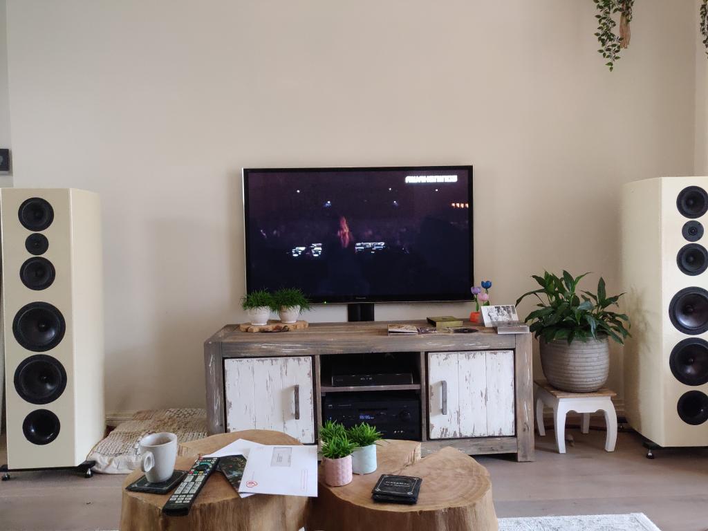

                                                        Some more pictures:
ID:	864210Click image for larger version
ID:	864209Click image for larger version
ID:	864208Click image for larger version
ID:	864211Click image for larger version
                                                          • 698
                                                          You chose quite a challenging type of enclosure for DIY, but the result is very nice indeed. All these sepaker projects with curved sides makes me itch to try the same... but not this year probably.
                                                          Thanks for sharing the build pics!
                                                          • Mikerodrig27
                                                            • Feb 2015
                                                            • 167
                                                            Wow, those look great! Are you going to space them out from the wall a little more?
                                                            • Dilirium
                                                              • Dec 2017
                                                              • 20
                                                              They where more away from the wall (30cm) and now they are a bit over 20cm from the wall and I hear no difference. It is hard to have them more in the room due to the shape of the room and the distance to the couch.
                                                              When my NAD is back from repair i will hook up the htpc again and start some measurements with REW. I have not done that yet and I assume there is a some of room for improvement. My living room is crap acousticwise anyway because one speaker has to be in the corner and ceilings are quite high. For this reason the port is in the front instead of the back or bottom.
