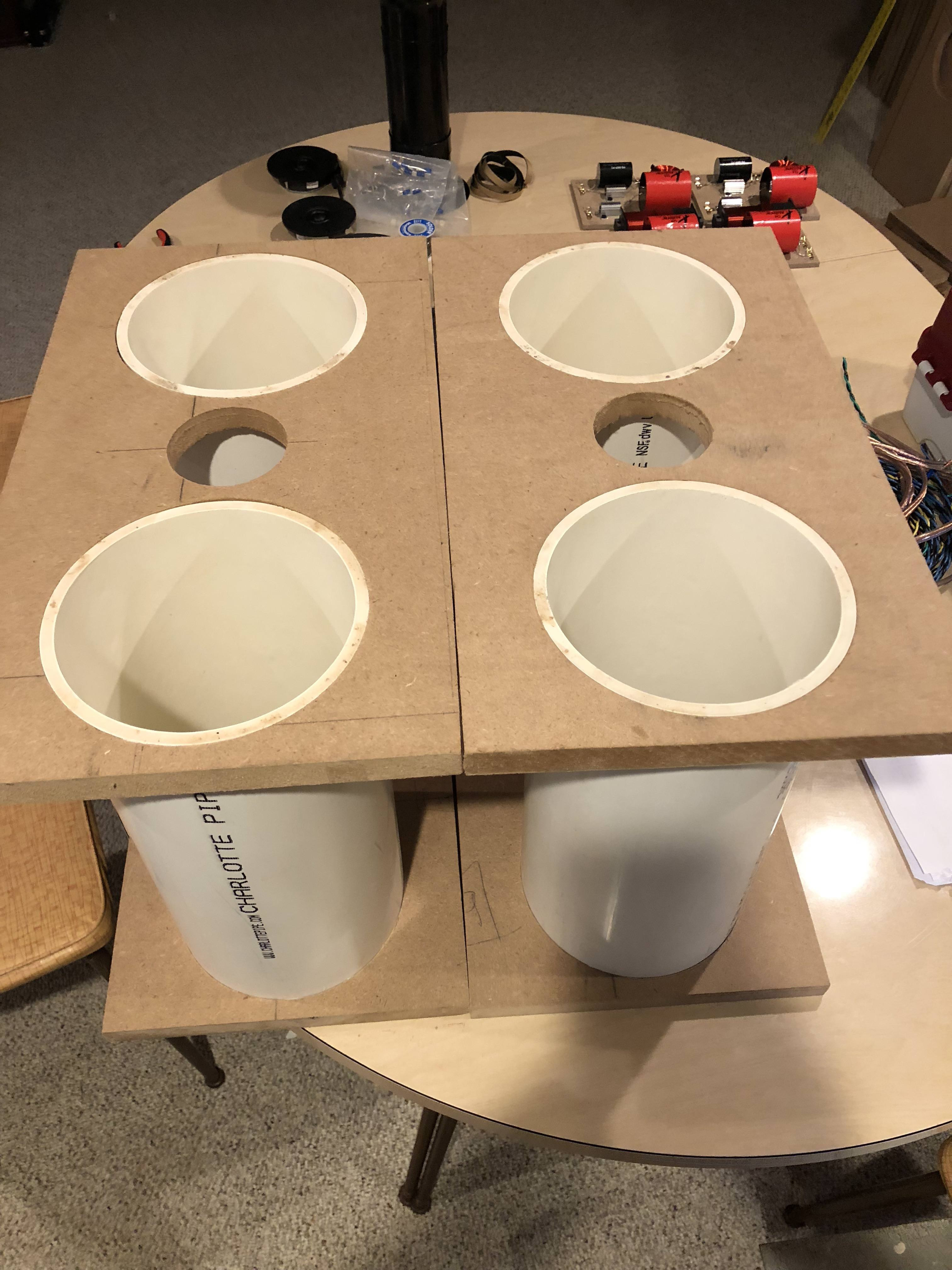

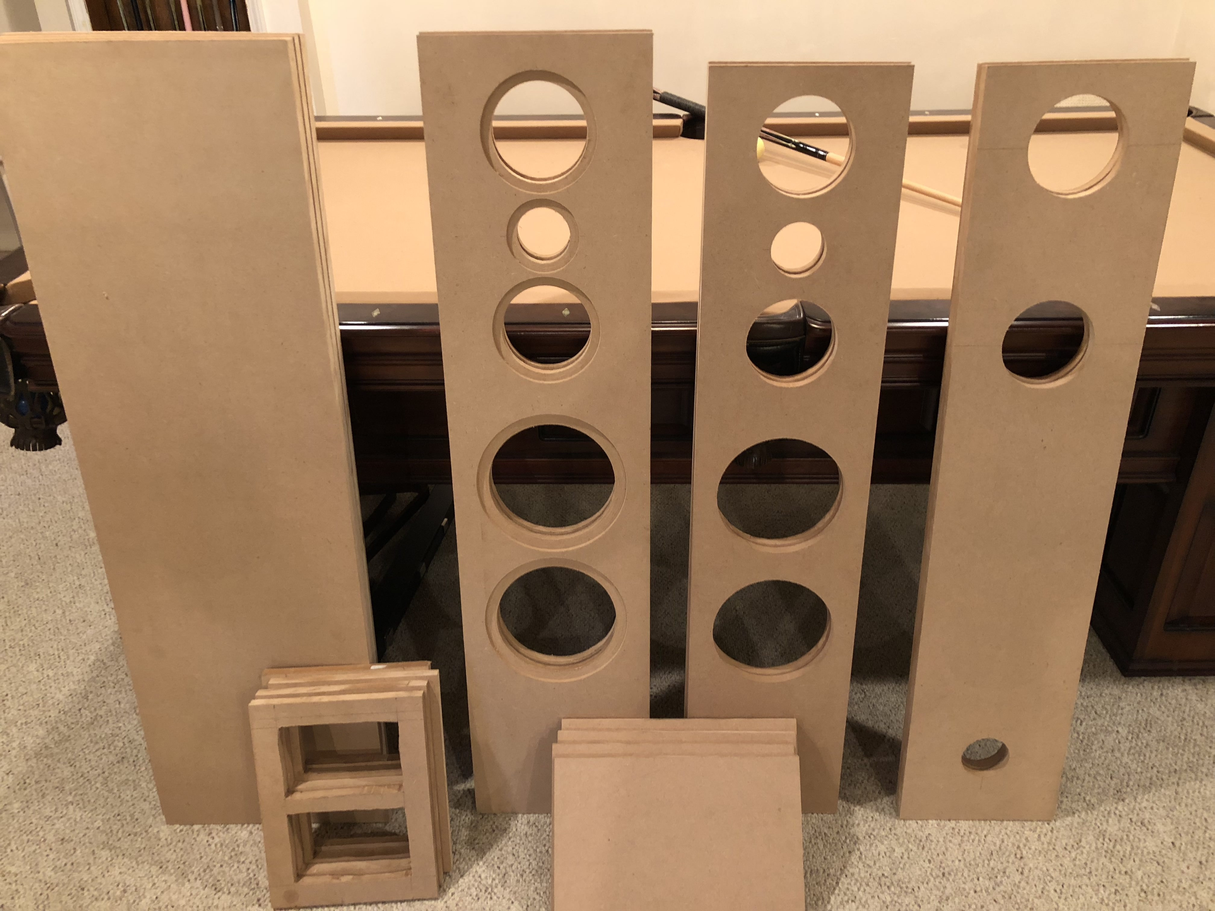

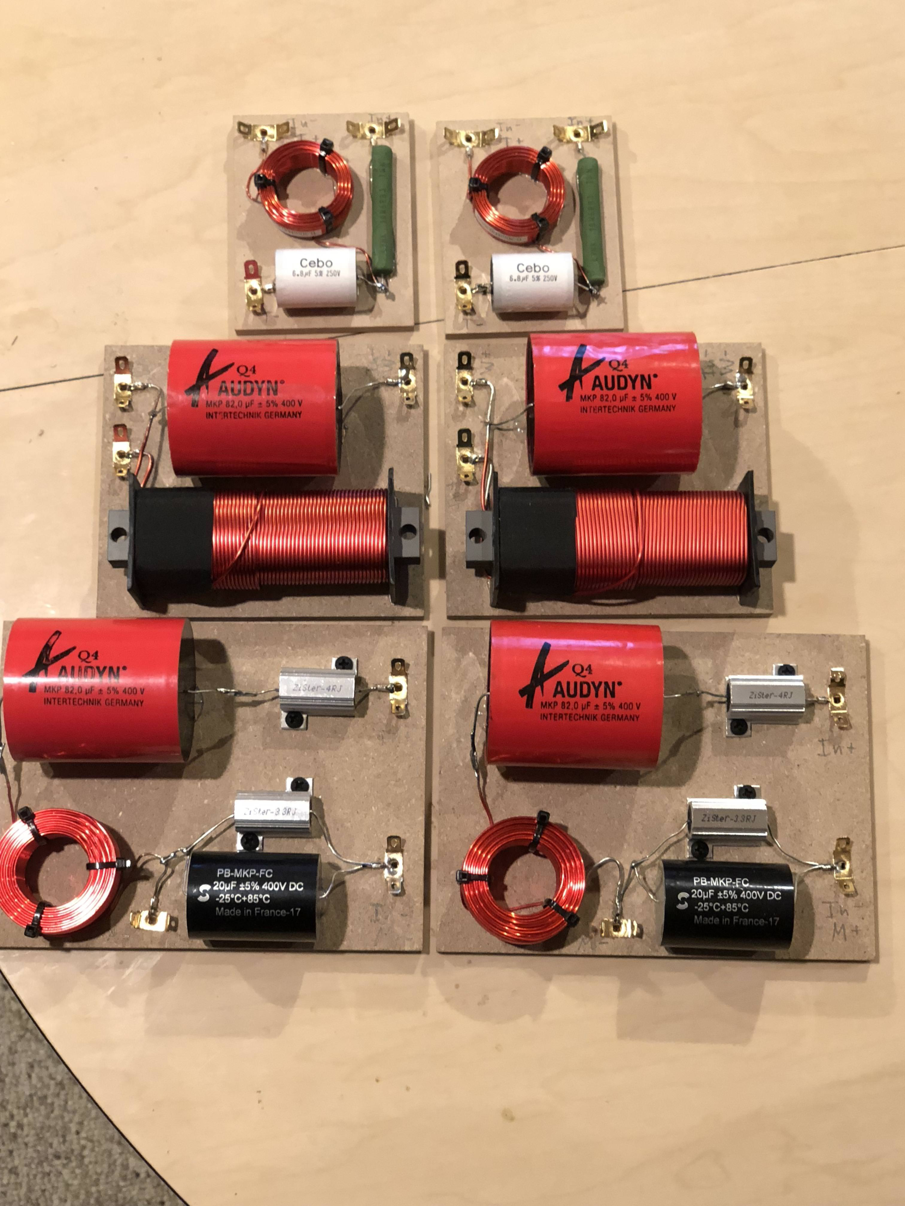

    Hi all! I just recently delved into the DIY audio world looking to build some nice tower speakers for my apartment at school. I settled on the Anthology speakers. Will update as I assemble the cabinets. I am probably going to take them to a family member who does custom automotive painting to give them a nice piano black finish.
    Here are some photos of the parts prior to final assembly
    Discover the magic of the internet at Imgur, a community powered entertainment destination. Lift your spirits with funny jokes, trending memes, entertaining gifs, inspiring stories, viral videos, and so much more from users.
    Let me know what y'all think but please be kind this is the first real woodworking project I have ever done!

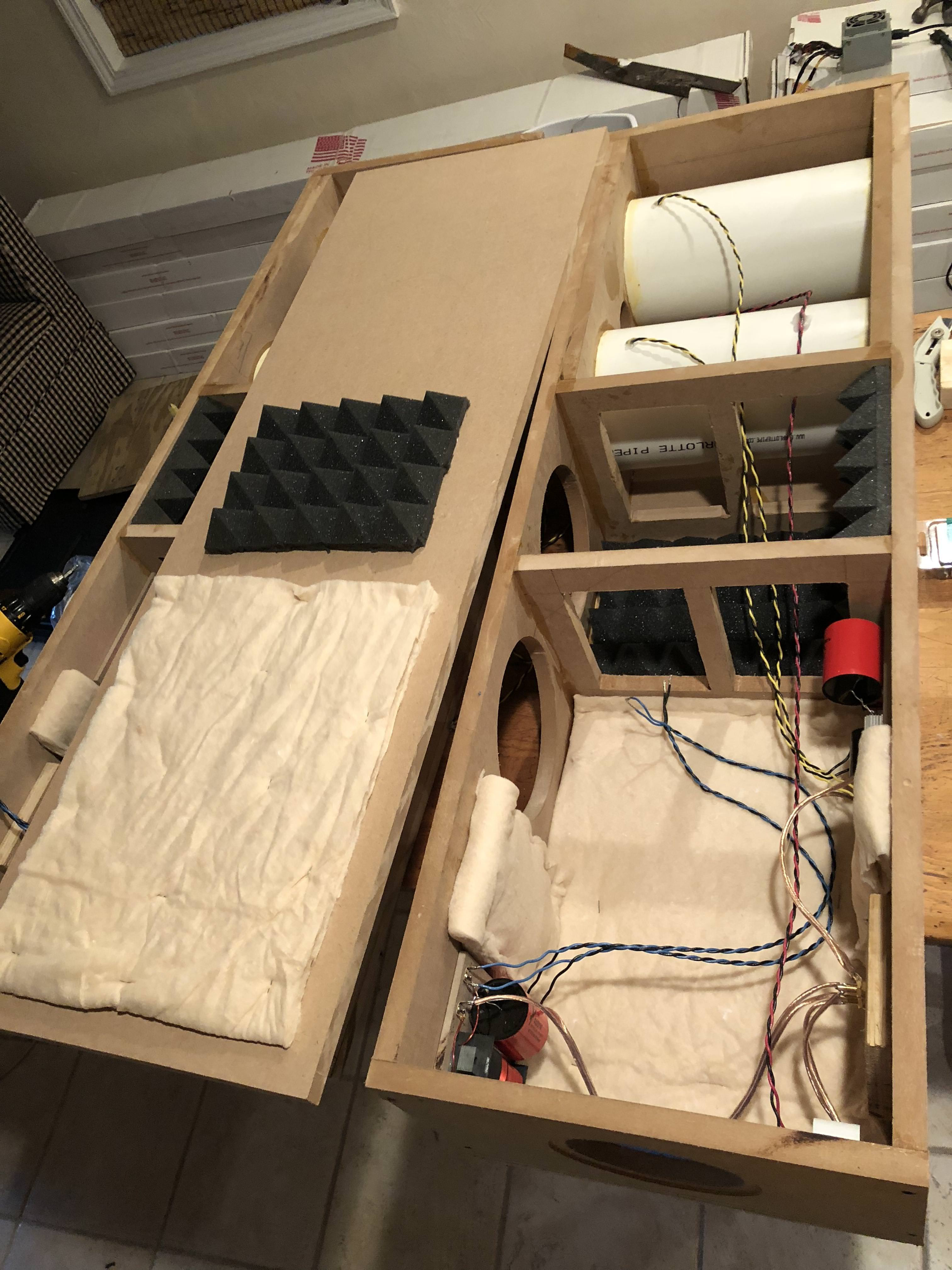

          Update: finished internal assembly with pyramid poly foam and cotton/poly batting. I opted to use 2 window pan braces to allow a more open internal cavity if I want to stuff with raw cotton or poly at the end of construction.

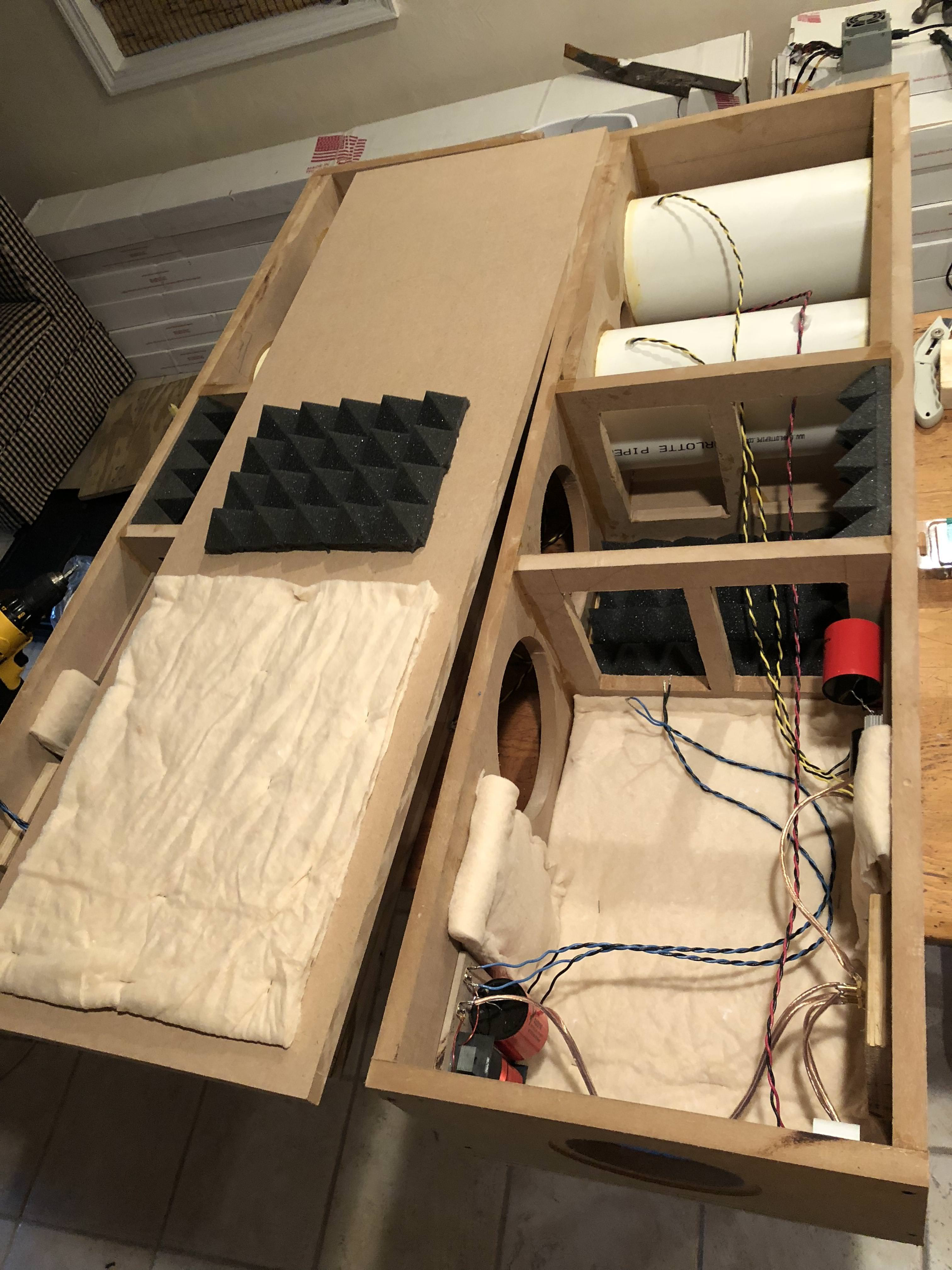

                  Just wanted to see if I could get them posted.
