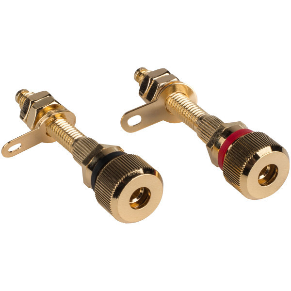

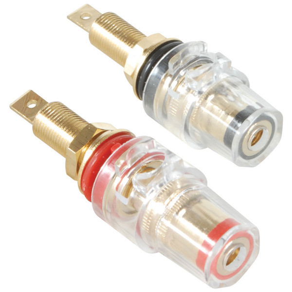

                          • Mikerodrig27
                            • Feb 2015
                            • 160
                            These are the ones that I use for my build. They're pretty good for the price
                            https://www.parts-express.com/Dayton-Audio-BPA-38G-HD-Binding-Post-Pair-Gold-091-1245?gclid=Cj0KCQiAy4eNBhCaARIsAFDVtI29yp863PBmuGr lolDAHsFo28zS7ezSdXgOYjTYiTtz8HrQngyJPTEaAuCCEALw_ wcB
                            I built a first one F6 clone amplifier and used these binding post:
                            https://www.parts-express.com/Dayton-Audio-BPFI-G-Fully-Insulated-Binding-Post-Pair-Gold-091-630
                            The only caution with the ones above, the more expensive ones, is that if you bend the tab, they will break off as they are a cast material. They are tough and extremely easy to work with. I tend to solder my wires to binding post to avoid having too many mechanical connections. They take solder well.
                            Best of luck!

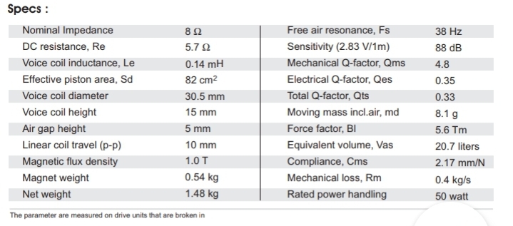

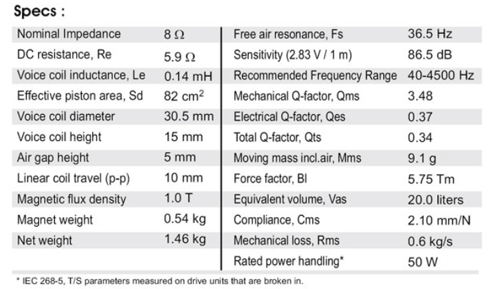

                                                                  Sorry for the delayed reply. I double checked the diagrams Mark sent me. All I had to update was the tweeter resistor from the original 6.8 ohm to an 8.2ohm.
                                                                  • Heli-Tim
                                                                    • Nov 2015
                                                                    • 159
                                                                    No problem, thanks for getting back. What was the tweeter resistance updated for? Was It to match a center speaker or something?
                                                                    I'm thinking I'm OK to build it "as is", unless there is something I'm missing. Do you know if Curt changed the value?
                                                                    Thanks again.
                                                                      • 3223
                                                                      Thanks again.
                                                                      The change is in the tweeter circuit to fine tune the new mid drivers with the tweeter. I believe that Curt worked with Meniscus and approved the change. The change is minor but a very inexpensive change that should be done.
                                                                      HTH

                                                                                          I was thinking on a recessed plastic terminal panel/box. I haven't decided yet though, as I also like the look of the big binding posts.
