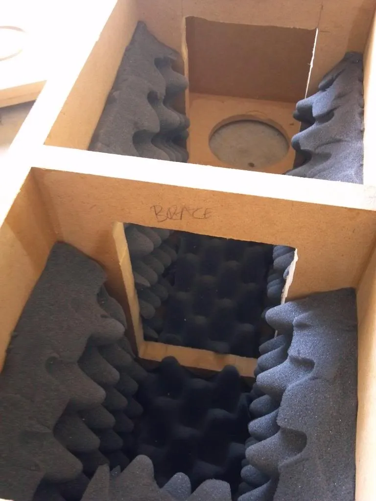

    so here are the latest pix, just lined the cabs with foam. I got the 'mini statements' kit from Meniscus and it came with 2 1/2" wedge foam rather than 2" dont think this will make much difference? Held back 2 1/2 from the back of baffle.

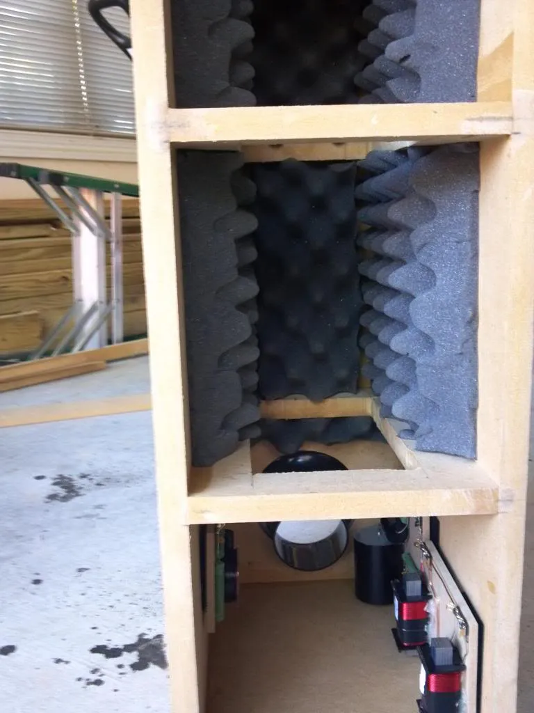

    one issue I have is that it also came with 2" foam for the mids, will this close in the sound too much? here is the back view

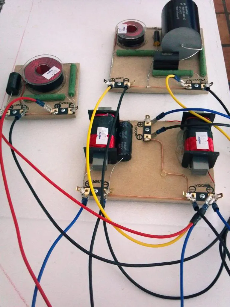

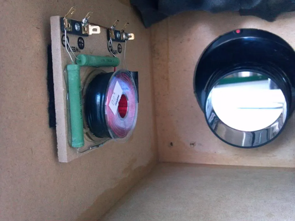

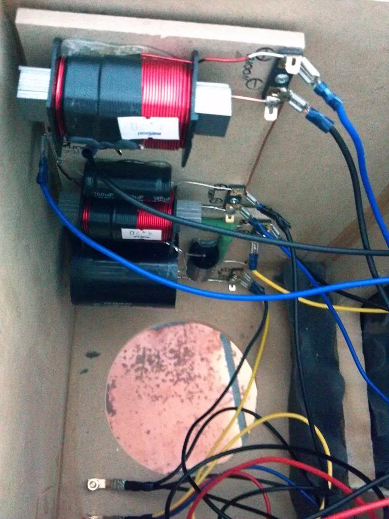

    so then onto mounting my crossovers with velcro into the lower cabinet space, just had to make sure there was enough room for my ports which are rear wall mounted.

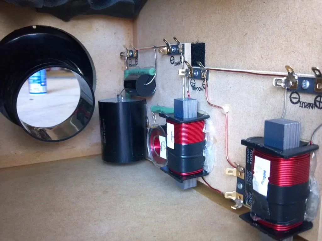

    then onto wiring them up
    hope its all good so far!!

    Nice work so far. Those are some of the cleanest crossovers I have seen that are going into the box.

      thanks BeerParty although I did get the crossovers and other components from Meniscus. Do you think the mid tunnel foam will be OK? I thought it looked a little dense with the thicker wedge foam?

          I'd recommend that you use 1" flat foam for the mid tunnel. It's available at most hobby stores in the upholstery department or online. It's not hard to find.
            JIm
            Thanks Jim, Ooops this was the foam that came with the 'kit' from Meniscus and I've already glued it in! Maybe I'll have to take a knife and cut it back or just pull out the wedge foam and start again...if the flat makes that much difference maybe I should start over?

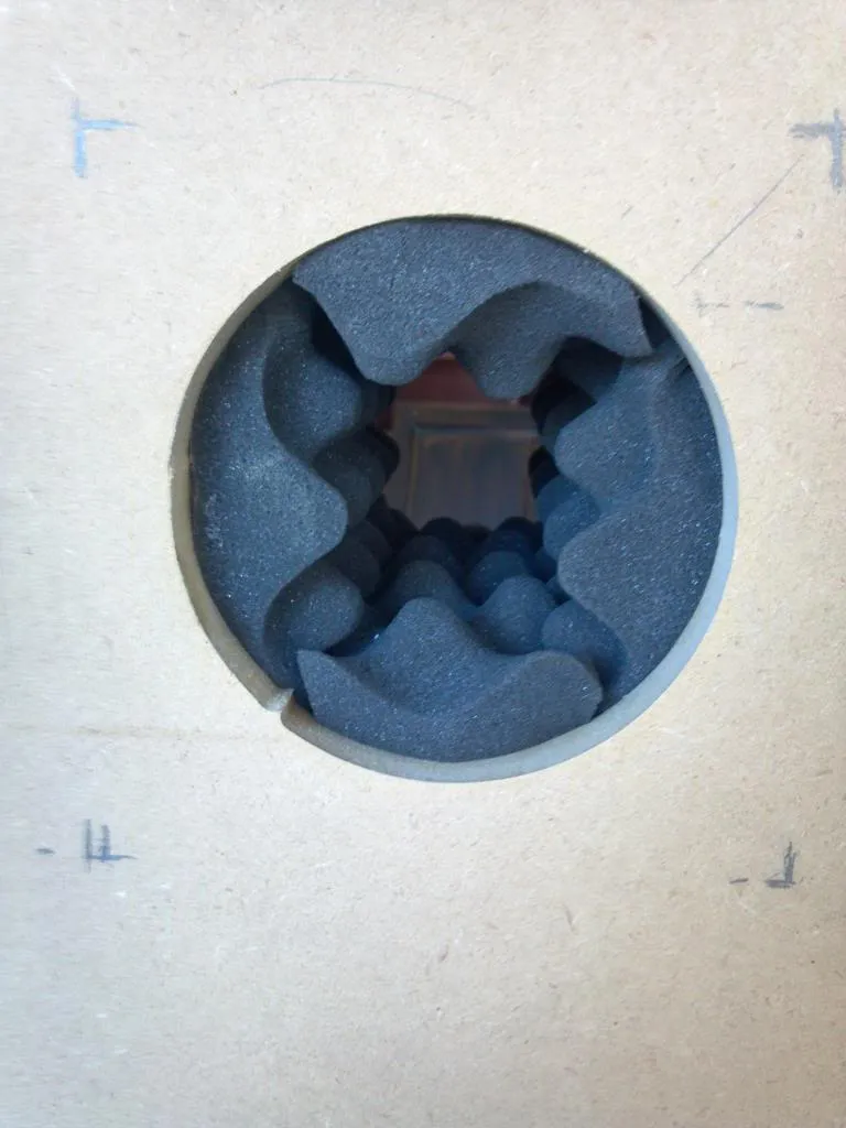

              Just measured a left over piece of the mid tunnel foam and its 1 1/2 inches should I just chop off the peaks : )
              Last edited by theSven; 21 July 2023, 08:15 Friday. Reason: Remove broken image link

                  Fire up an electric knife and slice away. It actually should be OK as is. Are your mid tunnels round?

                    Thanks Jim, tunnels are square as per the design and rear opening is round, think this is as per design too? Just out of interest what would be the result of leaving more foam in the mid tunnels ? A not so open mid?
                      I've built Statements with both the round opening and square. The square opens it up a bit. The foam can be varied for tuning. Give it a try and see how you like it. It will vary depending on how lively your room is.
