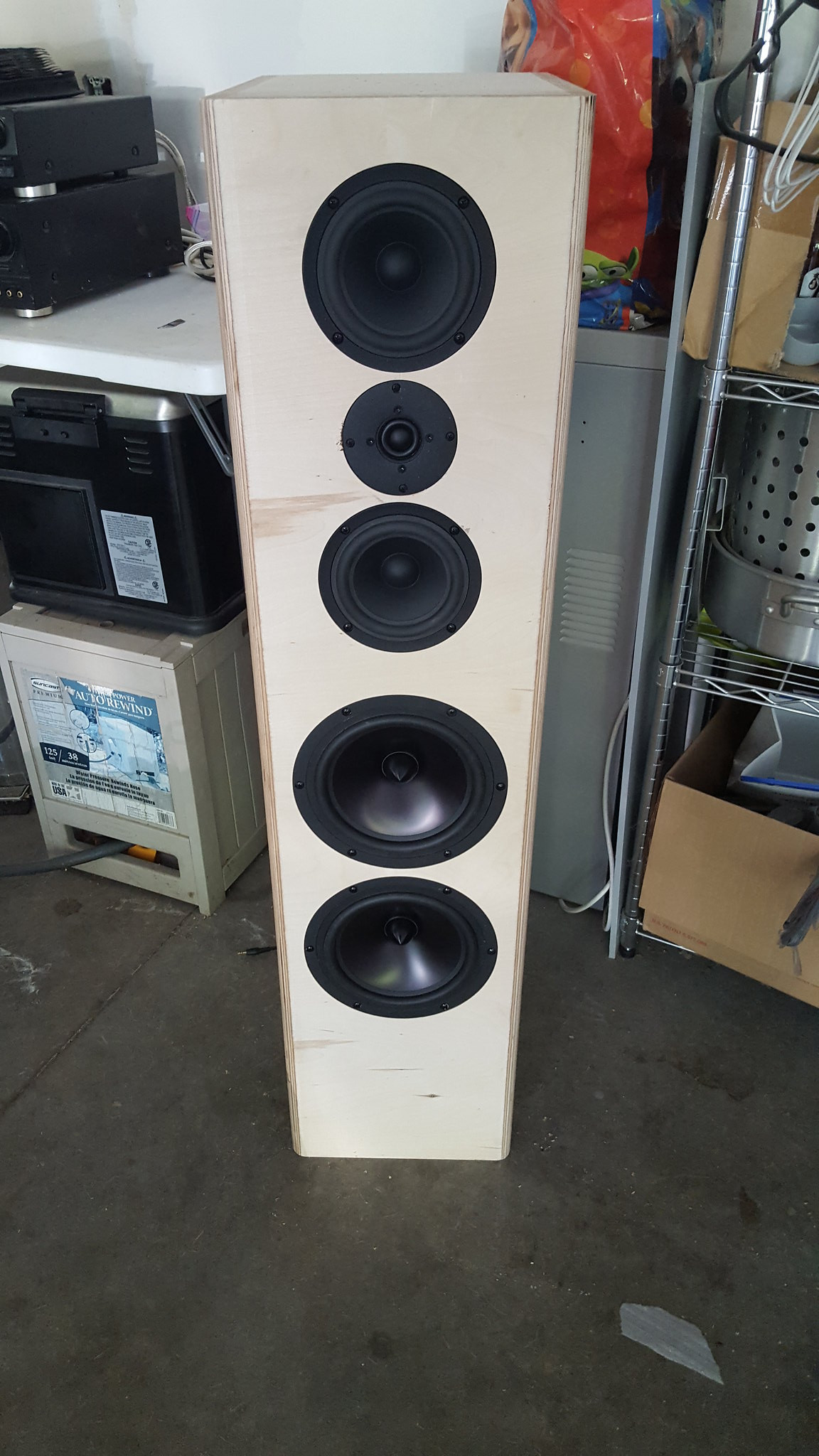

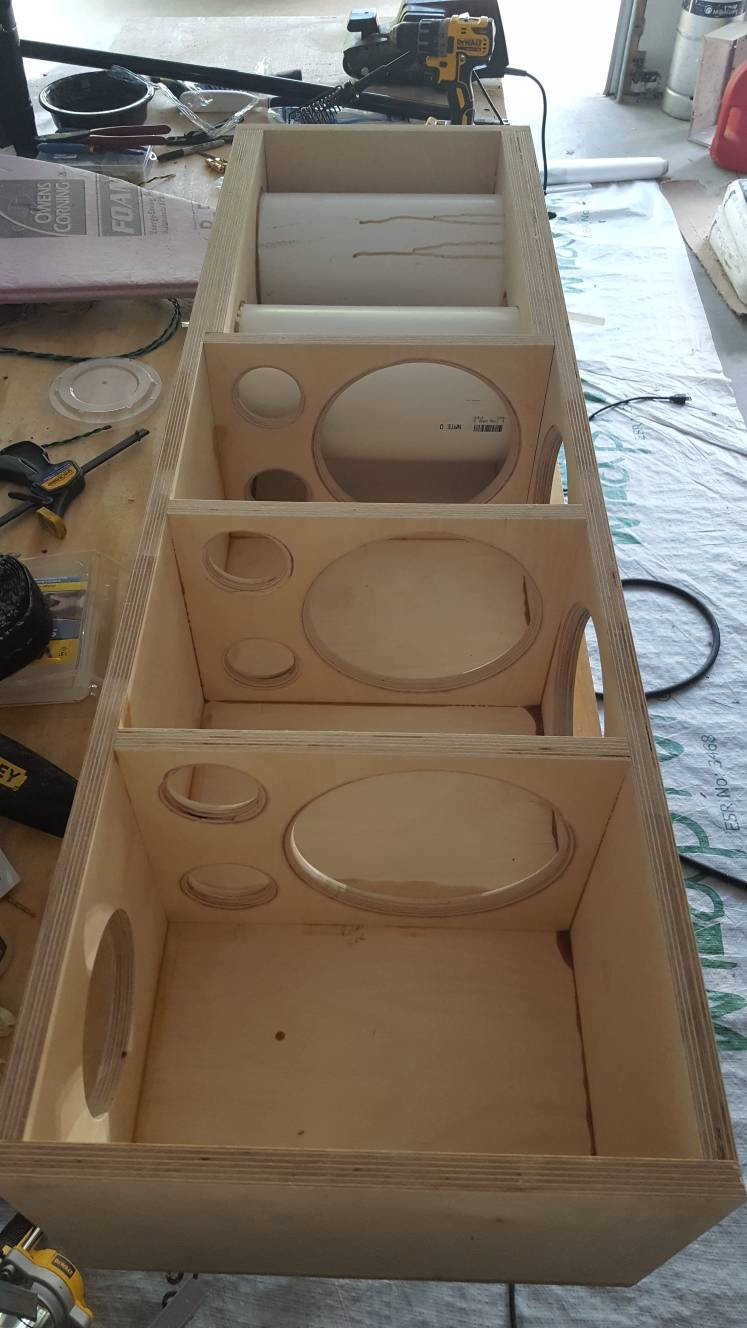

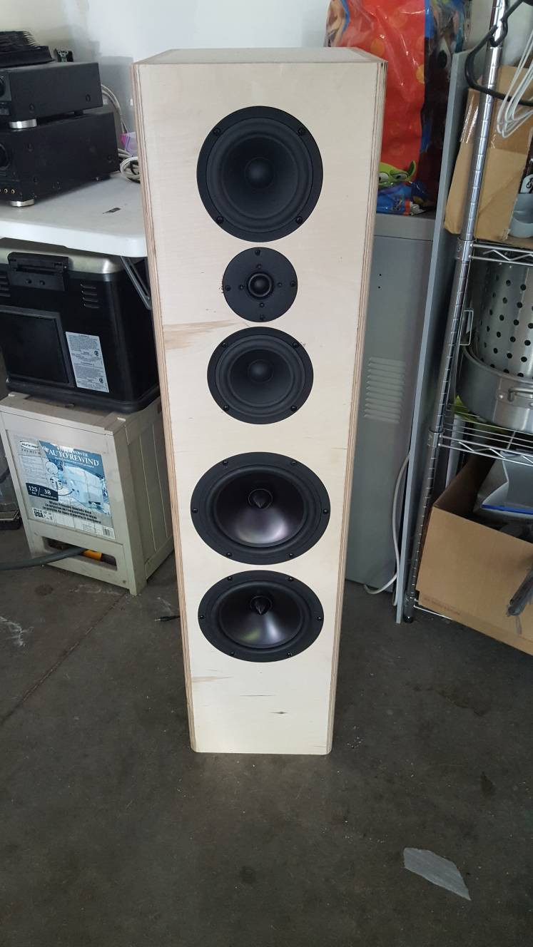

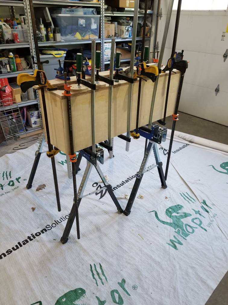

    Hi all,
    I'm really poor at documenting my build progress, but thought I should at the very least post up where I'm at in the process in case it helps someone else. And of course, to give thanks to Jim and Curt for providing the details of a fine DIY speaker. With that said; Thank you!
    Ok so where I'm at, one speaker is almost complete minus the final sanding, filling, and veneering. The second speaker is almost shelled, need to install the crossovers, add foam, button up the cabinet, and mount the drivers. So far this has been a fun project that has allowed me to start doing some woodworking again, so it's awesome in that regard. It's probably been 20 plus years and I had forgotten how much I enjoy it. Without further ado, here are some pics. ('Cause we know it didn't happen without pics)

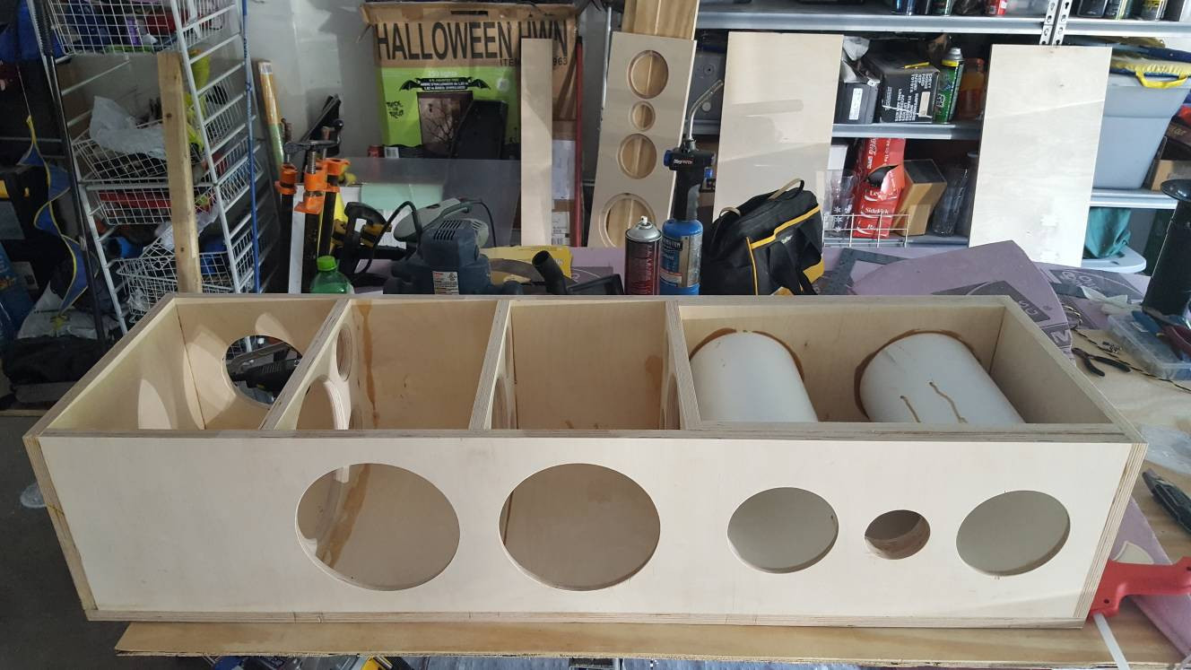

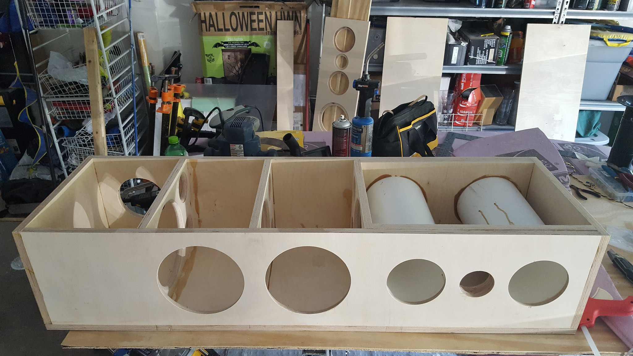

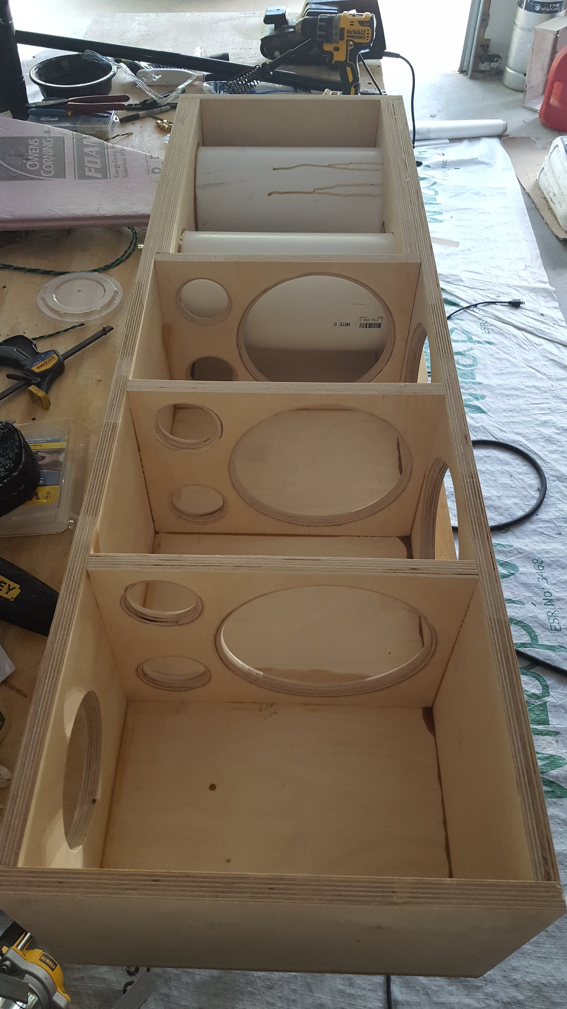

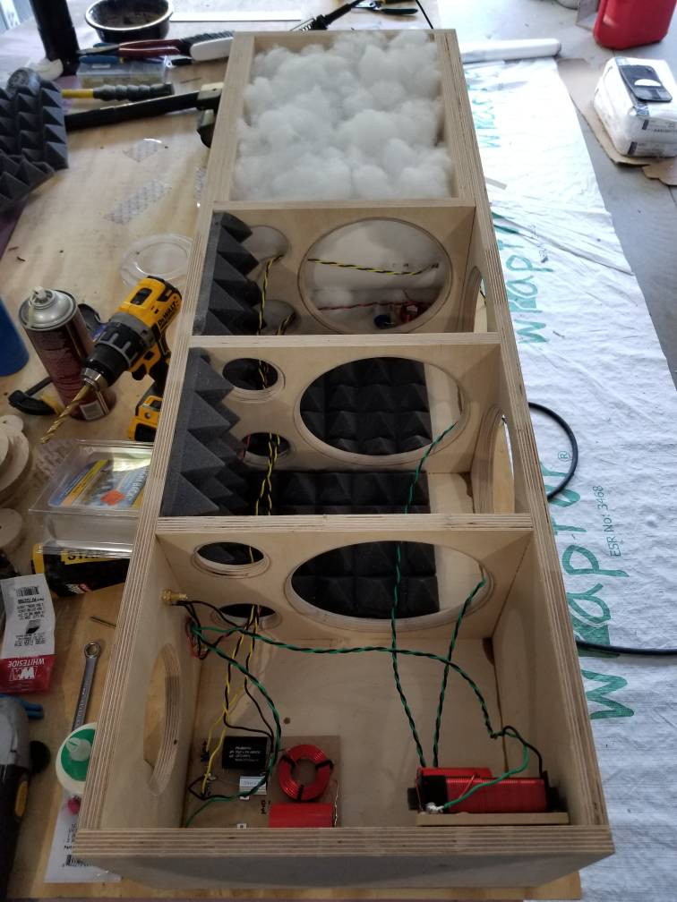

        Thanks TH, I really enjoyed your build thread as well. It kicked me in the hiney to get moving on this and post up the progress. Let's try Tapatalk images.
        Sent from my SM-G920V using Tapatalk
        Last edited by theSven; 16 April 2023, 09:01 Sunday. Reason: Update image location

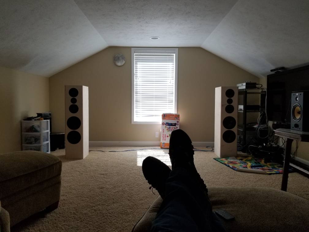

                Thanks Jim,
                With very limited time to listen so far and all new front end equipment, my initial impressions are quite favorable. The soundstage is spooky wide on good material. I've got them playing in the background to help with break in and give them a better listen later this week. I've never heard "Tennis Court" reproduced so well and it's just going to get better.
                Thanks!
                Sent from my SM-G955U using Tapatalk
                Last edited by theSven; 16 April 2023, 09:06 Sunday. Reason: Update image location

                  That’s a very nice looking setup. I like the angled ceiling, must help with the modes a bit?
                  • Chris~H
                    • 27
                    Thanks Ken,
                    I'm not sure if the angled ceiling helps or not, but the room does pretty well for audio. Foam insulation top, bottom, and sides. It's about 14'x40'x8' in size.
                    It's still a mess as it was my son's play room that is being repurposed to daddy's play room. [emoji3] Hope to have it all rearranged next weekend.

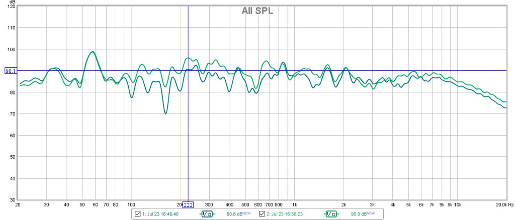

                            Could this be floor bounce or boundary bounce related? A snare drum is a neat instrument whose FR starts just above 100 Hz and fundamentally carries to around 250Hz or so with harmonics that extend well above. 4000Hz.
                            In my room, I’ve measured a minor dip with 4 different speaker models around 150-170Hz, which I assume is either a null or room related. This includes the Anthologys. Measuring the TM speakers on a taller stand changed things a bit, as did a much smaller room, that’s why I’m speculating. My mic is calibrated.
                            Here are two speakers overlayed, for example, the louder one is an MTM with the same drivers as bookshelf TM.
                            The dip is compounded by modal peaks on either side, so it sounds more pronounced than it really is. A bit of placement adjustment and bass traps/ acoustic treatment help, but I find the easiest thing to do is use a touch of EQ.
                            I could be way off though, and don’t want to hijack.

                                You may very well be right and I appreciate the insight. Rather than guess I just ordered up a Umik-1. I'll post up some results once it arrives. Assuming that REW is what you're using below? I've got about another week before it decision time on the Vidar.
                                  You assume correctly. I also have an older measurement rig with Dayton and Behringer mics as well, same effect. Actually, my Dirac measurement captures it too, but not as pronounced as I'm a few feet back for that.
                                  To be honest, I don't notice the omissions as much as the peaks, and wouldn't have guessed there was a dip without measuring. It sure helps with troubleshooting, I've messed up polarity and the odd crossover before. Maybe even more than once.
