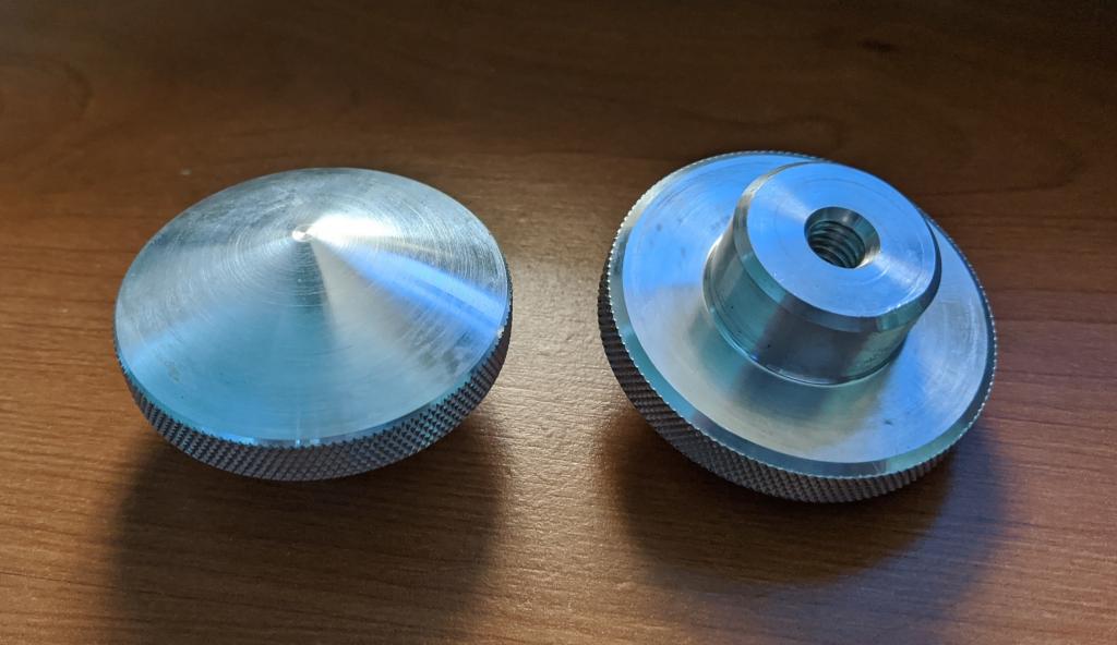

          I finally found feet! I need to be able to move these from non-optimal "just watching the news" position to "ok, let's listen!" position on the regular. Spikes are a no go, and flat bottom speakers float on the thick carpet too much / tilt to one side, etc..
          These are 2" wide, shallow cone shape, 5/16 threaded hole on a 1" base. Should be plenty strong enough, should slide on the carpet, and just tall enough to give the speakers that floating above the ground look. Really nice Morton machine shop knobs. Usually around 15 to 20 bucks each, I found a surplus seller on ebay with a pack of 14 for $50, so the sub woofer will get matching feet now too.

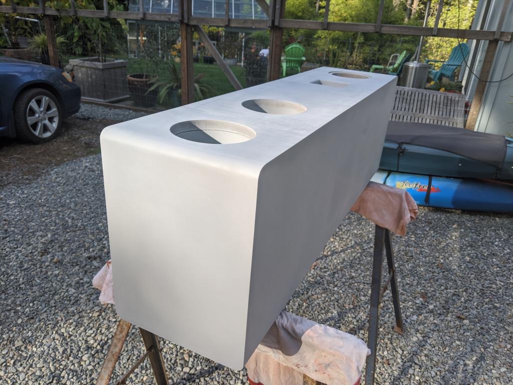

              First spot / glaze putty coat with one coat of primer sanded rough to 220. I'll sand to 400 on the veneer application surfaces. I'm using PSA veneer, so this surface prep should adhere very well. Then I'll pick out imperfections, glaze, block sand, and prime again, and maybe again on the paint application surfaces. Paint will be satin white. I do the typical spray, wet sand, spray, wet sand, final spray. When all goes well the final spray lays down perfectly. Satin is forgiving.
              I'm really liking the complimentary roundovers (front sides, back top/bottom)

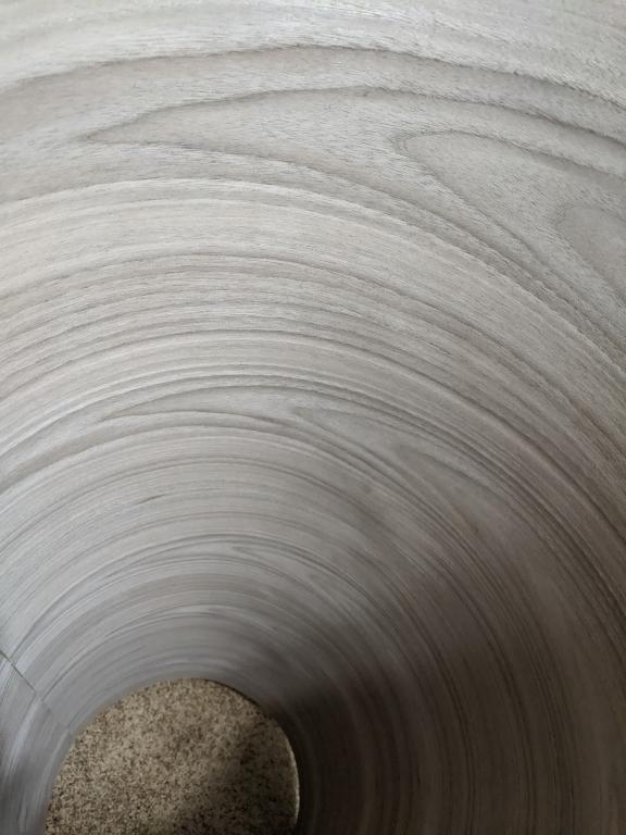

              I got my walnut veneer for the front & sides finally! (this part legitimately worries me...)

                Curious why all the effort on the mdf if you are veneering? The veneer will hide quite a bit. Be worried, very worried about the veneer around the rounded edges. I found that the more sap lines, the easier it was to wrap. I had a few blemishes, but sanding and colored pencils helped hide those.
                • 707kevin
                  • Oct 2010
                  • 52
                  I hear ya - right or wrong it's because I bought PSA veneer, which will stick so much better to a smooth sealed surface. And because I already needed to fill and prime the painted sides, so another three cans of primer is an easy way to seal it up and give me a 400 grit smooth surface for the PSA veneer. And because I know paint prep far better than I know veneer prep, for whatever that's worth So I figured instead of buying sealer and learning something new, I'd stick with what I know and just do it.
                  Oh, trust me, I am legitimately frightened of the entire veneer process! The sample I have was able to wrap around a sharpie pen without splitting, so I hope hope hope I don't have a bad spot along the way and 3/4r will be fine. You scaring me now! ha! :E
                    • 2135
                    Sealing the joints and surface is a good idea, it will help reduce potential joint telegraphing down the road. Also, you could use some of this to help with cracking when you apply the veneer around the radius. https://www.veneersupplies.com/produ...nditioner.html I think this is typically used on raw veneer, but I think it couldn't hurt. This website in general, is pretty good for all kinds of questions you might have.
                    • Mikerodrig27
                      • Feb 2015
                      • 167
                      Wouldn't you have to seal the inside as well?
                      • 1Michael
                        • 295
                        You do not want to seal the inside of the box, unless you want the wood to possibly rot...

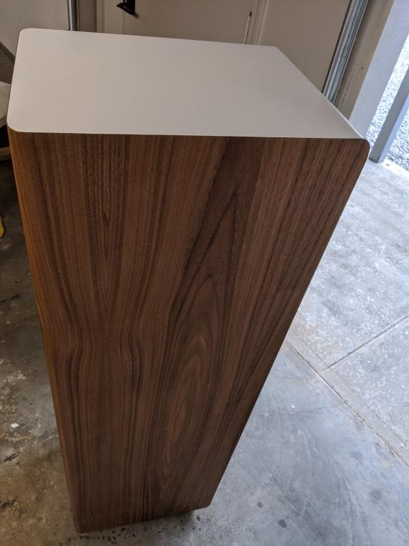

                                Applying 4ft wide veneer is ... nerve racking. My awesome wife helped, and her end turn out better than my end! Worked from one side to the other wrapping around. Scraped with as much pressure as I could without damaging the veneer with a 1x3 with a smoothed edge to work out any bubble, and ensure good adhesion. Then scraped again 30 minutes later. I'll do a natural oil finish, no tint, with some sanding while wet on the final coats to hopefully fill the grain in smooth and buff to a satin finish.
                                Rear, terminal posts installed, port tube installed.
                                Front, used a low profile laminate trim bit. It was short enough to trim veneer around the tweeter even.
                                Top. Trimming the curves was a pain. Use a new blade any time you are about to do a difficult cut across the grain, then make multiple passed to score first.

                                  Dude, looks sharp! Your finish came out nicer than mine. Well done. Having done it, would you do it again? Also, how did the wood react? Did it fight in the corners on the ends? I used about 15 razor blades to trim mine. Very nerve racking and painstaking.
                                    Very, very Nice! :T

                                        Curves. Are. A. Pain.
                                        Prep, sanding, everything was just so much more work.
                                        Painting, you try to move from horizontal to vertical surfaces in one coat so it blends nice. (not so worried about the bottom) This is tough. Then you think you're all good and realize you need another coat to make it better. But now a new flaw pops up. IT'S GOOD ENOUGH! lol
                                        Wrap around veneering, it just adds so much difficulty in order to not get any bubbles and a perfect wrap. I only had a margin of 1/4" top to bottom on the veneer as we wrapped it around.
                                        I'm conflicted. Having done it and see the results now I can't imagine doing flat, square, plain boxes again. Also having done it, I don't really want to do it again, ever :E I can also see ways I could do it better though. It didn't help that I dragged it out so long. Every step was like motivating myself to start a project again. Lost momentum is a killer on something like this.

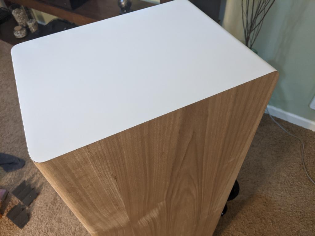

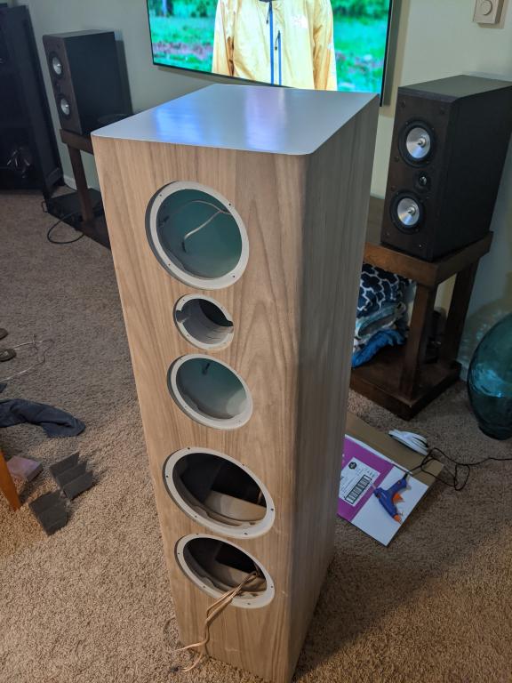

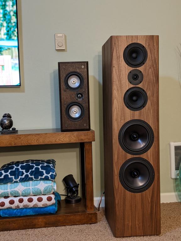

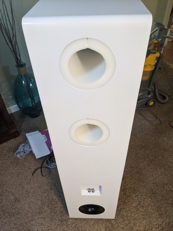

                                                        Here's the final. First one done. After the white paint is fully hardened in a month or so, I'll buff it out and it should brighten up a bit.

                                                            Very nice. What did you finish it with and what did you sand it with if I might ask. Your finish on the veneer is exceptional.
                                                            • 707kevin
                                                              • Oct 2010
                                                              • 52
                                                              Sand 180 then 220. Teak oil, wiped off, dried a few hours.
                                                              More teak oil, sanded while wet with 400, dried a few hours, do it again.
                                                              Sanding while wet fills the grain and makes it smith to the touch. For a smoother, glossier finish let each coat dry overnight after sanding. I rushed it for a satin finish

                                                                  Hi Kevin,
                                                                  They look beautiful but the real question I have is, are they playing music yet and I'd love to hear your sound quality feedback.
                                                                  Enjoy the music!
                                                                  • 707kevin
                                                                    • Oct 2010
                                                                    • 52
                                                                    Hi Kevin,
                                                                    Enjoy the music!
                                                                    This is the REAL question, isn't it? Unfortunately the paint on my second enclosure had a few bugs on it (literally, follow the trail of footprints until you find the deal fly...jerks!), and a run I'm not happy with. Since then the weather has turned cold and humid, so terrible for painting. I'll plastic off the garage in a few weeks and finish it up!
                                                                    I did get a few weeks on them before I took them apart again for prep & finish. They're sort of amazing.
                                                                    • 707kevin
                                                                      • Oct 2010
                                                                      • 52
                                                                      And THANKS!!!
                                                                        Sorry about the paint issue but I'm pleased you're enjoying the music.
