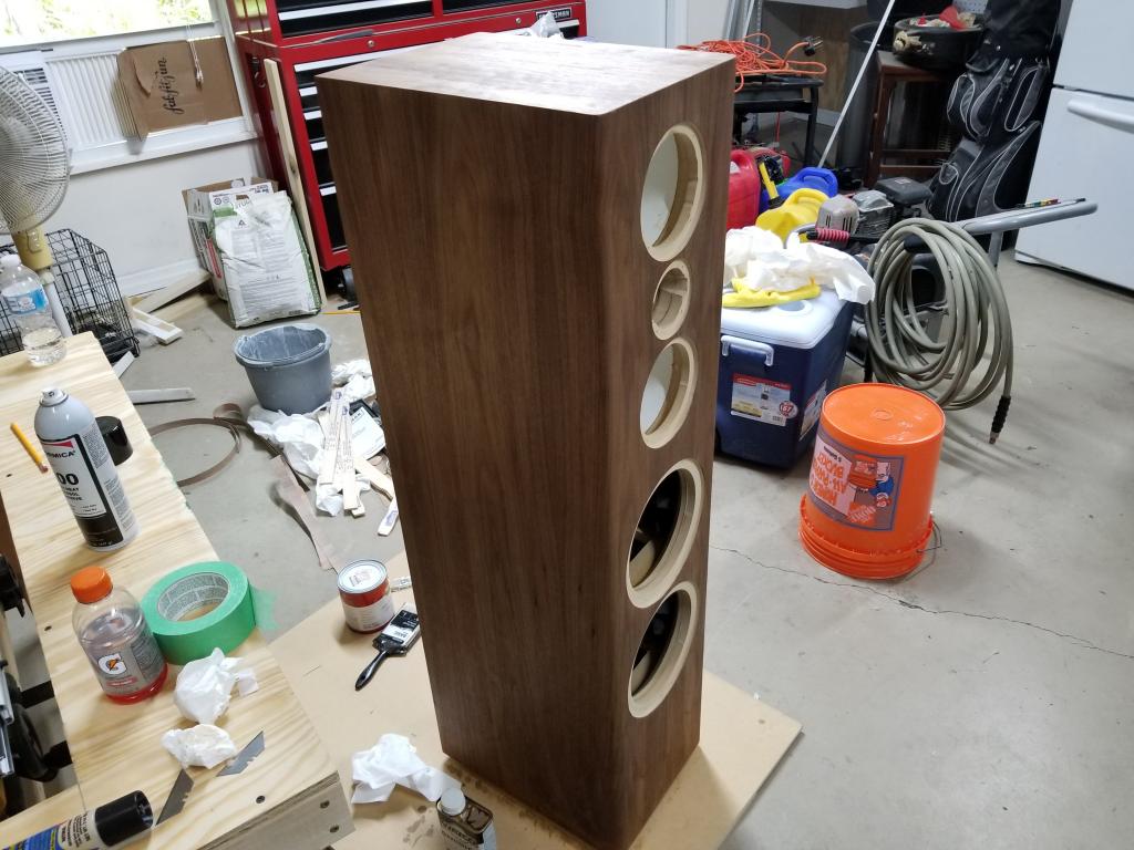

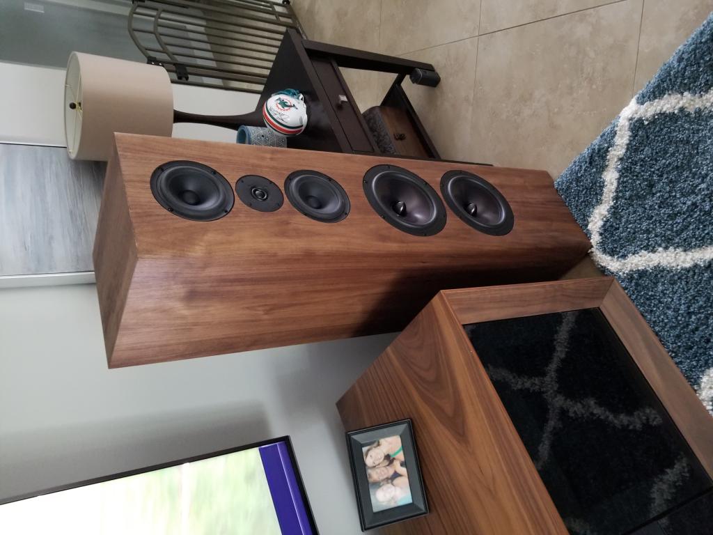

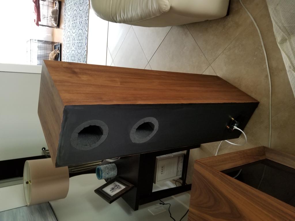

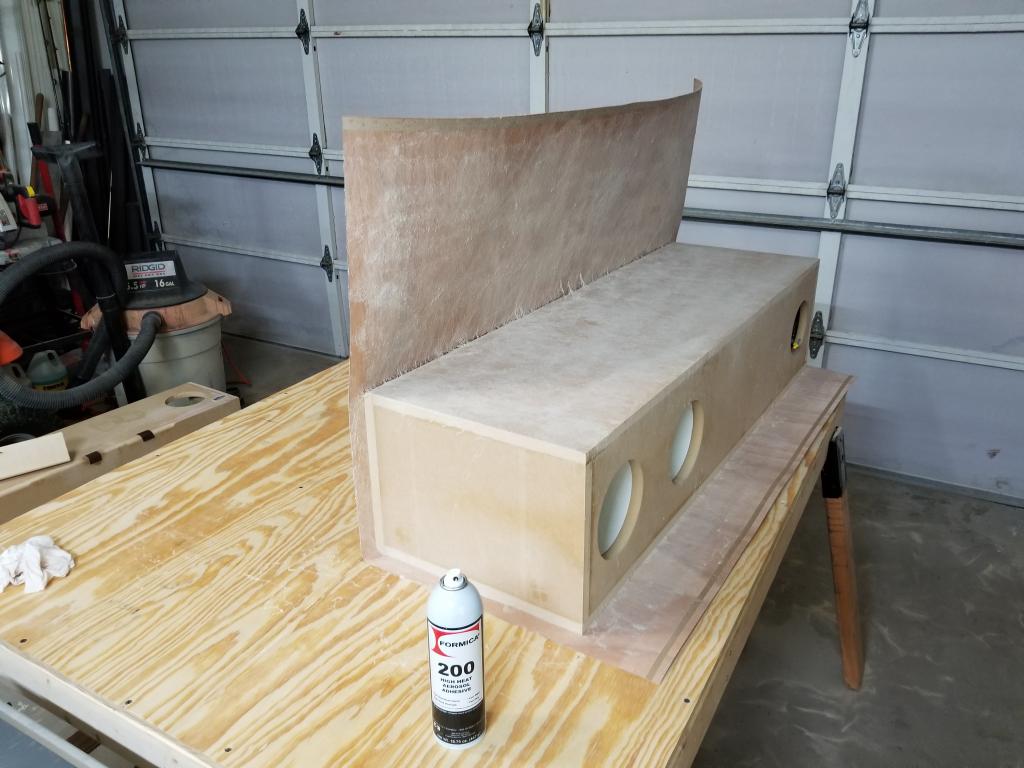

                    Hey guys, quick update. Decided to radius the front corners and apply the walnut veneer directly while wrapping over the radii all in one piece. Needless to say it was a pain, but I think it paid off. Take a look and let me know your thoughts.

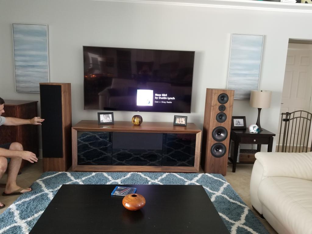

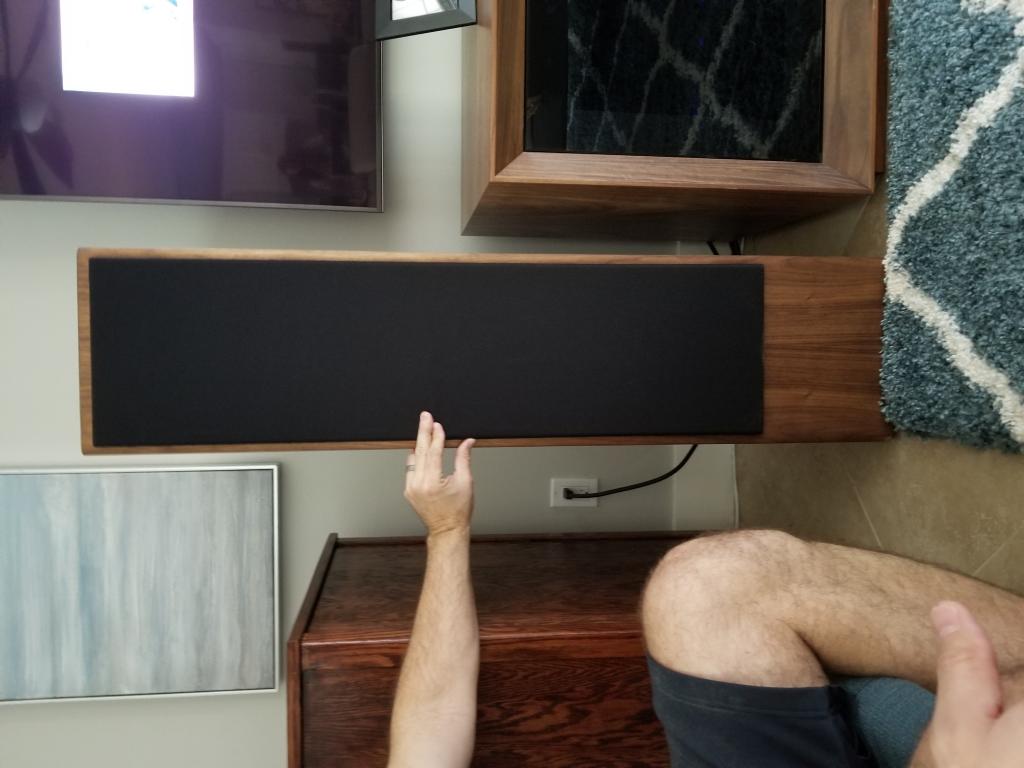

                            Grills or no grills??

                              #104
                              I see the child gate in the hall so I would stick with the grills. Looks good either way!
                                #105
                                The grills look great. However, the speaker crossovers were designed without a grill so for best sound, grills off. WAF often dictates grills be in place unless you have a man cave. Grills are easily removable when you want to do some critical listening so its easy to have peace in the house and still enjoy the best sound when you want.
                                Very nice job!
                                • JoeAngelicchio
                                  • Oct 2006
                                  • 47
                                  #106
                                  Looks good with the grille too. What cabinet is that??
                                  • rick844
                                    • Jun 2019
                                    • 232
                                    #107
                                    Thanks all. Was curious if sound would be affected so that may very well push me over the edge. The cabinet was hard to find but is exceptional. It is MDF with a walnut veneer just like the speakers. I will dig to find where I bought it and let you know. I would buy it all over again.
