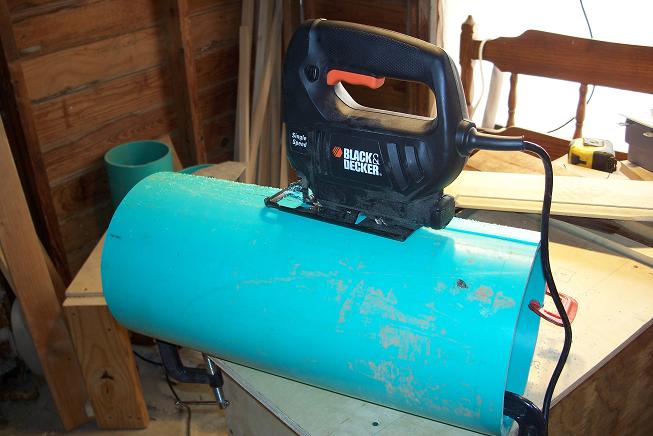

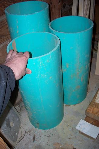

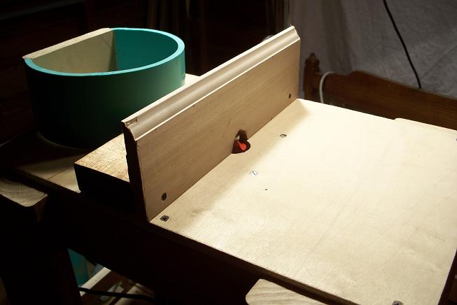

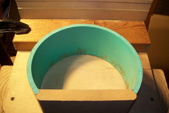

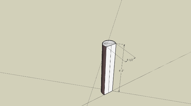

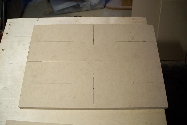

              Beginning Pictures

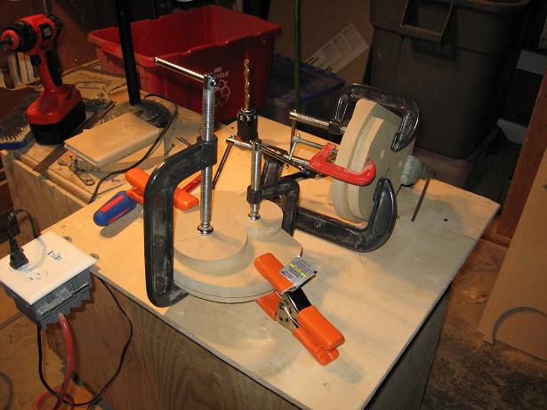

              As promised, here are some pictures from some mock-up work last night. I've got the PVC enclosures cut down to size (18.5") as can be seen in that first photo. I am using some 8" Pipe which has 1/4" walls, and unless I am completely mistaken, it should be fairly inert. If not I have though of using a butyl deadener to line the inside before stuffing it.
              The second picture illustrates my test baffle set up. I cut a V-Groove with my high-end router table (as can be seen in exhibit 3) in the lower half of both sides of the MDF baffle. Then, per the recommendations of others I put a 3/8" roundover on the upper half. Then all that was to be done was pry open the pipe and slip in the baffle. The beauty of PVC is that even though I cut a 6.5" strip out of the pipe and put a 6.5" wide baffle in the gap, it is still very tight as PVC is in constant tension apparently. I'm quite please with how well it went together considering my rudimentary tools and tiny little workspace. I might get brave one day and post a picture of my "workshop". Thanks again to all who have assisted and please feel free to make comments and suggestions.

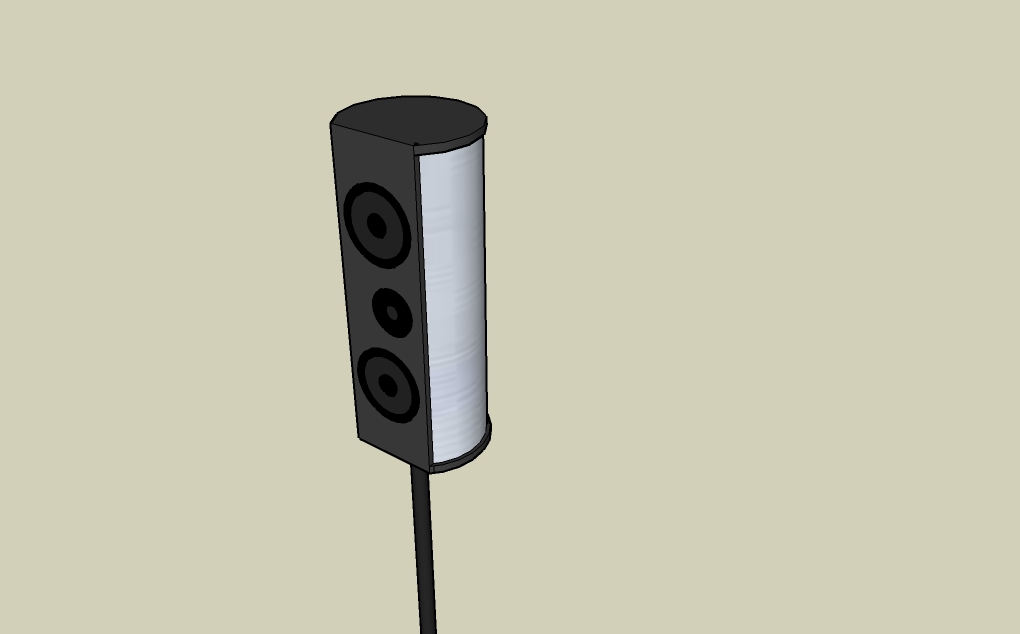

                and one more thought on finishing...
                The Sketchup rendering above shows an "aluminum" material on rounded back. I am thinking about using either a silver vinyl laminate on that or even picking up a sheet of really thin sheet metal of acceptable finish to bend around that. I would consider using a silver paint, like Zaph did on his Slimline Wallmount Speakers . However, I am not convinced that any paint would durably adhere to PVC. Anybody had any luck with painting PVC??

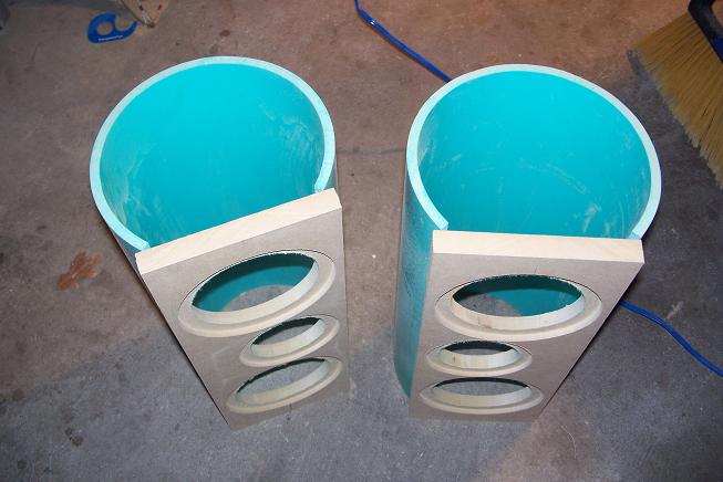

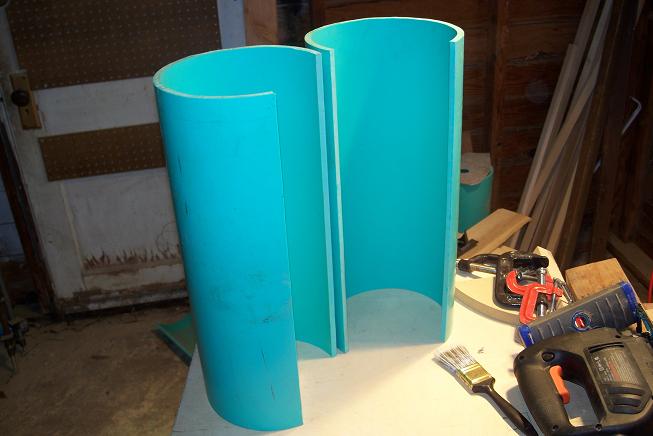

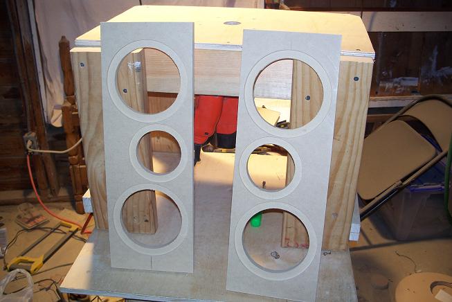

                                    Guys, just wanted to give you a quick update on the progress of the weekend. The MDF dust was flying as I learned about routering. These are my first baffles ever and I'd say they turned out pretty well all things considered. Thanks to everyone for your suggestions, I'll comment more a little later once I get caught up. Let me know what you think!

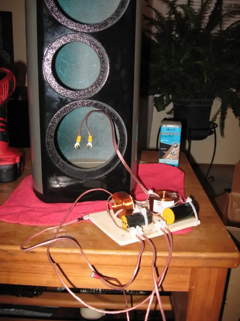

                                      Well, progress has been slow recently but I have done a little bit. As you can seen in the picture, I built my crossovers and tested them. Everything sounds as good as it should all wired up with alligator clips and sitting on the floor. I also cut all the rest of my MDF caps except for one, so now I need to sand them to shape, round, them over, and glue it all up. I have also found a great solution to painting the PVC. I went to an auto parts store and found this can of BullDog adhesion promoter. Its made to help paint stick to bumpers and whatnot. You just spray that on, wait a minute or two then paint. I am using a silvery auto paint, then going on with a clear coat wheel protector after that. I end up with a really hard scratch and chip proof finish. For the black parts of the speaker I am thinking about using truckbed liner if I can get it to satisfactorily stick to MDF. Any suggestions?

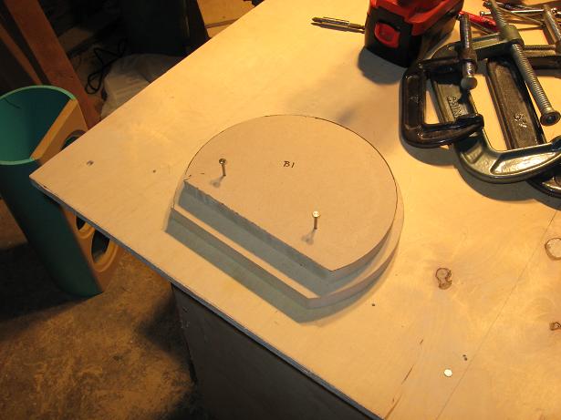

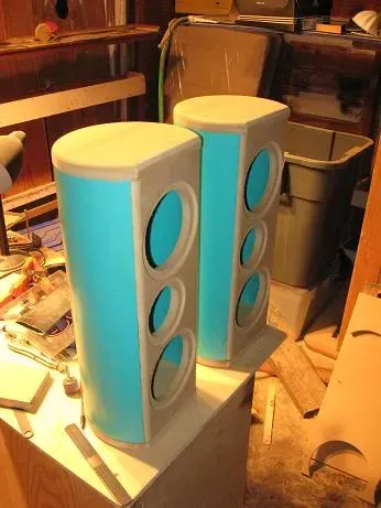

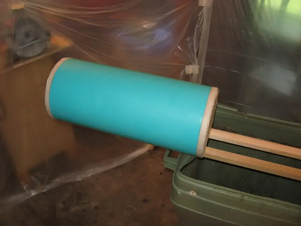

                                                    small update
                                                    Well, here's another small update, I only seem to be able to work at this in 2 hour chunks and that can slow things down a bit...however, it does get worked on and thats the important part!
                                                    I got the rest of the caps cut out after dealing with a bout of too much bad fried chicken. Then last night, I glued them all together. I was having trouble figuring out a way to keep the pieces aligned while I clamped them. So, I ended up just aligning the plates with the PVC on them, then carefully pulling it off without moving the plates. Then, holding the plates together I drilled a couple of pilot holes and pinned them together with 8 penny nails as shown. Then I could pull the top plate off and apply glue and realign with the nail holes and clamp it in place. I was having to get creative with my clamps to get all the plates glued up but I got it. Good to have that done, now its on to trimming the overhang off of them, roundover the edges and actually glue the box together.

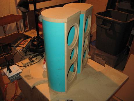

                                                      Then here are both cabs with all the plates rounded and in place:

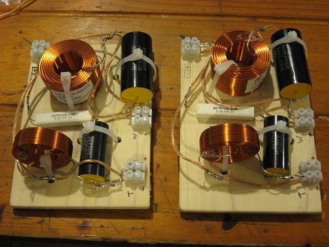

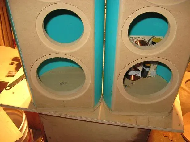

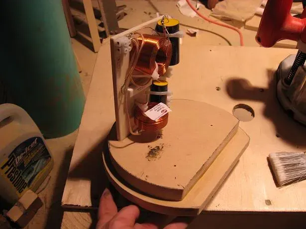

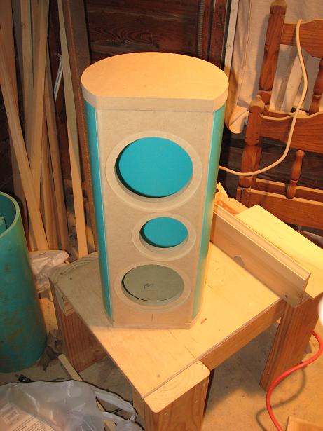

                                                      Then here we have my crossover mounted. I routered a 1/4" slot into the plate for crossover to slide into. I'll hotglue it in place when the time comes, but it is already pretty secure:
                                                      And here is what it looks like assembled with the crossover mounted:

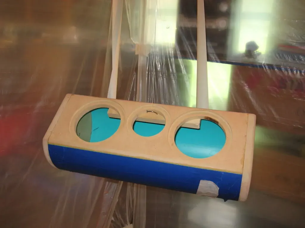

                                                      Right now I have a mock up of the baffle/PVC gluing up to see how the epoxy I used will work to hold the two materials together.
                                                      Last edited by theSven; 15 July 2023, 09:38 Saturday. Reason: Update image location

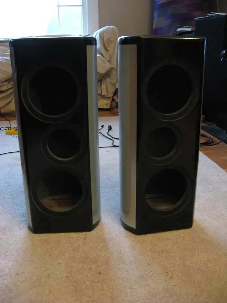

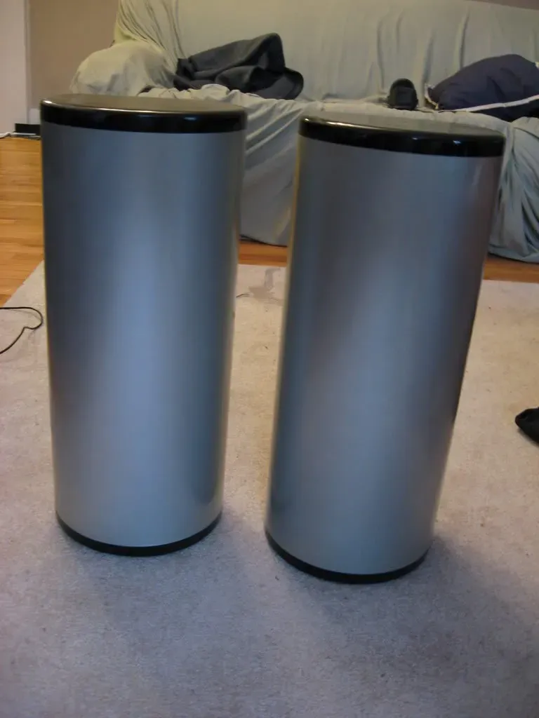

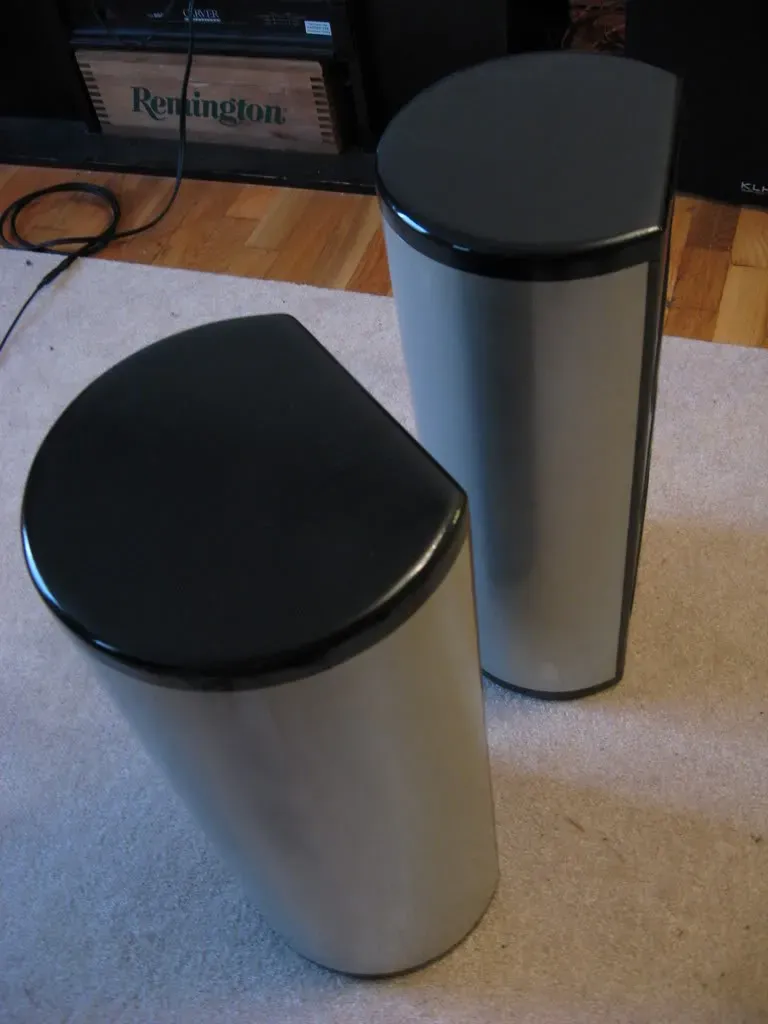

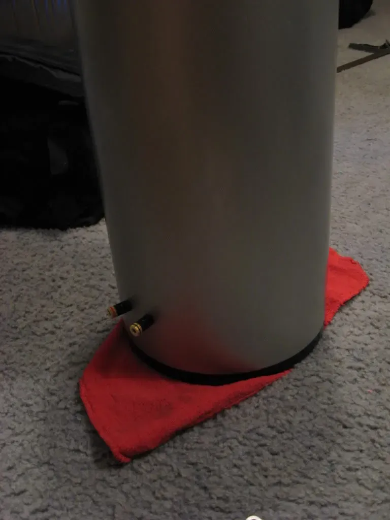

                                                          Finally an update!

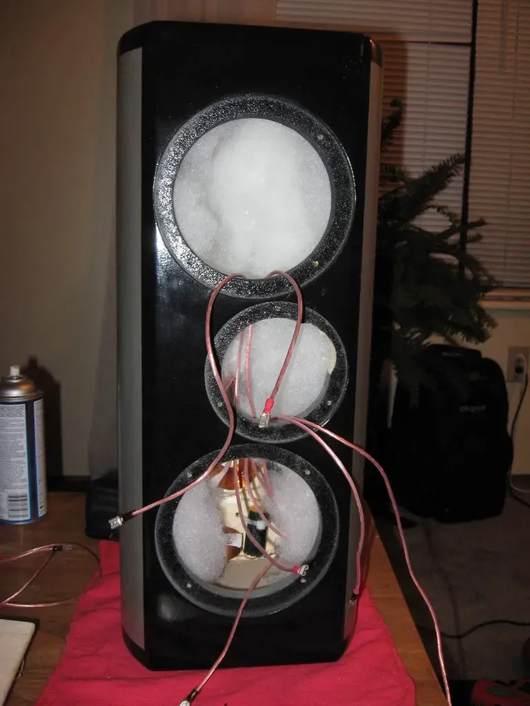

                                                          Well, after being backburner for a long time and just spending a few minutes here and there on them, I think I am finally ready to say that the finish is complete!
                                                          This is my "paint booth" with one cab ready to paint the silver on the PVC:
                                                          After painting the silver, i taped off the silver and prepped for the satin black. Here it hanging from a rafter from like a 50lb test line with some tape to keep it from swinging. Works really well actually as fishing line really doesn't obstruct the spray paint. Here it is:
                                                          Then peeled off the tape ever so gingerly, did a bit of touch up and sprayed on some clear coat. They are a bit dusty but here is the final product! I have some stands designed in my head which should look pretty awesome with these but will probably have to wait until after I am married. For now they will sit on my monkey coffins as zaph calls the big 3-ways. Finally:

                                                                Finally Done!! ....mostly
                                                                Well, I thought the day would never come but I've finally got the enclosures loaded and am listening to these guys now. What a treat! Thank you so much Curt for your help in this endeavour and all you guys and your suggestions, recommendations, encouragement and support!
                                                                Here we have the newly installed binding posts:
                                                                and the crossover all wired up and getting ready to go into the box. I have sprayed a contact adhesive on the inside walls of the enclosure to help the polyfill stick:
                                                                Now with the crossover mounted in its slot in the bottom, all wires hooked up and protruding from their appropriate holes, the polyfill stuffed and in and stuck on the walls:
                                                                And finally, with the drivers loaded and sitting next to the TV. Don't worry, its just temporary until my projector comes in. I just got married and moved into my wifes apartment so still transitioning. Hmmm... looks like I've got a lot of fingerprints and smudges on those baffles, need to get that wiped off and get some better pics:
                                                                Whew, what a relief, and what fun, not sure I'll do an enclosure with such different materials again... well maybe. My next question is, considering my choice of DIY speakers, what receiver would you guys recommend to power these? I currently have an RCA Pro series receiver rated at 100wpc but as always I'm skeptical and would like a little more headroom. Any recommendations? I can't wait to get these guys paired with my Tempest-X sono:
                                                                I grew up in the Philippines, so for now is has a kind of cloth made from dyed grasses wrapped around it. It is blowing my mind even in a large 25x25x9 living room with plaster walls and ceiling and a 3/4" thick hardwood floor, large openings into other rooms, etc....! Especially liking Transformers at this point, I could watch it over and over just for the LFE!
                                                                Well, enough rambling, thanks for watching the progress with me boys!
                                                                Last edited by theSven; 15 July 2023, 09:43 Saturday. Reason: Update image location
                                                                  Good job! :T Nice to see something different and let's hear it for non-parallel walls!
