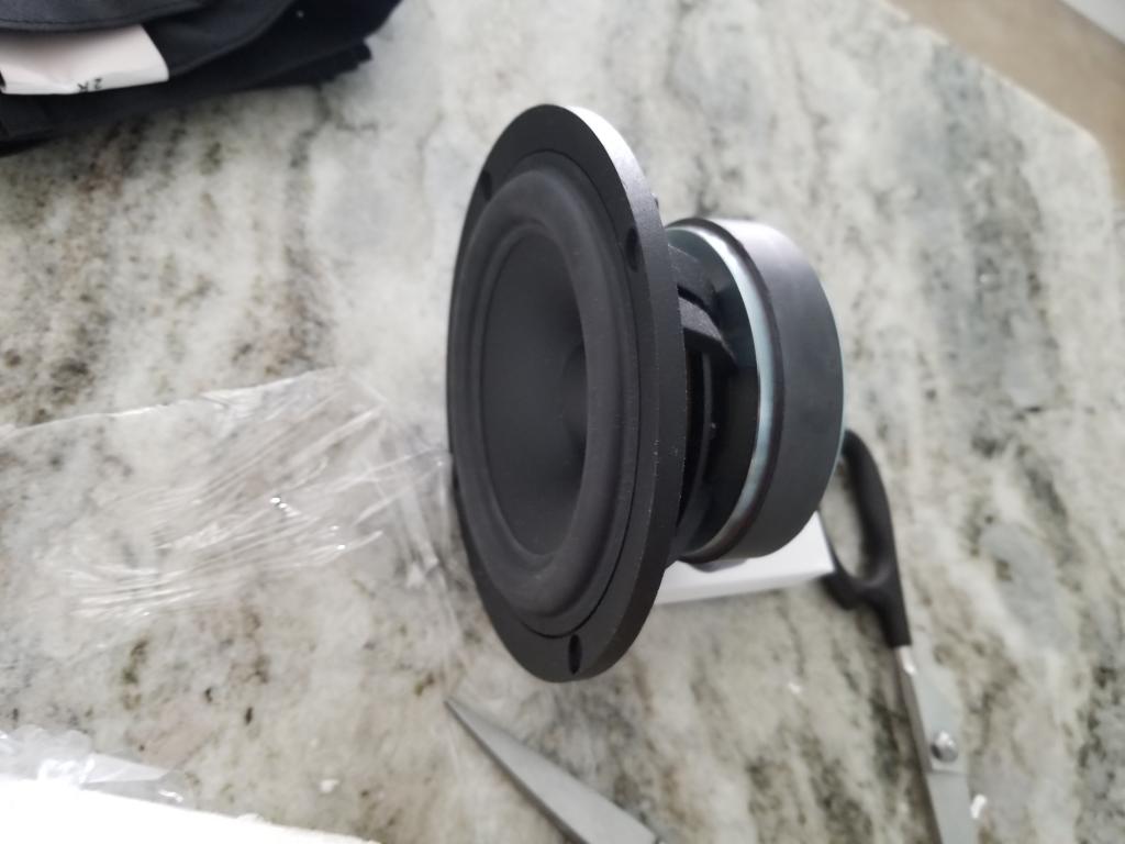

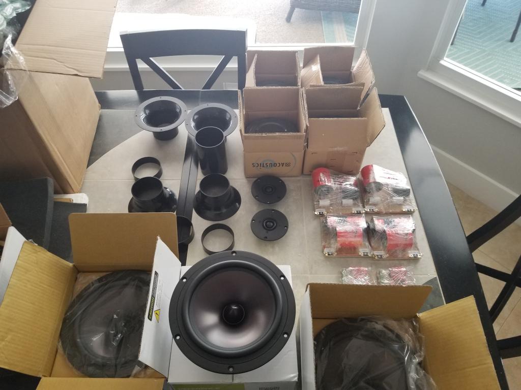

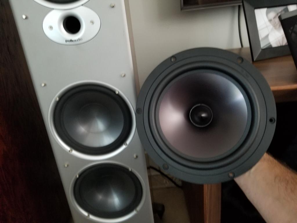

      First box arrived from Meniscus. One photo compares the new woofer to that in my Polk. Only a slight difference. Lol

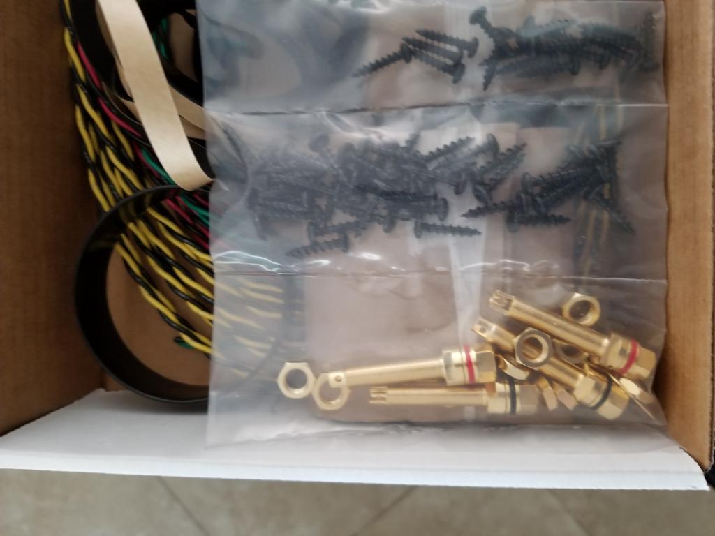

        Everything was well packed. I also got the tweeter crossover, but I'll post up better pics after I get the second box.

          Pretty sweet! It looks like meniscus does a good job of making sure you have everything you need.

            Yes, their kit is exceptional. Very well put together and everything was packaged to perfection.

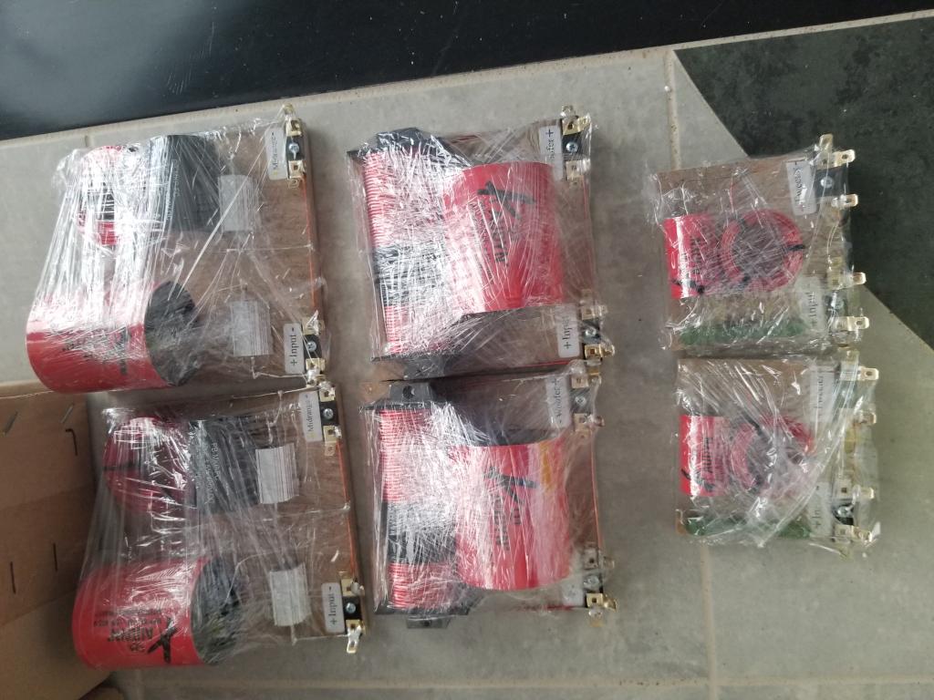

              More pics

                Crossovers look pretty sweet!

                  Yeah, they charged around 80 dollars to assemble all 6 crossovers. Worth it to me.

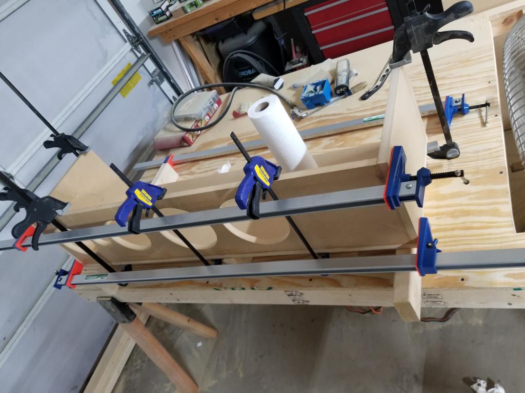

                    Started assembly
                    Last edited by theSven; 23 March 2023, 16:59 Thursday. Reason: Update image location

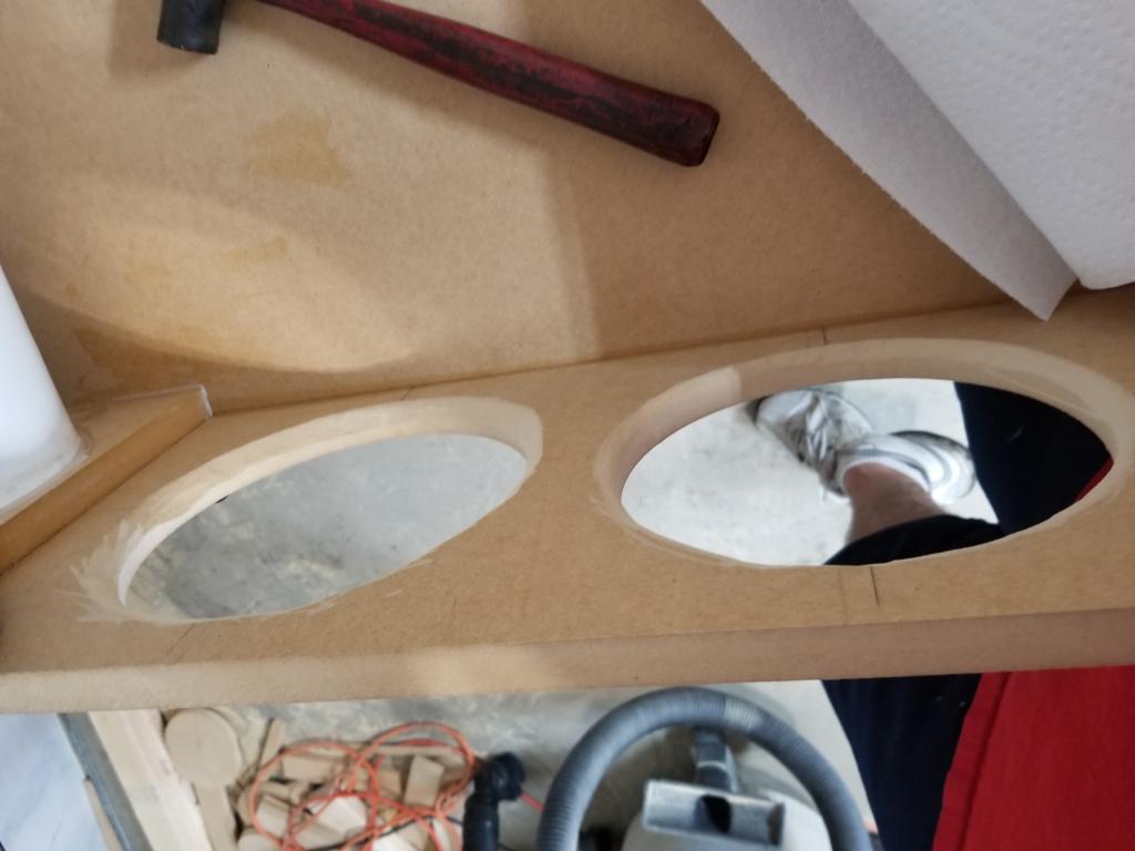

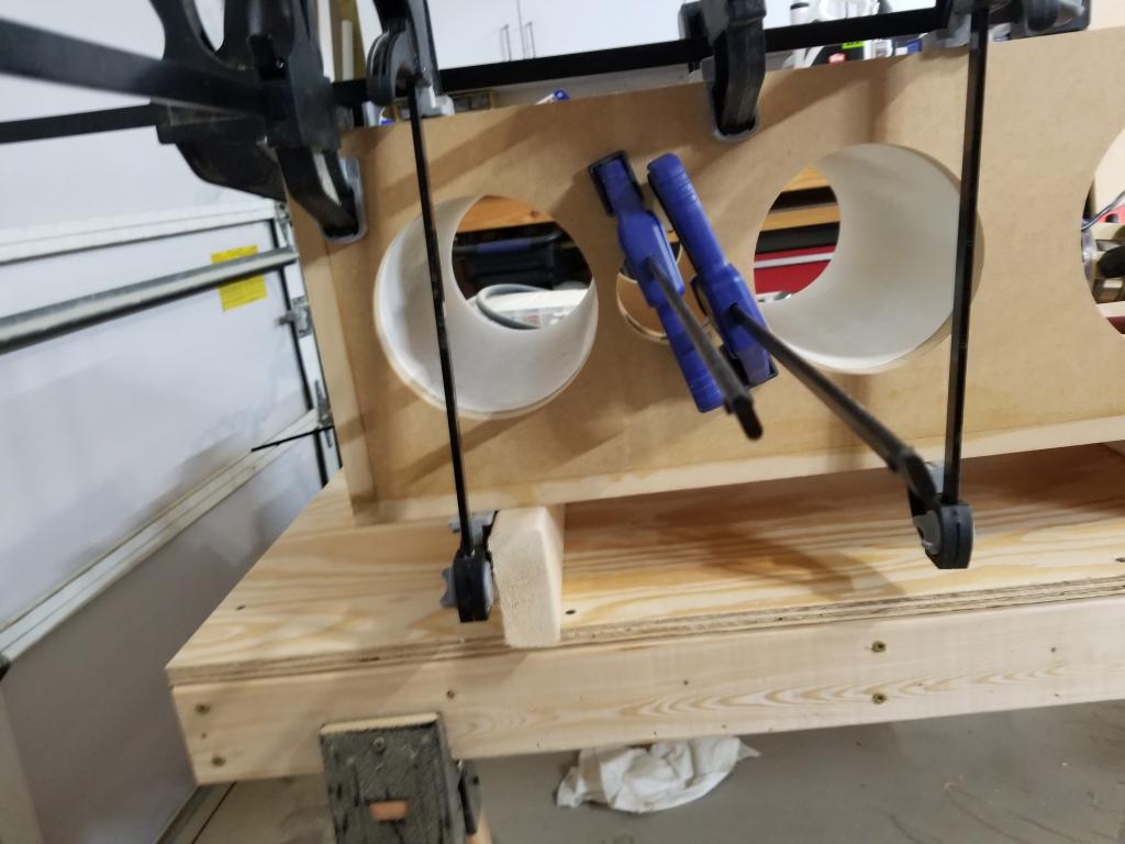

                      Question, I forgot to bevel the woofer holes on the inside baffle. Is there a difference or is this needed?
                        It does prevent tunneling. Can you bevel it in any way from the inside of the cabinet?
                        • rick844
                          • Jun 2019
                          • 232
                          I'm sure I can find a way. I have a dremel so worst case I can use that. Thanks for getting back to me. I'll start working on a solution.

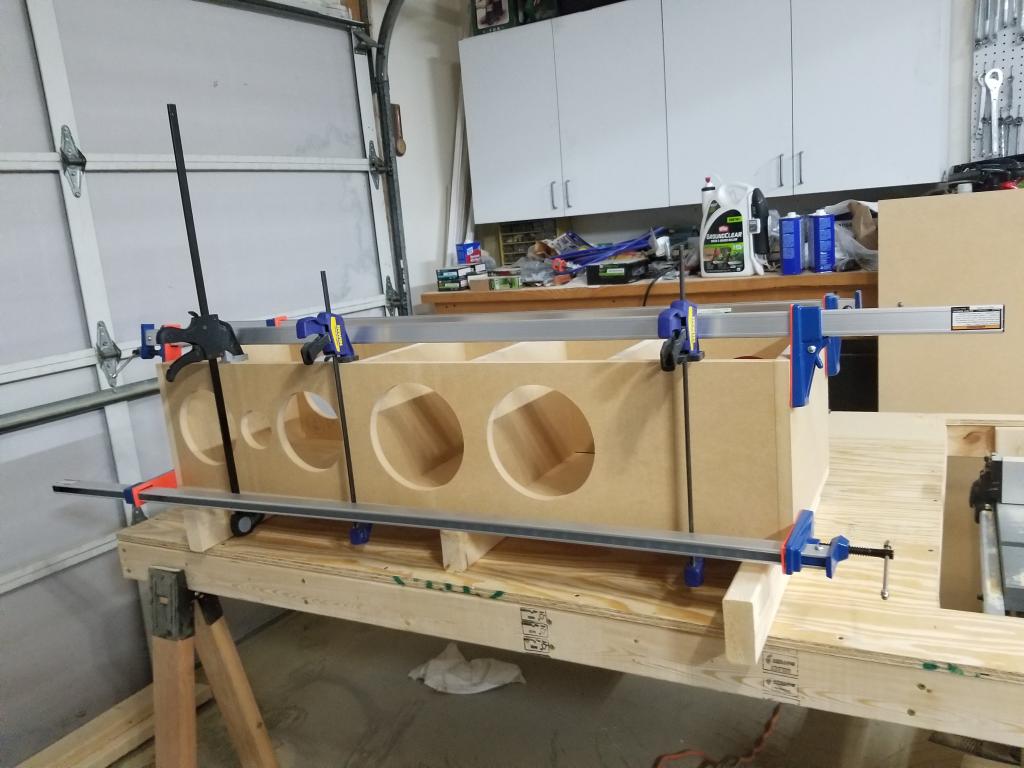

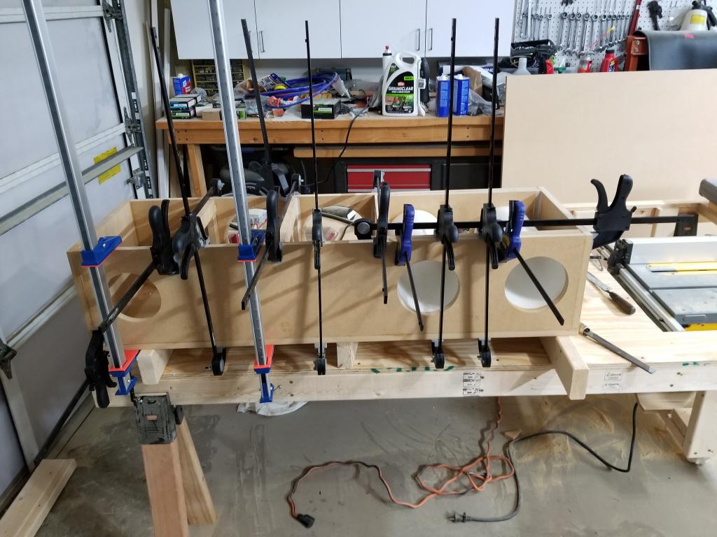

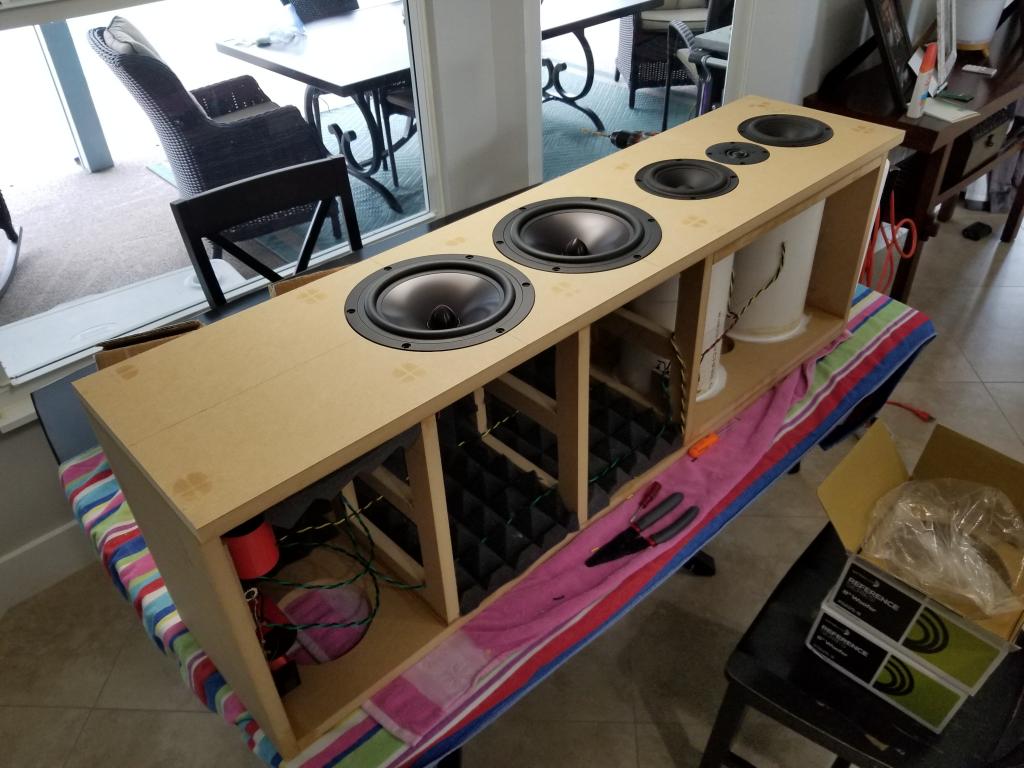

                            Making progress
                            • rick844
                              • Jun 2019
                              • 232

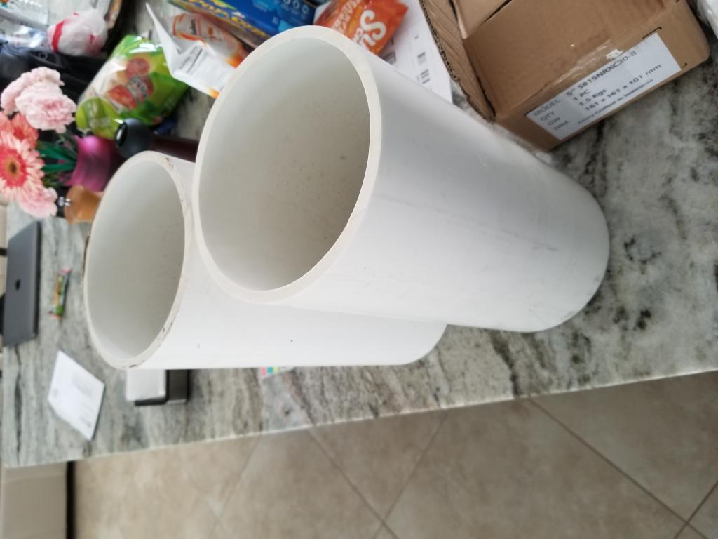

                              I glued the front tube support and the tube ends on the front side first. I plan to then glue the back panel, then slide the rear tube support in and glue that. Only way I could figure I could get the most square and solid alignment. If I glued the tubes first, it may not have been square so this way i figured it would be true to form and solidly glued to both the front and back panels.
                              • rick844
                                • Jun 2019
                                • 232

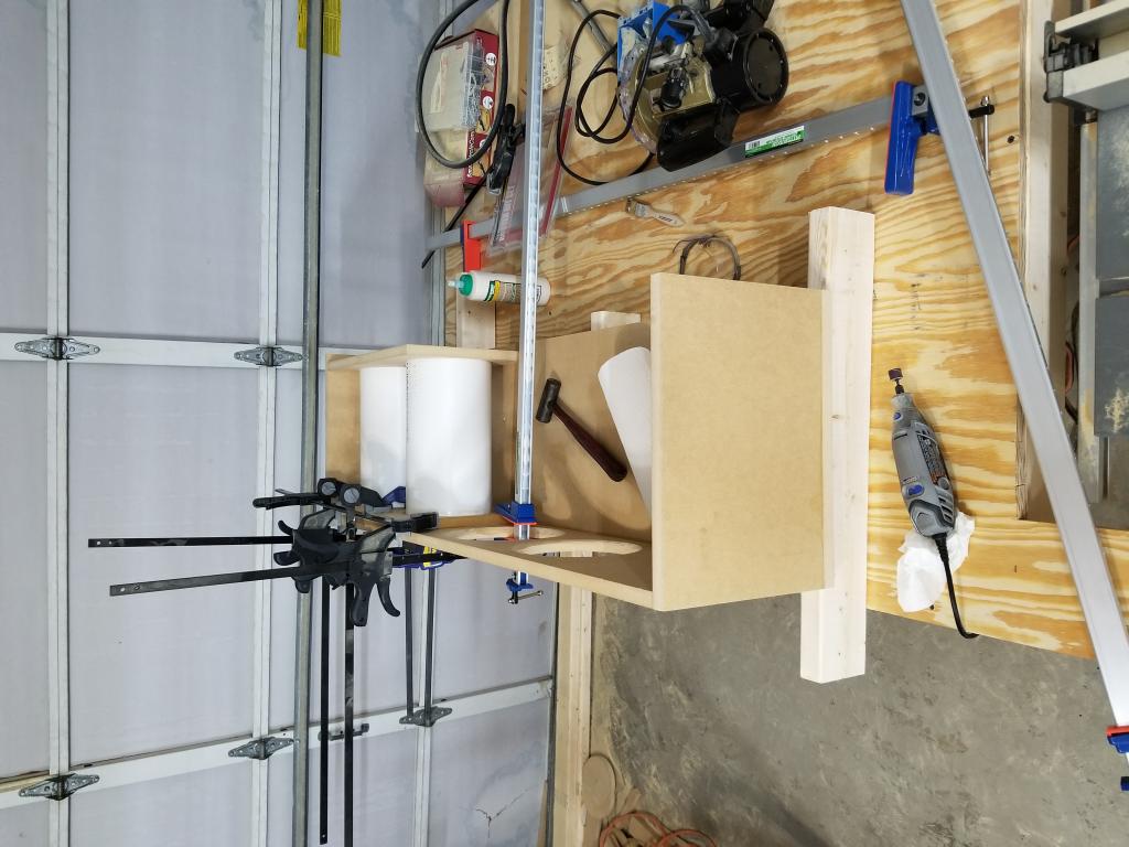

                                Bevel by hand worked out. Definitely won't forget on the 2nd one.

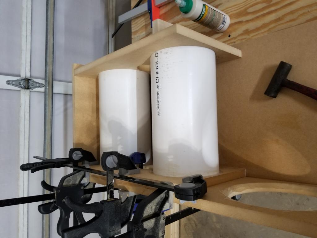

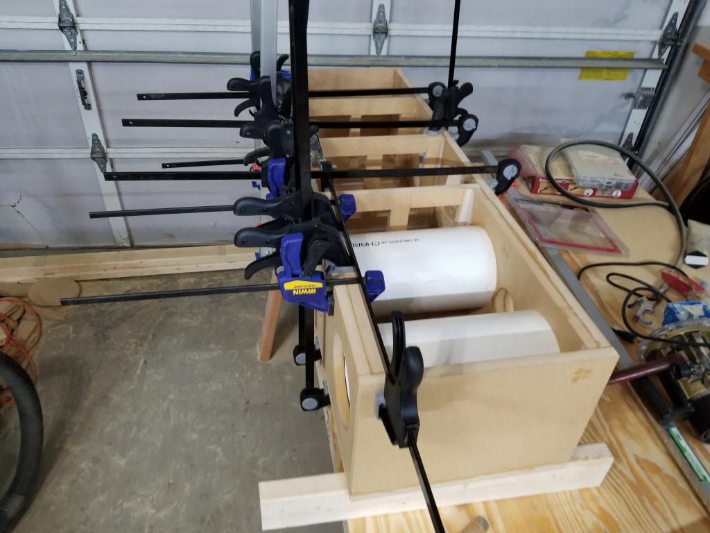

                                            Sorry, one more question. The PVC and port tubes, do they need to be sealed to the enclosure? I glued the PVC mid tubes to the support to ensure no rattles, but need to know if I need to fill any voids with caulk or glue. Thanks in advance
                                            • rick844
                                              • Jun 2019
                                              • 232
                                              Got clamps? Lol.

                                                Well, got one wired up and tested. I still have to glue one side on but I wanted to hear it to make sure I didn't goof. Needless to say, very little bass as the side was off but the mids and highs already dwarf that of my old Polk. Just so much more presence. Cant wait to glue the side on and put in the port to test it for real.

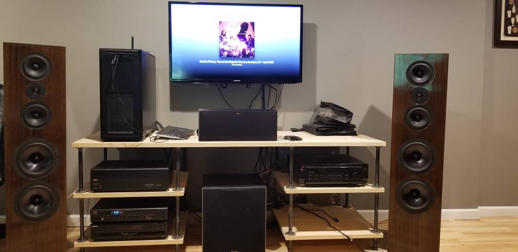

                                                  Side panel is glued. Simply stellar bass and clarity. Makes my polks sound like Walmart Sony speakers. Crazy the difference. Need to get the second one done. Wife isnt too pleased with the size, but oh well. Lol
                                                  • rick844
                                                    • Jun 2019
                                                    • 232
                                                    Oh wow. Just watched a movie. Crazy clarity, and bass. For those of you on the fence, build these towers. Jim, you guys nailed it with these anthologys. Best towers I have ever heard.
                                                    • rick844
                                                      • Jun 2019
                                                      • 232
                                                      Only one tower done and I can tell a huge difference.
                                                        Thanks for the kind words. Curt is the reason all of our collaborations sound so good. He's the brains, I just do the heavy lifting. I'm looking forward to hearing your feedback after both speakers are completed and you have about 20 hours on them. Break in does help.

                                                          Will do. I'm sure they will be amazing. I'm hoping to wrap up the second one this week. Should go faster as now I know the little tricks and steps to get where I'm going.
                                                          • flamethrower1
                                                            • 392
                                                            Nice build, have been enjoying mine for quite some time with no regrets or upgradeitus

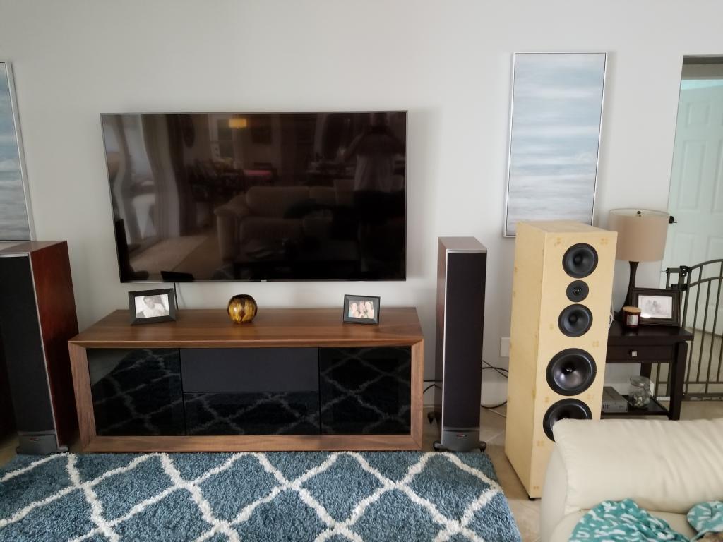

                                                              Looking good! Make sure to play with distance from the wall! IIRC, Mr Holtz recommends 16"-24" or that neighborhood. It really does have an affect including bass response. What do you have powering them? I found that my older HT receiver couldn't do them justice, so i went with some Adcom separates for some better power. I'm with everyone else, i have no desire to upgrade. Click image for larger version

                                                                I can't really push mine that far off the wall, so they will stand at 14 inches away from the wall. I have no doubt this will provide everything I was looking for. As for the amp, I am using an Outlaw M5000 which is ~140 WPC at 6 ohms (all channels driven). Great amp by the way. The distortion I was getting from the Polks was unnoticed until I played the Anthology at the same time on the right channel with the Polk on the left. To be fair to the Polks they are 14 years old, but some of it is just in the build I think. Nuts.

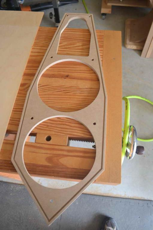

                                                                            Thanks, yes I want to do that. Do you just glue the MDF or drill and screw it together?
                                                                              • 2142

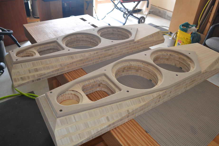

                                                                              The baffle would be one solid piece. Here is one I did for a forum member for a set of Ardent baffles. No need for glue or screws.
