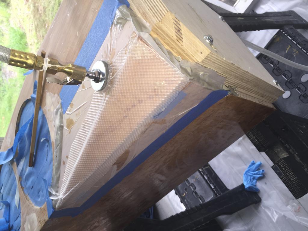

          The smooth surface worked - I can get 20" of vacuum on the bag using 2" blue tape on the already veneered surface. Using the mastic on the baffle face since there's not enough width to get a good seal. Top and bottom facets going simultaneously. As warm as it's going to be I should have the veneer applied by Friday.
          Here's the setup
            • 2135

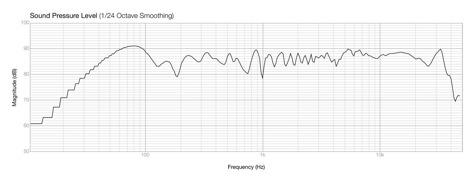

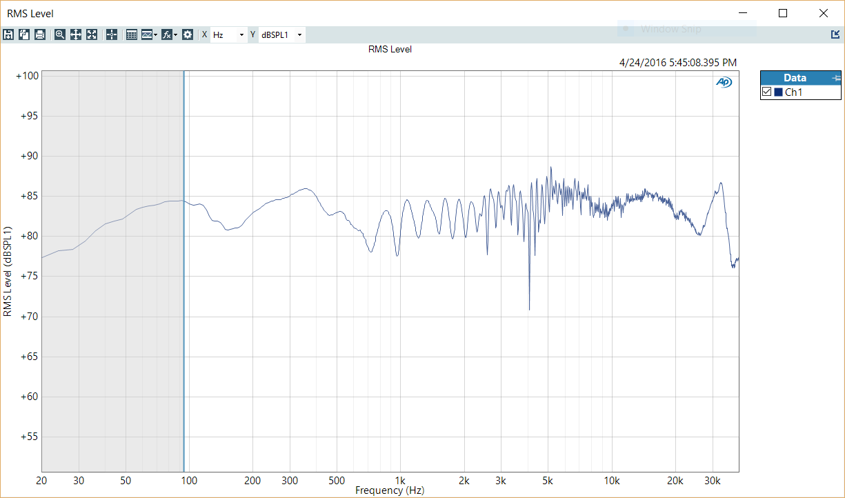

                                    OK, just a measurements to post before finishing cleaning up-
                                    These two are the closest to good correlation, though both the cabinet and microphone were moved a bit (to do the work on the crossover in the cabinet base) so LF correlation is not an issue= I was more interested in 400Hz and up anyway.
                                    AudioPrecision, no smoothing, short gate
                                    Fuzz measure, no smoothing, also a short gate, but not exactly the same

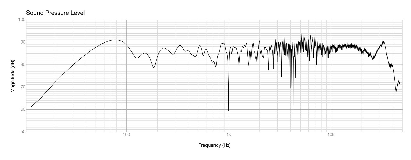

                                    Just for fun, another FM with more conventional smoothing, at 1/24 octave.
                                    I'm seeing some trends here that I think I want to address, as regards midrange to upper end balance. Should be straight forward, but to be "rigorous" I'd like to go back and re-do the individual driver measurements, setup in VituixCAD, and see how it shakes out in that before tweaking any parts.
                                    Stay tuned.... it's the Ardent Channel!

                                          Well, this is frustrating. Pulled the bag off to find the veneer had slipped on both facets. The lower left a huge gap, could not be salvaged. The upper was ok except for an inch or so with a barely noticeable from 6" away gap. That was until I tried to trim the overhanging edge. Wild grain means wild internal stresses and a huge chip came out. Ok, both facets have to come off. Set my plane to barely take a solid shaving and still managed to take chunks out of the LBL. Now I have to fill that.
                                          Lesson here: position the speaker so that gravity will pull in a direction to make an overlap with the previously veneered surface.
                                          So going to do facets on the other speaker, and mix plenty of fine sawdust into the leftover epoxy to make a filler. That will also be used to glue the grill magnets in place. Guess I won't quite be ready to finish sand when I get home.

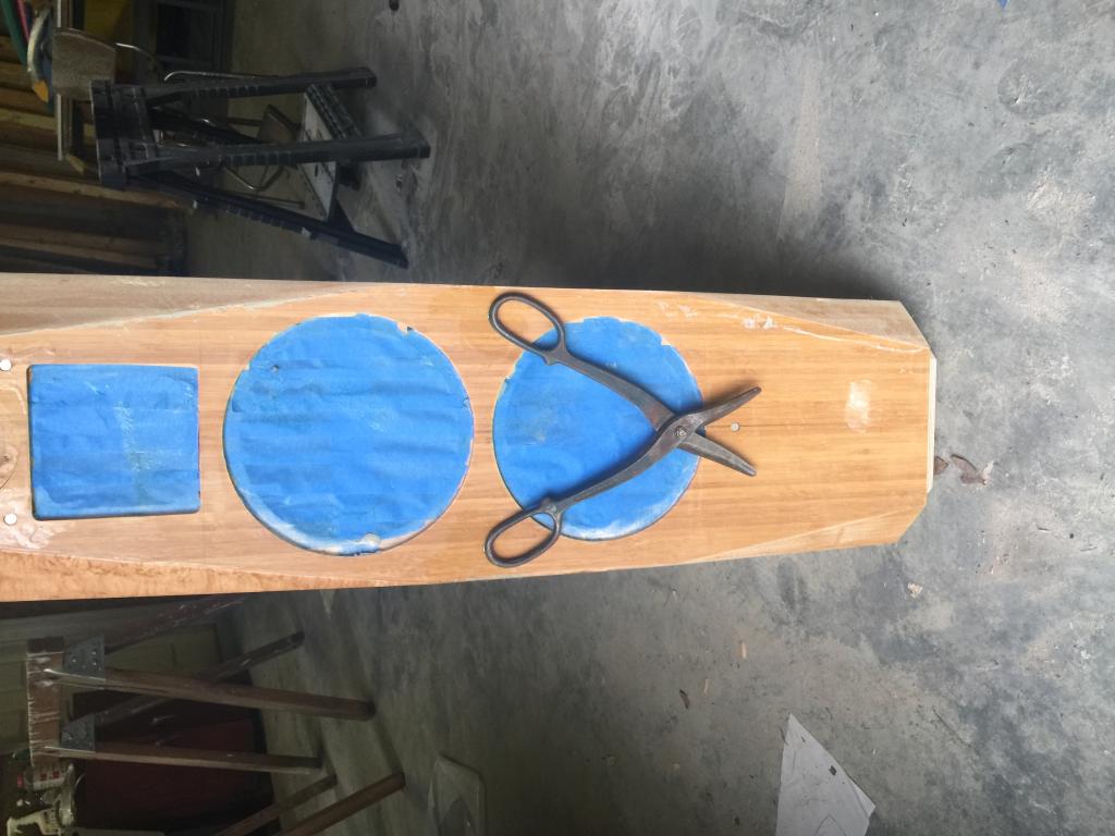

                                                                    Travel has ended, to my granddaughter's chagrin. The good news is I'm back at the Ardents. I should be able to get the large facets veneered before having to return to civilization Tuesday. I hope to be spraying the first weekend in June.
                                                                    Glad to get back to it, but the clatter of the vacuum pump is spoiling the quiet. Last night as our steaks hit the grill I heard the cows 3/4 of a mile away start mooing. Their attempt at a guilt trip didn't work.
                                                                    Proof of progress picture.

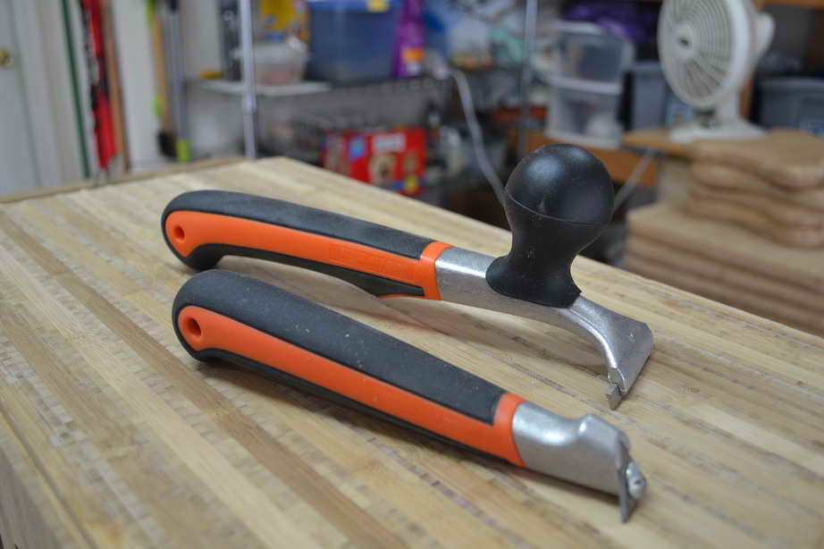

                                                                        Rediscovered the power of the scraper this morning. Well, at least using an old metal outlet cover as a scraper. Forgot the putty knife I'd been using to remove the mastic, and being an old house I found a stack of outlet covers that had not been well de-burred. Worked like a champ removing the mastic and cleaned up some epoxy drips in the process. It even did as well as my block plane trimming the facet veneer. Had I sharpened it a bit I bet I would be able to use the edge as is. Stiffer than a normal scraper I was more confident at the edges.
                                                                        Cabinet scrapers, we should all have and use them.
                                                                          • 2135
                                                                          #261
                                                                          +1 on that Bob ...... I've also found these to be super useful as well. They have carbide blades so they keep an edge a lot longer than a standard scraper does. Either way, I've been using scrapers a lot on my project.

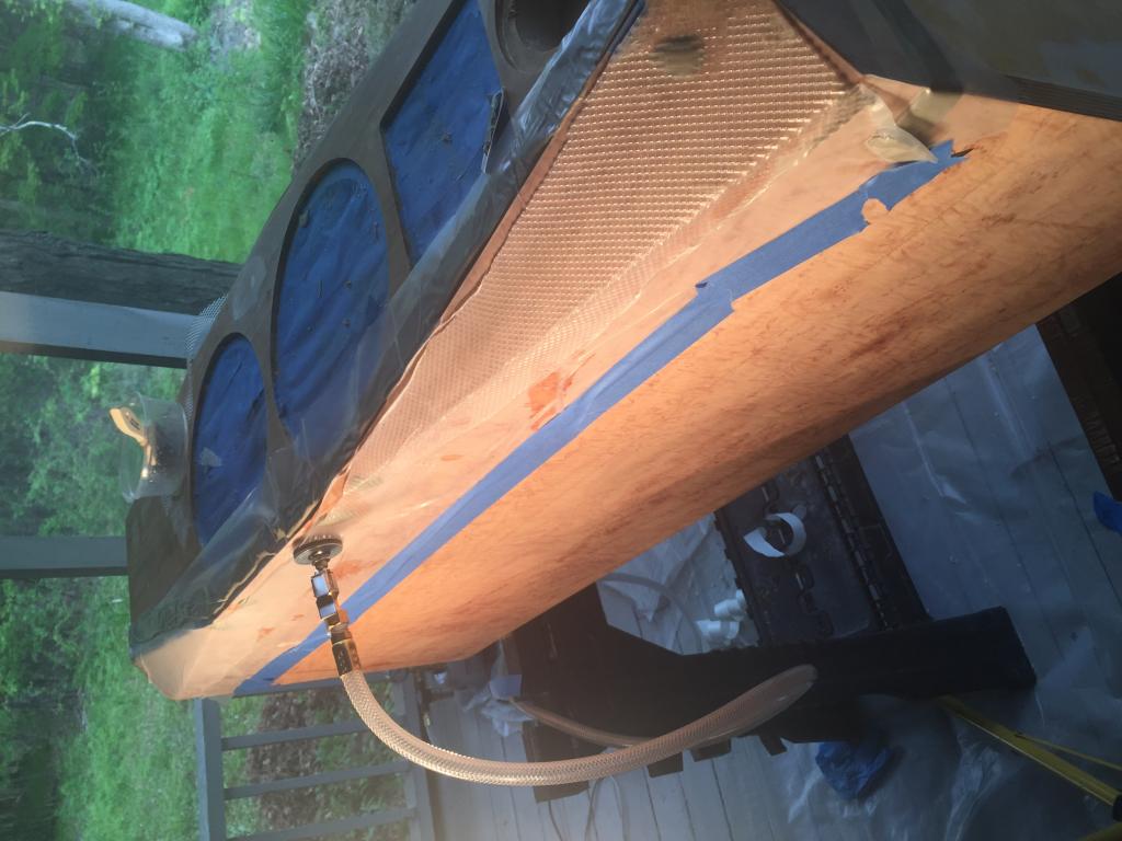

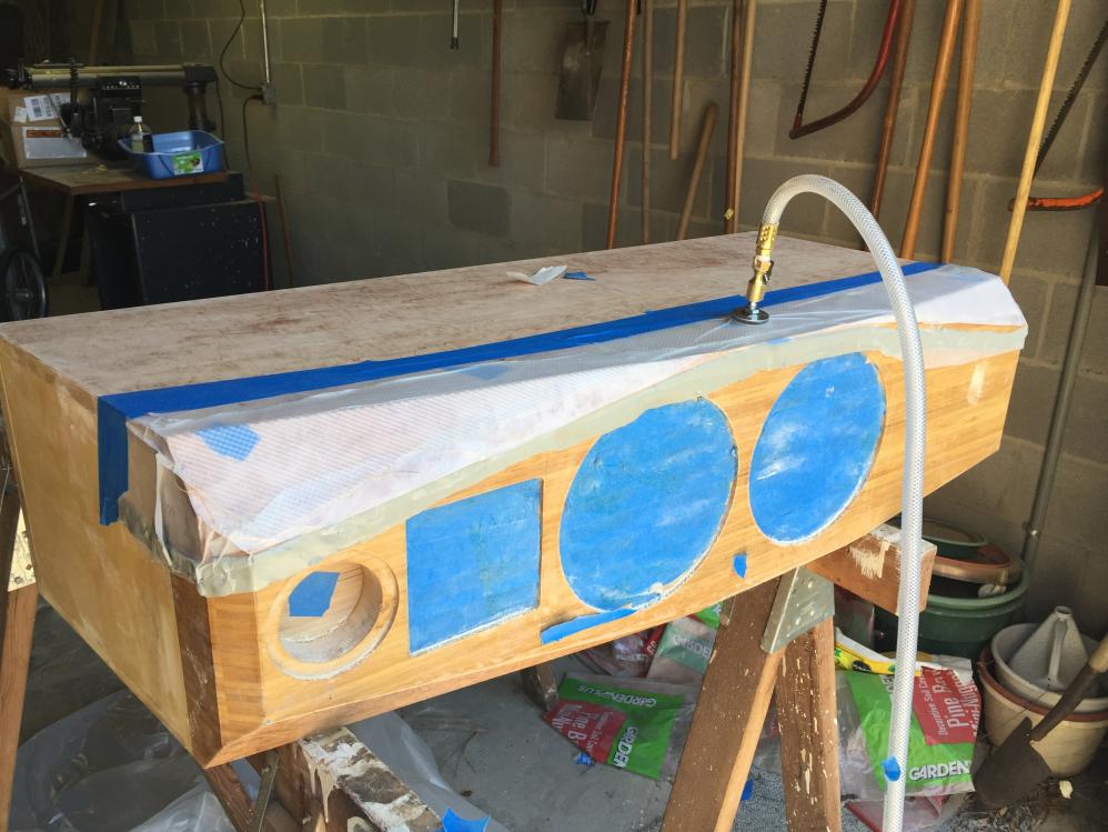

                                                                            Another proof of work shot. It's turning out a little cooler than forecast so 2 500W halogen bulbs are creating a little extra warmth. This is the last of the large facets on the first cabinet. The other has one pair of large facets complete.
                                                                            Mastic on the narrow surfaces, with a couple inches of smooth surface to seal against blue tape does the trick. Once under vacuum the blue tape isn't needed. I'm using 3.5 mil vinyl sheet instead of the 30 mil Joe Woodworker sells. I bought the thick stuff, but it seemed like it would be difficult to seal on these tight corners. I can get a couple uses out of the thin stuff, and it's cheap enough that I don't care if it gets torn. I'll use the thick stuff for larger surfaces.

                                                                                Quite a bit of craftsmanship and thought to make that process work, but you're definitely moving the ball down the field. :T

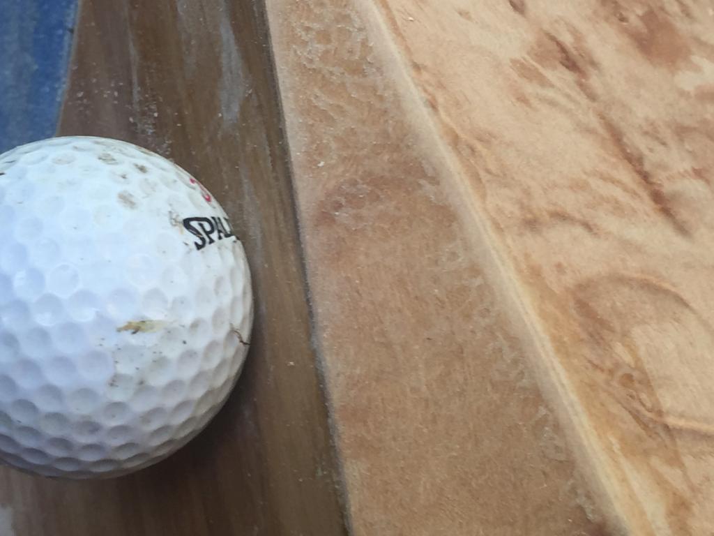

                                                                                  And Jon has a new favorite phrase.
                                                                                  The seam is pretty tight. I still need to sand the surfaces for finish, but I suspect it will almost disappear.
