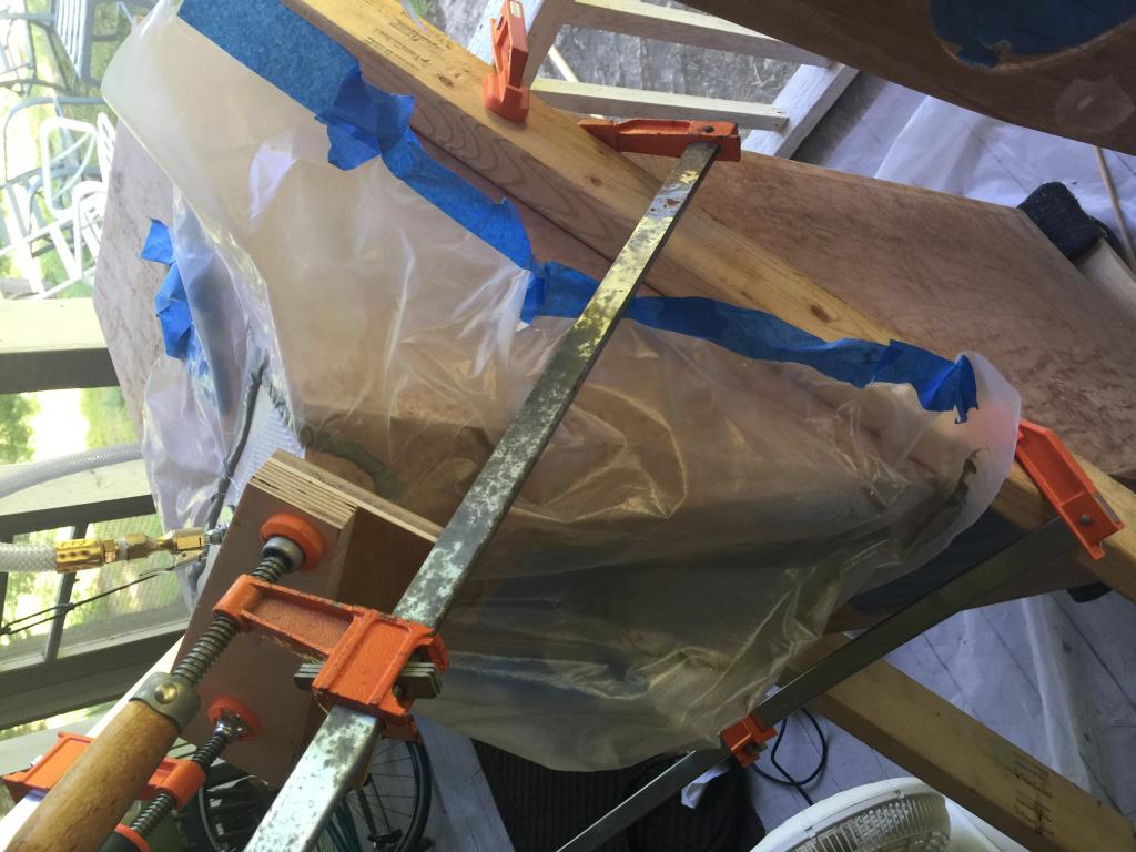

            Back at it. Veneering a top. The grain is so wild that epoxy is flowing up through the veneer, which punctured the release sheet so epoxy is in the breather mesh. Oh well, guess that's why the call it a consumable item.
            Mastic on the front and in the folds of the plastic sheet, 3M blue tape (the other stuff doesn't hold well enough) on three sides and I was able to get 25" of vacuum. Bleeding down to 20". The weather went from really to cold for epoxy to glad I got the slow hardener in a week.
            Why does the forum turn my portrait pictures to landscape?

              #276
              Happens only very intermittently to me- what do you take the pictures with?
                #277
                These are iPhone shots.

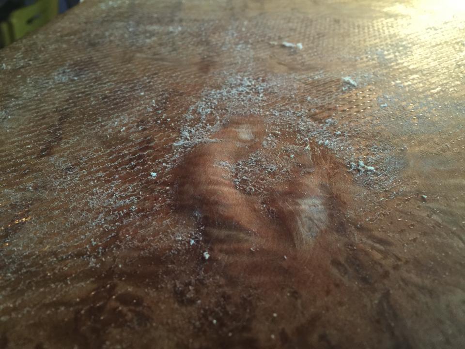

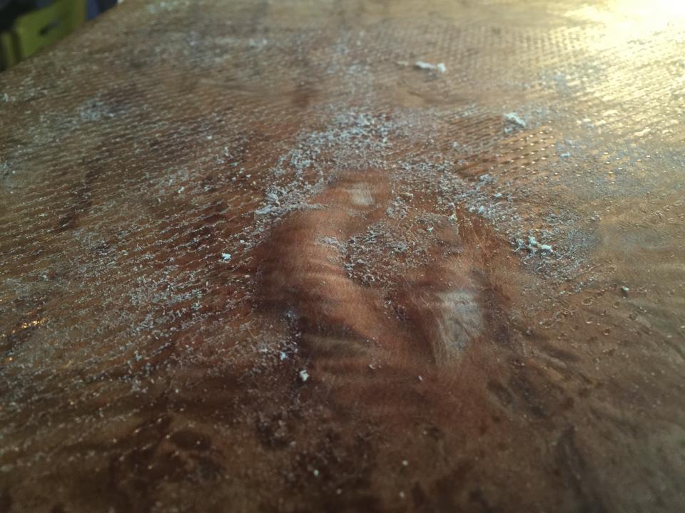

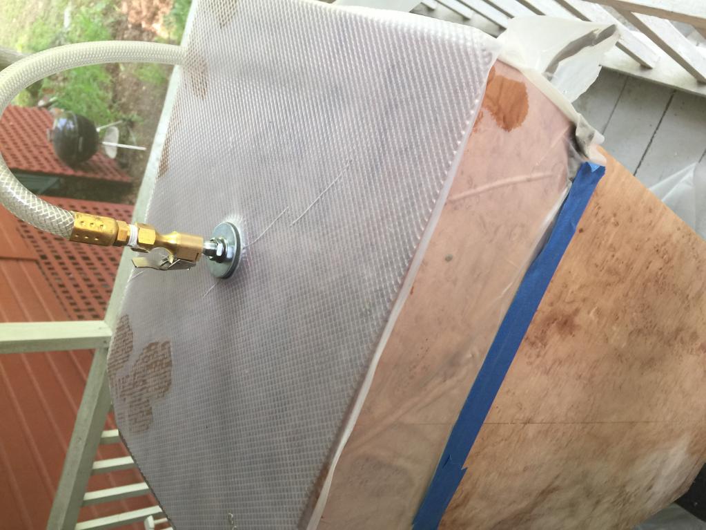

                  Another lesson learned.
                  I'd noticed on Joe Woodworker's site a mention of putting the vacuum port off of the work surface when using the breather mesh instead of a caul. I'd had no issues with the facets I'd glued with the port right on the face. Yesterday, however, veneering the top some spots around the port did not adhere. I'm using the less expensive port which does not have a flush bottom. So, plenty of pressure at the center and a ring of no pressure surrounding it. Why a problem this time and not others? I think it has to do with temperature. When gluing the facets, the resin was chilled to around 50F overnight and was quite thick and tacky when applied. Yesterday was well into the 70s when applying the resin, so it was much thinner and not as tacky initially. So a confluence of watery epoxy and wild grain that wasn't terribly flat despite softening and I get to learn how to repair bubbles.
                  If you're using JWW's lower cost vacuum port either place it off of the veneered surface with a strip of mesh or use cauls. He has a flush port, but it must be glued onto the bag rather than clamped on. That wouldn't work as well with my new "bag" for each piece of veneer method.
                    • 2135

                    Ouch ...... That bites the big one Bob. Though I'm betting you will get it fixed and not even see it.
                      #280
                      Still waiting for Ron's how to fix a bubble instructions.
                        • 2135
                        #281
                        I've had mixed results fixing bubbles, especially since you having used epoxy, you can't throw an iron on it and reactivate the glue. I'm interested in what you come up with.

                          #282
                          Bob,
                          Bummer man, very sorry to hear / see your bubble trouble.
                          I was going to write up a short presentation on how to repair bubbles the correct way, but I didn't get the expected bubble in my last large sheet of veneer, so nothing to repair.
                          I'll write up a separate thread on how to repair bubbles this morning.
                          In the mean time, go find a #22 or smaller needle & syringe. I get mine used from "downtown" there all over the sidewalks in Sacramento. JK. (kinda)
                          You'll also need a heat gun / hair dryer, tiny bit of distilled water, and adhesive of your choice (aliphatic (white) glue may not adhere well to epoxy), sm. flat sheet goods (MDF, plywood, straight board) and a heavy weight (car battery) or cauls and platens if feasible. Parchment paper if available (not necessary)
                          I was able to score quite a few different size needles from an in-law in the medical profession, all the way down to insulin size (which is really too small).
                          I'll post a link here to the new thread when it's done.
                          Ron

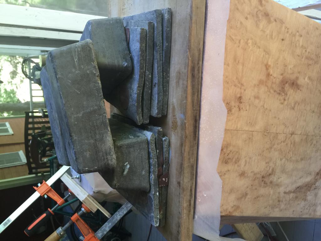

                                                    Finally the weather returned to reasonable temperatures and I'm able to get going again. Tries Ron's 80 grit on a piece of plywood method of flattening the top facet. Worked great except for nicking a corner and rounding it over. Would have been ally of sanding to fix, so I set up the vacuum rig. Veneer wrapped perfectly along the rounded edge until... Power outage. No power, no vacuum. My band clamps are 2 hours away. So I came up with this, hoping the bag and breather would provide some flexibility to get that round over wrapped.
                                                    Also used as much of Ron's veneer patching advise as possible. Epoxy bubbles aren't going to get wet. I used a heating pad with my caul on top to warm the veneer. It was much more flexible and the bubble seemed to want to be flat. Clamping by lead weights.

                                                    About half an hour after going out the power returned. Back under vacuum with clamps as a backup.

                                                            Thanks, Steve. I have hope for the bubble repair seeing how flat it got under the heating pad.

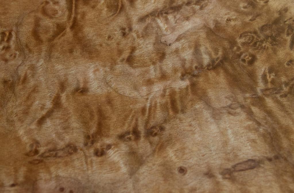

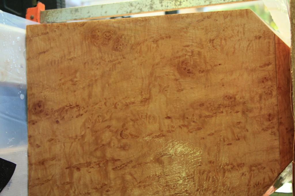

                                                                      Here it is - from a foot away I can't see the slice, but it is visible if you look hard enough. The radius pg the curved section is about 1 cm Brushed on a little GF to add contrast, and I couldn't wait to preview the finished look.
Name:	veneer repair.jpg
                                                                      As a reminder, it looked like this:

                                                                        Very nice fix Bob :T

                                                                            Thanks, Steve.
                                                                            And thanks to Ron for his admonition against vertical razor blade cuts.
