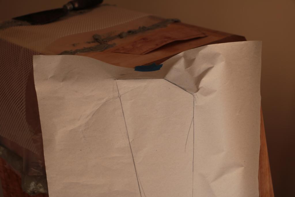

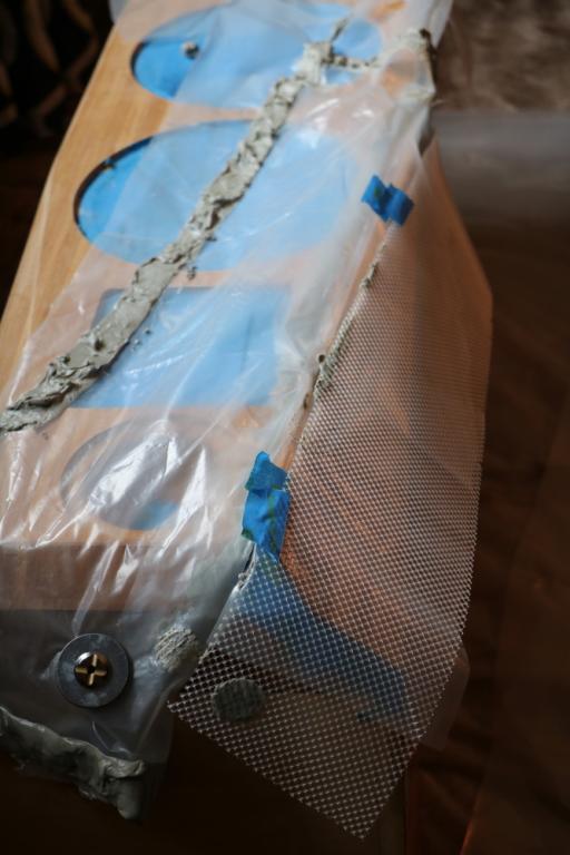

                    Finally a bit more progress. After trial runs, I decided two facets at a time were too likely to slip out of place, so it's one at a time.
                    First, I made a template to cut the facet out of the side veneer off cut. Who knew grave rubbing skills would come in handy? I cut out and traced this pattern onto the veneer. It gave me a piece that was about 1/16" oversize.

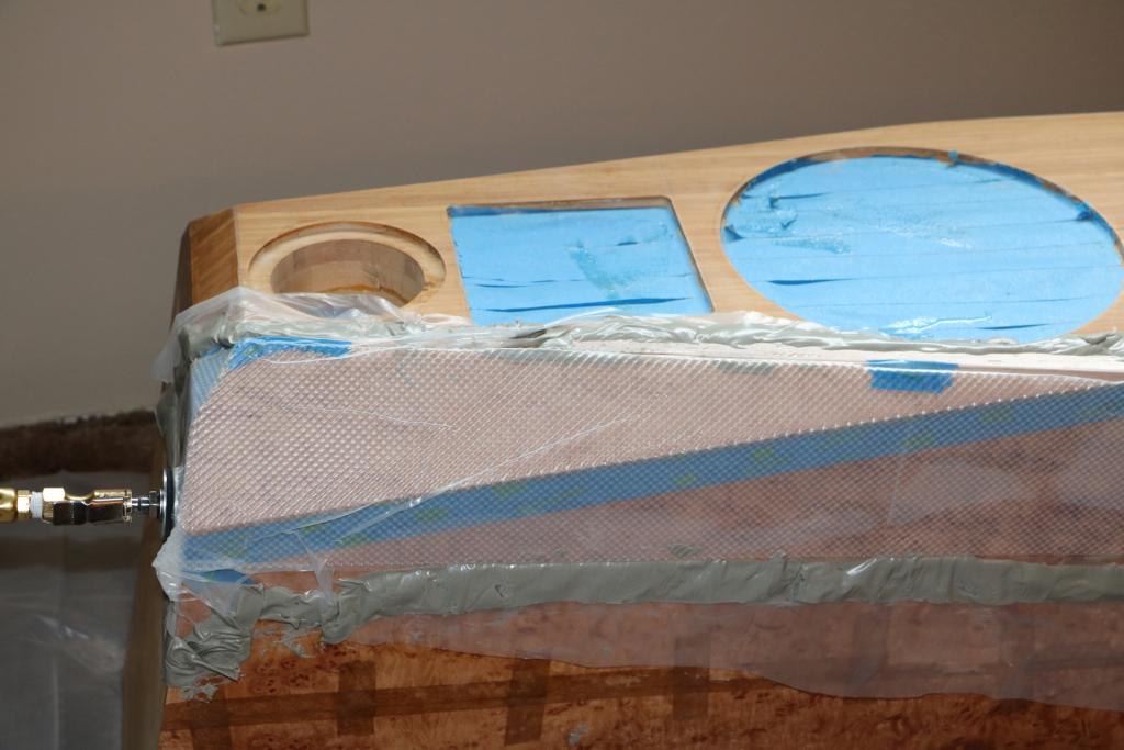

                    Prepping the bag. All laid out, a sheet of plastic under the breather mesh to keep the epoxy bleed through from sticking. I folded it back, wet both surfaces then flipped the whole mess down.
                    Here we are under vacuum. Running at 23" at the pump. It took a bit of mashing on the mastic to get the bag sealed reasonably well. I can still hear a little hiss, but overall it's sealing well. The veneer slipped, but pulling the vacuum fitting off of the bag allowed repositioning. The 1/32" free edge doesn't create enough of a lever to crack the veneer. I'll keep it under vacuum for 12 hours then let it continue to cure until tomorrow when I will trim it.
                    Yes, that is the living room, since it's too cold outside to cure the epoxy in a reasonable time. The pump is outside. Very understanding lady of the house is eager to hear them, too. I think I may miss my 12/31 target for listening, but not by much.

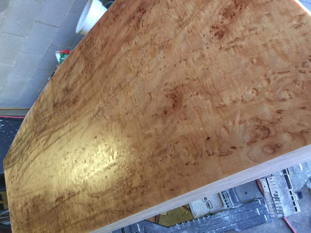

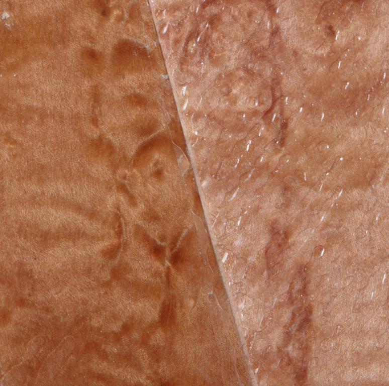

                              I'm happy with the seam, but not so happy with how much the mastic stuck to the surface. Leaving it on 20 hours made it a lot harder to remove than my ten minute test showed. I'm going to investigate using closed cell foam weather strip to seal the bag. It should be fairly easy to clamp over the seal on the already veneered sides and maybe use the mastic on the top.
                              Here is a close up of the joint. The edge has been rough trimmed and the end grain disappears when wet. Note the waffle pattern in the epoxy caused by the breather mesh. It should sand off easily. The veneer on the two faces is from the same sheet. There's just a bit more light on the facet on the right.

                                #195
                                Great joint, and I hope you smiled after seeing the result.:T
                                It gives you an idea of what Avalon has to produce over and over again in order to make money. These little details others won't notice or care a bought but it sure makes me happy when I consider the effort, planning and scheming that went into it!
                                  #196
                                  Thanks, dar. Yes, there was a big smile even before trimming.
                                  There was only 1/32" or so of overhang on this side. The other side was a bit more, maybe 1/16". That was enough to bend the veneer slightly, but not enough to break it over the edge. That should help give me a bit more to soften the edge before finishing.
                                  Letting the putty harden on exposure to air is making it easier to remove. It will take a few iterations, but a metal putty knife is getting a lot of it fairly quickly after all. Still going to look into altenatives, though.

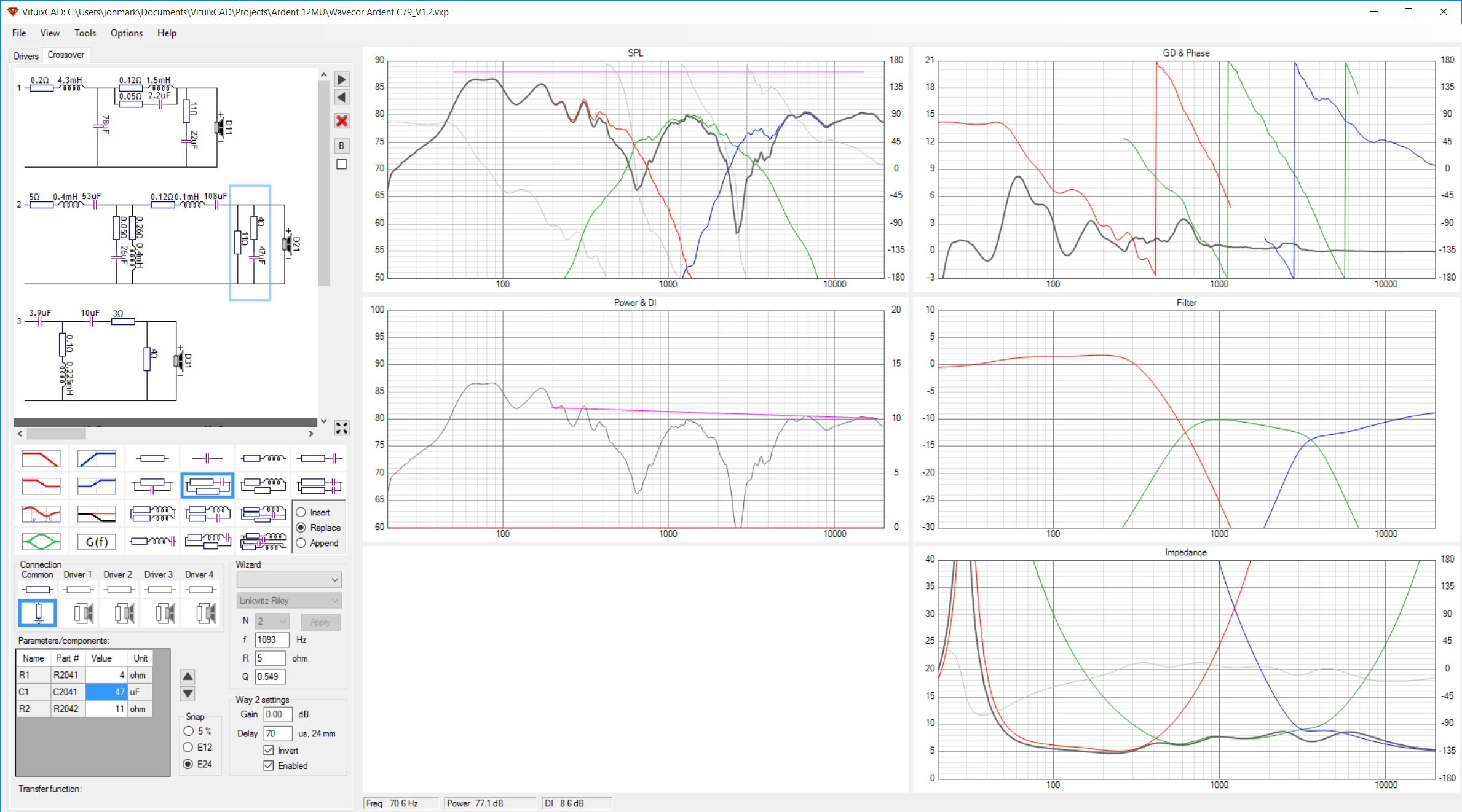

                                                          Looks like I will get to do some veneering tomorrow and Thursday. Here's hoping that the weather guessers aren't too far off.

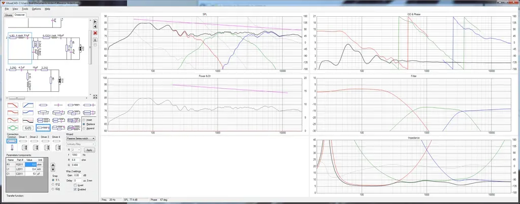

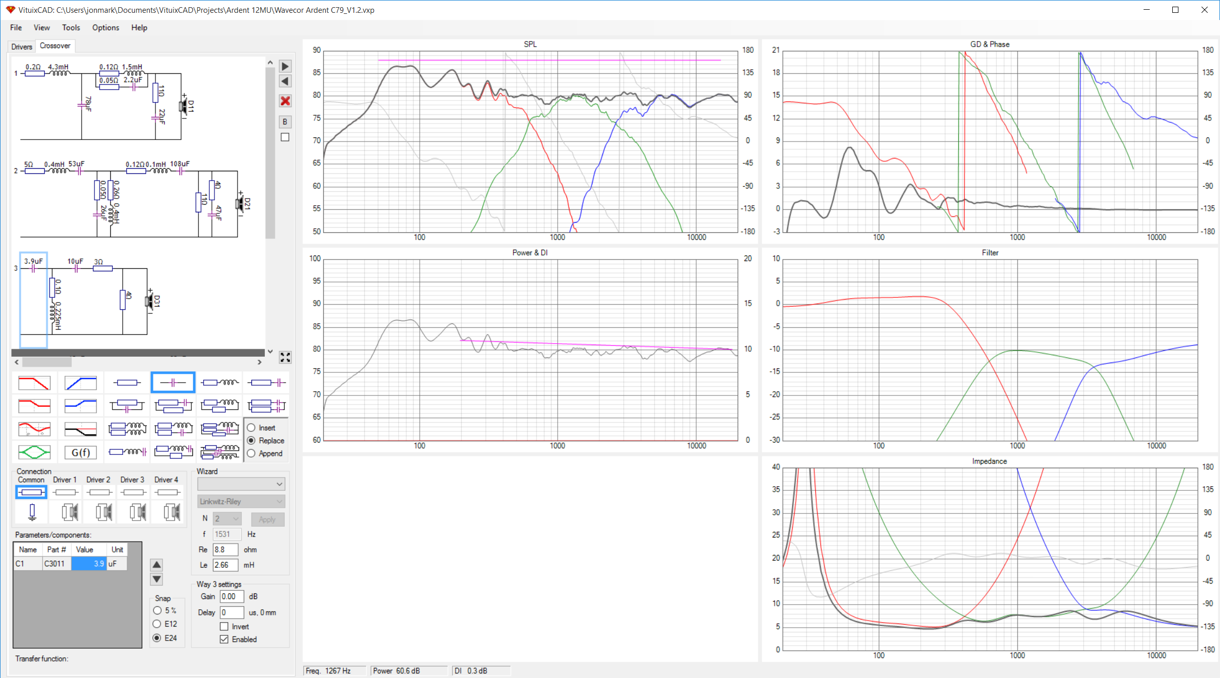

                                                          In the meantime, Jon was kind enough to share the Vituix Cad files he generated for Ron's build. I swapped the C79 back in and scaled the response down 2 dB to represent my SW223BD02s. This will do until I can get actual measurements. Using that I played around with changing the midrange and tweeter padding resistors to match the reduced woofer sensitivity. I was surprised how much the resistor values interacted with the response.
                                                          In the tweeter section swapping the two resistors gives the right attenuation, but the hump from 4500-7500 Hz gets about 1.5 dB bigger. A 2R3 resistor in series seems to be the best way to reduce the level without significantly impacting the response.
                                                          Not balancing the changes in the midrange section throws off all sorts of things. There is a bit of baffle step kicking in which increasing just the series resistance reduces, making for a big dip in response and reducing the reverse null.
                                                          Overall, several combinations produced flatter upper end response, but were either too attenuated, had bad phase match or required resistor values not available from Madisound in M-Resist. The response below represents the best I think I can do with standard resistor values. I think it matches Jon's original pretty closely just 2 dB down. I plan to buy inexpensive resistors to verify values before committing to the Mundorfs. Comments, suggestions welcome.

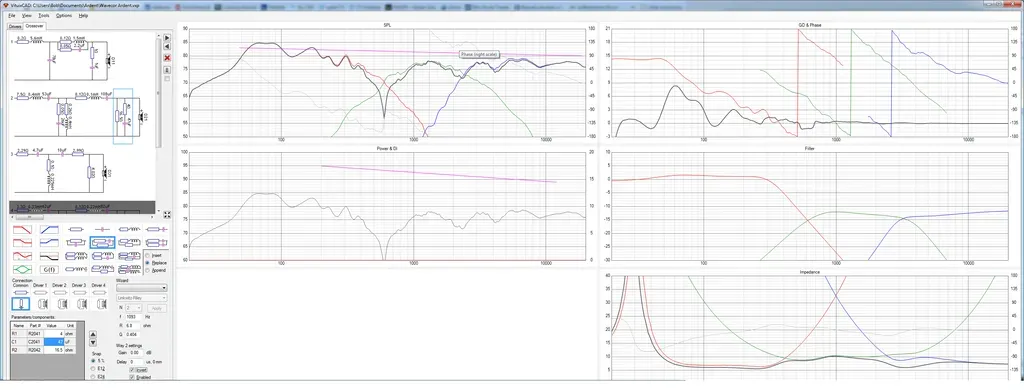

                                                          Response:
Name:	Ardent XO SW223BD02_zpsioqyi8xy.webp

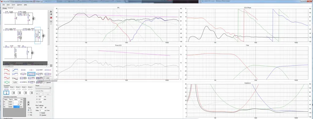

                                                          Midrange reversed: The original doesn't have much of a null in the upper crossover. This is almost as much.
Name:	Ardent XO inverted_zpszjob9vqm.webp

                                                              Slight revision - I noticed that the model didn't have the values in for the woofer zoebel. Makes a slight change in woofer response. This revised version matches the correctly simulated Ardent quite closely.
Name:	Ardent XO SW223BD02 rev 1_zpsy2xnouvy.webp
                                                              Last edited by theSven; 30 April 2023, 15:53 Sunday. Reason: Update image location

                                                                I just spotted that, too. . Also, the LspCAD version shows a deep reverse null on the midrange to tweeter, so that bears some investigation, though with surgery today, and a work conference call coming up in minutes, it won't' likely happen until closer to the weekend. Hang tight...

                                                                  I find VituixCAD very interesting, but it takes some care to transfer data and networks accurately, and I'm also pretty convinced I need to do some more correlation testing between simulation and measurement; the last several tweaks for the Ardent were done just by measurement, though I did go back and update the schematics.
                                                                  Now, I've updated the C79 schematic (and the 12MU, but that's for another thread) and put in the driver offset estimates- here are both in phase, and reverse midrange. Note that I've "tweaked" the woofer L1 from 5.6 mH to 4.3 mH, and the C4 tweeter input cap form 4.7uF to 3.9. (these designators are from the "official" schematic, not the VituixCAD component designators. With driver time offsets entered, the reverse null behavior is as expected.
                                                                  Click image for larger version  Name:	26044276782_68460f0a58_o.png Views:	101 Size:	572.9 KB ID:	933694
                                                                  Click image for larger version  Name:	26110836226_2c2036e5ef_o.png Views:	94 Size:	595.5 KB ID:	933695
                                                                  My suggestion is that after I recover from my surgery today, I need to do some correlation testing with regards to these possible updates and versus VituixCAD. Since I'll also likely be switching over to my AudioPrecision analyzer for testing, there will be a lot to track. Probably should do measurements with Fuzzmeasure, too.
                                                                  For your situation, Bob, I think the right thing to do is model the woofer crossover with gain added, (possible in VituixCAD) and we'll work on bringing up the midrange and tweeter network sensitivity to the highest possible level to use with your other amps. Needless to say, don't buy crossover parts yet!

                                                                                          Back at it again, finally. Bagging the whole speaker doesn't work because I can't get the bag sealed fast enough. Back to taping a bag over sections. Started sanding the sides to get a better seal so maybe I can use blue tape or duct tape. Although the plywood end grain sealed in epoxy felt smooth after sanding I still got a bit of telegraphing. My girlfriend didn't notice until I pointed it out, so I'm not going to redo the veneer.
                                                                                          A quick wipe down with a damp rag and I'm excited to finish these.
