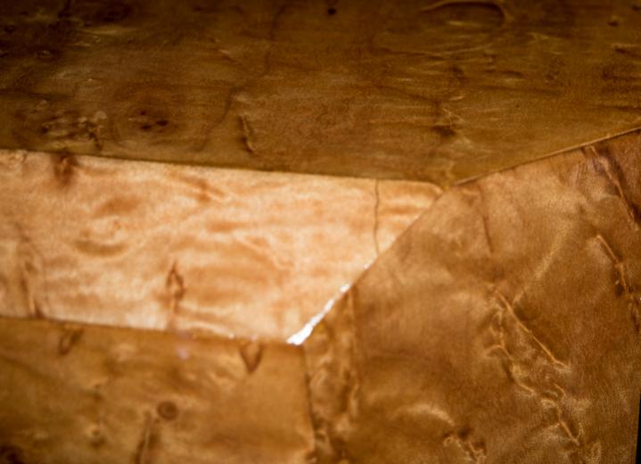

      This is as close to actual color as photos will let me make it.
      Since my sander has no dust collection I will keep the veneer over the driver holes until finished power sanding. Makes cleanup easier.
      Last edited by masterofnone; 30 June 2023, 16:38 Friday. Reason: Update image size

        Wow Bob, nice job, they look spectacular.
          #364
          Thanks.
            #365
            These will be very interesting to see after the final finishing work is complete. But these preliminary results are most impressive...

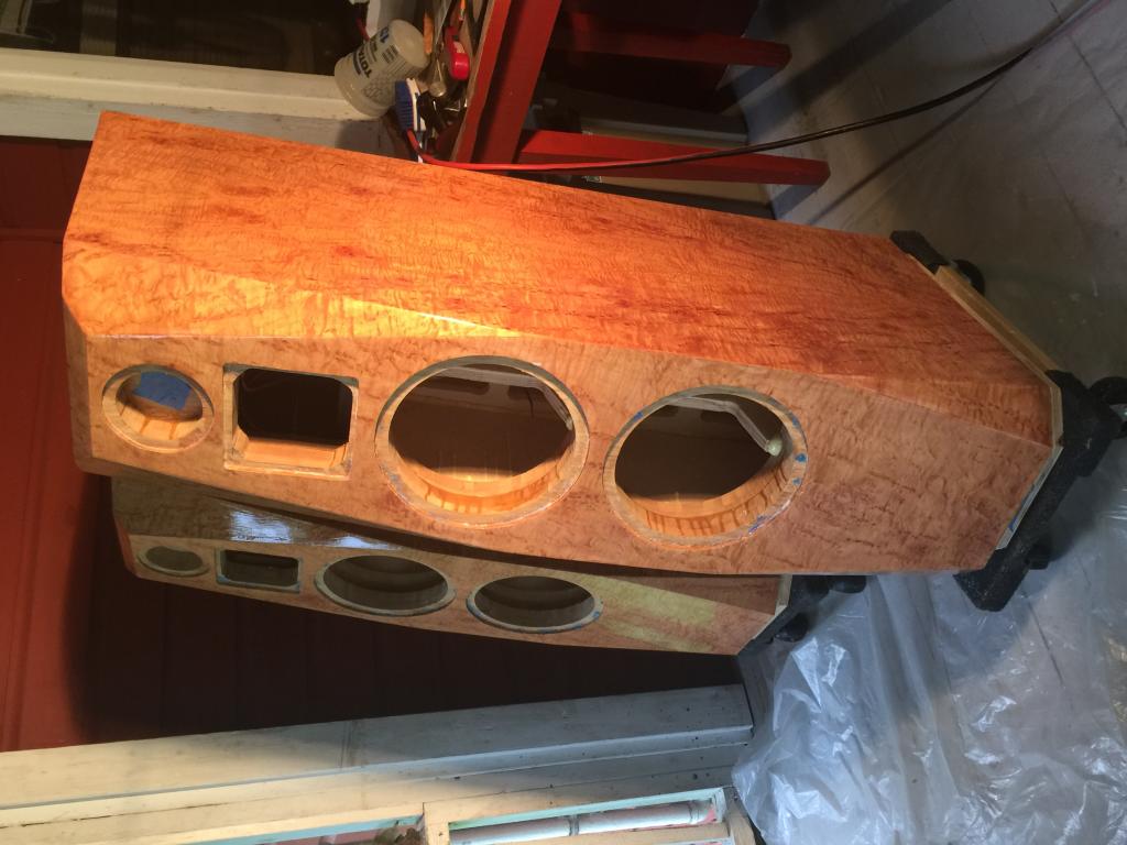

                                  Spot repairs completed, first coat of General Finishes High Performance Gloss brushed on. It levels itself quite well, although going over 220 grit sanding one coat is still satin. At 80°F and 70% humidity I should be able to get another coat on today. I plan to go with 4 coats, but will do more if needed.
                                  Was going to spray, but it's windy and my shady spot for spraying has too much stuff coming from the trees. After Ron's experience with veneer cracking I'm not taking a chance on a sunny spot. I know, I need an easy up tent, but that means a shopping trip.
                                  Teaser shot - almost shows how much the grain is popping.
Name:	Ardent first coat-3.jpg

                                    #377
                                    [ATTACH=CONFIG]26129[/ATTACH]
                                    Sounds like you have some of the soupy weather up the as well Bob ..... I was doing the tent thing for a while for spraying, I still had an issue with wind and since my gun is a bleeder I had to make sure not to point it at the grass or I made a heck of a mess of things. Looking forward to some more pics.
                                      #378
                                      Not quite as bad as you're getting, but it's also supposed to rain this afternoon.
                                      I'd planned to put a decent size drop cloth down to avoid blowing stuff around, but it's now moot.

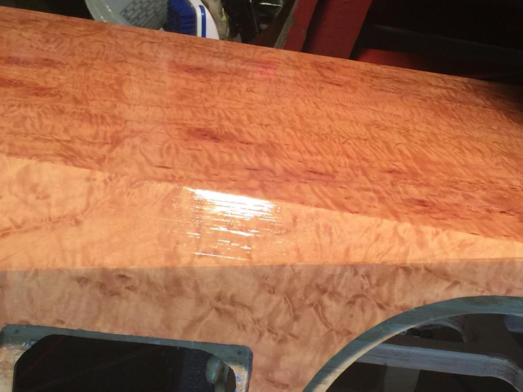

                                        Another coat on, starting to get glossy.
                                        The large facet is really starting to shimmer.
Name:	Ardent second coat-1.jpg

                                          #380
                                          Looking good Bob...I was also pleasantly surprised how well the GF HP brushed on.
                                            • 16072
                                            #381
                                            The GF HP stuff is really good- IMO; brushes well, sprays well, and makes a hard clean finish with a very reasonable curing time.
                                            One could ask why I ordered something different for my next project, but it's a very similar product.
                                            I hope the weather starts cooperating a bit more with you, Bob.

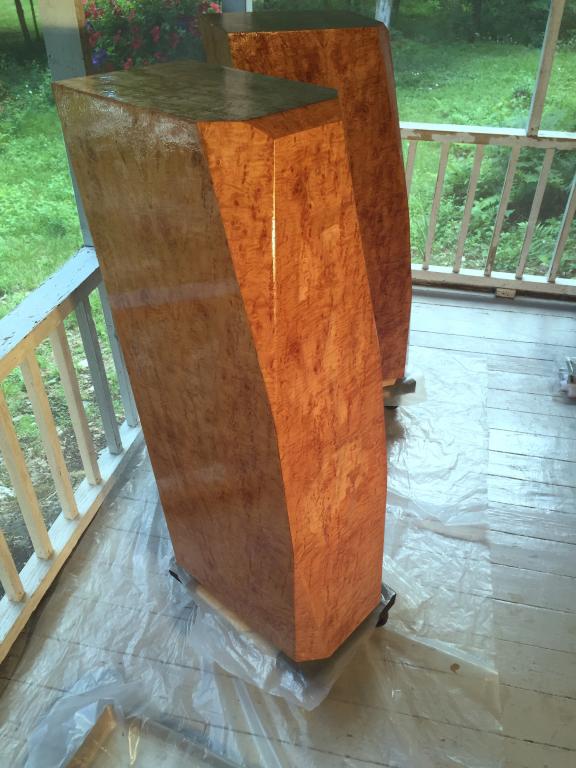

                                                                              Final coat of finish on. Almost doesn't need buffing. It will get some time to harden while I'm out of town. I need to build proper bases and assemble the crossovers once I have the adjustments for the -02 woofers. ET has been keeping Jon busy on black projects lately. I've got a mini-DSP solution handy in the meantime.
                                                                              Teaser shots, of course the forum decided I wanted to present them in landscape format. I even tried rotating them before uploading to no avail. Halogen shop light from the side, in case it wasn't obvious.
                                                                              Actual color is about halfway between the two colors seen here.
                                                                                • 571
                                                                                #399
                                                                                Looks great Bob...Is that 5 coats total? If you plan to buff it out I would sure like to know your process.
                                                                                  #400
                                                                                  Thanks. Just the usual buffing process. That horrible feeling sanding a nice glossy finish with 400 grit, then working up through 600, 800, 1,000 and 1,500. At 1,500 grit it should be a nice satin finish. From there, I'll decide whether to buff with a polishing compound. I have buffing wheels and a compound stick somewhere in the garage. If I end up using them I'll post what they are, I just don't remember. I did a set of black Focal Mini-Utopia lookalikes that came out looking like they had been clear coated and polished with this routine.
