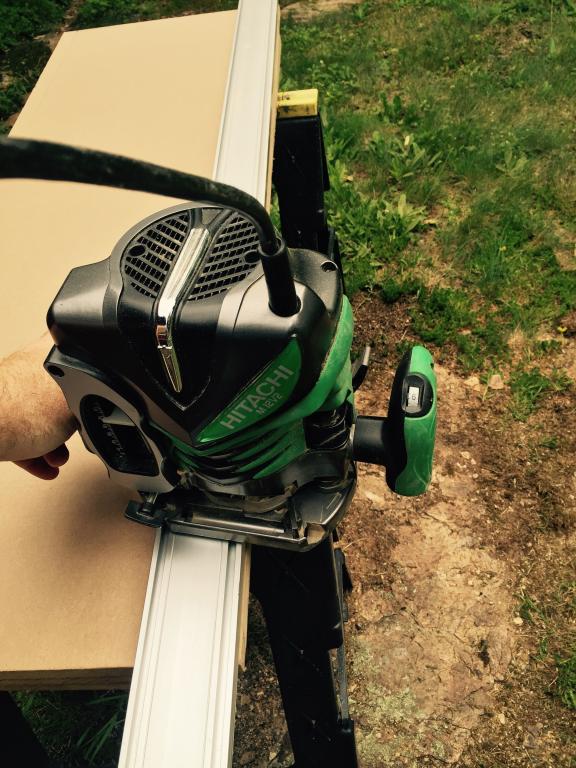

                    #234

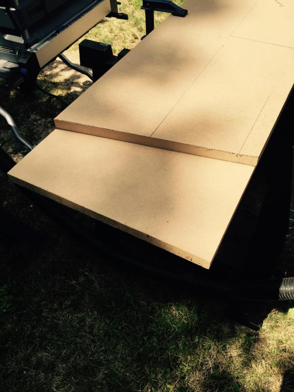

                    Edge straightening so there's proof of progress
                      • 16203
                      #235

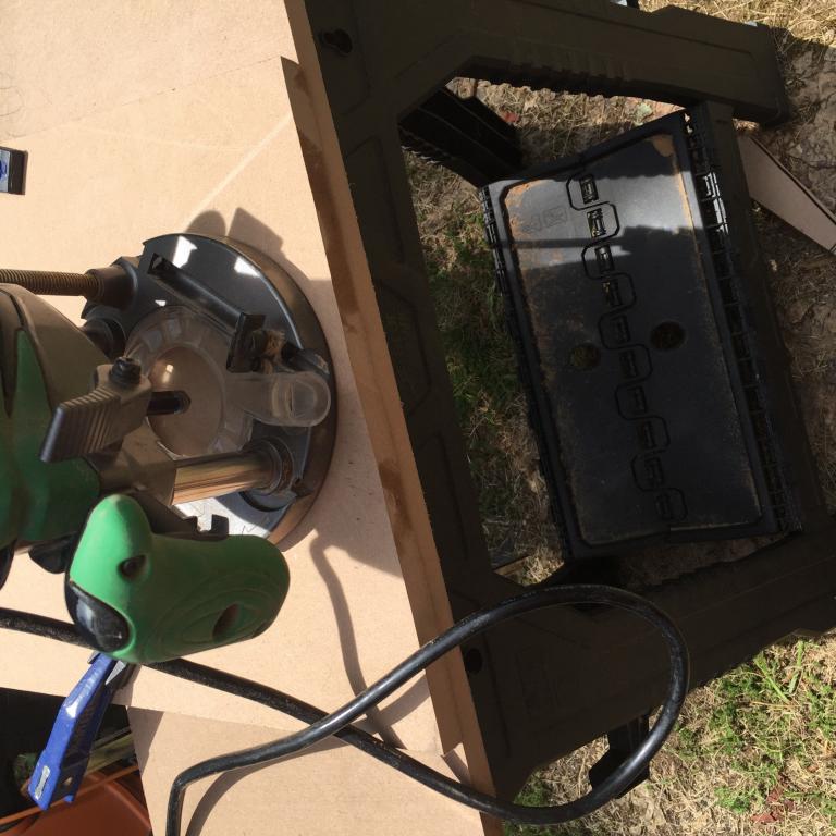

                      OK! BTW, that's one of my favorite brands of routers- I have two of the original M12V! Absolutely marvelous motors and design- second to no one! But heavy... definitely not for laminate trim! :W
                        • 2142

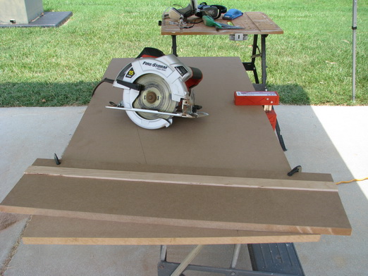

                        Nice with the router, Have not tried that trick. I do a similar thing with my circular saw ...... my poor mans imitation of a Festool.

                          #237
                          Not surprised you like the router, Jon. I bought it based on your recommendation years ago.
                          My circular saw wanders too much even with a guide board. The blade and base are only parallel as long as you don't use it.
                                Ouch, that explains it. I could at first not understand why you would use a router after making the cut.

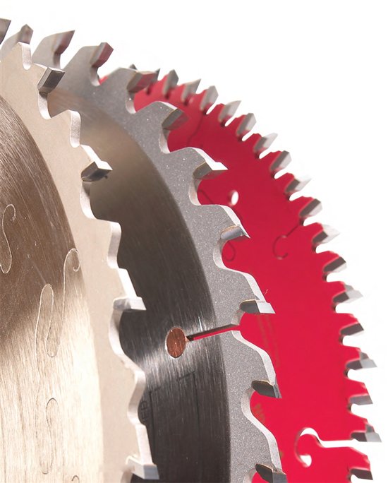

                                  If a new blade is in your future, or your looking to have some blades or bits sharpened, give Dynamic Saw some consideration. I had some sharpened (including 2 Forrest) along with a few router bits and they are like new. I have no affiliation with them, just excellent prices and service.
                                  Great explanations of the different types of blades and designs. ie; Triple chip, ATB, FTG ect. and when to use each.
                                  We offer low prices on these types of new saw blades: non-ferrous, chop, general, panel, split scoring, trim, thin, gang rip, truss, melamine, plastic, mitre, glue joint, solid surface, ...

                                      Here is a good explanation for the different types of blades available. Some of this I just learned.
                                      BTW, this was NOT meant for you, it was meant for anyone who wants to know whats available in blades and how to chose the best one(s) for their applications.
                                      Choose complementary blades for perfect results. In the dark ages of woodworking, before carbide, you never used the same blade for ripping and crosscutting. Cutting plywood required yet another blade. Today, hybrid blades allow you to avoid blade changes entirely—unless you want absolutely perfect results. Then it’s better to have more than one blade. I’ll...

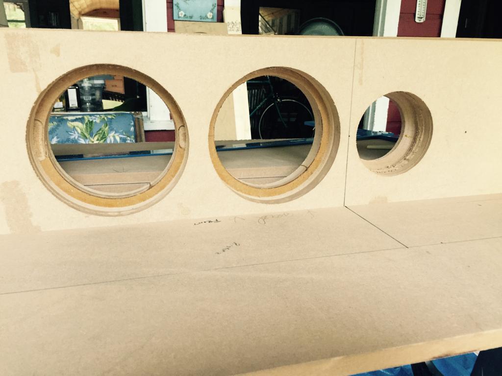

                                                    A little progress to report. Baffles chamfered, assembled and other cabinet parts cut to width. It's been a battle with the weather. Working outside, I have to wait for the ground to dry so I don't tempt fate standing in a mud puddle. It's been darned hot, the summer camp is not air conditioned, so it's 10 minutes in front of the fan for every 5 working. Then we have our afternoon thunderstorms. At least they have been moving slowly enough that when I hear a rumble through my earplugs I have time to pull everything back inside. Glue up and dry fit is on the porch so rain isn't a total washout. It won't be long before it's assembly so I won't be so weather dependent.
                                                    I took the baffle parts to my Dad's when I went to get him set up at home post surgical rehab. I forgot that I had grabbed some of the clamps out of my trunk, so I wasn't able to do anything other than chamfer the mid cutouts. Boy, did my Hitachi MV12 make quick work of that. I agree with Jon that this is one of the must have routers. Although I only have one.

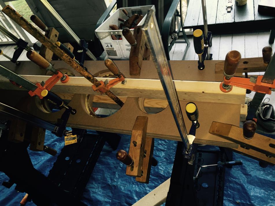

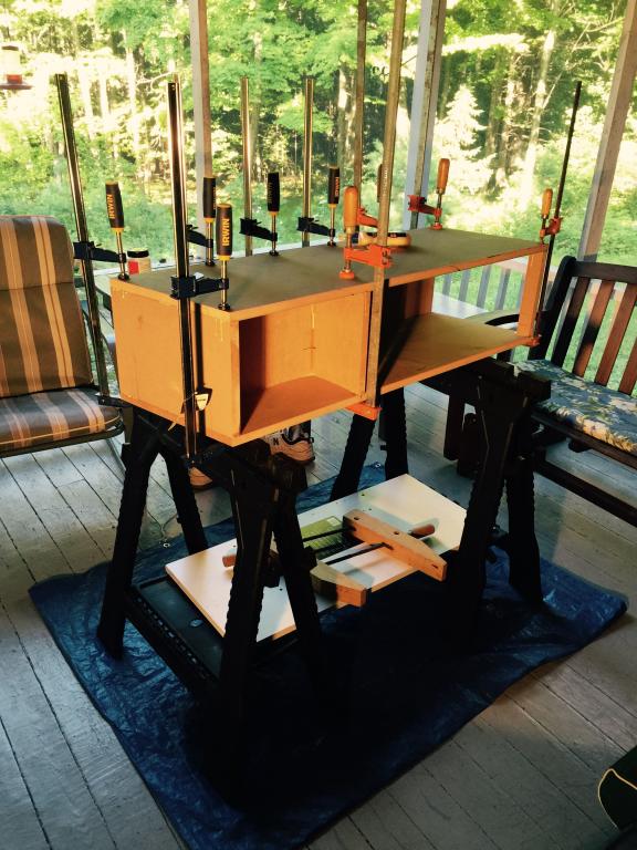

                                                    In the you can never have too many clamps department, I glued up the baffles on the porch to stay out of the sun. I couldn't get a shot without so much contrast, but you get the idea.

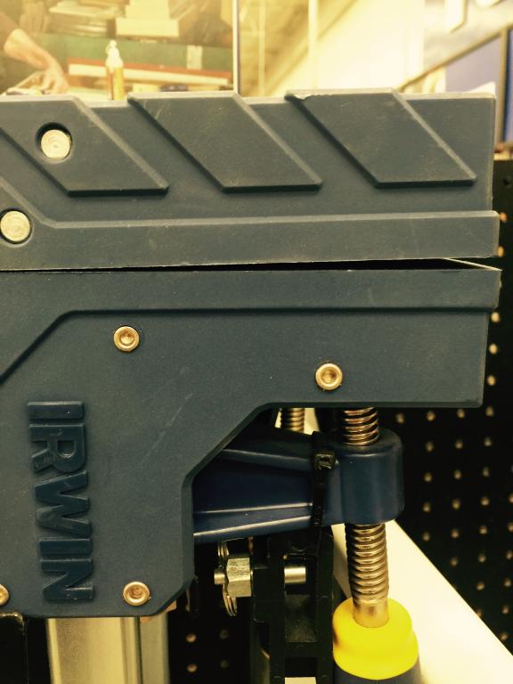

                                                    Speaking of adding to the clamp collection, I went to buy some of those lovely parallel jaw clamps I've seen others here use. Most on the rack at the store looked like this:
                                                    Guess I need to look to another brand.
                                                    This build will make use of my biscuit joiner, so here's a shot getting the mid sub chamber placement marked up. Although generally following the Ardent build, I am only using a single 3/4" thickness of mdf other than the baffle. I also added a couple of inches to the depth to make the RS225s a little happier. I'm adding a couple inches to the height, since I am a bit taller than average, too. Bracing will be cross braces rather than the matrix in the original.
                                                    The eagle eyed will see the distraction that has kept me from spending as much time on this project as I might have hoped. Even when I plan a ride then speaker building I end up pushing hard and get to that fuzzy brained place where power tools aren't a good idea. Nice to be getting fit again, though.
                                                    Then just to get a feel for how the assembly will go. Not the largest speakers I've built, but not much smaller. Glad my girlfriend appreciates good sound and is willing to have this in our living room. Thank goodness the facets will make it visually smaller. Halogen shop light filling in the darkness.
                                                    Next is cutting the angles on the cabinet parts. Once the cabinets are assembled, I will cut the baffles to width. That's going to be a bit of a challenge with my low powered tablesaw. I guess it's a rip blade and multiple passes. If worse comes to worse, I have a pattern bit and flush trim bit that will allow the MV12 to do the job. That's how I got one clean edge on the baffles.

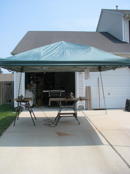

                                                      Some nice progress Bob ....... I know what you mean with the weather and having to work outside in the heat ...... I picked up an inexpensive tent when I was doing my Jensen's made a big difference just getting in the shade
                                                      A suggestion for you on the clamps .... I use Jet and they work great. They are more expensive than what you get at the big box stores but I look for sales of them in sets on Amazon and have saved considerably. They are also nice if you have a work bench with dog holes since can attached bench dogs to the clamps and it locks everything to the bench nice and square. I also hear Bessy and Jorgensen are good but I don't have any experience with them.
                                                        #252
                                                        Thanks, Steve. I think a canopy like that is in my future. I have a number of Jorgenson clamps, and they are great. Standard bar clamps, pipe clamps and the handscrews in the picture, just no parallel jaw clamps.

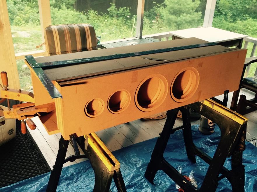

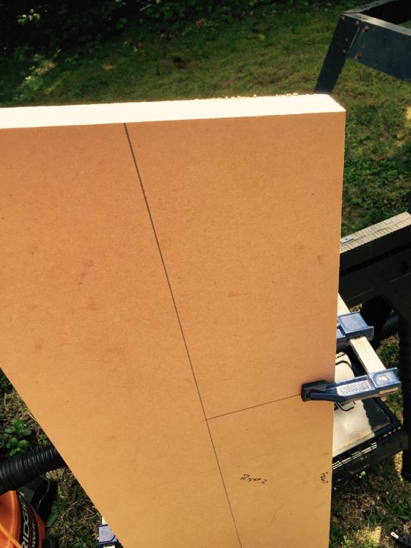

                                                          A bit more progress. Missing my radial arm saw for this part. Cutting the top and bottom angles on the sides would not work on my table saw without making a crosscut sled. The miter gauge doesn't have enough reach to properly guide a panel 14" wide (I went deeper than standard to get more volume for the RS225s) and the whole thing seemed a bit wobbly at full extension. So, it was Hitachi to the rescue again. Hand rough cut the first edge with the wandering circular saw, clamp a straightedge along the desired angle, flush trim and then use that as a pattern to do the other edges.
                                                          Using the first cut as a pattern for the second to ensure the ends were somewhat parallel. Then used the first completed side as a pattern for the remaining 3 panels.
                                                          I managed to get one cabinet glued up - bracing to be added next. Not sure why I decided to do it in this order other than a desire to see some glued up progress and rain was threatening. We ended up getting a dozen drops, but it looked really nasty. Yes, it's bright sunshine in the background. The skies cleared within minutes of my pulling everything inside.

                                                                        Progress again. Both cabinets assembled and braced. Baffles cut to length and 10°. That part was interesting because as I started assembling a crosscut sled I realized that I didn't have the depth of cut needed to cut the baffles if they were on top of the sled. Luckily I had enough extra baffle length to make a few practice cuts to hone my technique. Overall it came out pretty well considering the flimsy miter gauge that comes with my saw. I will probably take the week after Labor Day to cut facets and attach baffles. My back doesn't like the lifting or bending over, so it goes slowly.
                                                                        Click image for larger versionName:	image.jpgViews:	1Size:	102.2 KBID:	859995
                                                                        Click image for larger versionName:	image.jpgViews:	1Size:	101.0 KBID:	859992
                                                                        Yes, I used a rip blade to cut the baffles and trim to width, figuring there's no way I could push an 80 tooth blade through 3" of MDF
                                                                        Click image for larger versionName:	image.jpgViews:	1Size:	101.2 KBID:	859993
                                                                        By the way, it's always a good idea to maintain a firm grip on the cabinets when moving them. At least the cabinet was undamaged. The lake is one of the many distractions that have slowed progress on this project.
                                                                        Click image for larger versionName:	image.jpgViews:	1Size:	100.9 KBID:	859994

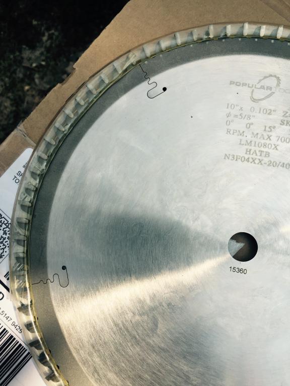

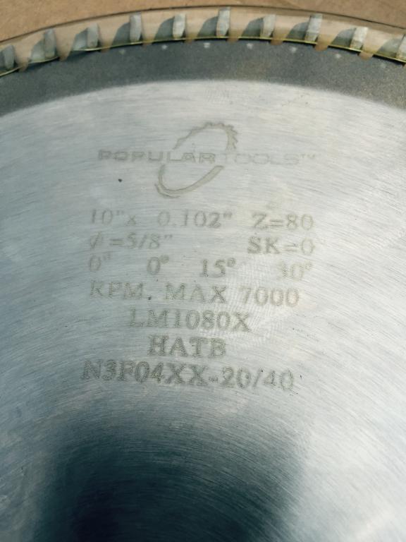

                                                                          Mini product review section:

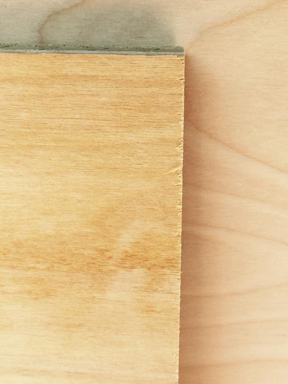

                                                                          Dynamic Saw LM1080X - The cut is really nice. Feeding it 3/4" mdf or 1/2" Aspen ply there was never a hint of slowing the saw, no matter how fast I pushed it through. Cuts were smooth with just a little tearout on the ply. Although it only has 4 laser cuts to dampen the blade vibrations it was quieter than either of my Freud blades. (An old LU85R010 with 8 laser cuts and a new LU74R010 with loads of laser cuts) The dominant sound running not cutting was the air flow into the dust collection. Overall, it's a winner and I'm sending them a few old blades and bits to sharpen.

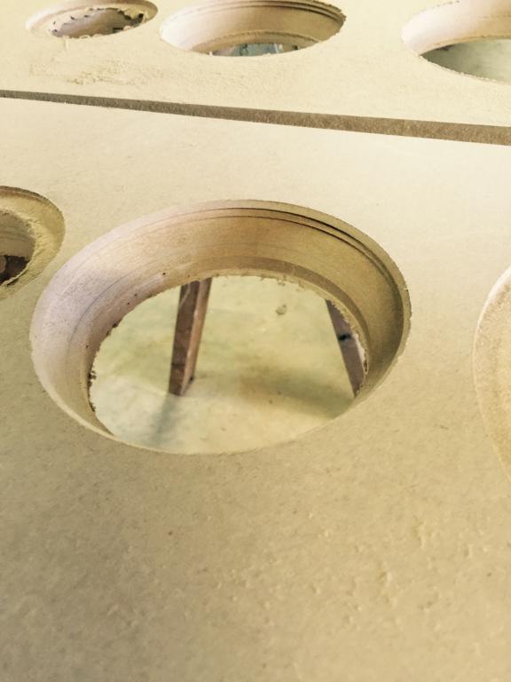

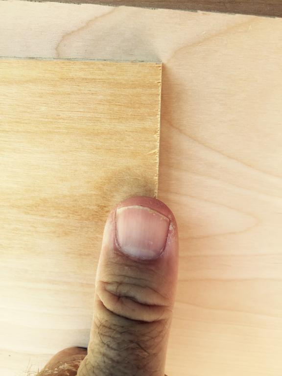

                                                                          Tearout shots - these were the worst areas. Thumb for scale. Most people I meet for the first time comment about how big my hands are. That thumb is probably 25% bigger than you think it is.

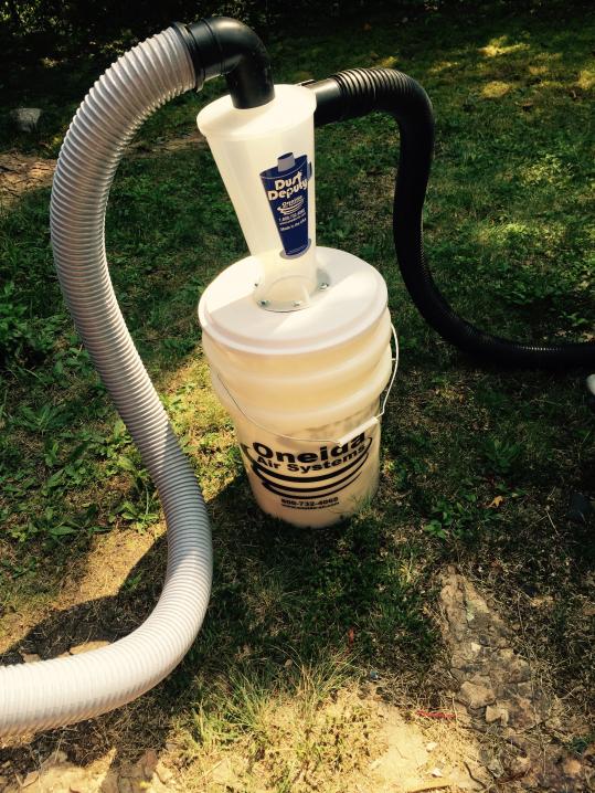

                                                                          If you use a shop vac to collect sawdust, you really should get one of these. Some dust gets through, but the vast majority ends up in the bucket. I did several times more cutting than used to require unclogging the vac's filter with no noticeable loss in suction. There is some insertion loss, of course, more than made up for by not clogging up the vac's filter. For now I just have some weight in the bottom bucket to keep it upright. If I start working where wheels make sense it will be assembled to the vac.

                                                                            " At least the cabinet was undamaged." Way to take one for the team! You are a true professional, sacrifice your own flesh for the safety of the cabinet. I salute you! I bet that smarted a bit. Nice to see your progress. Is there a layer of plywood under the MDF baffle? Asking due to the color difference(s).
                                                                            Damn straight the cabinets are heavy, be careful of your back. Are you planning on any additional layers of material on the outside of the MDF?
                                                                            Good use of materials on the "mid-back" section. Gotta love a frugal guy. Not sarcastic.
                                                                            Thanks for the review of their blades, I was happy with their re-sharpening service and the next blade I purchase will be from them. Very glad it cuts so well and quiet is always a bonus. That tear out is acceptable for non Baltic Birch plywood, I would think almost zero with BB. Glad your happy with the blade. Pictures are worth a thousand words. Nice.
                                                                            " Thumb for scale." Great idea having a reference in the photo.
                                                                            " Most people I meet for the first time comment about how big my hands are. That thumb is probably 25% bigger than you think it is." In Benny Hill's voice : Yeah, and I bet the girls like you.......:roll::rofl:

                                                                              Looks like you've been busy Bob ....... cabinets are looking good, nice job on the leg 8O hopefully it's not slowing you down too much. I found that once my Jensen cabinets got to a certain point I drug my wife out to help me move stuff around. After many years I've finally learned just because I can pick it up doesn't mean it's smart to do so. It's either that or get an engine lift, that mdf gets heavy.
                                                                              The new saw blade seem to be working well ...... for that last bit of tear out protection, have you tried painters tape on the cut? I've found it helps if I'm really trying for a clean cut.

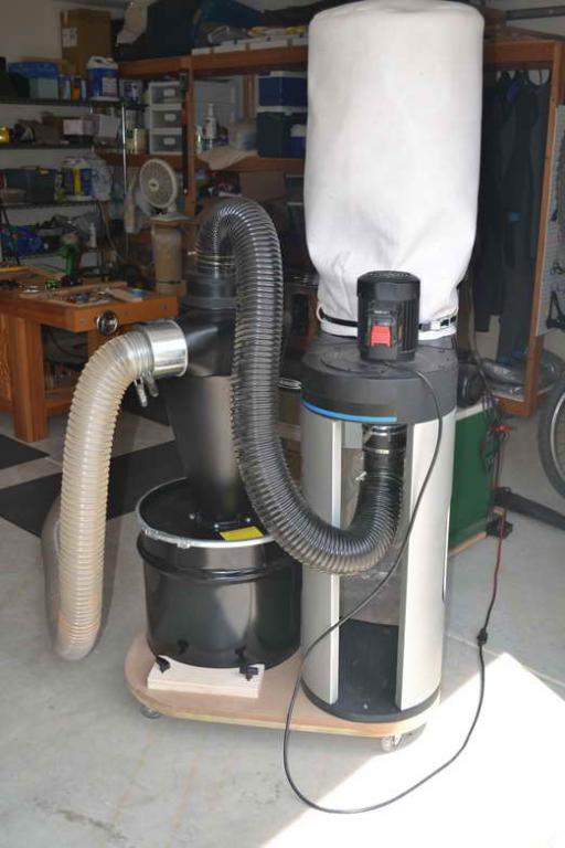

                                                                              I like the dust collector, I want to add one to my shop vac at some point. I've put the big brother to yours on my dust collector and it works great.

                                                                                As much lazy as frugal with the bracing. It's all butt joints and biscuits so mid enclosure, top and back are the same width. I just cut an extra strip to give me some braces to work with. The thought of cutting lots of little holes in MDF braces didn't thrill me. It should be less problematic with the next build's BB, but I am searching out vacuum hoses and adapters to improve my dust collection.
                                                                                That aspen ply is a substitute for the 1/2" MDF the Ardent plans call for. The box stores around here don't carry thinner MDF. I intended to rip some of the full boogie build's BB pieces to see how that went, but my bicycle called.

                                                                                  I haven't tried painter's tape, thanks for the suggestion. I'll try both bare and taped on BB and report back after next weekend's work. Excited to think I'm going to start laminating the panels of the Wavecor version soon.
                                                                                  I was expecting the leg to bother me a heck of a lot more. Got in the shower this morning and thought I had glue on my leg until I looked at the scabs. I got lucky on that one.

                                                                                        Painters tape is a good trick to prevent edge blow out. Keeping the blade low helps too, just high enough to see the bottom of the gullet behind the tooth. On the REALLY pricey wood we would put a sacrificial board underneath and rip/crosscut both at the same time, ie; 1/4" hardboard. Never tried cardboard, just thought of it.

                                                                                            One more for tear out ..... it might preclude you from having to add the hardboard underneath, use a zero clearance insert on the table saw ..... depending on your saw you can make your own or buy them. Add the tape on top of your board for critical cuts and your good to go.
